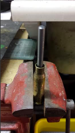

Was sizing some once fired LC 308 brass, a couple primers wouldn't pop out because of the crimps and then sizing one, and on the down stroke this happened..
Did about 20 or so with no problems before this happened. I got the case out and the rod back into the die, but is it ok to use the die? I put the rest of that brass off to the side for now and will continue (if possible) with the rest that I have. But is it ok ok to continue using this die?
What happened? Did the rod come out of the die?
I assume that the expander ball is stuck ? if so you will have to cut the case if the die won't hold it.
either take the ball out or lube the inside of the case neck
Yes the whole thing was stuck. Thankfully I was able to get the die to hold it! and get the case off!
