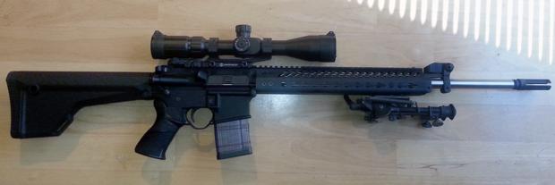

All you need to do is pull the barrel off the upper (simple job) and have a local smith thread it.
SS is easy to thread. I have 6 SS bbls. that are threaded my self.
Buying the parts VS a ready to shoot gun can run a lot more or a bit less depending on what you get.
Stainless steel barrels will thread just fine. A lot of off-the-self varmint rifles will come with a heavy stainless steel bull barrel. These barrels help with accuracy and reduce recoil. Being that flash suppressors are used to aid in concealment, they are not typically found on hunting rifles. Since you are looking for an accurate "SHTF" AR-15 I would suggest something with a shorter and lighter barrel. WOA makes 18" SPR and a 20" DMR barrels that are already threaded, are lighter than the varmint contour barrels and are very accurate. They will also send you a bolt that is matched to the barrel you buy for a few more bucks. If you go with a WOA barrel I would also suggest a Geissele trigger. These are top notch triggers. As far as toning down the SS barrel you can go many different routes. At the high end you can have the barrel finished to whatever color you want or you can mask off the important parts and spray paint it in your backyard. Good luck and keep us posted.
