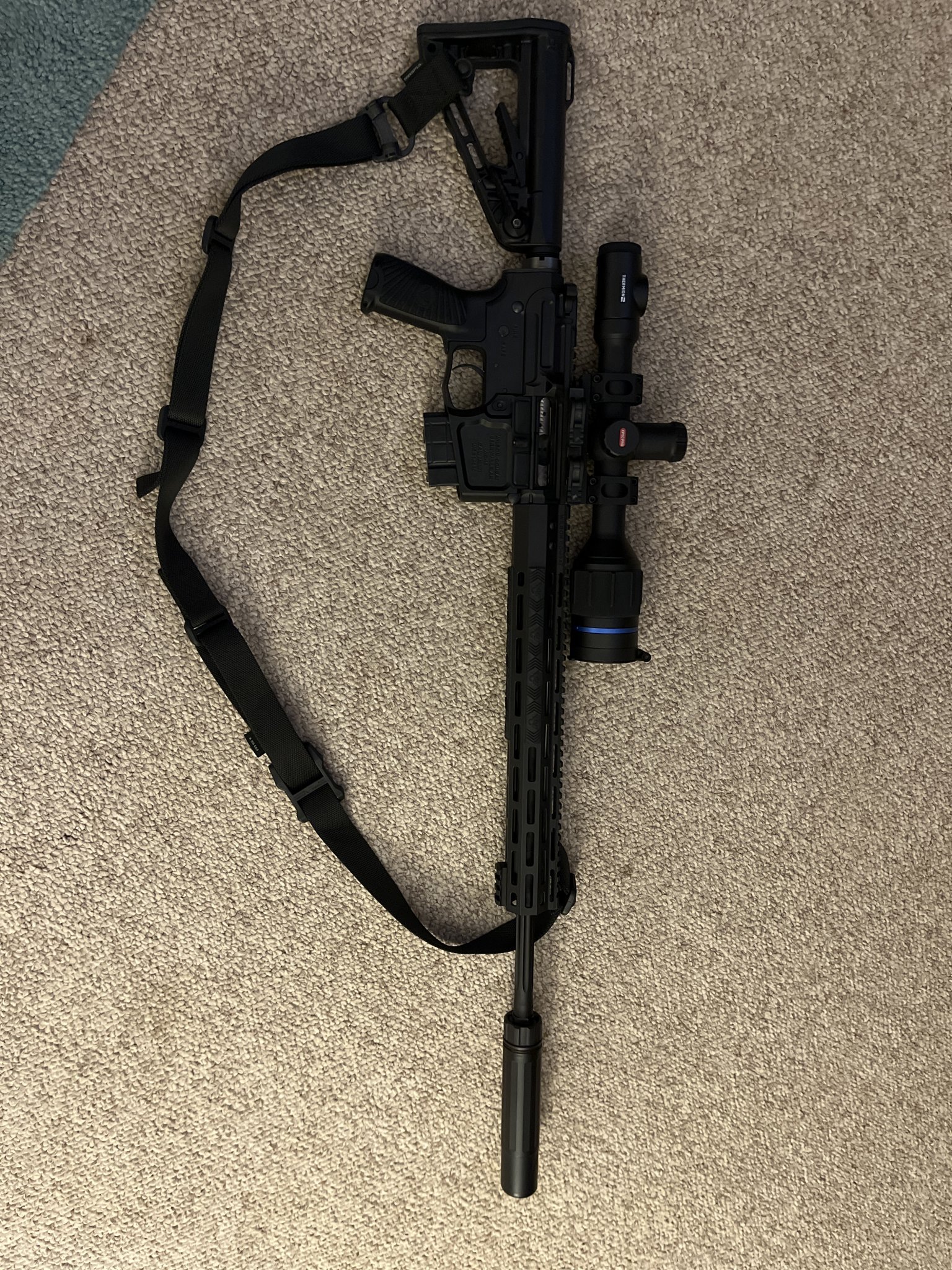

Since you revived one of my old threads I guess I could share what I built. I ended up building a 22nxs 20”. This is super sweet. Runs sierra 55 game kings at 3566fps out of an AR15 platform.
Now the bummer part is I bought 100 pieces of 6 Hagar brass to “test” the caliber out and planned on buying 500 if I liked it. By the time I got it built and tested hornady discontinued the brass so I really haven’t used the rifle much since I’m afraid to loose my brass or wear it out.
On a positive I am building a 16” 22br as the newest coyote getter.
