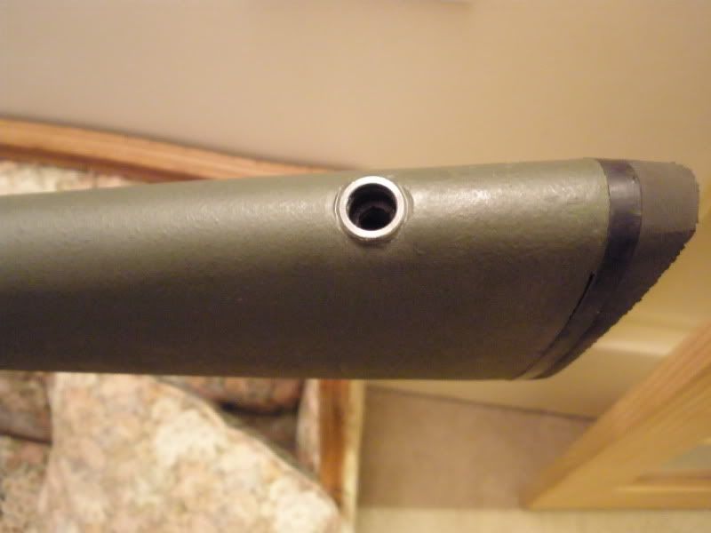

You can install flush cups in almost any stock, you just drill the whole for the flush cup, epoxy them in, 24 hours later your good to go. I'd give it a 3 out of 10 on the easy-ometer.
I recently installed flush cups on a HS Precision PSS stock, here are a few pics

I purchase mine from Triad Tactical .Its hard to tell from the pic but they have a course outer threading, any epoxy will do, I have used everything from Marine Tex to JB Weld.
