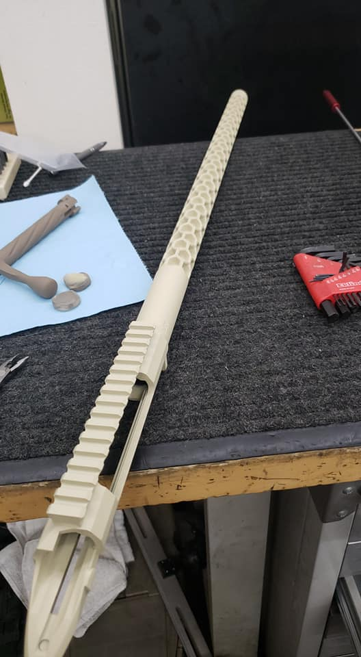

Yeah, I've been wondering too what the effect of these intricate designs must be on harmonics and accuracy.
Accuracy? None far as we can tell. You may have to alter a given load a smidge to find the node again, but the fundamental potential of the barrel doesn't seem to change on a properly normalized piece of steel.
Harmonics? Don't know, don't care. That is what a loading bench is for. To be totally honest, I don't even know wtf harmonics even means. -A music instrument that instantly makes you Neal Young? :)
In all seriousness. This term gets thrown around a ridiculous amount. The truth is very few have the means to truly evaluate it and the moment you change anything, it all becomes meaningless anyway. Throw a can on it, there will be a change. Let the can go for XXXXX number of rounds where it collects a bunch of fungus and carbon, it changes again. This is a constantly evolving reality. If the barrel copper fouls, that is added mass as well and low and behold, the frequency, amplitude, and harmonic will all be affected. It'll be small, but it will change.
Ever shoot a gun that hammers like the dickens and suddenly the can backs off and you're lucky to hold a minute of stop sign? Guess, what? THAT is a change in harmonics.
It's no different than hanging a ruler off a bench with a screw and tapping on it with your finger. Then, tape a penny and do it again. Follow up with pubic hair. It is the same exact kind of behavior. A big "trick" with ammo is making that thing "bounce" the same amount every time you shoot it. The old school adjustable barrel tuners managed this behavior by moving that mass inward/outward in the effort to "time" the projectile exiting with the crown to a point where the barrel has stopped moving as it begins to travel in the opposite direction.

You could have saved that much weight a lot quicker by just cutting the barrel down to 12 inches. Haha.
Those honeycombs might actually dampen "harmonics", they natively can do that. Super cool job BTW. I would totally use one on the chassis I'm building - way before carbon.
Looks awesome, but I can tell it would drive me nuts trying to keep those honeycomb pits clear of debris/dirt on any rifle that gets more use than back and forth from the bench. ?
Still love the pattern you call pattern X, but looks like chain. That price tag puts a stopper on it for me. Have a Shilen on the way for a Savage. Was thinking of wrought iron, but maybe honeycomb now? I don't know. Have about another month till I should get the barrel. Have more time to sleep on it.

If I chop that barrel down to 18" and put this fluting on it, I imagine I can really drop some weight.
What is the price of getting a barrel fluted with this pattern?
We will. I have this silly thing on our FB page as well and it's throttled into a reasonably big topic of discussion. I'll be on a milk carton if we don't show the final assembly.
Is it me or are the pockets elongated on this compared to the original barrel you showed?
Is there a set amount of material you’re leaving between the bottom of the pocket and the bore? Ever done a shallow version to a #2 or #3 contour?

That's badass. I don't know how you could do it efficiently but it would be cool to mask the raised surfaces and coat the fluted recesses in a darker color for even more effect or hiding the inevitable accumulation of dust and dirt. Would totally double down on the already amazing effect.
Reactions: Snuby642
You would have to have some kind of mask material that could be sprayed on, selectively milled off, and then washed away, sort of like semiconductor manufacturing. It wouldn't be possible with tape because it's too intricate.
Liquid mask? I have used it for masking airbrush projects. No idea how it would hold up with cerakote. It's basically a brush on frisket material. Much easier to apply to irregular surfaces than tape.
A water hose would wash the barrel right off. Let dry and spray a little rem lube. Done.
Waterjet cut high temp rubber sheet to fit into the honeycomb shape. Install after first coat is staged, then add second color. First victim pays for plugs.
