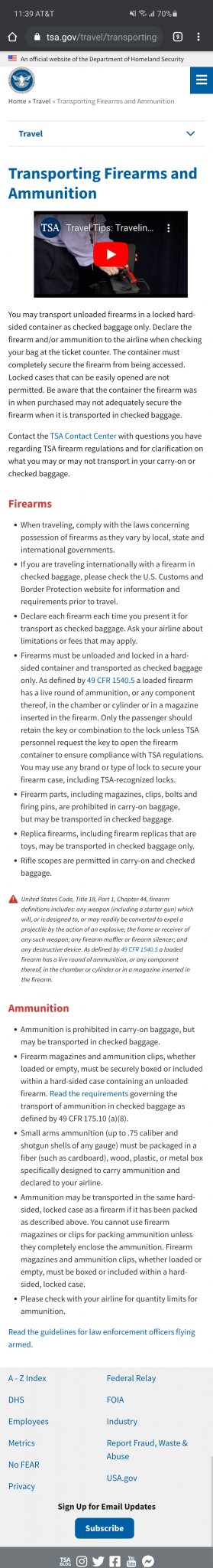

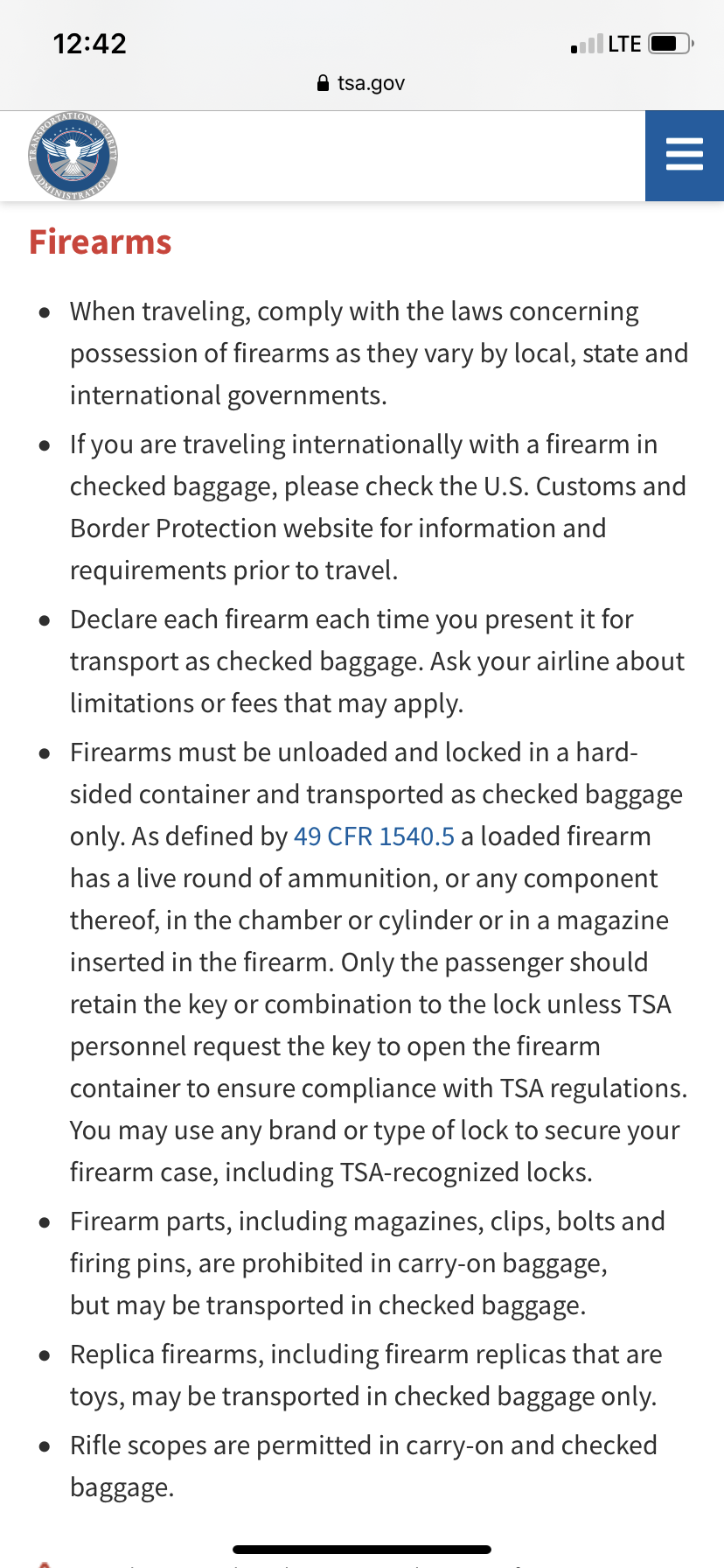

They did update it, just grabbed directly from TSA. It does say clearly. Loaded mags are allowed except they are not allowed and you can transport loaded or unloaded in the same hard case except if they are loaded...
WTF...??
latest from tsa..
