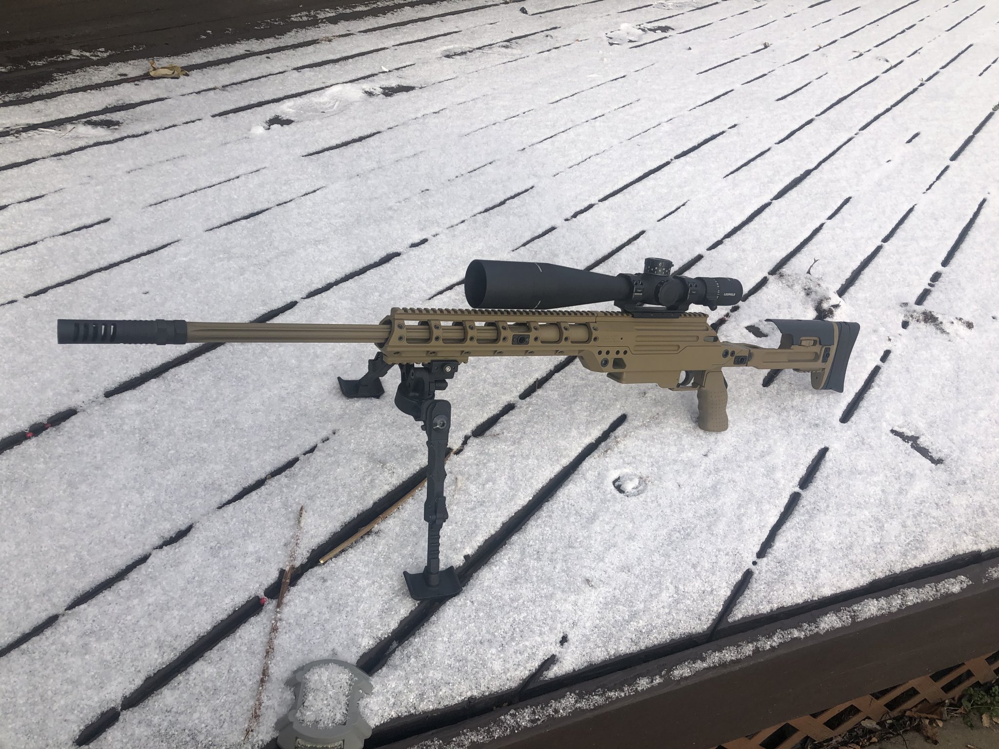

I recently got an FN Ballista chambered in 338 Lapua. I have shot around 150 rounds through it, and all of the sudden I am beginning to have light primer strikes.(using federal 215's) I've checked all of the usual suspects such as dirty firing pin, headspace issues, primer seating depth, etc. I was wondering if anyone else has had any problems with this particular rifle, and if it was a spring issue, or what you had found. Thanks for the help!

I assumed it was that also, i have thoroughly cleaned the firing pin and nothing is broken. That's why I was confused only thing I could think of other than what I had already checked would be the spring wearing. I would be quite surprised if it happened in that low of a round count, but I am not ruling it out. I appreciate the help though!
