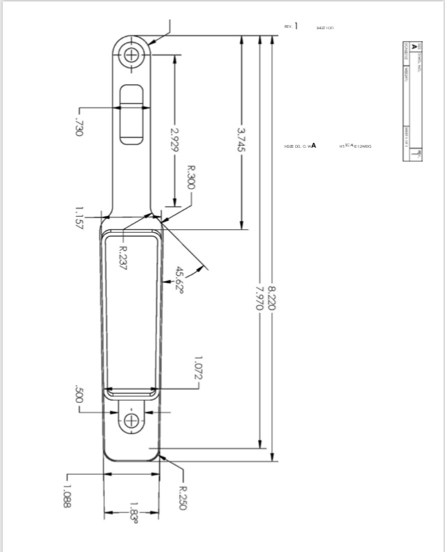

So I have this crazy thought in my head about using ARC Mags for the 2.970" internal capacity advertised by ARC in my FN PBR build. I will be doing an inlet into a McMillan A3G and would like to know from those in the know what bottom metal(s) will work for this application? and what if any modifications will be needed to the receiver?
Thanks!

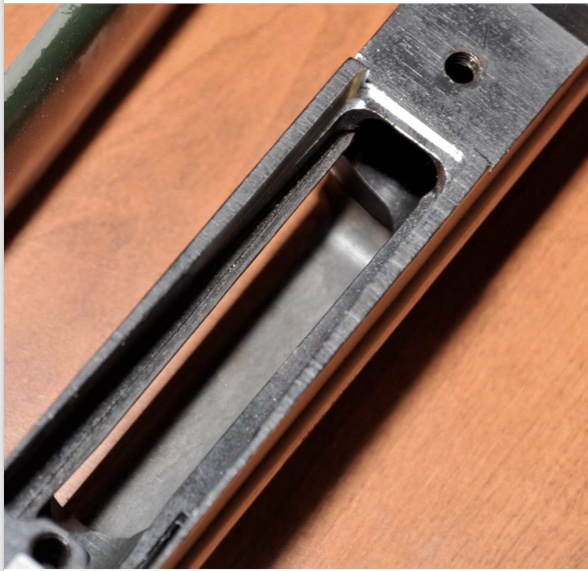

There is a bit of machine work that needs to me done to allow for the fit of the AICS
Mags on the bottom of the receiver. There used to be a thread with the entire process done by Scimitar, But I couldn’t find it just now with a search. But box up the gun, call CDI precision And let him take care of getting it done. Seen too many hack jobs where somebody Tried to do it with a dremal tool. I have used the CDI DBM on my modified FNs
For years for 308 and 7WSM. That’s the way to go.
