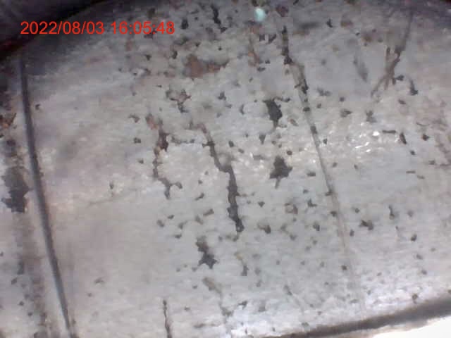

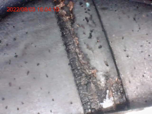

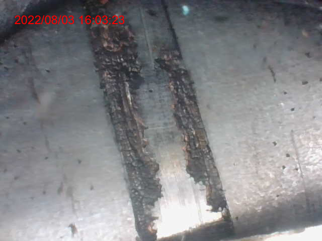

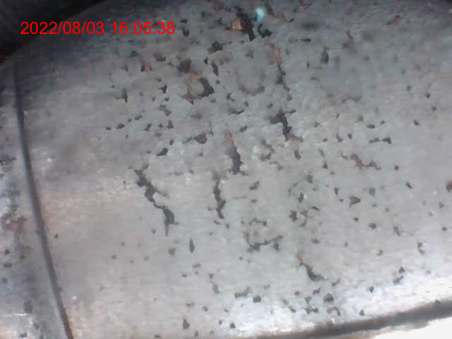

This FN SPR is making me question my sanity. 20” Model A5M XP in .308win serial number in the 35,000 range. TBAC Ultra 7. Prone and rear bag.
1,100 rounds down the tube. Sometimes it shoots 3 or 5 rds decent (.5-75moa) but the next time out or even the next group maybe substantially larger/suck(1-1.75moa). 175smk Handloads or FGMM both do the same. Constantly chasing my tail.
Look like the chrome lining giving it up? Didn’t consider it at first because it will shoot at times but just seems inconsistent with big swings with the same load.

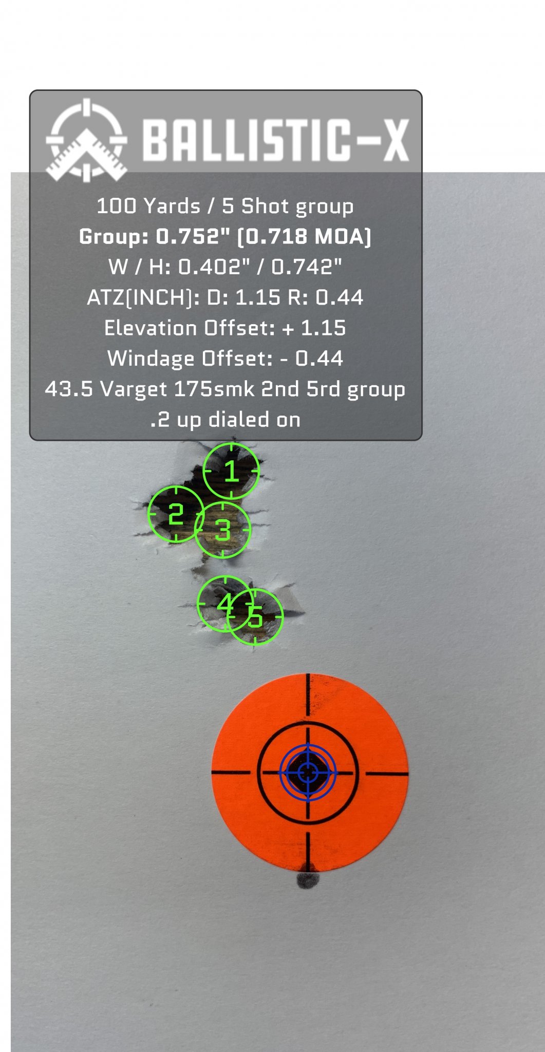

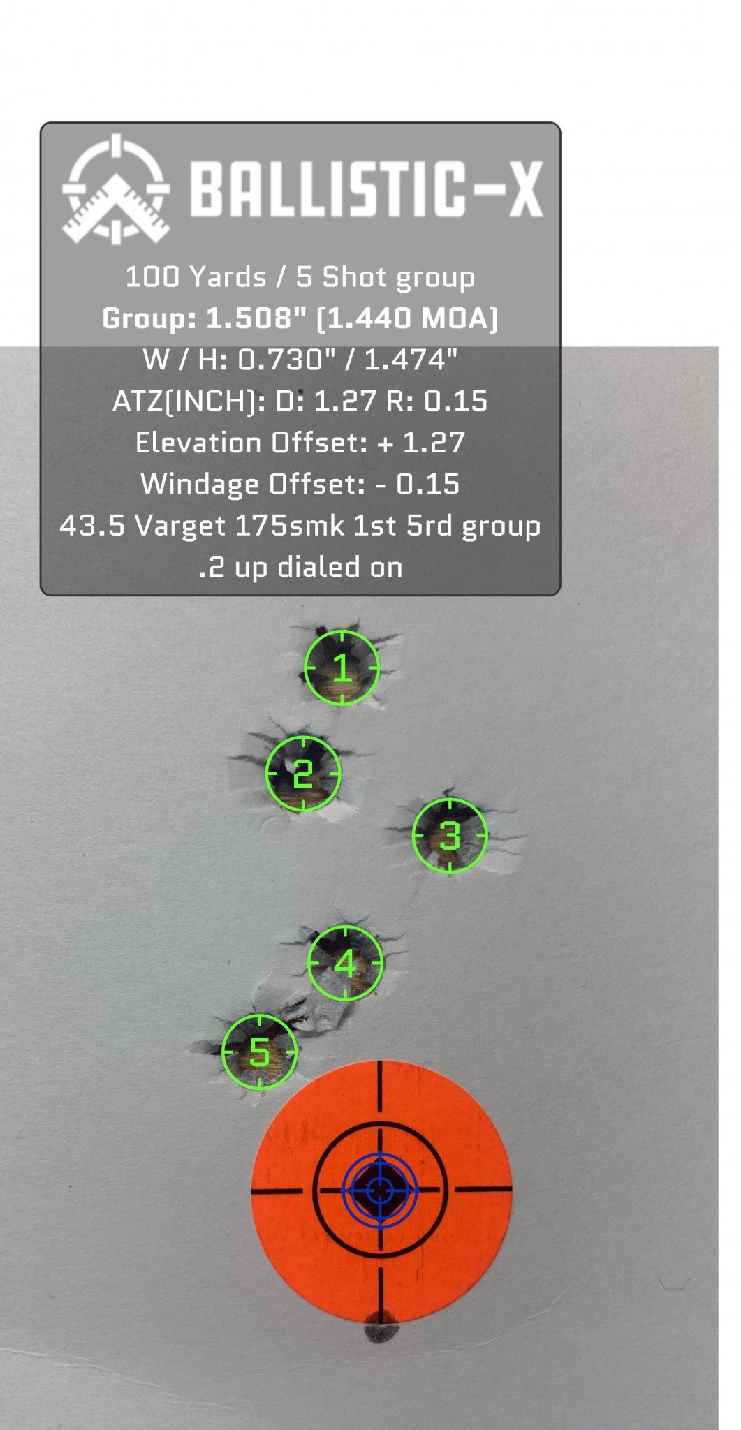

1st group today.
2nd group today after cooling 10mins - seems like it was .75moa gun on average when new.
Shot a .286moa 3rd group at 43.3grains yesterday, today 1.553moa. 🤔
But the bore looks like this in front of the throat. Obviously not so much towards the muzzle.
I’ve read Frank Green’s comments about chrome lining giving it up and it going to shit when it does, just simple statistics that I get a good group once in awhile looking like this?

It seems to me the rifle is telling you it needs a new barrel. I had a 308 barrel last 8000 rounds and didn't look that bad, but it was very inconsistent at the end of its life. I did shoot the best group out of that barrel before it gave up and started throwing shots.
Reactions: Shootnwrench
Agree. Barrel looks bad. I have not seen problems with FN or Colt chrome lining. Keep in mind that chrome lining takes away from accuracy, so on a good day, .75 MOA is good. I am used to seeing chrome lined barrels last 1,000s of rounds. Who knows. But, replacement is the answer.

🤯If that barrel is “clean” and showing that much copper fouling, then it would seem that those are indeed, many “pits” and it’s prematurely fouling the barrel. 🧐

Thanks for the input gentleman. Only recently got around to borescoping this thing, first time I’ve borescoped a chrome lined bore, wasn’t what I expected for sure. @Frank Green any thoughts?
Agree, I still really love the rifle, just disappointed the “FN 10,000rd chrome lined barrel” is unpredictable @ 10% of that . If it was a barrel burner cartridge fine but .308 barrel life 🤔. This one is 1:10twist btw, the latter guns are.

Chrome plating is chrome plating. Think of a chrome bumper on a car. Once the plating starts chipping/flaking you are not going to stop it.
Depending on the spec./requirement for chrome plating of the bore of a barrel...it could be as thin as less than a .001".
You also can have issues with it effecting bore uniformity. If the bore uniformity from end to end is compromised....this will also lead to accuracy issues.
