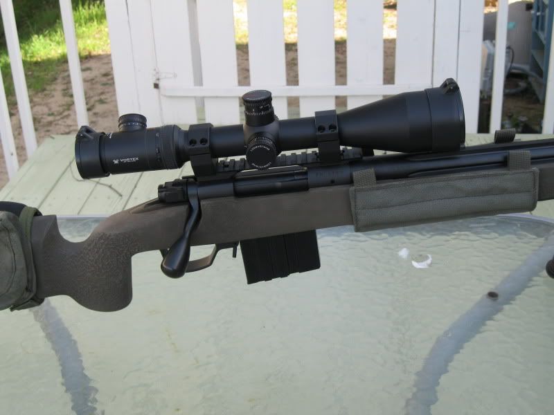

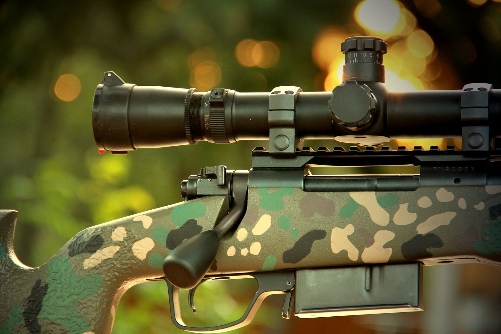

Been think about a bolt knob on my PBR and wanted to know if anyone out here has them done. Please post pictures.
Karl Feldcamp of Kampfeld Customs:
Mark Gordon of Short Action Customs will do a helluva job too.

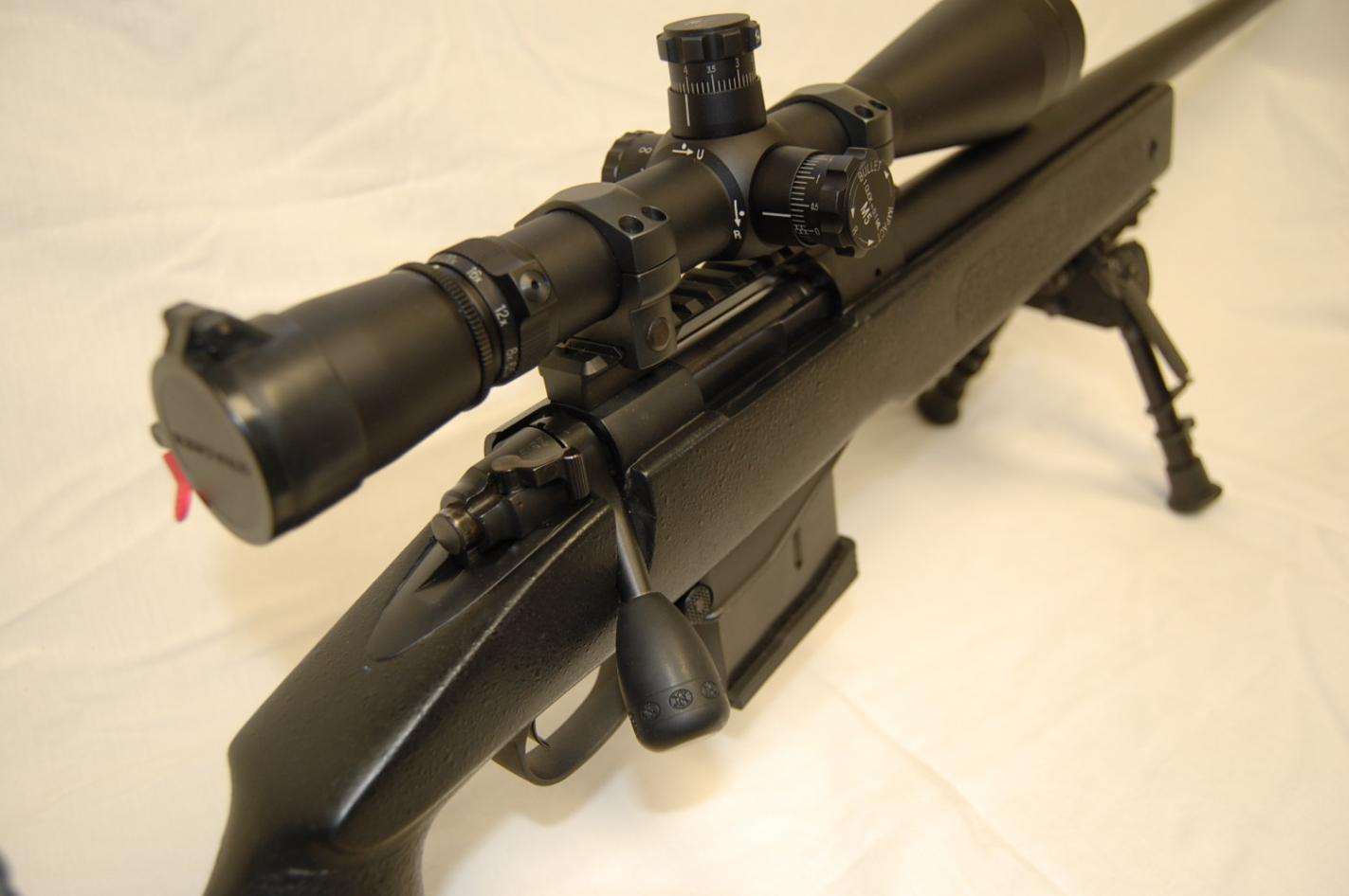

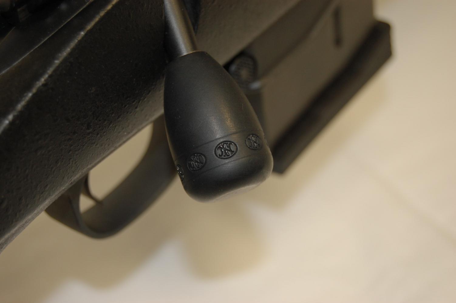

Here is my SPR in .260 with FN logo'd bolt knob.

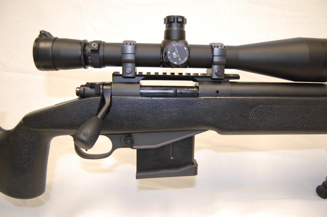

Here's a R&D Precision bolt knob.
[/URL]
Apologies to the OP. Thanks for the info guys.
