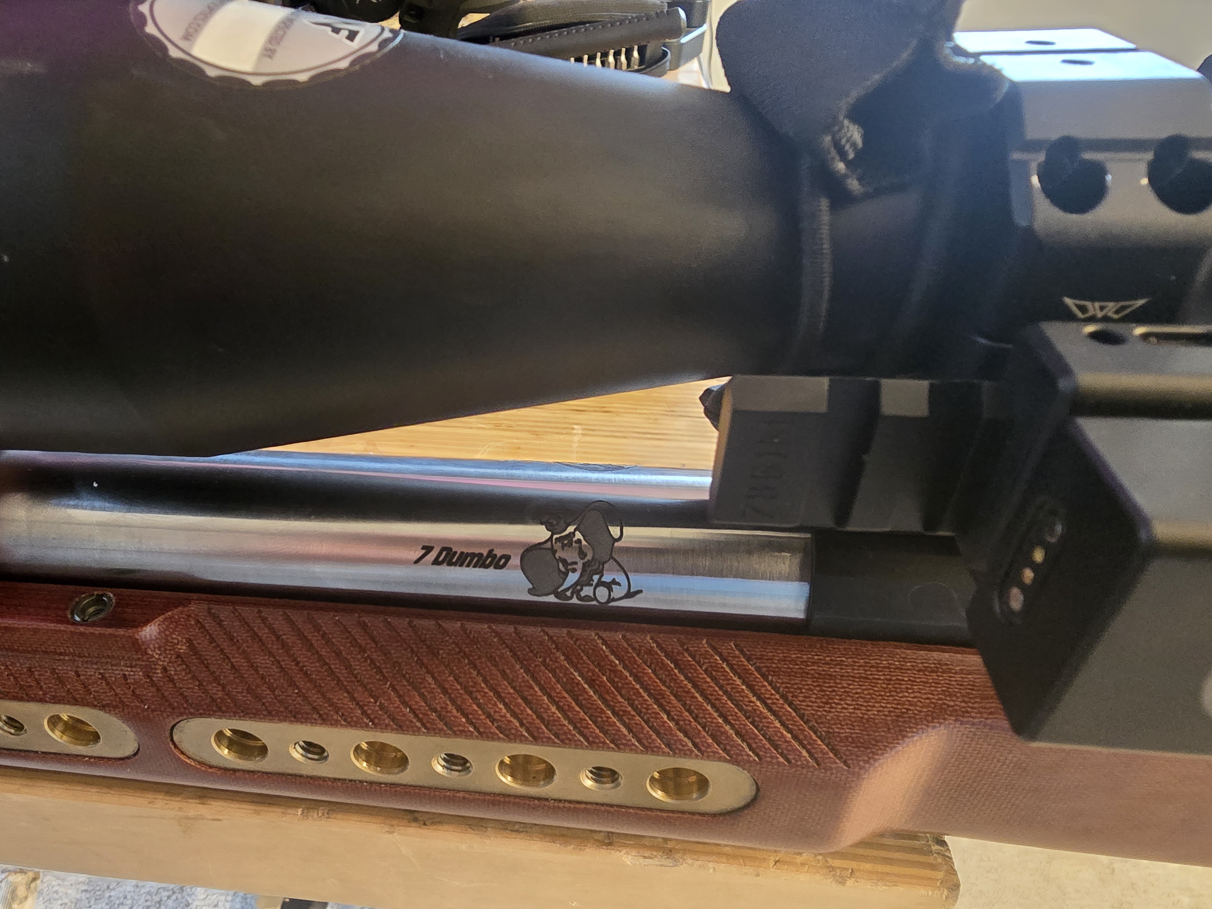

Hey guys, I got a wild hair brained idea about 6 months ago to neck the dasher up to 7mm, to be called the 7 Dumbo lol. Going into it with few expectations and viewing it as a experiment, hoping its a success.
I worked together with manson reamers to get a reamer built and sent it off the #620riflewerks to get the chambering done. (By the way he is a jam up gunsmith if somebody is looking for a guy to do your work with good turnaround time.) I opted to use a 8 twist crb comp barrel, finished at 28 inches.
I want to get it to shoot 2400+ with the 180+ bullets, preferably the 190 atip or 190 bergers. If it all works out I will certainly be shooting it in a few matches to see how it handles that vs the 22 dasher and 6 dasher that I normally use.
Follow this thread for updates!!!!

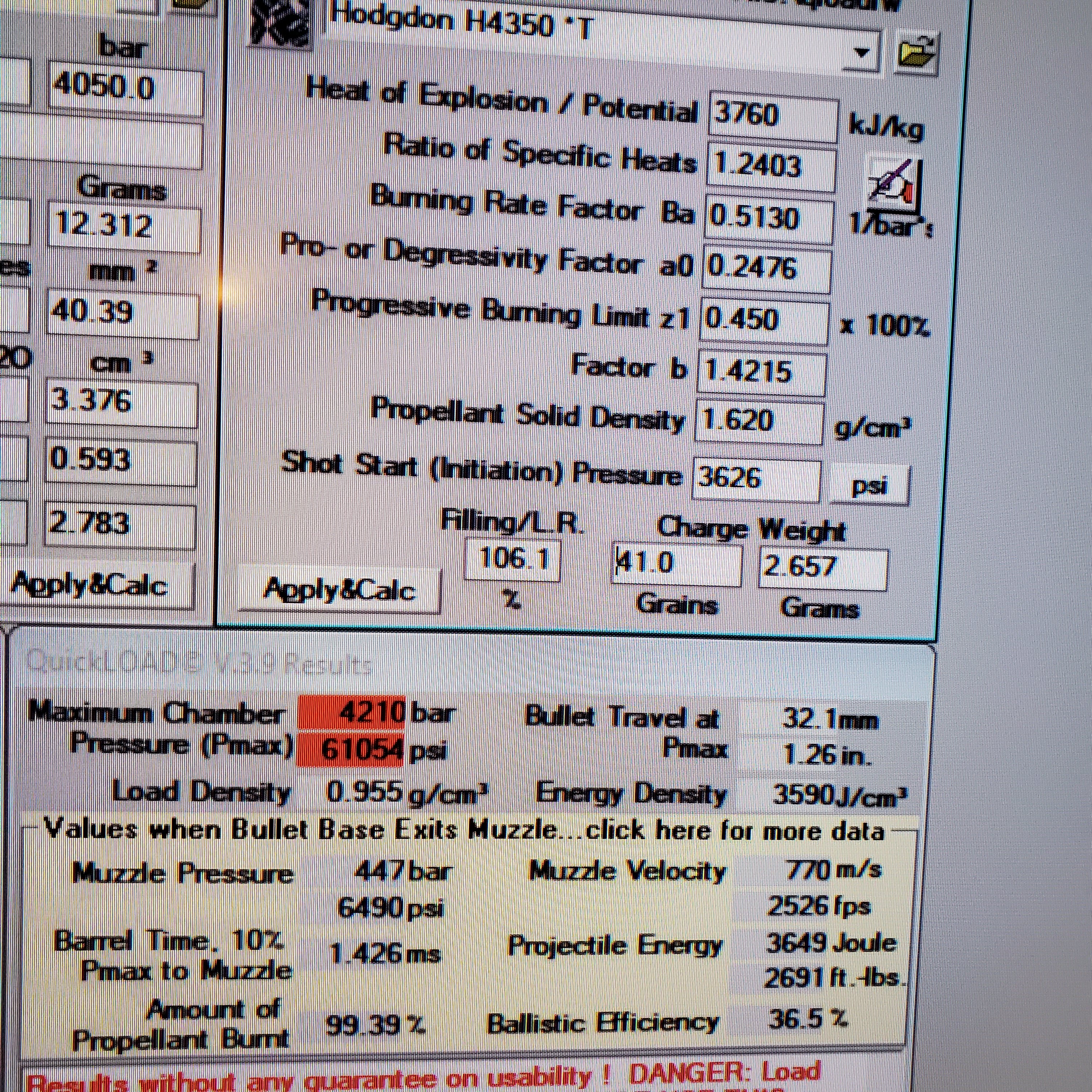

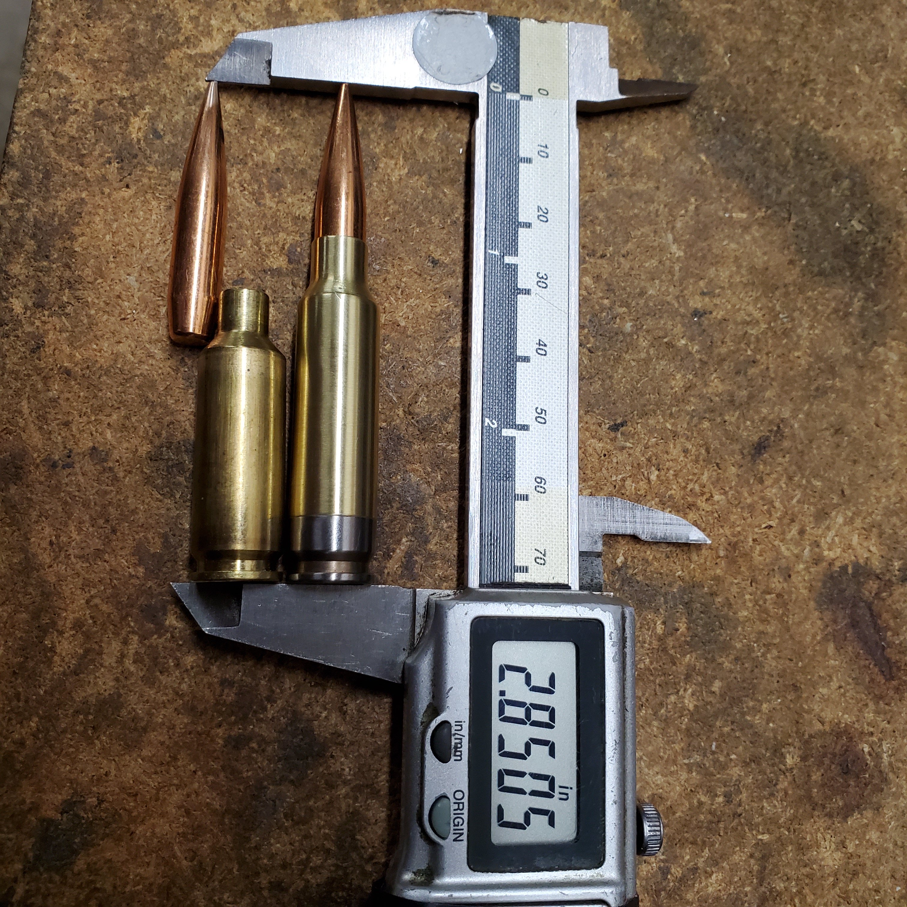

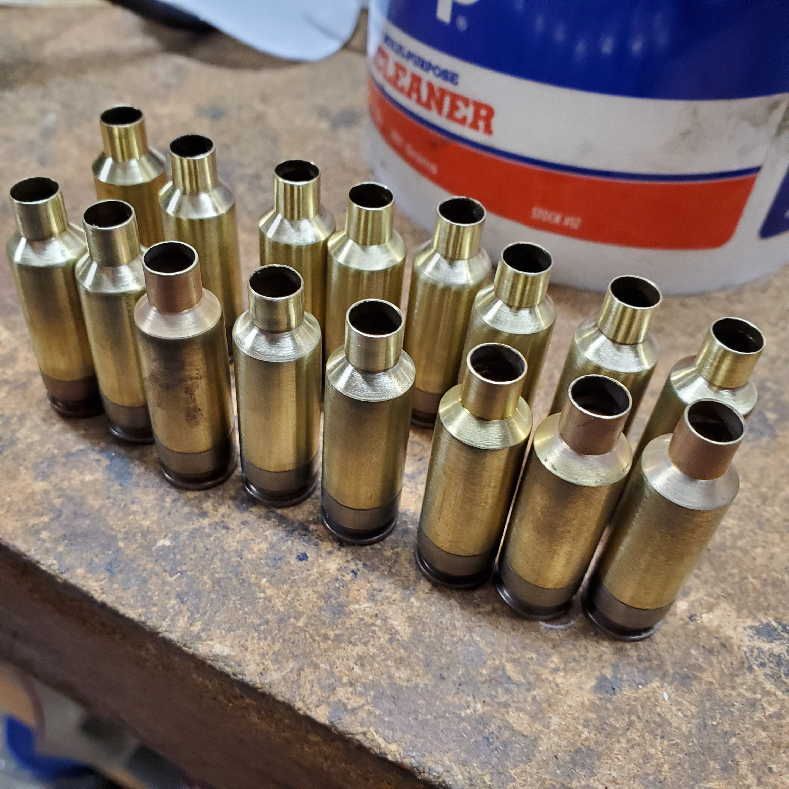

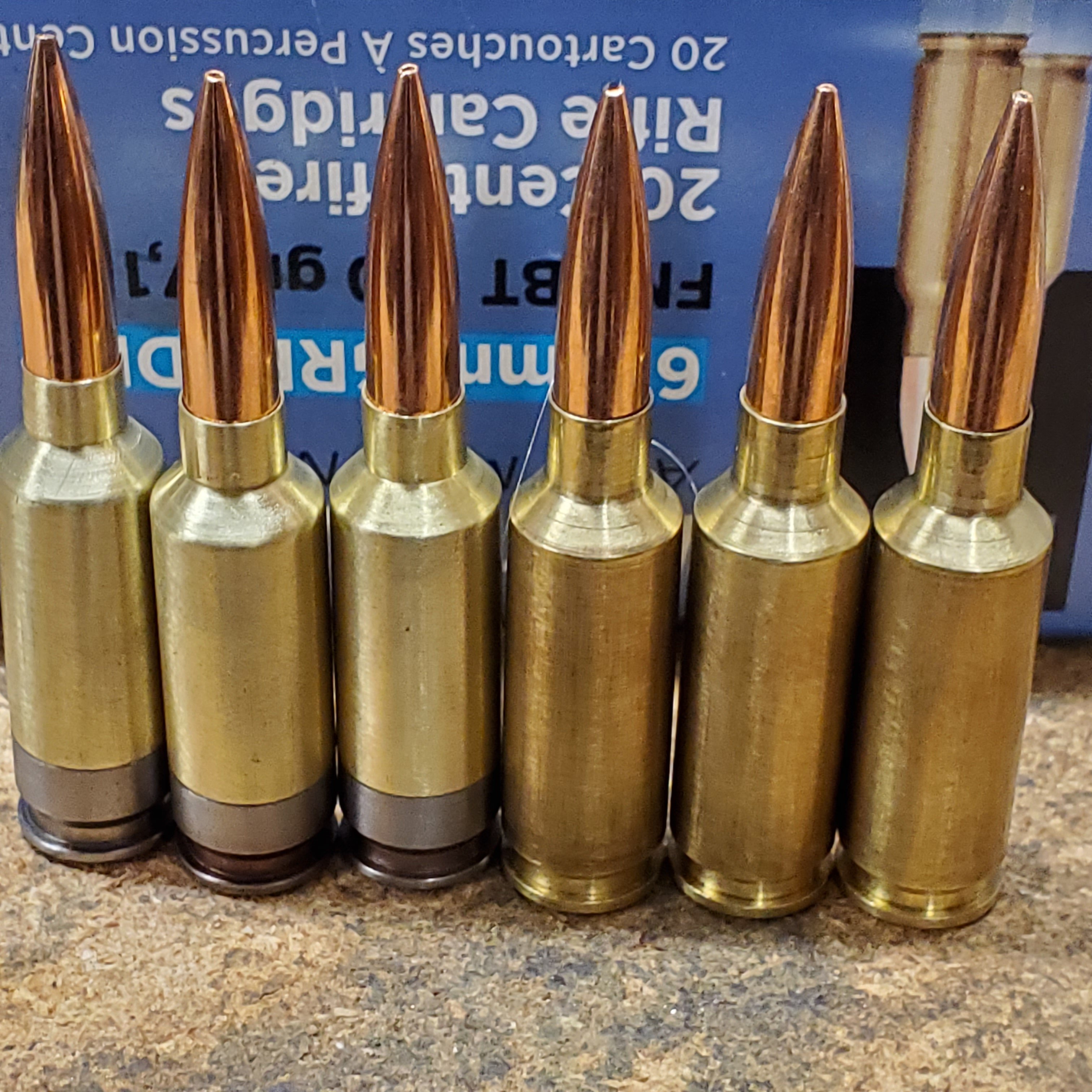

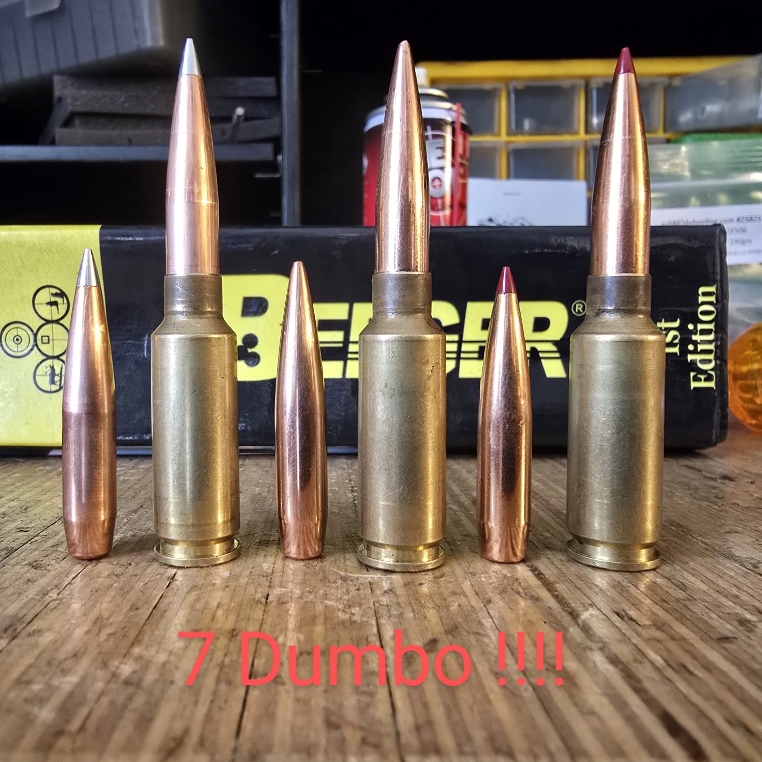

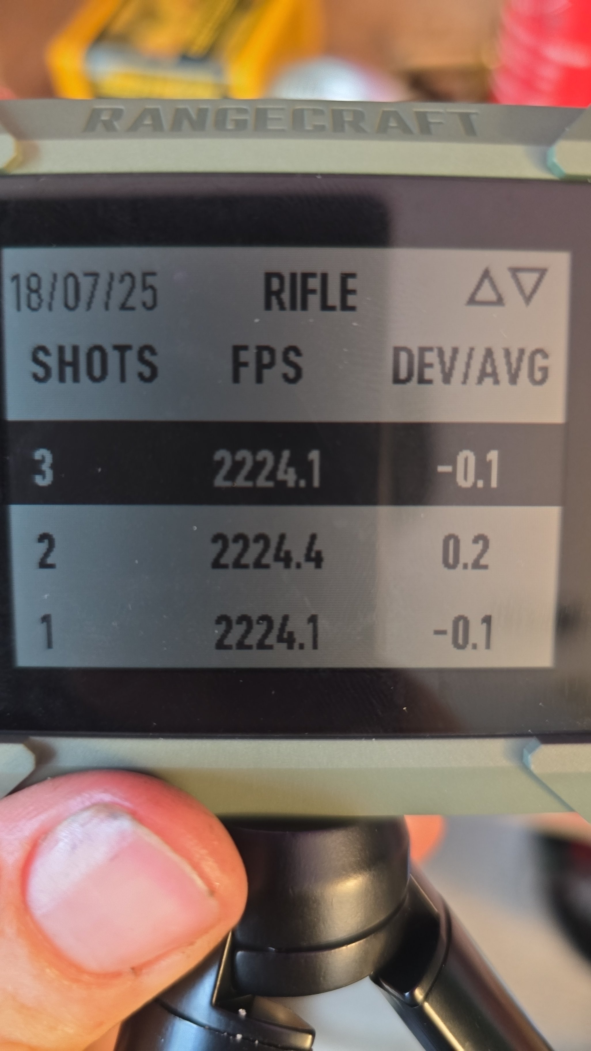

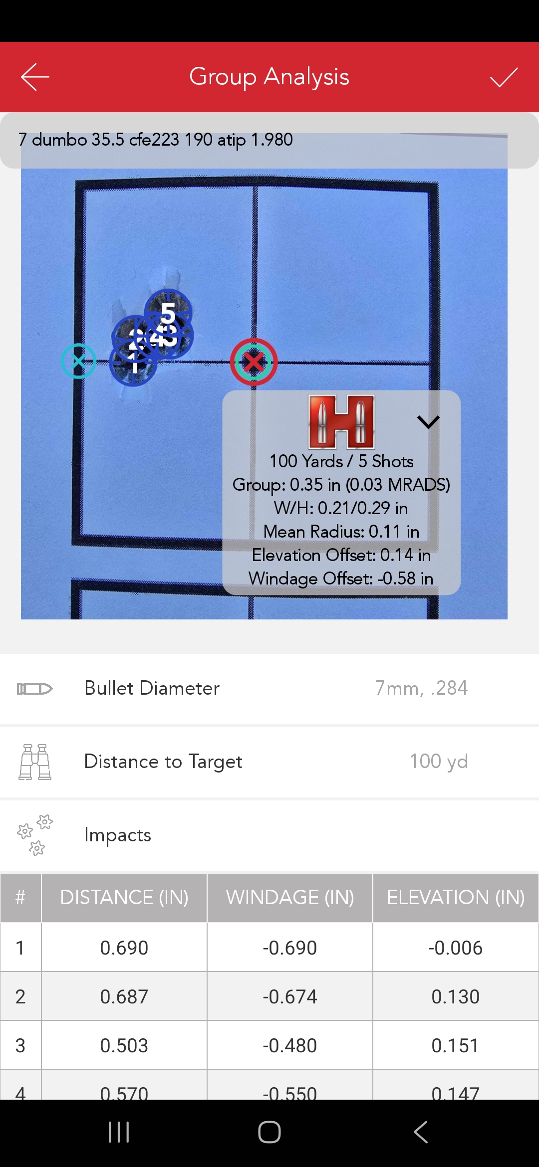

Here's a picture of some dummy rounds from when I was designing the reamer. Left to right, 190 atip, 190 berger, 180 eldm. I may end up shooting the 180 eldm yet.

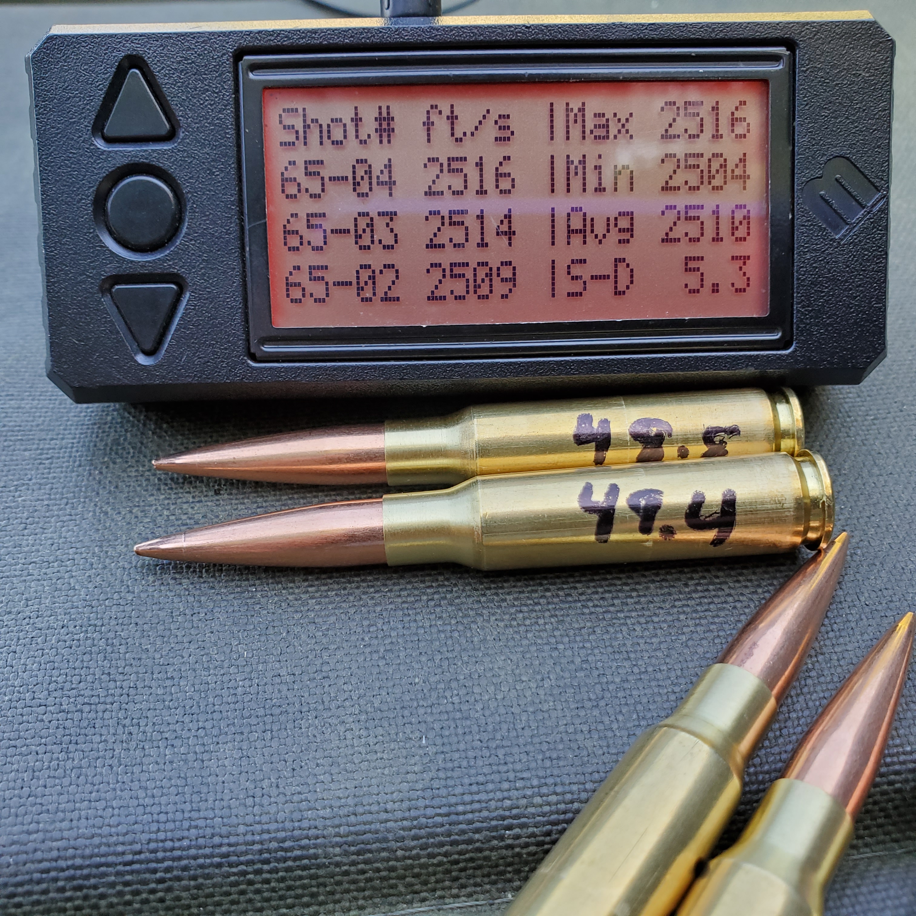

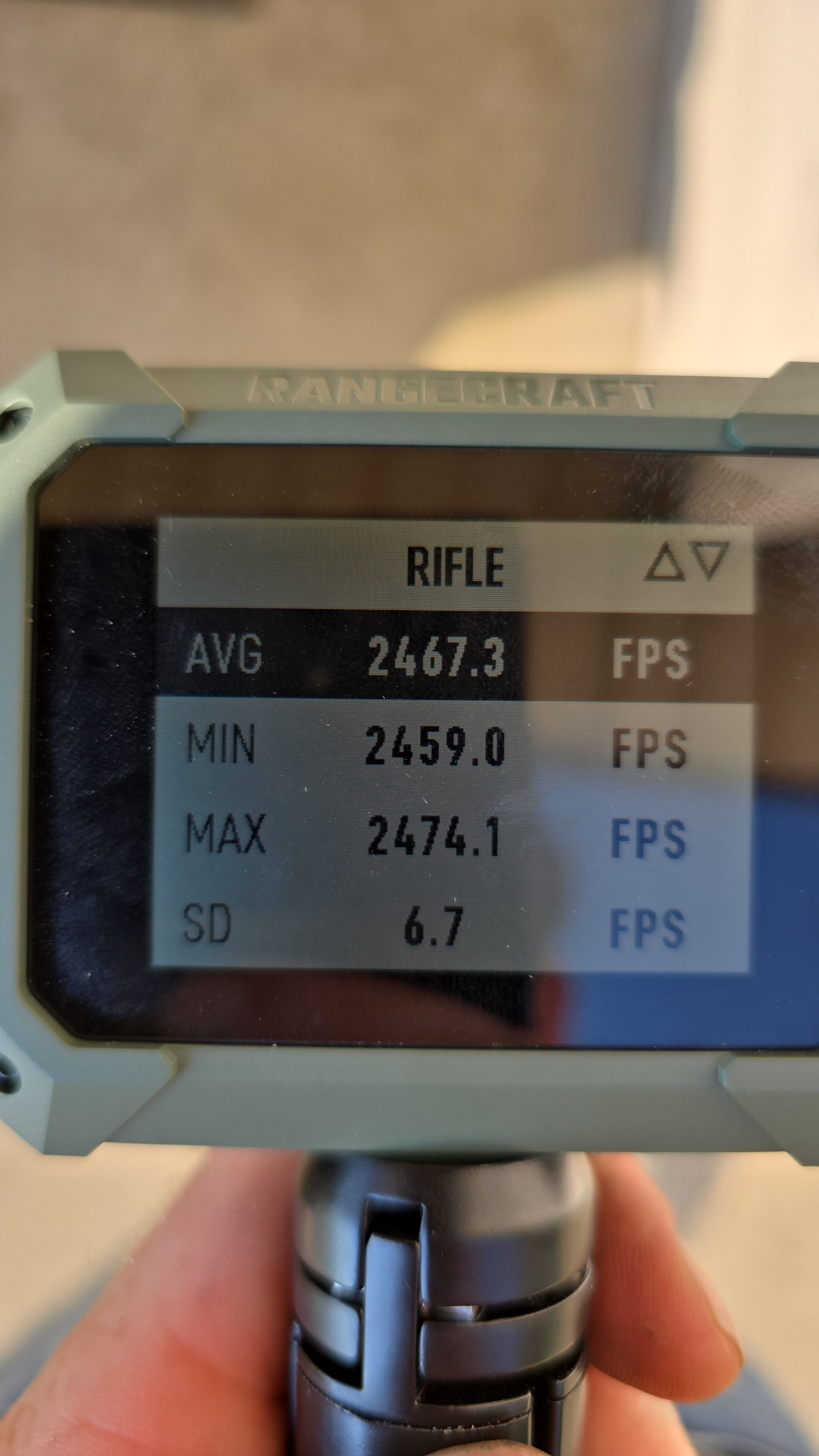

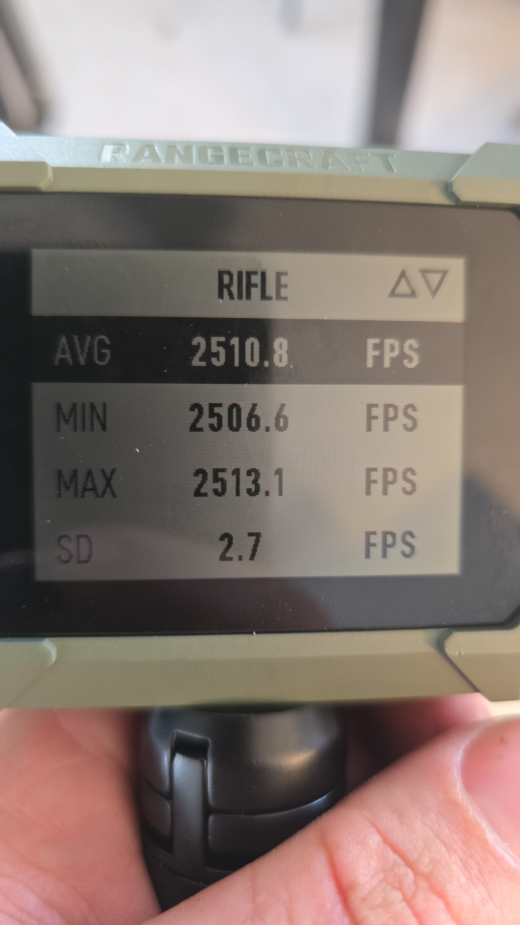

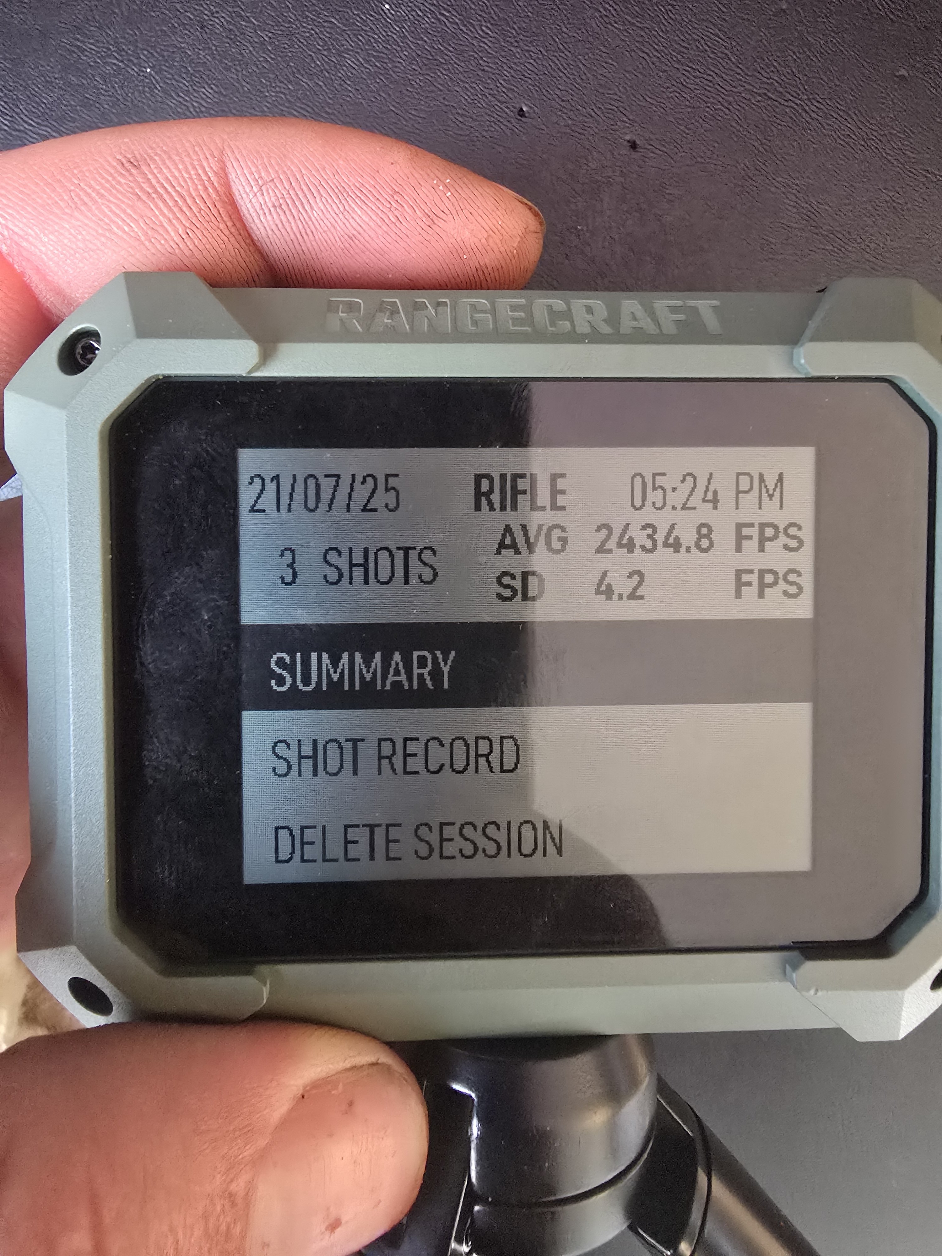

I have been working on finding max charges with multiple powders with atips while fireforming brass. Powders I have tried, 8208, cfe223, RL15, RL15.5, varget.
The 8208 velocity was lower then I wanted, cfe223 yields the highest velocity at 2510. I think h4895 might be the perfect powder for this but I dont have any at the moment.

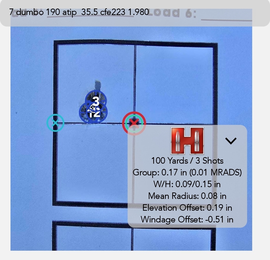

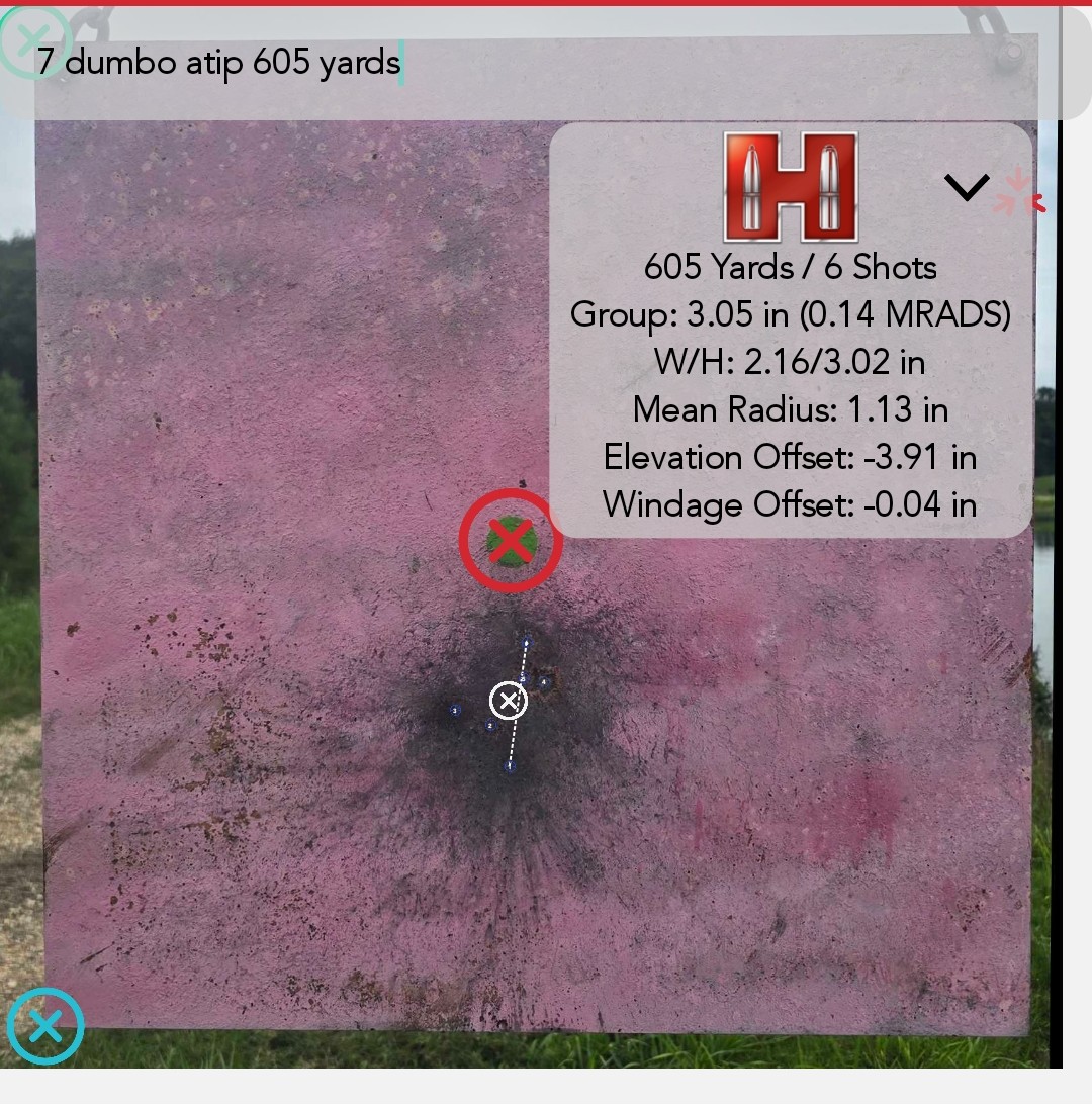

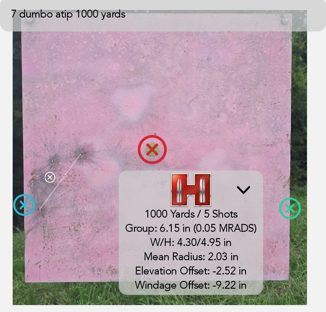

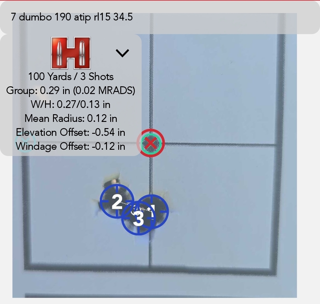

Rl 15 numbers, slight ejector mark if I use my imagination.

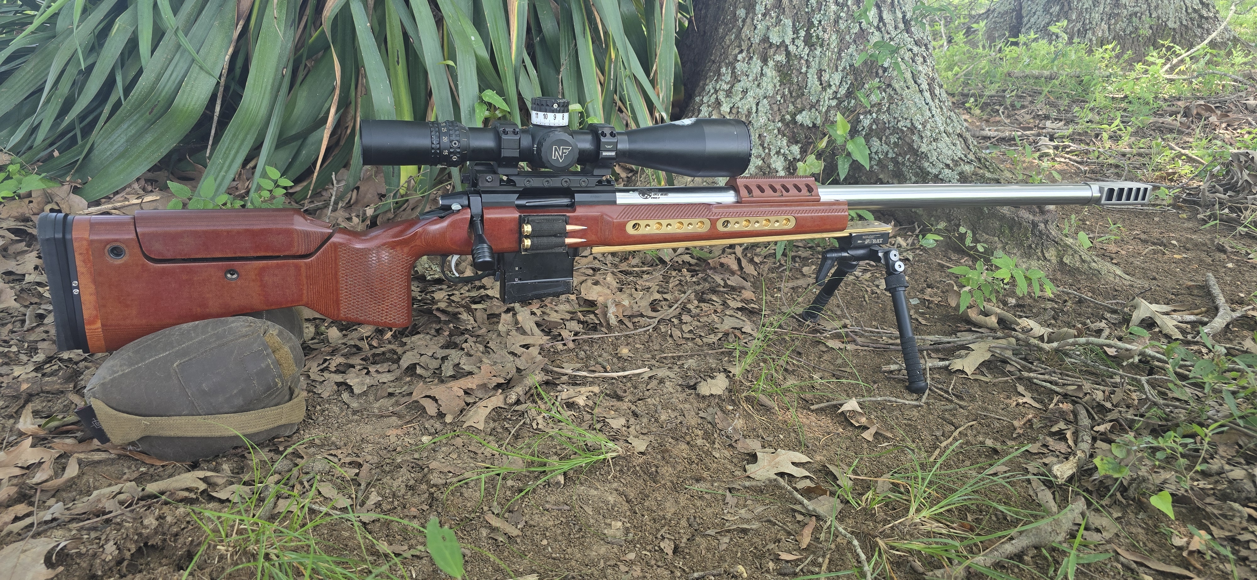

Sorry im not organized, I should have clarified the build earlier, so here it is.
Impact 737r
Foundation Samson
Crb comp 8 twist
Botnia maxi
Nf atacr 7-35
Bix'n and tacsport pro x, gator shoe
Warne precision mount
Sg pulse level

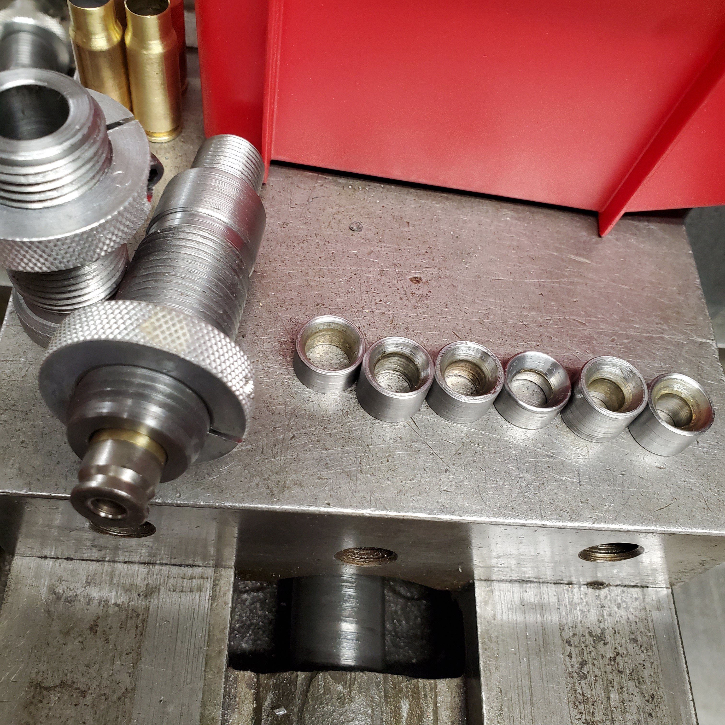

So one could improve the 7 dasher with hybrid cases where the brass isn't holding up at 2500 fps.
Here is some 6 dasher hybrid cases, 7 dasher would be easier. But it requires dies to produce...
There are alot of brass cases to choose from these days, if ya don't like hybrid cases.

It would have been much easier to have an investigative plan to meet your goals.
This is a hybrid case 1.870" 52 gr H20, you do not have to use hybrid cases to meet the goal of 2500 fps...but it does give you extra velocity in case ya want it. Run the 180 Berger 2400 to 2700 plus fps....lots of adjustment, to find an accuracy node.
Here you can use H4350 a very stable powder to drive the 190 Berger hybrid over 2500 fps 30° shoulder for easy feeding 2.850" to 2.900" with 308 mags of your choice.
I don't have the reamer but can easily make the cases.
Pictured the 6 dasher with 180 gr Berger VS the cut down and formed 6.8x51 hybrid case, also with 180 gr seated.
Plus QL prediction with the 190 gr Berger hybrid and H4350.
Just for information purposes, and what I meant about more case capacity making it easier, to beat the 6 dasher, with quality components, and lots of velocity adjustment.
Good luck with your 7 dasher.

Here is an update, got my new seating die in and it helped a lot, still had issues with concentricity tho. I opted to turn the necks and ended up having to take .0035 off of my overall loaded neck diameter to get material removed from around the whole neck. I guess the necking up really caused some thin spots in my necks. After all thet was done the rifle started shooting so much better and consistent from session to session. This is my load im gonna shoot for now.
Next im gonna take it to distance and see if this low velocity will still give me that amazing advertised bc for the 190s. Also i need to see how bad my temp sensitivity is gonna be with cfe223. Currently im quite excited about the results, just took longer then expected to get there.

Why not use 7mmBR brass and blow your shoulder out to dasher, but have 7mm necks already ?
I think that would be a great option. Im just using from my stockpile of used 6 dasher brass or what i had on hand from other rifles at the moment. I will probably buy new brass in the future specifically for the rifle. I will certainly consider that option.

Took it out to distance today, and it shot great.
Im curious if anybody else has experience with 190 atips? Looks like hornady is either overstating bc values on them or my bc is being compromised, could easily be a bit of both.
G1 published .836 trued .745
G7 published .422 trued .376
Maybe its a result of them being factory 2nd atips?
If indeed this is the bc I'll get out of them it makes total sense to drop down to a 180 or possibly lighter.
Hornady does overstate bc - on top of manufacturing mediocre bullets (Berger ftw). But bc is also a product of speed and moving significantly slower than what they tested bc at will cause it to be lower

Have you tried a 190lrht? At your low MV I think a 7.5tw would be best, I didn't look back at the twist you're using. I know in my slow 65s with 7.5tw, the 153.5 Bergers have shot really well at mv around 2600.
First you are shooting at a lower muzzle velocity, which automatically lowers the BC.
The BC assigned to a bullet varies all the time...it's not a constant.
Influenced by just about everything, bullet profile consistency, velocity, twist rate, atmospheric conditions, elevation, temperature, etc.
So you shoot the bullet at a known consistant as possible velocity... over a known distance with "your" range finder like 650 yds.
Adjust the BC value for your load, your rifle, your range finder... BC values are a constant variable
Then...as the bullet slows from the initial muzzle velocity the BC value drops off in a somewhat predictable manner for every yard it travels.
Shooting across a deep canyon the value of gravity and the value of time has suddenly changed for the bullet, but not for you.
Spot the impact and adjust.
If you can not see your impact at the shot increase the range to the target...time.
I did alot of cross canyon shooting...shoot a spot on a rock wall, similar distance as the target, at 1400 to 1500 you have over 2 seconds to get back in the scope, and make the spot...plenty of time...unless your windage is way off...turn down the power to get a larger field of view about 8X, and try again. You'll see it then a Cadillac and a half to the right...the wind in the canyon and the wind on the opposite rock wall are not so predictable, possibly opposite or tornado like swirling.
Helps if you visualize the wind as a water current coming down the canyon flowing right hitting a mountain barrier and swirling back to the left on your side, a lower mountain island 700 yds out in the middle causing an updraft.
Things are not as they seem.
As @Maurygold and @45-90 said, BC changes as velo changes, also I believe pressure / humidity change it a bit too (someone please correct me on that if I'm incorrect).
In a perfect world, BC on box would be spot on, however you trued your data, which is awesome.
I also noticed your 1000yd group is better than your 605yd group. People group better at distance because the proj has to "go to sleep".
