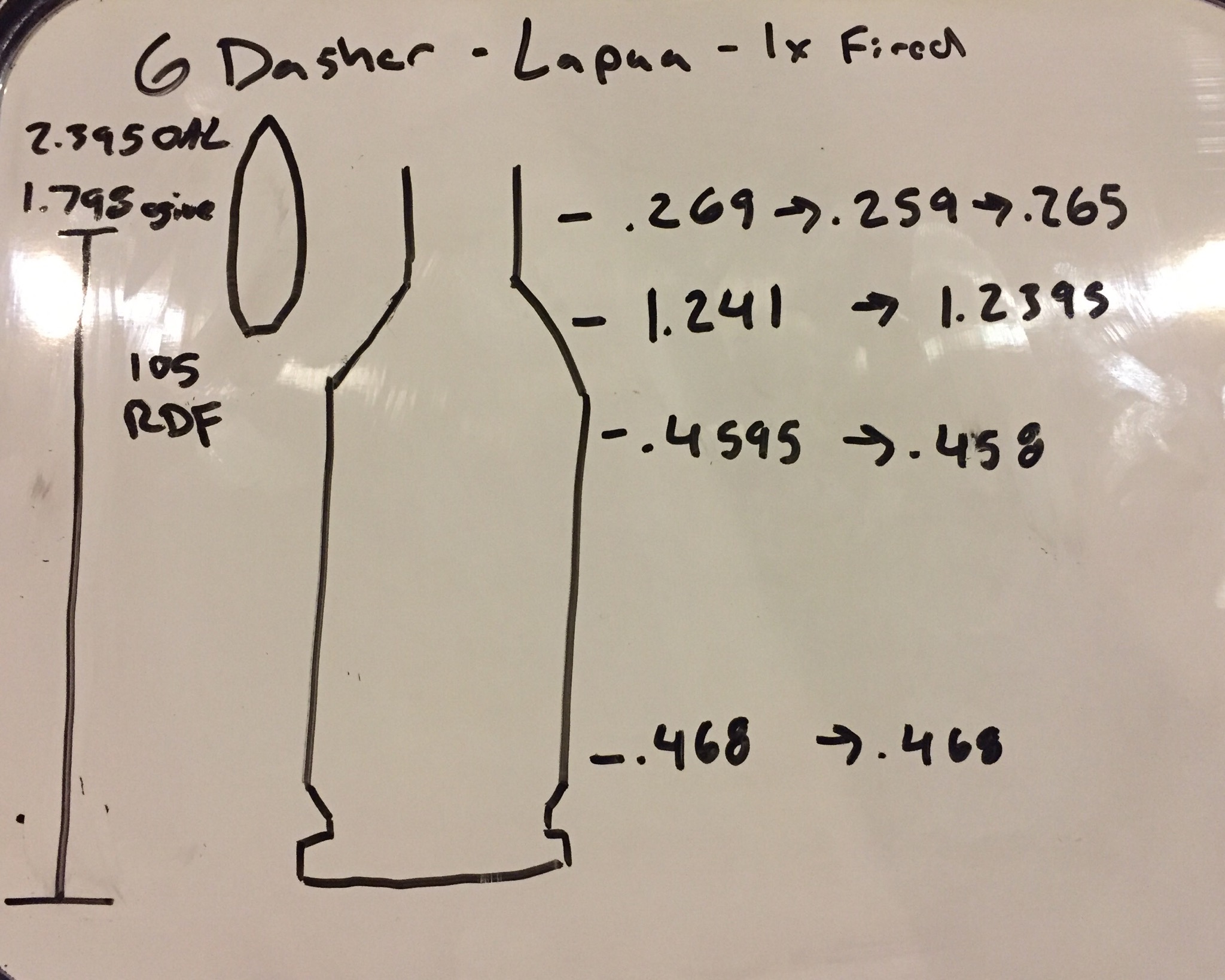

You still haven’t provided us with one single measurement yet.
Measure your damn brass and see what’s going on for yourself.
And then report back to us with your findings.
Something like this, fired dimensions on the left, sized on the right.
7087730
