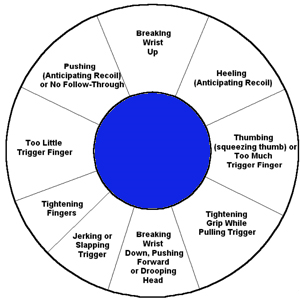

When I shoot low left,
  1. I was dipping - At the moment of firing, I push the gun forward and the muzzle dips. Usually happens during the first few pistol sessions in the spring. Overly sensitive to recoil.
  2. my strong hand was not far enough around the gun so my trigger finger was pushing on the right side of the trigger
Everybody is different so I am probably doing what the chart says, too.
Since you're used to shooting a block, er, Glock, you may be using too much or too little finger on the trigger in combination with gripping too hard. That will cause a low-left impact.

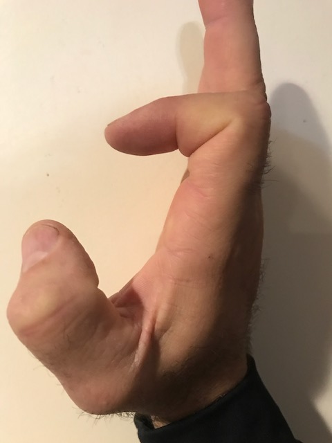

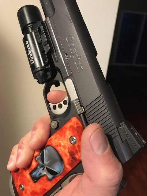

He is a lesson in gripping the pistol that I give shooters to help with their accuracy and precision.
Hopefully this will help you, I used to shoot 25-35K rounds a year and it was the one thing that I always kept in the forefront on my training sessions.
IMG_1166.JPG Hold your finger at 90 degrees with your wrist straight and elbow down out if front of your body.

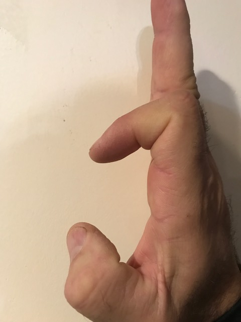

IMG_1167.JPG You will see that when you do pull your trigger the result is a angled pull which results in a lower left hit. If you are doing the same trigger pull on a a rifle it is effected less due to the extra weight.

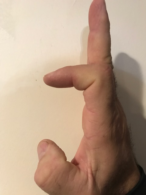

IMG_1168.JPG Now try the same with a slight bend in your wrist.
IMG_1169.JPG The bend in your wrist is necessary to give you the "more" correct angle to have the trigger come back clean. As you grab your gun, do everything the same but angle your wrist out about 10-20 degrees, it makes a huge difference in the angle of your trigger finger.

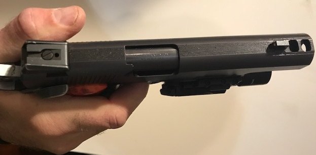

IMG_1170.JPG For me I only have the pad of my finger on the trigger, I see others all the way through due to hand size. The important aspect is to have your finger coming back at the correct angle.

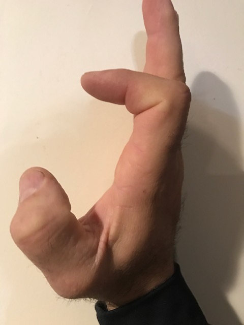

IMG_1172.JPG The most important part of the trigger is maintaining the correct angle of the wrist/finger. As you shooters adjust their grip when learning something new they tend to go backwards. To see if your wrist/finger is in the right position, look a small gap in between your finger and the gun. Whether I am shooting long range or pistol I try to maintain this gap. It also allows you feel the trigger break better without resistance.
Jerry Miculek would build his grips up at this area to maintain that position since the revolvers had a heavier pull. Try it and see if it helps your groups.
