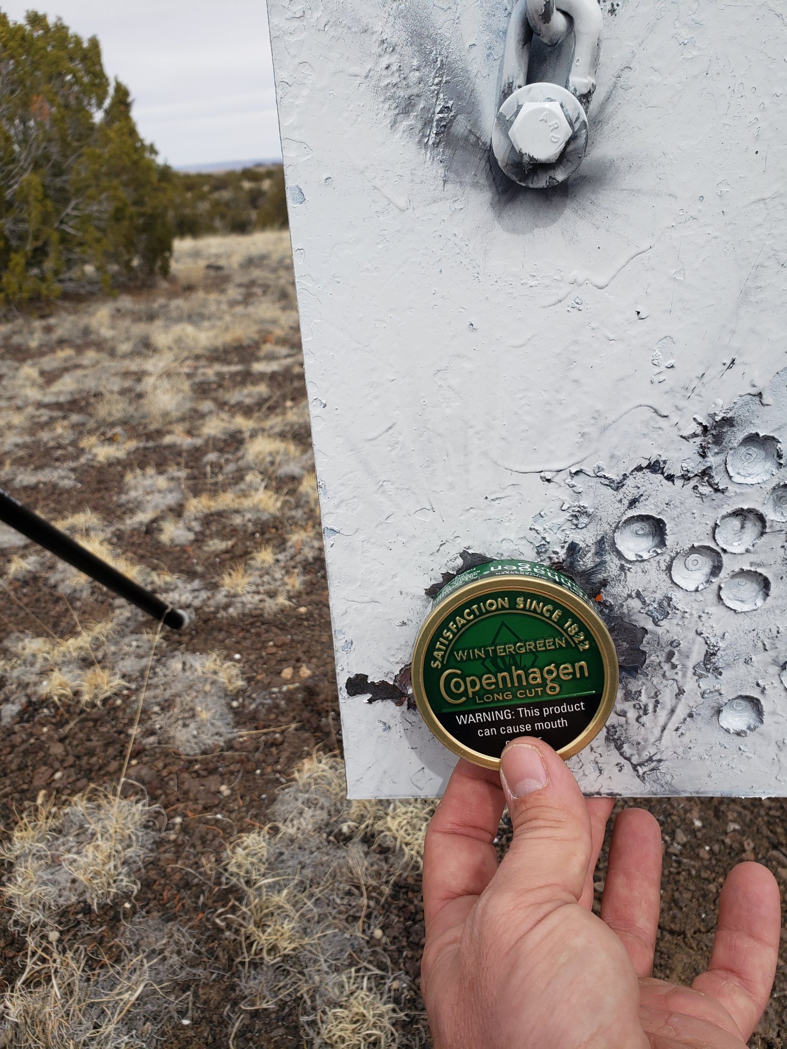

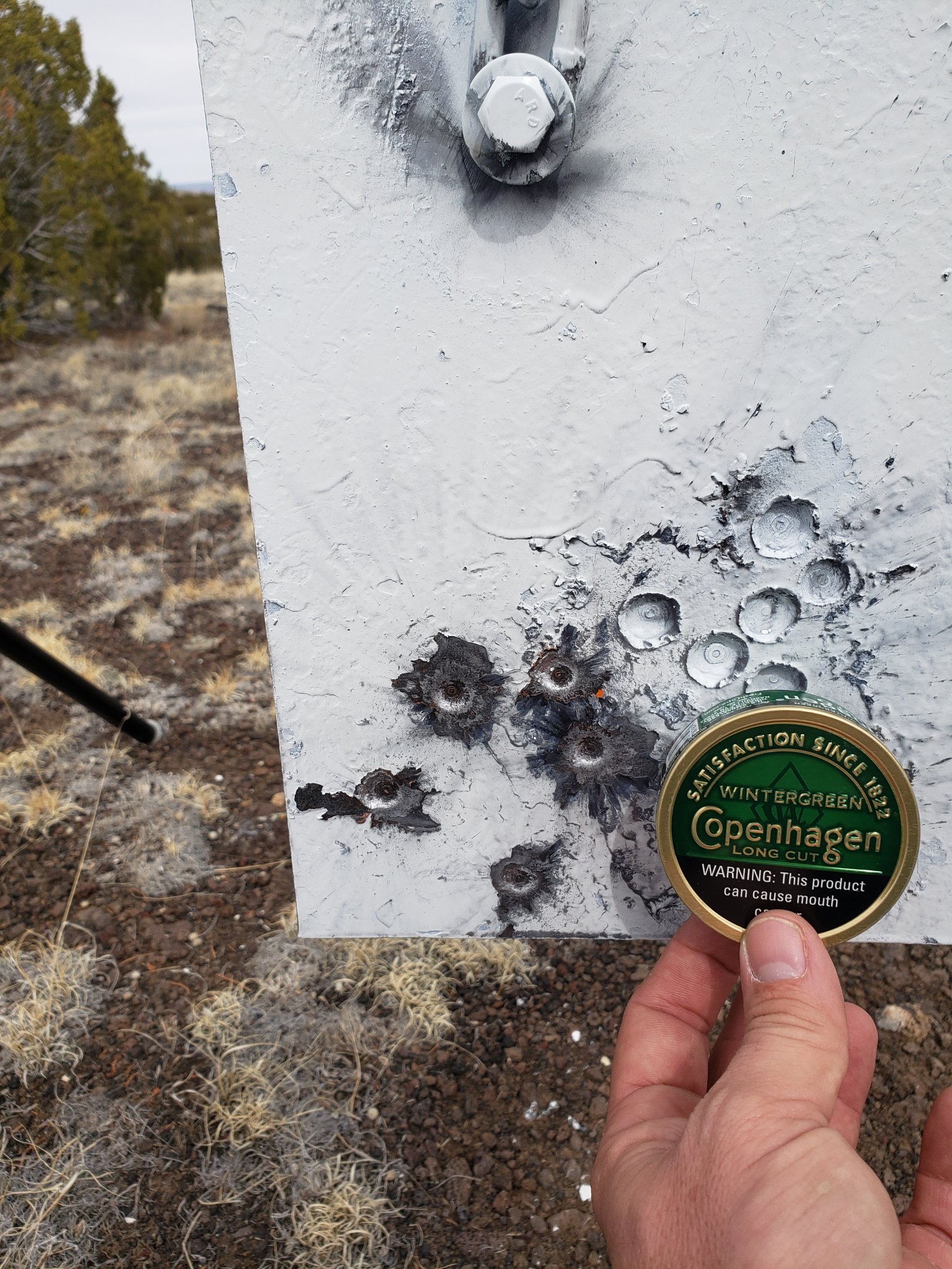

I have a 6.5cm that shoots well with h4350, but shoots incredibly with RL16. It’s shoots the 147 eldm about as well as I can hope for. This is a five shot group from 1005 yards. It’s nothing more than a buds guns scratch and dent Howa hcr. It took a while to get the load, but I’ve won prs matches with it.
I also have a 7 saum that shoots the 175 eldx equally as well. Here’s a group at 1501 yards. It’s just a budget light weight hunting rifle tikka t3 build. Nothing special.
I wouldn’t say they’re the easiest or best bullet out there, but they will shoot if you spend some time with them.
6.5cm 1005 yards
