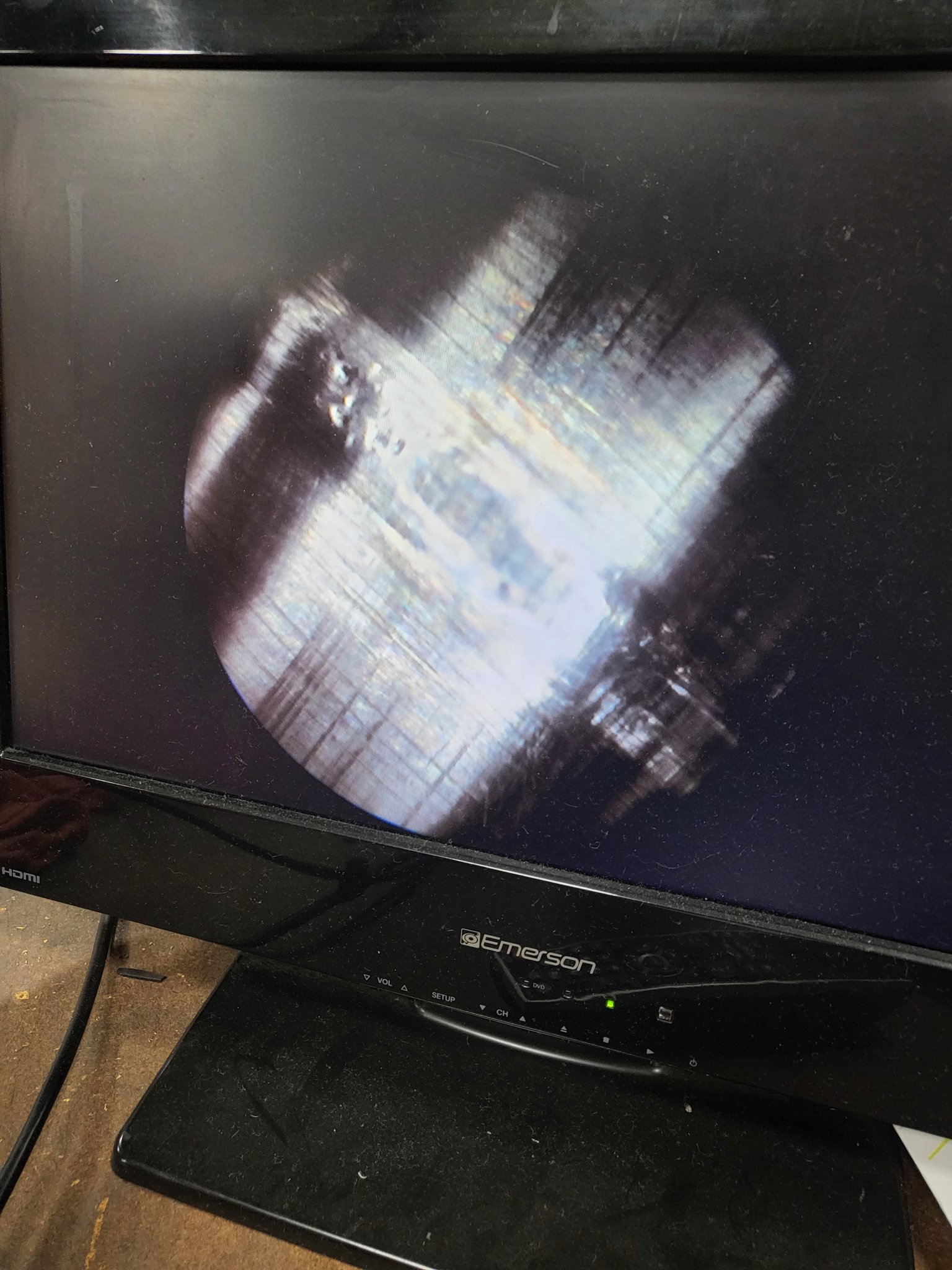

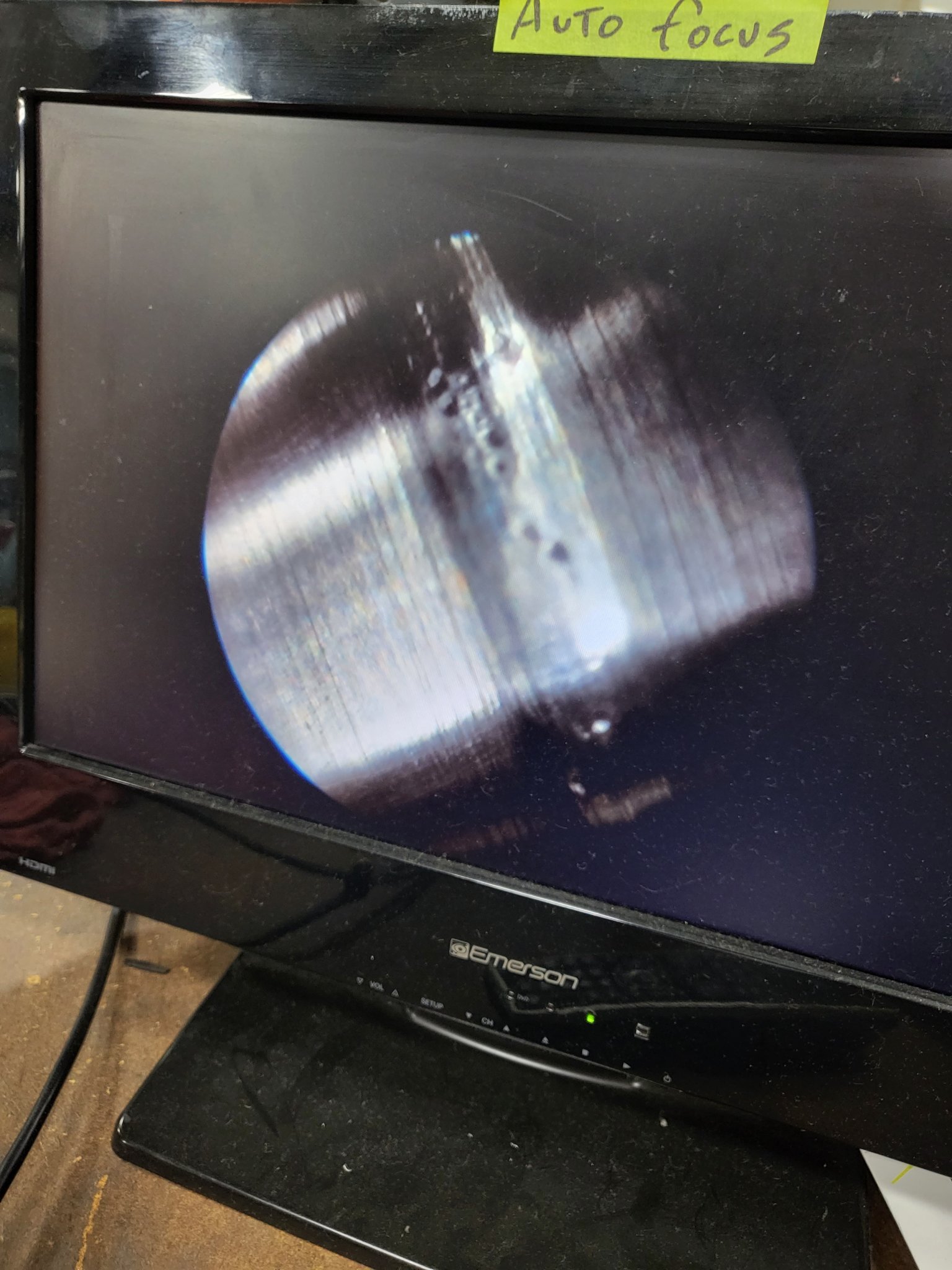

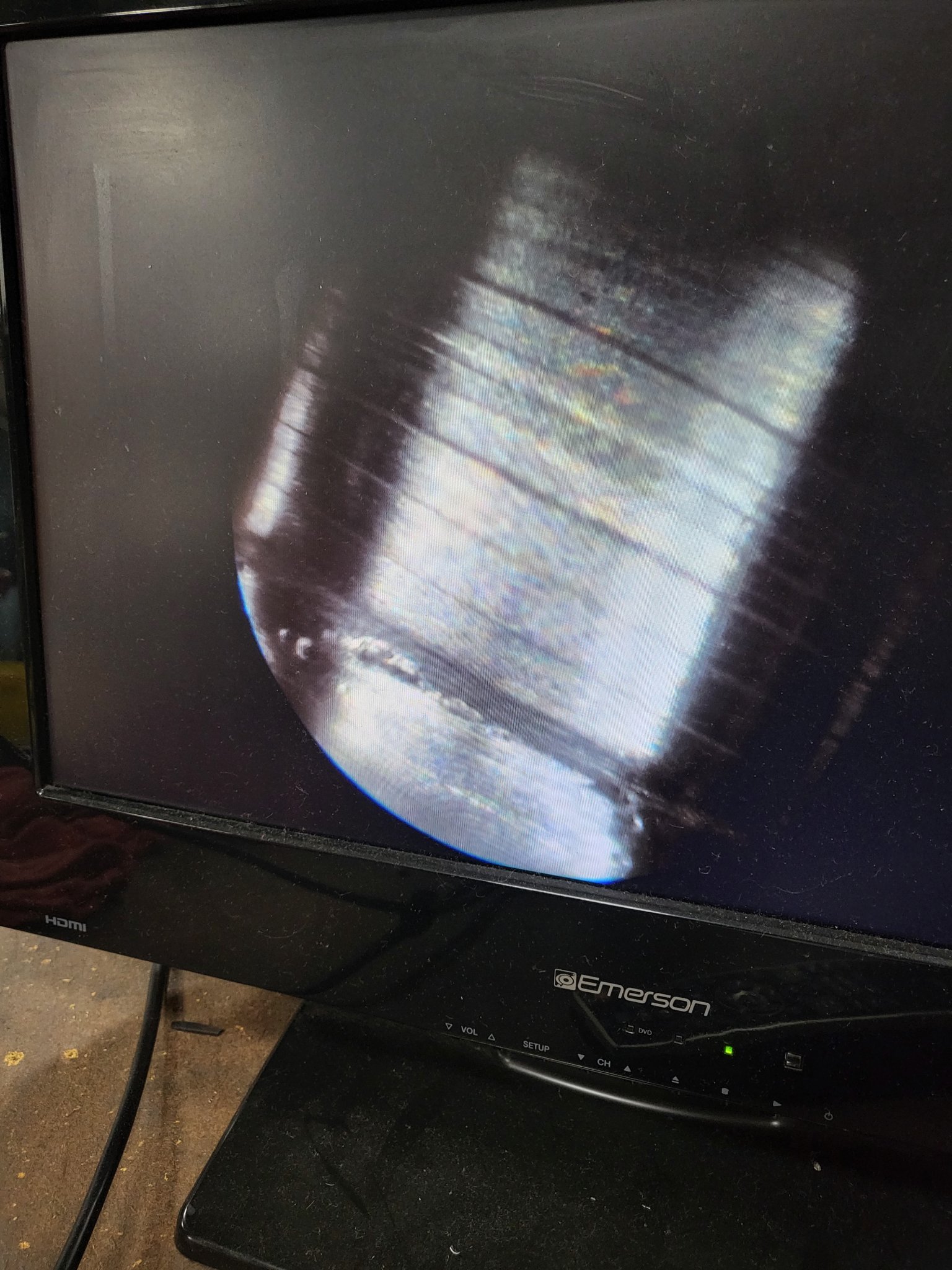

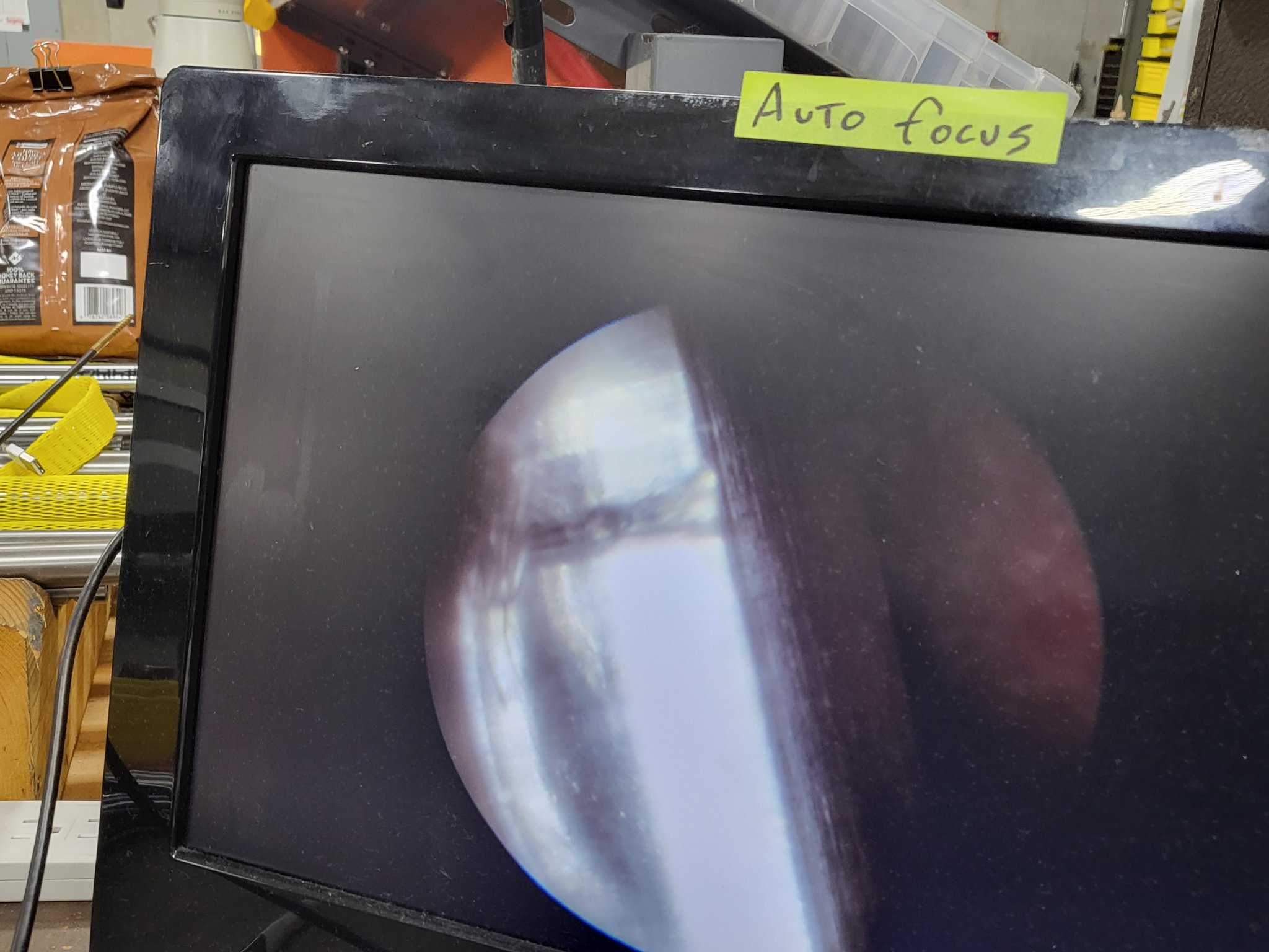

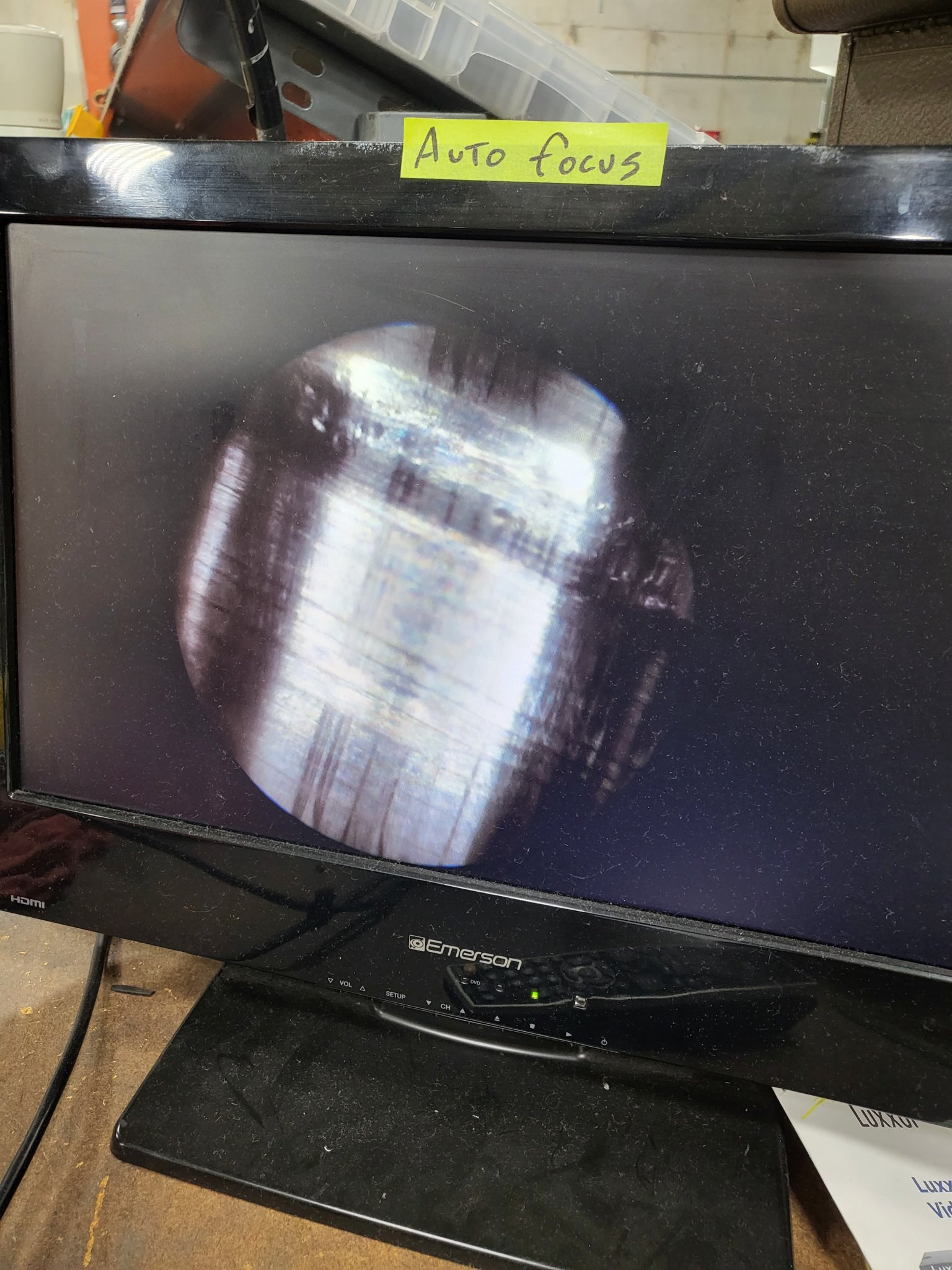

Guys..... This has been beaten to death but you have to watch how your using abrasive cleaners! Here is a 223 barrel with 800 rounds on it. Cleaned after every 75 rounds fired. I know the pitting is from a chemical reaction but I didn't get the whole story. It was cleaned approximately 10-12 times from what the shooter told us.
What I did get was the shooter was using ThorroClean. This is a cleaner made and mixed with Iosso Bore Paste! So sum it up how ever you want.... it's an abrasive cleaner. The lands and bore are completely damaged. The lands are all rounded over, damage to the muzzles crown as well as polished and rounded over. In the first 2" of the barrel from the chamber a brush with the cleaner was run either by hand or with a drill on it. You can see the drag marks going over the tops of the lands and down in the grooves. This isn't from when the barrel got made. My guess is the shooter was worried about the carbon ring build up in the throat. Also notice the gouges running down the bore on tops of the lands and grooves.
Watch what your doing please.

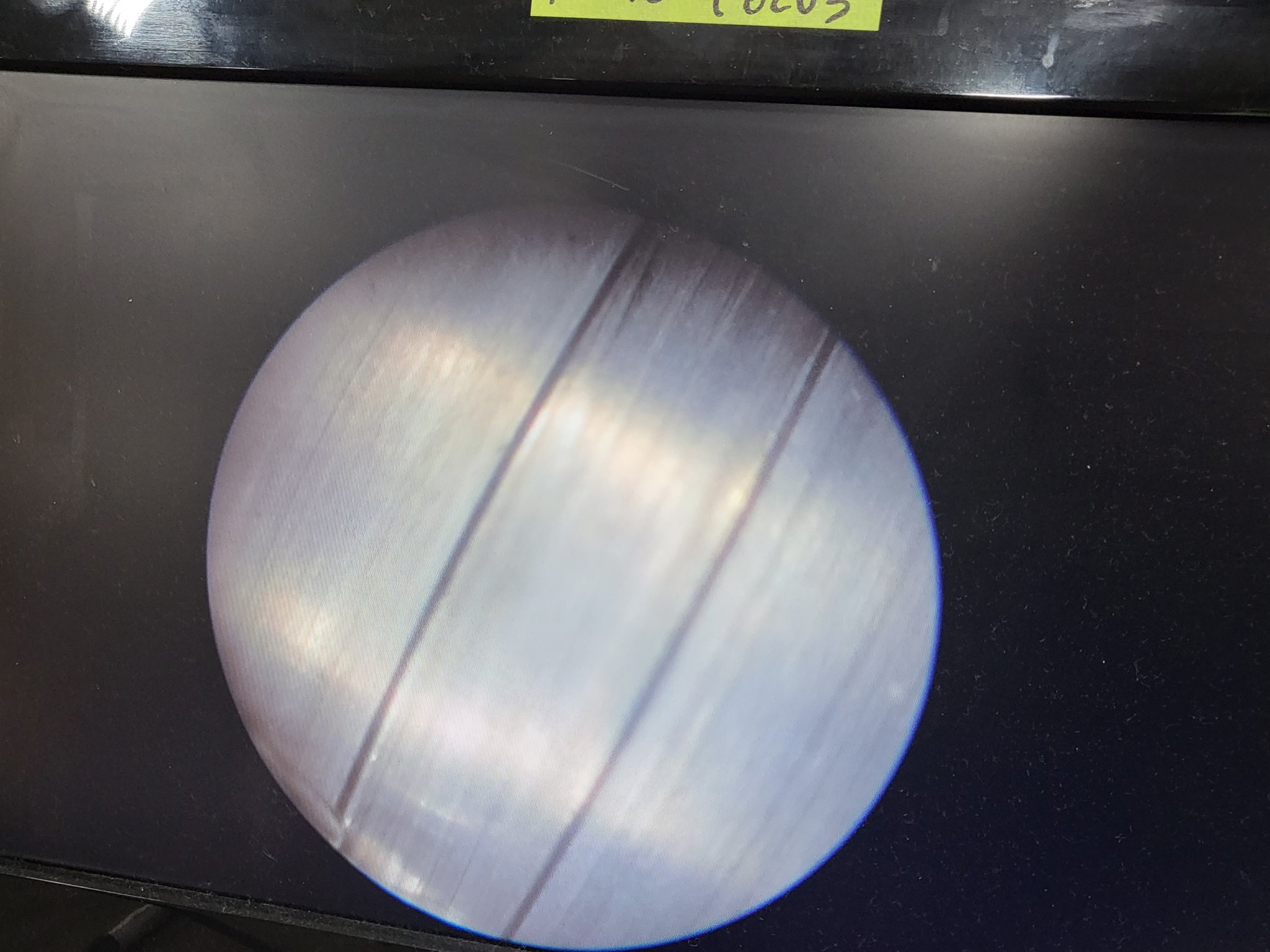

The last picture for a reference for comparison is also a 223 Remington barrel. This was a accuracy test barrel I got back from the bullet maker. It quite shooting at 14,000 rounds! Up to that point it held .5moa or better at 200 yards. This is a saami spec. 6 groove barrel (not 5R rifling). Only one guy in the ballistic lab is allowed to clean the barrel with JB bore compound when they start getting a carbon ring built up. They only use the JB when the need is felt to use it. For an approximate number of cleanings on the accuracy test barrel it got cleaned 140 to 200 times.
Later, Frank
Bartlein Barrels
here is the accuracy test barrel with 14k on it....
Later, Frank
Bartlein Barrels
Thanks for taking the time to once again post on this subject.
Question....where in the test barrel was that last pic taken? No fire cracking, no carbon, no copper wash (well, maybe a tiny bit). That sucker is clean.
May I assume that this is well down the barrel toward the muzzle?
I only ask because some may take this as an example of proper end state of cleaning from end to end and I personally would hesitate to work on a barrel enough to get it that clean anywhere near the chamber.
Am I being silly?

The picture of the test barrel is the center section of the bore basically. It's in the as I received it state from the bullet maker. It's dirty and hasn't been cleaned. Yes the throat has the normal fire cracking etc..
The reason I took the picture of the center of the barrel is to show that there is no damage from cleaning at all to the lands or the grooves after a 140+ times of cleaning it. Goes back to paying attention to what you are doing and how your doing it.

How were you able to isolate the fault to use of BT product and not some other dumb shit stuff the gun owner may have done?
As for water based….well, that is why we dry patch them, right. Haha
And I live in Maryland which is as humid as it gets. No issues with it.
Were these CM or SS?
Haha…as for bore scopes and just put a new barrel when you think it’s not grouping… well, one of us owns a barrel company and…well, you know! Lol
The BT products and corrosion.... again I/we can't nail it down. Just seen a pattern with primarily that cleaner and guys with pitted/corroded barrels. Is it every month? No. I say we see like 3-4 a year but it's mostly just that one it seems like. Again we can't replicate what each guy is doing.
My only guess is it's the left over moisture from the cleaner that is reacting with the fouling as some think they got the barrel really clean and that they cleaned it down to bare metal but I'll tell ya.... there is still some fouling left in the bore. The other possibility is that after a guy dry patches it... he doesn't run a oiled patch down the bore to protect it.
Every one we've seen has been SS barrels. I think it's just luck of the draw as that is like 98% of what we make now. Yes we still do CM but very little of it anymore.
Good one on the last comment! But we don't just throw a new one on.... Good example was Dave in the shop here last year. Was at a match with his 6.5PRC and he blew up a bullet. Asked me to look at the barrel. It had right around 900 rounds on it at the time. He said what do you think? I said it's carbon fouled really bad. Clean it good. So he did. Still had some really stubborn carbon build up in it that he couldn't get out. I told him to give the barrel a light finish lap and will look at it again. That took like 95% of it out. Gun went right back to shooting and no bullet failures. He just pulled the barrel recently. Think it is around 1200 rounds. It's still shooting good but it's on it's last legs and he's now pulled it.
