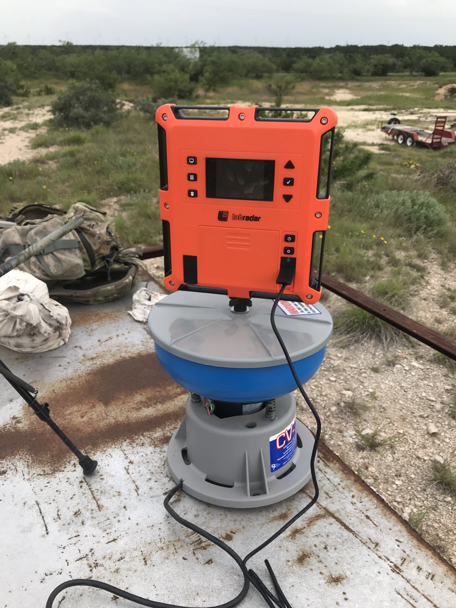

I was at my father and laws house and he had a Dillon vibratory case cleaner, which the screw that holds the lid was the correct size for the labradar so I decided to try it but knew aiming was gonna be a pain and probably would have trouble.
Well I used the notch to aim it at a target at 100 yds. If it didn’t pick up the shots I wasn’t too worried because I was just really trying it out and this was my varmint gun shooting factory ammo, so I wasn’t trying to collect any data.
First shot, read 3100 FPS and every shot I took, it picked up perfectly. Was using the trigger for activation. So using a less than ideal setup and factory aiming notch I was able to get the unit to pick up with only about 1-2 minute of set up time.
This is only one time using it but the issue that had me the most worried about using it was a non-issue. It should be even much less of an issue when I have the PVA tripod and RRS leveling head setup in hand. I wanted to write this because I have seen countless threads and YouTube videos about how the labradar is a piece of junk because you can’t aim it and it won’t pick up shots, yes they should have a better way to aim it but for me it was not an issue. Hopefully my opinion stays the same, I will update the thread when I get to use it more which should be soon because I have two rifles coming back from the smith soon with two barrels each in 6.5cm and 22cm to do load work up on.

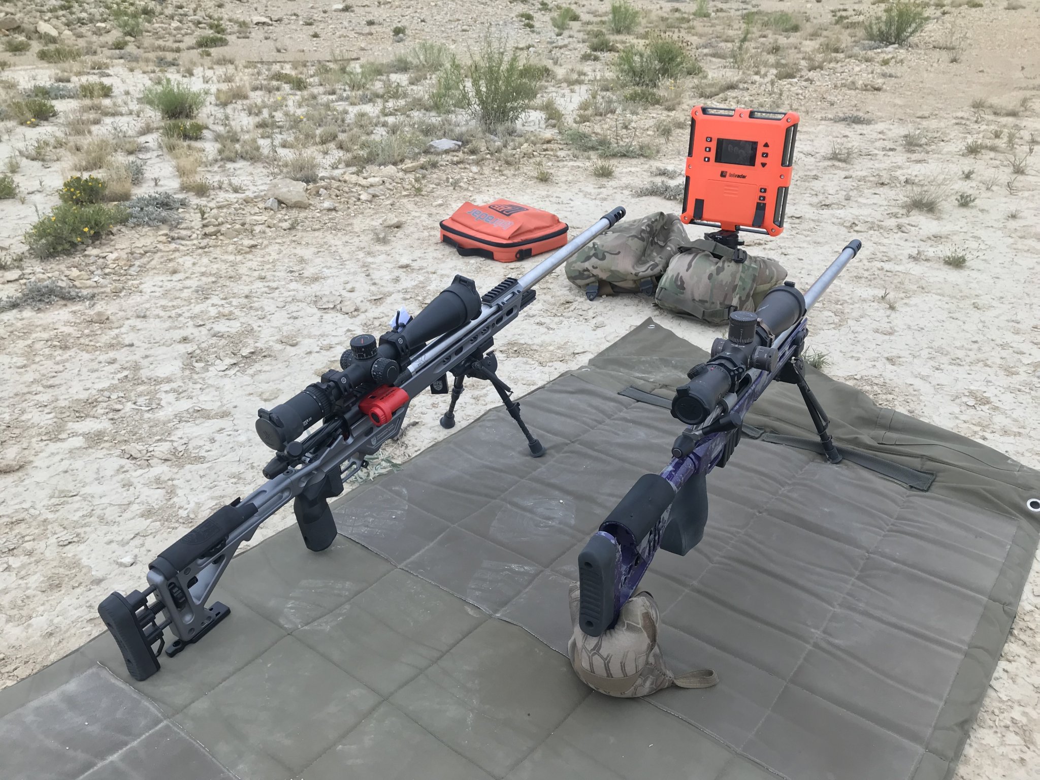

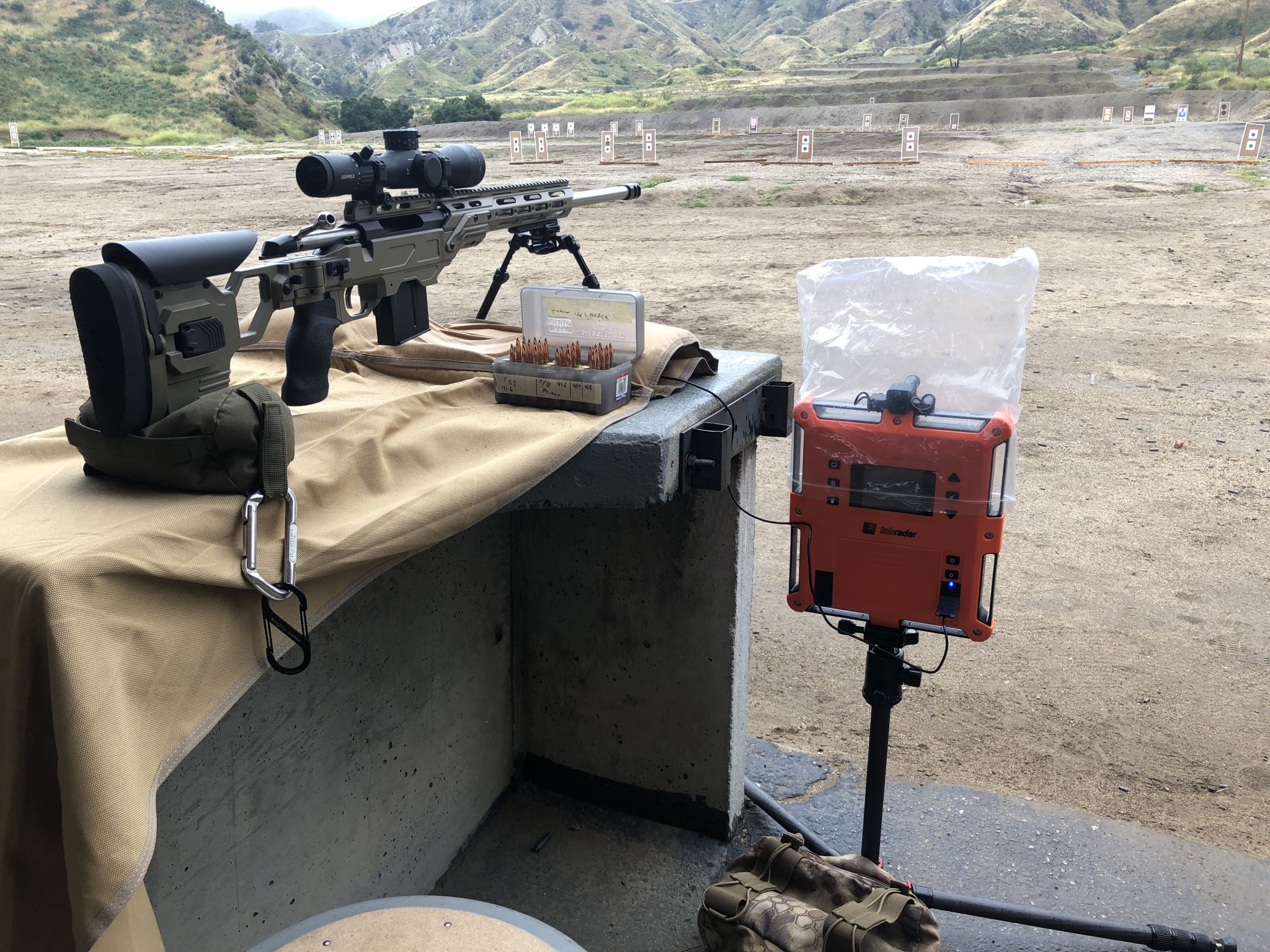

@DevilDocAZ definitely not a feature and definitely a “rig job”. I bought the labradar thinking I would have the tripod in hand at the same time, I didn’t and my patience was limited. I had a new toy and I wanted to try it and could not think of another way.
The reason that I am posting the picture is everyone who says that labradar sucks says it’s because you can’t aim it or get it to activate or that you magically drop it and break it all the time. I’m using a complete joke of a set up with the factory aiming notch and had zero issues aiming it. Yes, the way you aim it could use some improvement but the error in aiming is user error and not product error in my opinion.

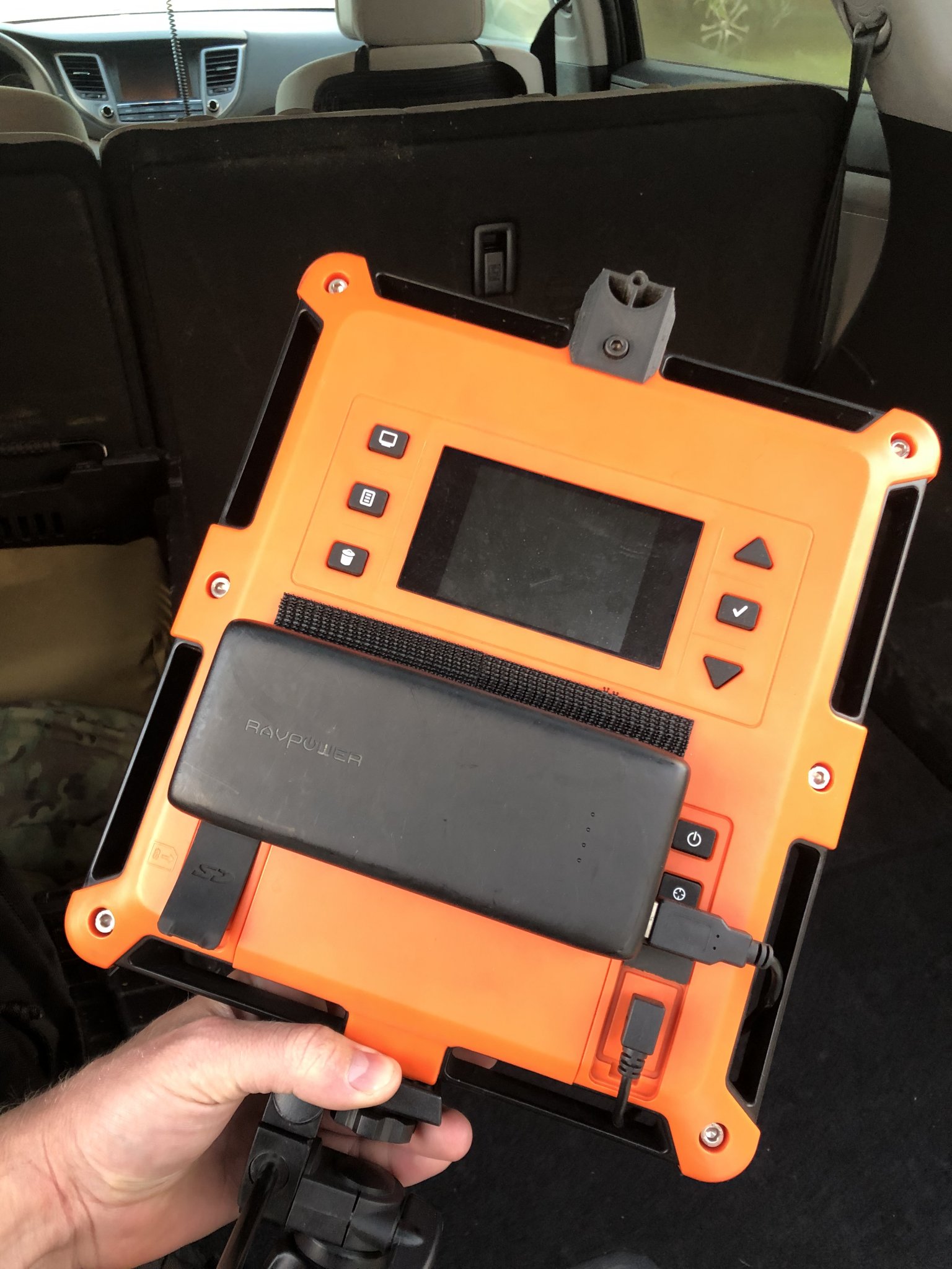

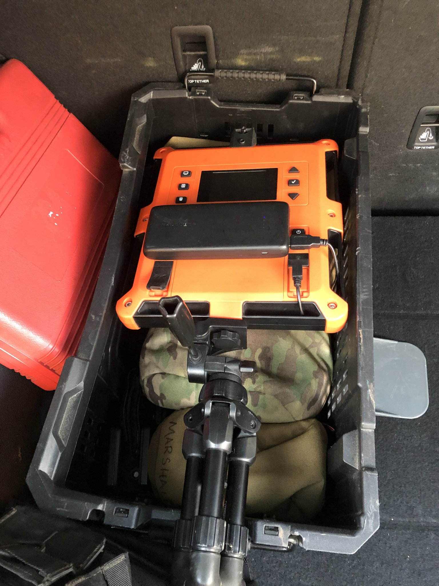

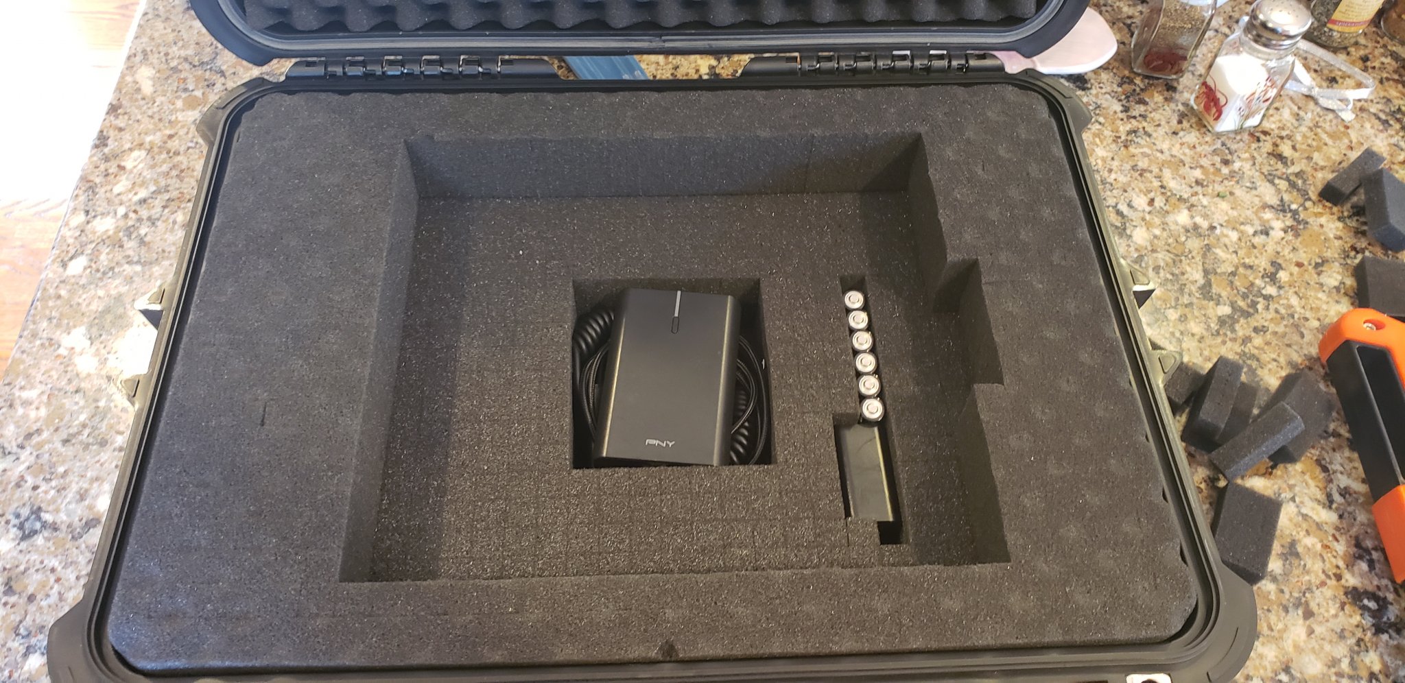

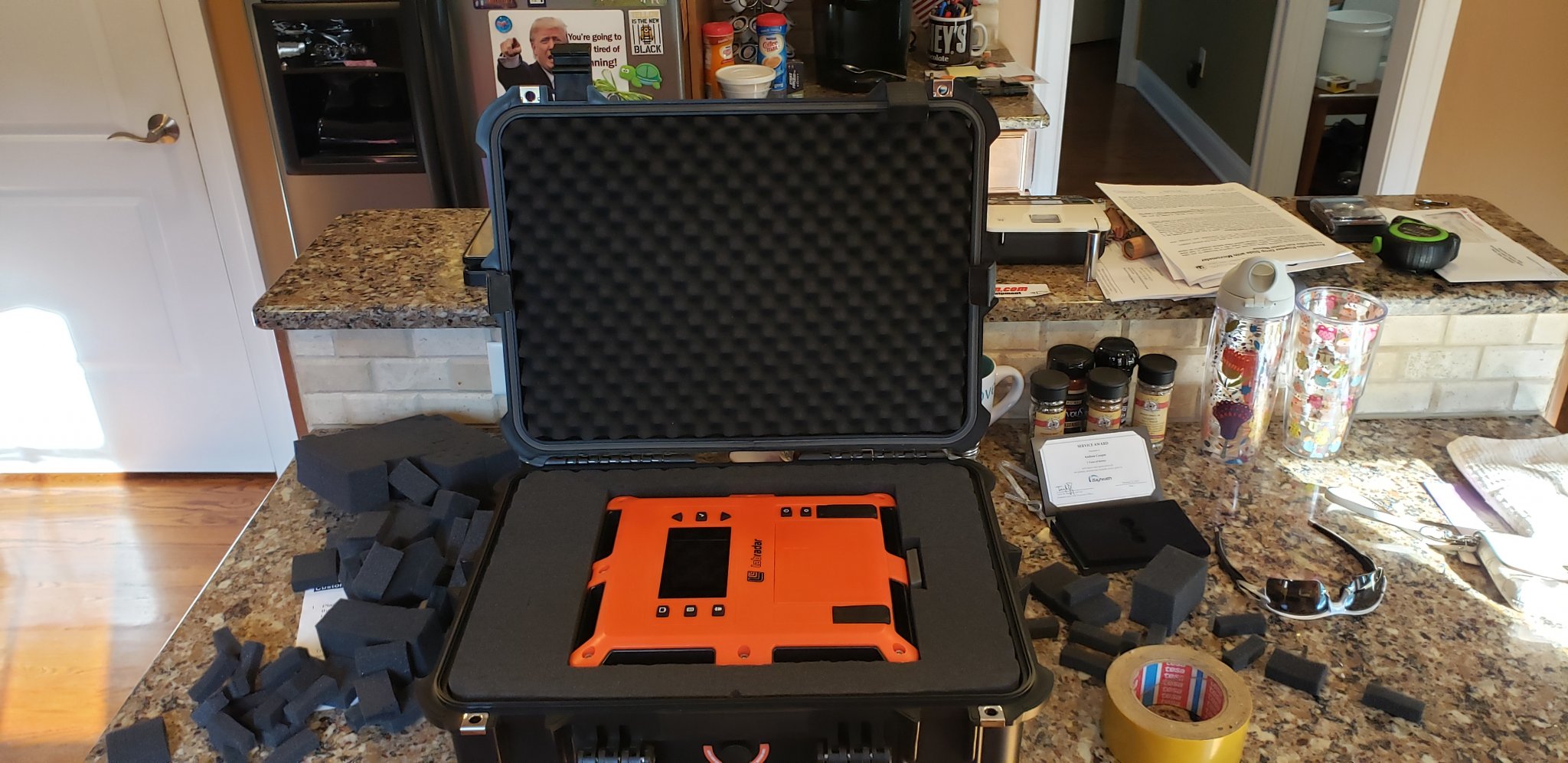

I just got a labradar after being frustrated with optical chrono inconsistency. Bought the MK aiming device which is nice. Very very happy with mine so far.
Got this case from Harbor Freight for $48.

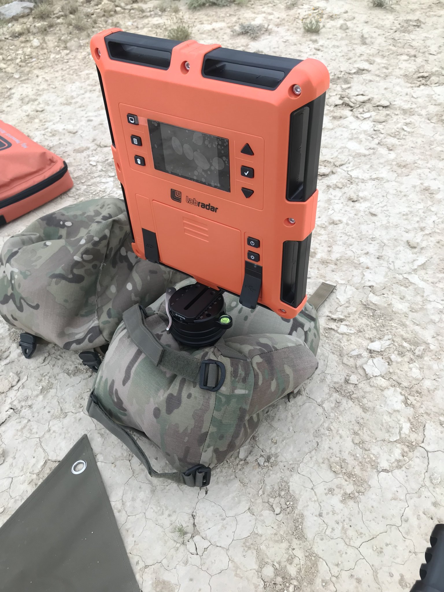

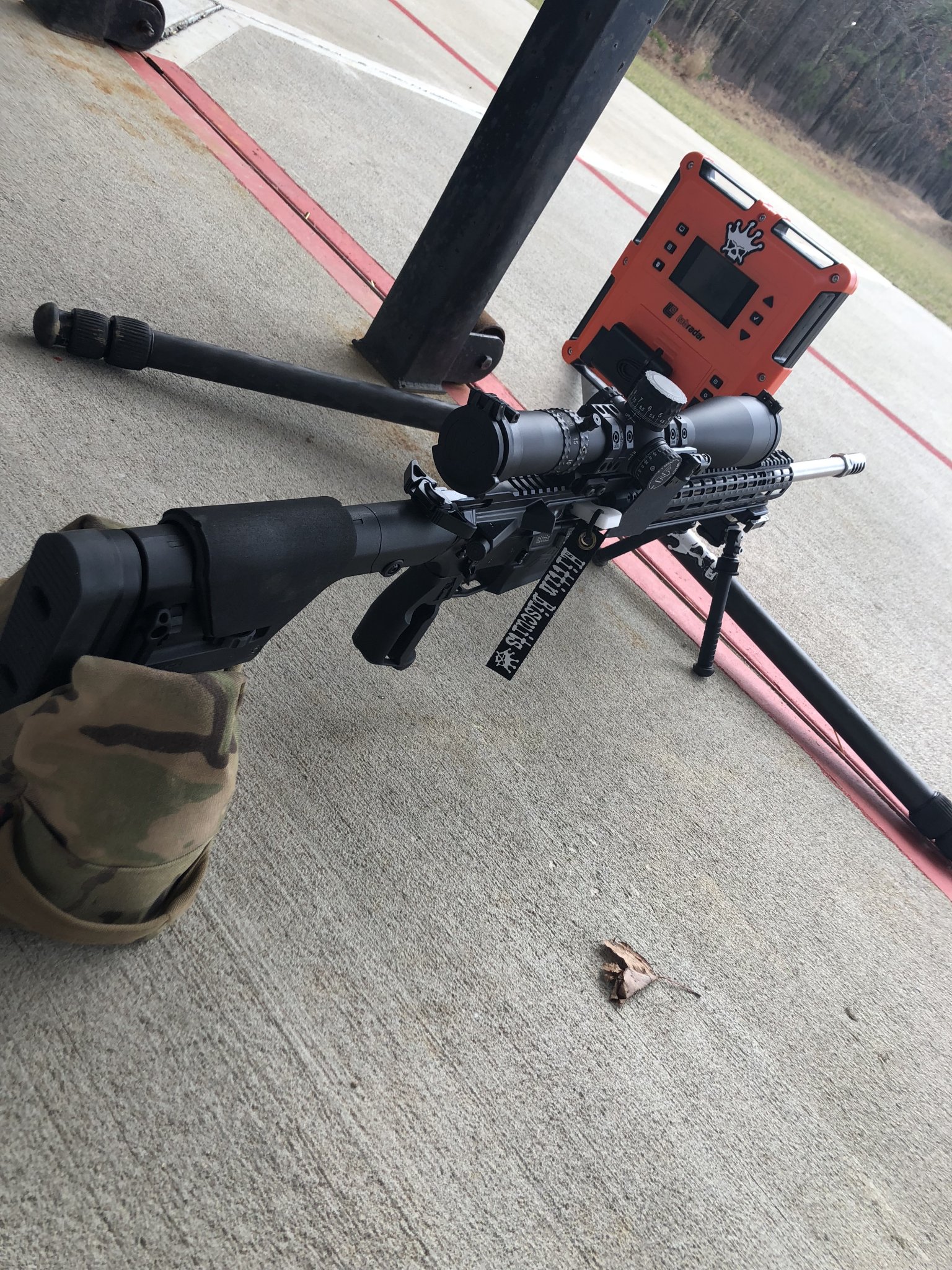

This is what I have for aiming my labradar. It has become very fast for me to chrono a batch of guns now.

@ShtrRdy i stuffed my tab gear rear bag underneath it where the motor was. I was able to kind of move the tumbler around the bag and it stayed in place and it also took some of the flex out caused by the springs between the base and the media hopper.
That is why I did not have much confidence in getting any results and was completely surprised I was able to get perfect results using such a joke of a setup. Now, I only fired a few shots because I just wanted to test it out but got readings on every shot.
@ShtrRdy my bag is actually underneath the machine in the picture I posted and the motor is sitting on the bag, I just kind of worked the top part of the vibrator around until it settled into the right spot on the bag.

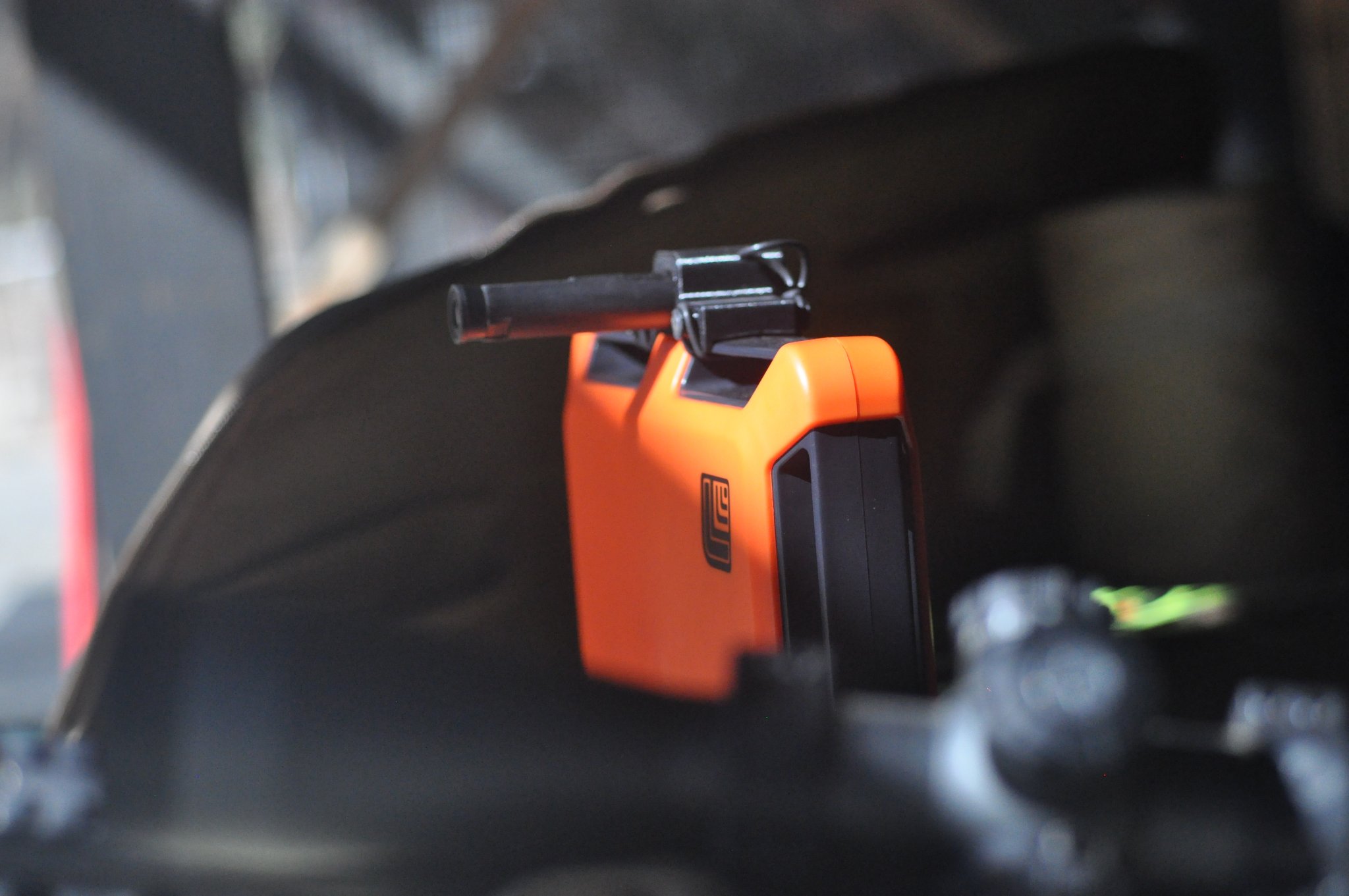

take the guts out of a ballpoint pen and toss it in the v groove. pretfy effective and low cost
The pen trick works just fine for me (y)
I bought the LR, after i had seen what a 300 win was able to do with a wobling MS3...........!
I have never had a problem just using the groove in the top.
i set up behind the LR- shoot with the LR at 11 oclock. Just think about your muzzle blast signature. It depends on your muzzle break as well. Direct concussion to the unit interferes with its accuracy. I don't mess with a case or anything with how often I use it- just throw it in a bin in my car where i pull it out and have it set up ready to go in a few seconds.
I used a V3 for some time. I didn't like the strap system, especially shooting suppressed, ended up going with the LR and have never looked back.
I shoot with no brake, brakes and suppressors and do have to change the trigger adjustment a bit higher with some, and move the unit a bit further back with a brake, but it works well for me.
I read about the fragility of a certain internal solder point and simply use the LR base with a bag on it so it doesn't tip over, did a hard case as was shown above, labeled the buttons and lastly, I only use lithiums as I leave them in the unit and don't want a leak. /lecture off
Since I started using the barrel of a ballpoint pen literally lying in the LR sight groove as a sight, I have not missed picking up a shot and the signal-return bar graph shows all or all minus one bars. Yes, of course a breeze will blow the thing out of the groove. So what? I only have to aim it once.

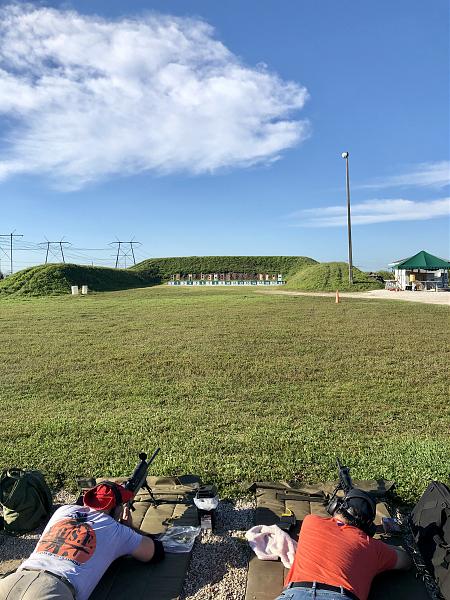

From just today. People shooting on either side of me, though not too close. No missed readings from the very first test shot. I’m not sure if the device is water resistant so I put the bag over it, and could still aim the device. All in all it was a very efficient load development day.
