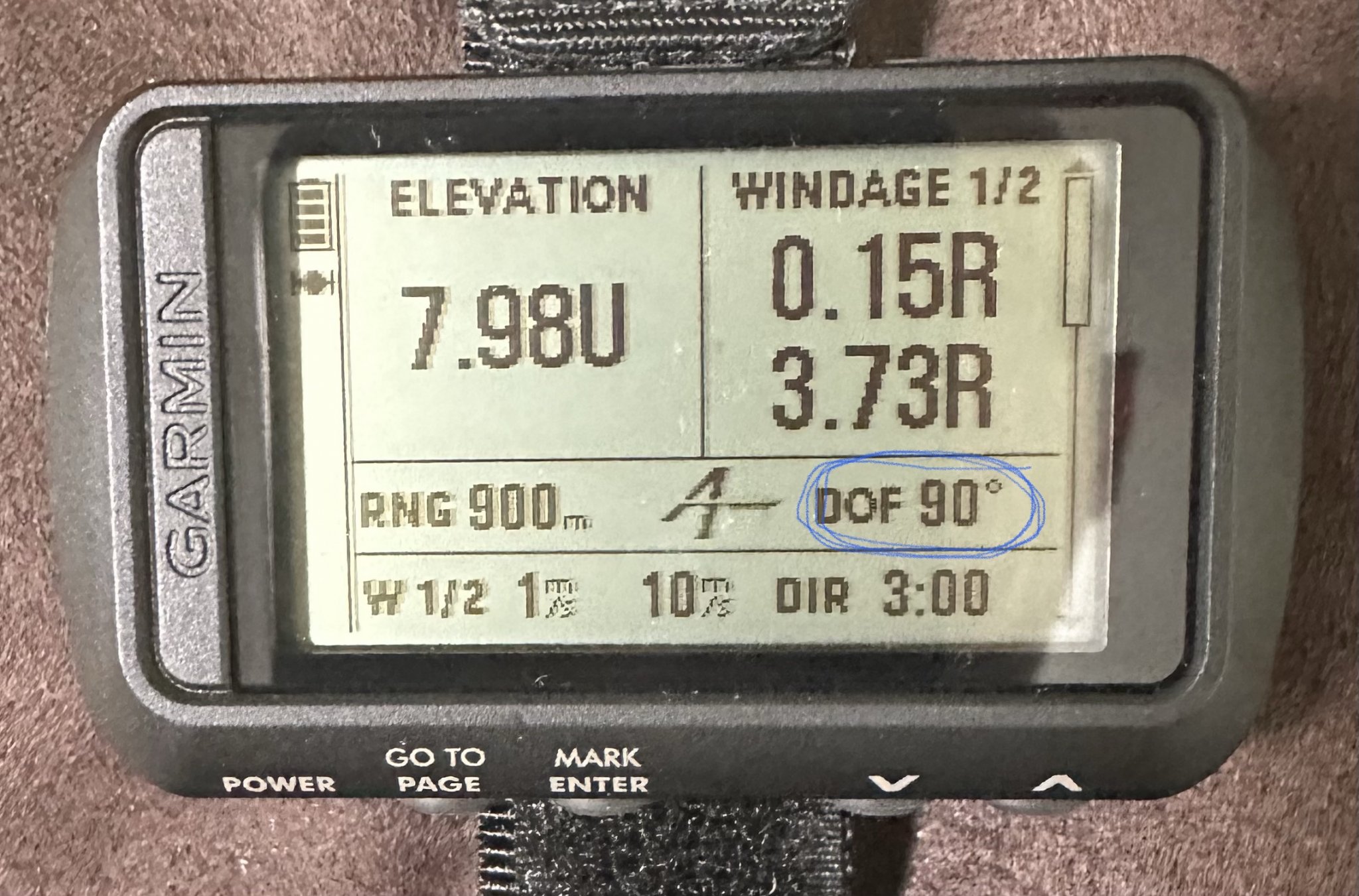

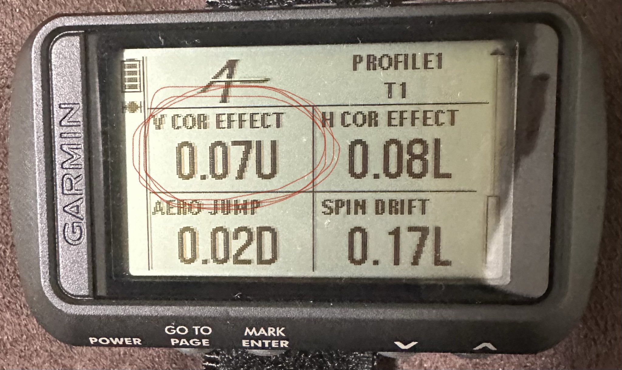

Did anybody pay attention to the sign of Vertical Coriolis Effect in Fortrex 701 BE with AB? Why is it opposite to the correct one.
If you shoot east the correction displayed for V Cor Effect should be down. And vice verse…
My Kestrel 5700 Elite for the same profile and target displays correct correction with the correct sign! But my Foretrex displays the same correction but with the wrong opposite sign. I checked several videos about Fortrex 701BE on youtube and saw that many of them have the same issue! Does anybody know what to do? I have the last update for my Fortrex hardware but it does not solve the problem!
