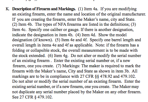

Please cite where there exists a requirement for Form 1 to have the receiver engraved with owner / trust name ? Thanks.
When the eForm 1 is submitted a photo of the receiver markings / model # / serial # etc. is reviewed and the application approved by the BATFE. Done.
The OP is not indicating he is manufacturing the receiver himself, rather just cobbling together a receiver with a short barrel.
A Form 1 is an application to make a firearm. In this case an SBR. If you read block H of a form 1, it states what iou are required to place on said item when you convert it. It doesn’t matter if you buy a brand new lower receiver, the minute you decide to sbr it, you become the “new manufacturer”.

An individual that "creates" a firearm is the "Maker" in BATFE speak. Such a Maker has to engrave the receiver as specified in the Rulings. When the common citizen "individual" is only "modifying" and existing firearm (e.g. swapping out to less than 16" rifle barrel or converting a mfg. pistol by fitment with a shoulder stock to an SBR) one does not need to engrave anything.
Did a few form 1 sbr's last year and was sot back in the 80-90's, although i may be rusty. My understanding on the engraving thing was that you do not HAVE to engrave, but when you croak the firearm is INSTANTLY illegal (without a trust anyway). Not a good thing for your inheriter. Not having the engraving likely increases your odds of potential inspection issues. Not to seem paranoid, but say you have a car accident on the way to the range and did or did not forget your Paperwork and ATF gets their hands on your best loaded sbr? Engraving now is local, cheap and way better than the old letter punches - Argh! Corrections welcome.
Correct, who ever was the previous manufacturer, it doesn't matter anymore. The person now doing the form1 is now considered the manufacturer per gAyTF

Do they require you to prove it’s a braced gun in the form 1 process? If that’s the case no one can do this on a bare lower they already owned?
They require you to sign the form which swears you are telling the truth. I attached the amnesty F1, go read it. If it's a bare receiver it doesn't qualify and you're perjuring yourself.
You are also guilty of wire fraud if you lie on the form.
Alrighty then, I don’t know who’s right or who’s wrong, but I’d sure like to see it proven one way or the other. Maybe because of the eForms software though Silencer Shop, things can be done differently, kind of like how they were allowed to do digital fingerprints before anyone else? 🤷🏼 @Silencer Shop can y’all give us some answers…
And the picture of the receiver, is ONLY of the factory engravings, not of the whole receiver, or of any other parts of the weapon.
We only ask for a photo of the engravings, not of the firearm or its configuration. And the photo is not required, we will submit the form without any photos if you wish, but there have been reports of forms being denied as there is no way to verify the model and serial numbers.
No additional engravings are required because you submit the factory engravings, and as the rule is written they're treating the existing firearm as an SBR, so the engravings are already indicative of an SBR (Similarly, if you purchased a Form 4 SBR you would not need to engrave it, this is essentially the same). - Chase
