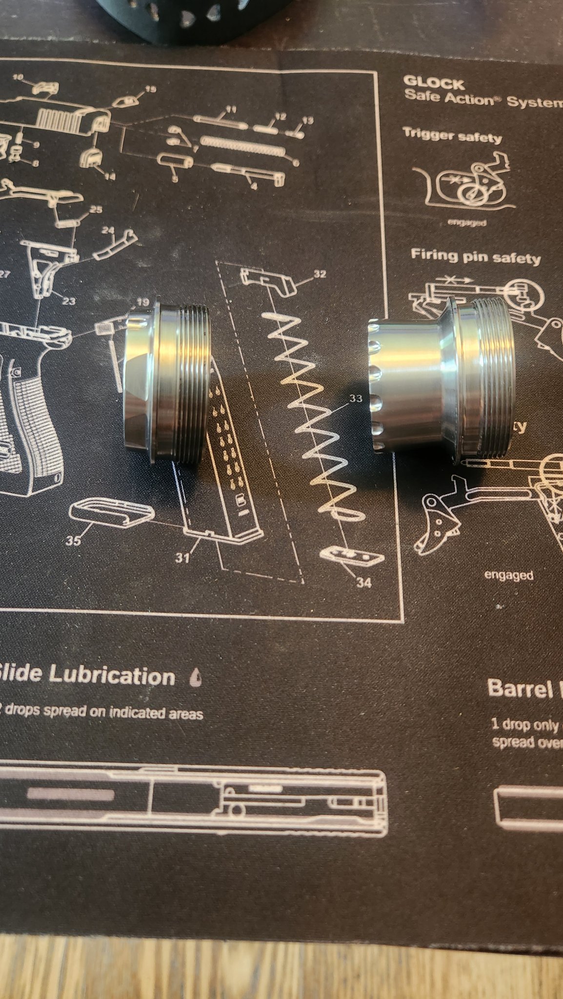

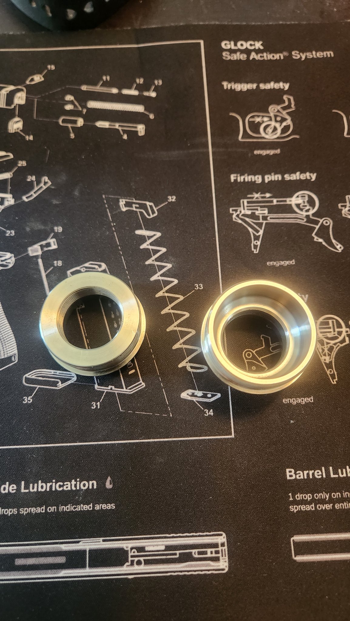

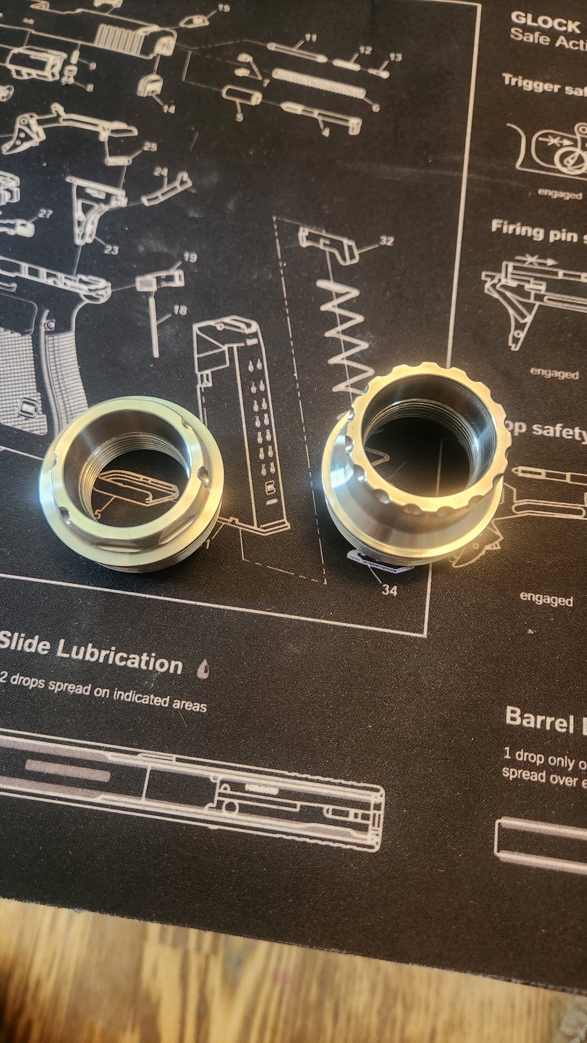

This is what you seek:
These are taper adapters made by the machinist that used to run a very reputable company.
TA-16, and TA-16 Pro.
Depth in tube: .45 (most of DM stuff went that)
16 flushes the rear of the taper to the rear of the mount, 16 Pro sets the MD back out another .5-.7ish, helping to increase your BC (good for your hot mag rounds if your BB is Ti, or BC too small)
