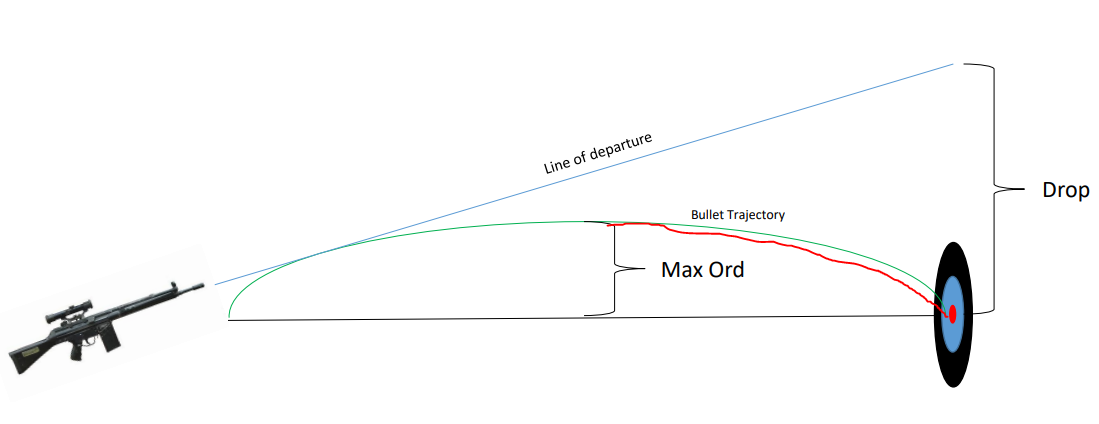

    What I am looking for is how much does a 0.1mil correction (in inches or CM) get me at various distances. In the diagram below, if the Green line is the flight path dialing 8.1mil and the red line is dialing 8.0mil....what is the distance on the target between the Green impact and the Red impact?
    Given a lot depends on the BC of my bullet, muzzle velocity, Density Altitude, and other factors I imagine this is something that would be found in my Kestrel.
    The reason I ask is because I know for wind it is more or less 1:1 where if you miss left by 0.2 mil you can correct with "hold right 0.2 mil to get on target. But as I understand it, several factors (gravity, BC, density altitude, etc.) preclude the same correction for elevation. If I miss low by 0.2 mil the correction doesn't exactly translate into "dial up 0.2 mil"....or does it?

    To clarify, if I am impacting 0.4mil low, the correction is simply dial up 0.4 mil (all else equal)? Based on the diagram above, wouldnt that only apply to Drop and not MAX Ord?

    And why do you give a crap about max ordnance? I believe your concern should be only about point of impact. Right?
