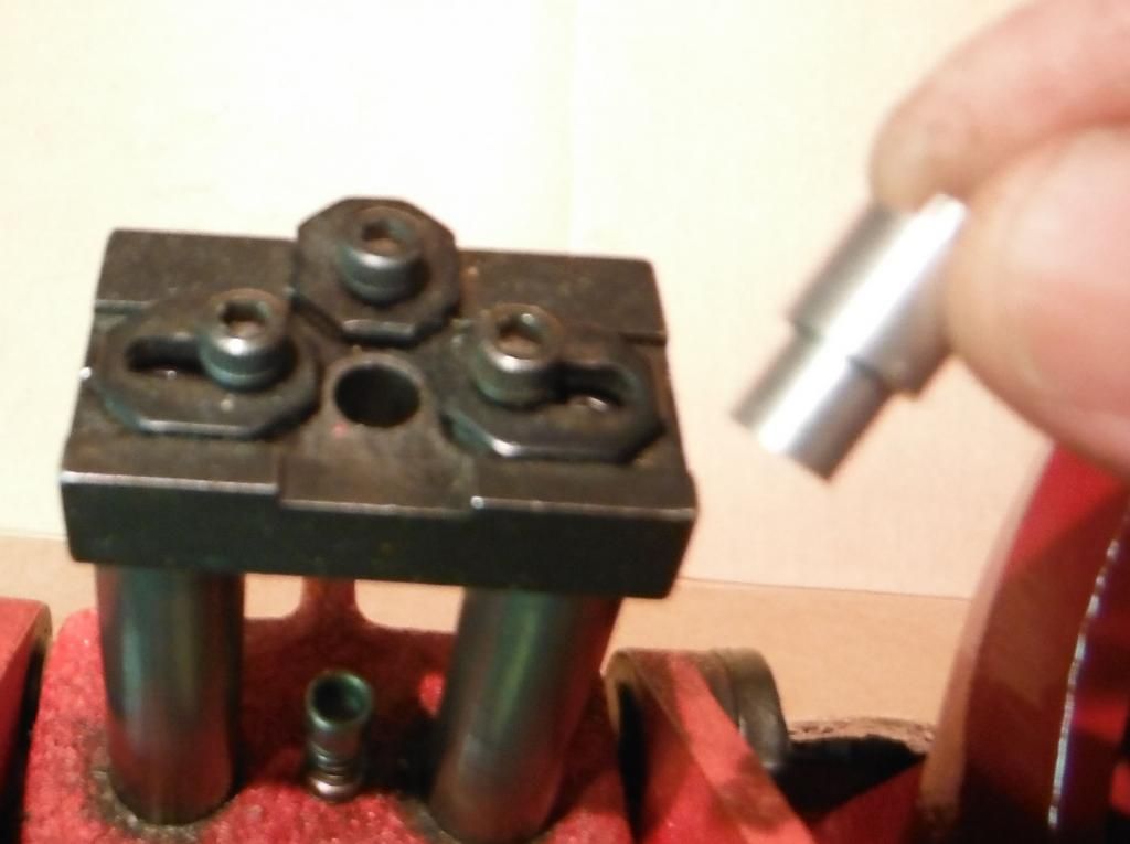

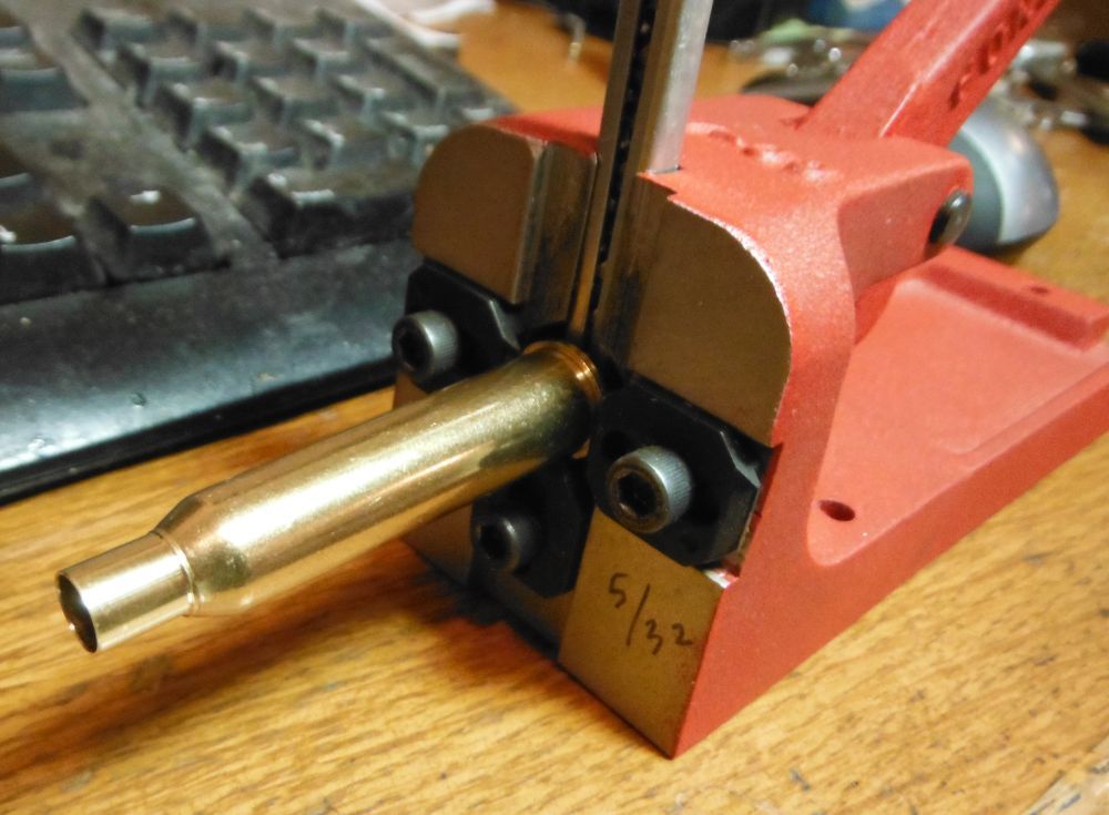

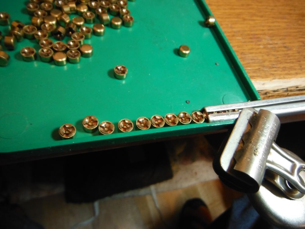

I did come up with a way to adjust it fast. I made Aluminum jigs that have the plunger bore and the extractor groove diameter. RCBS primer tray with relief cut for Forster Bonanza primer tube sliding in primers  9-21-2012.jpgForster Bonanza priming tool with tube full of primers and priming a 257RAIR case  9-21-2012.jpgshowing fixture for Adjusting primer on co-ax.jpgAdjusting primer on co-ax.jpg
The Bonanza/Forster type table top primer is a good tool. I came up with a way of loading the tubes fast. I milled out a slot in an RCBS primer tray, and ciip the tube to the tray with a clothes pin.
