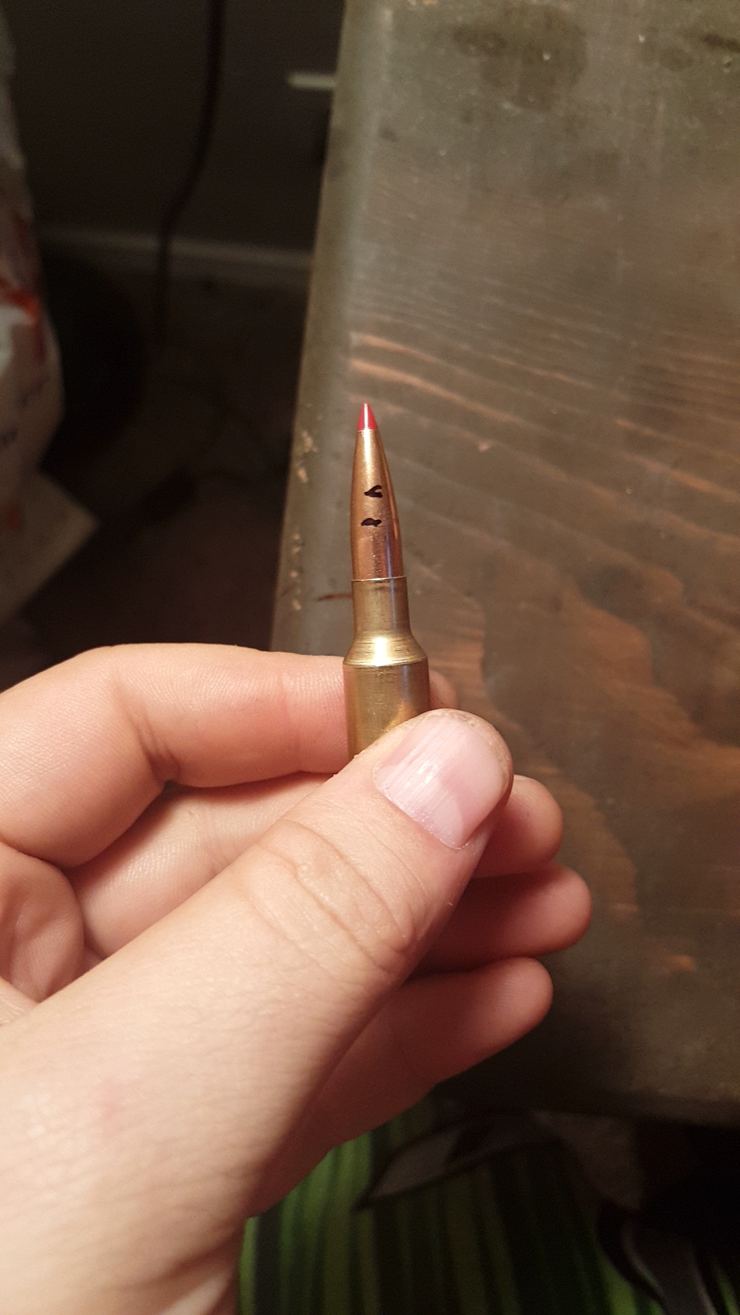

So I have recently bought a forster coax press with forster FL Sizing die honed to give me .002 neck tension and a forster bench rest micrometer seating die. I am using Lapua brass, vargat powder, and hornady 140gr eld match. I have found my lands and know what my seating depth should be from the ogive measured with a Hornady Compator 5-26. I have noticed when seating my bullets 6 or 7 will come out perfect and then a few in will seating 5 or 6 thou deeper than the rest of them. I have measured my bullets and all seem very consistent my brass is all trimmed and set even and my powder load is not compressed and none of the primers are sticking out further.Does anyone have any idea what might be causing this ? Thanks!
The only way to seat every bullet exactly the same is to seat a few thou short, measure, adjust the micrometer, seat again and measure. Even in the most consistent bullets, you will see some variance.
It just seems really strange that I can go several rounds and they all be identical then just one jumps a significant amount like that. And after measuring 20 of my elf match they were all within .0005 of each other from bullet base to ogive
Not that I can feel. I don't turn my necks but I do use the honed die which brings my outside case neck diameter to .2880 and loaded rounds measure .2890 every time I check one
My Berger hybrids are usually within 3 thou of variance but I always do the procedure above to get the exact seating depth
one thing I think may be an issue is that my seater die contacts on the top mark and my compartor hits much lower on the bottom.mark
Try a nice, slow, smooth seating process and check again. Your numbers don't seem quite right, that is 10 thou of tension.
I will be using this method going forward. I was just worried I was doing something wrong that might be an easy fix. still doing load development but last load was 7.3 SD and 26 ES over 10 rounds so I'm closing in there at least
