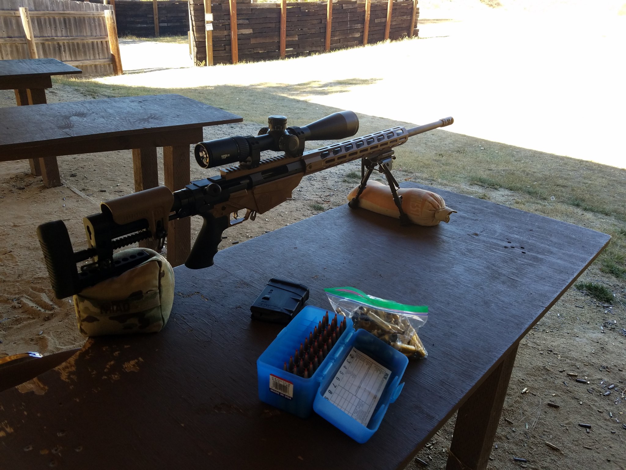

Equipment is gen 3 ruger precision rifle
6.5 Creedmoor 24"barrel
Hodgdon 4350
Cci no 200 primers
Hornady 140gr eld match
Hornady brass
After lots of questions from me to this forum several members beared with me and helped me get this load dialed in
42.1 grains of powder and coal 2.816
Bullets moving at 2800fps
I shot two ,10 round groups @100 yards to confirm, here is my best target.
Anyways thank you again hide members for helping this rookie have the best day @the range I've ever had.
