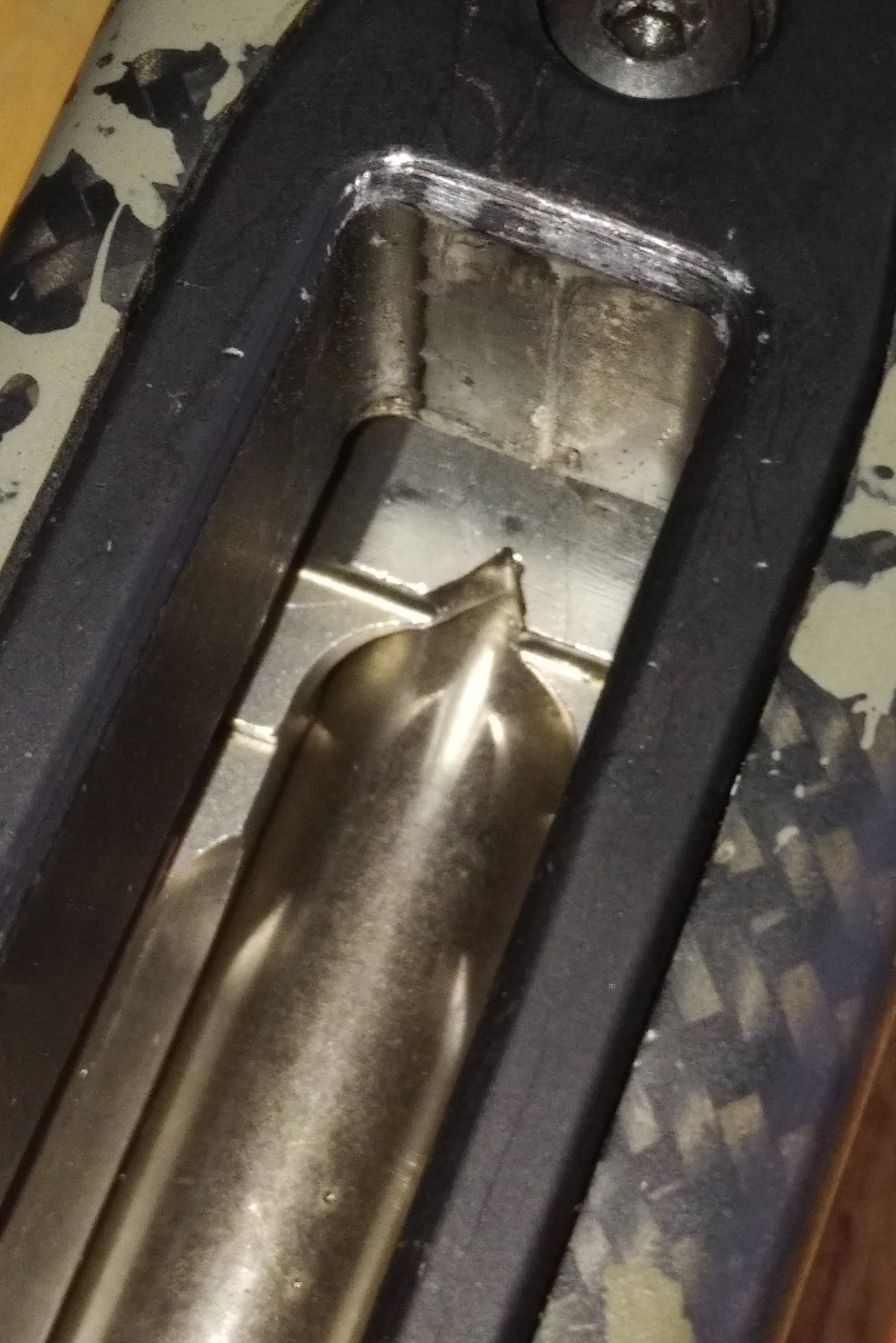

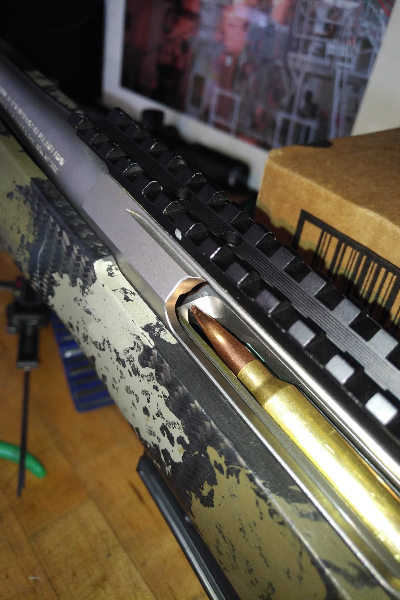

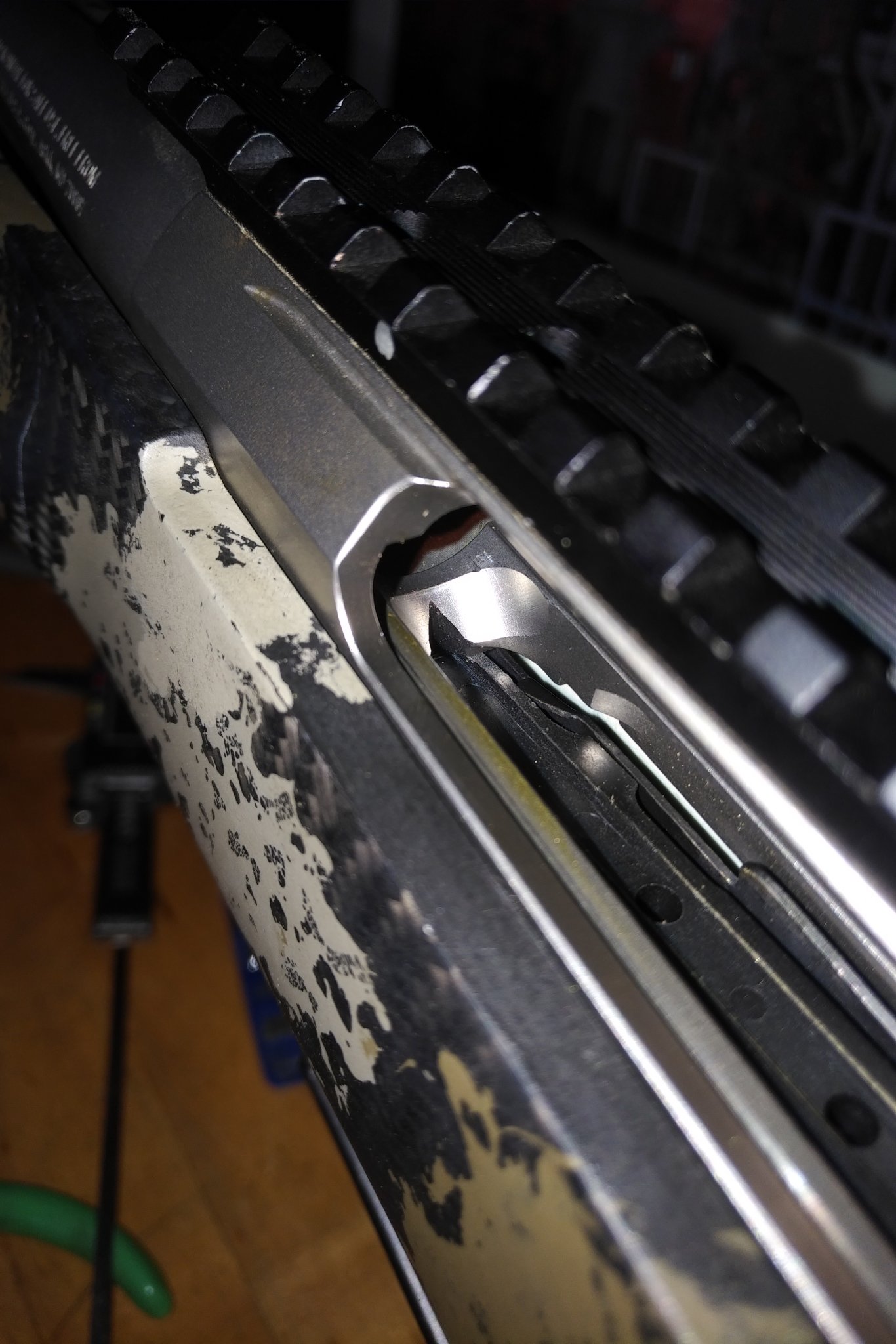

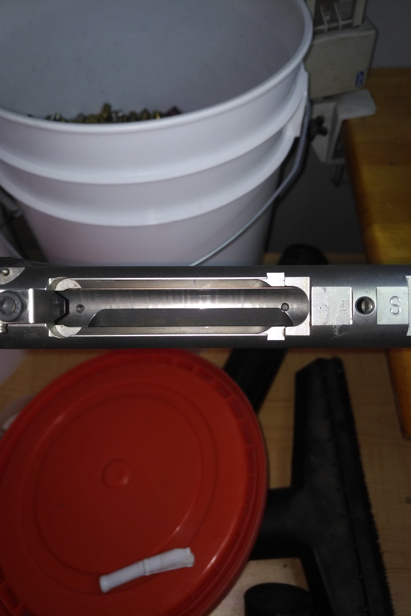

The bottom of the Tikka action also limits the overall length of the round to 3.41". I have a CDI bottom metal with my Tikka action with AICS 300WM length mags. I had to lengthen the bottom of the action to allow for longer length rounds to be magazine fed.
I have a 7mm RemMag and can now load 175 and 183 Matchking rounds from the mags when loaded out to 3.6" or so :)

I just need to grind down the front portion of the followers in the AICS mags so the don't contact the action and angle downward which causes the last round to nose dive. Also, you'll need to tune the front of the magazine lips to let the rounds angle upward ever so slightly to feed reliably anyway.
