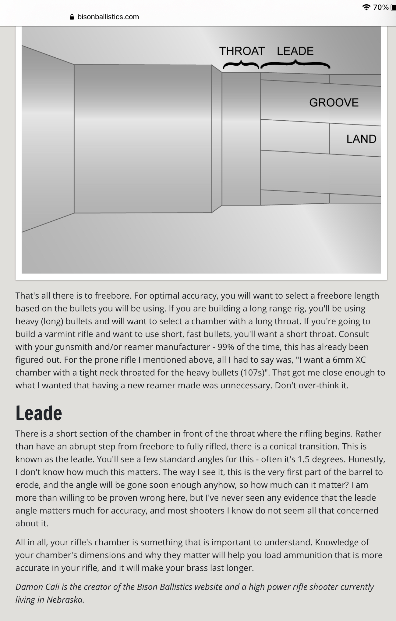

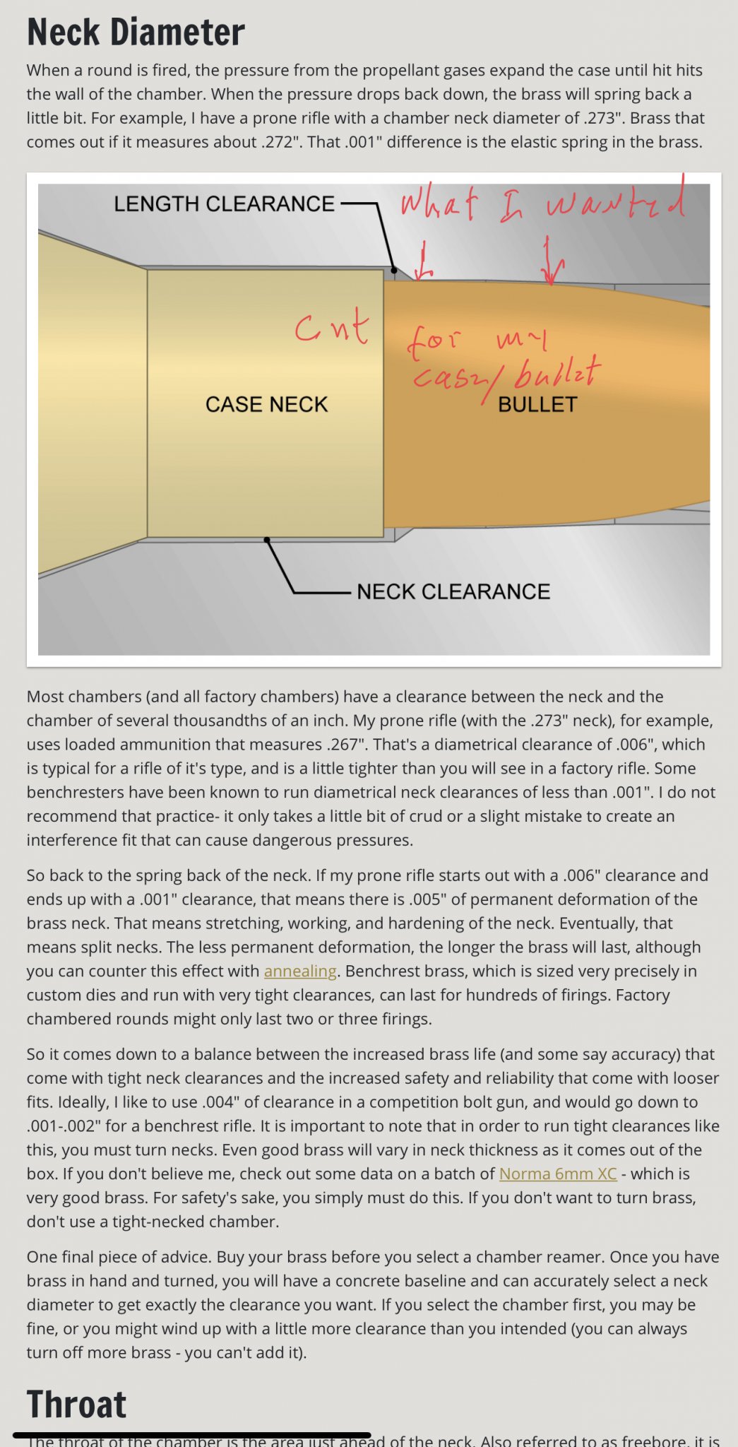

Where the neck on the chamber reamer ends starts the throat (freebore) - the portion between the neck chamber and where the lands start. The .216 on mine is the distance from the neck to the ogive of the bullet. It is essentially the length of the seated bullet from the case neck to where it touches the lands. I like to seat my bullets with the boattail/bearing junction seated at the neck/shoulder junction of the case.
on Hornady’s commercial 6.5 PRC ammo if you do the math they have significant bullet bearing surface buried below the case neck/shoulder junction in order to work in short actions. That room is normally reserved for powder.
I attached a couple of photos from another site. Please delete my post if not ok. They put this out to teach people so I think it’s ok.
I’m an old man. I’ve been reloading for ~45 years. I smoked bullets to help find my seating depths long before I ever heard of a comparator. Though I only bought and shot factory rifles until about 5 years ago. Have rifles built is creating the pleasant need to learn more. I’m on my 3rd build and only scraping the surface of what I need to know to ensure I get what I actually want.
