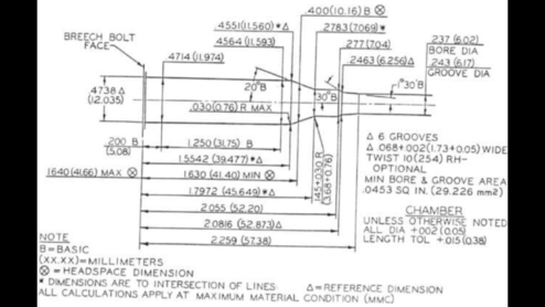

The reason you can't find it on the diagram is because it doesn't have any straight freebore. It has a funnel shaped throat. The 270 and 300 Winchester also have this style throat. If you want straight freebore, you will need a non-SAAMI reamer.
