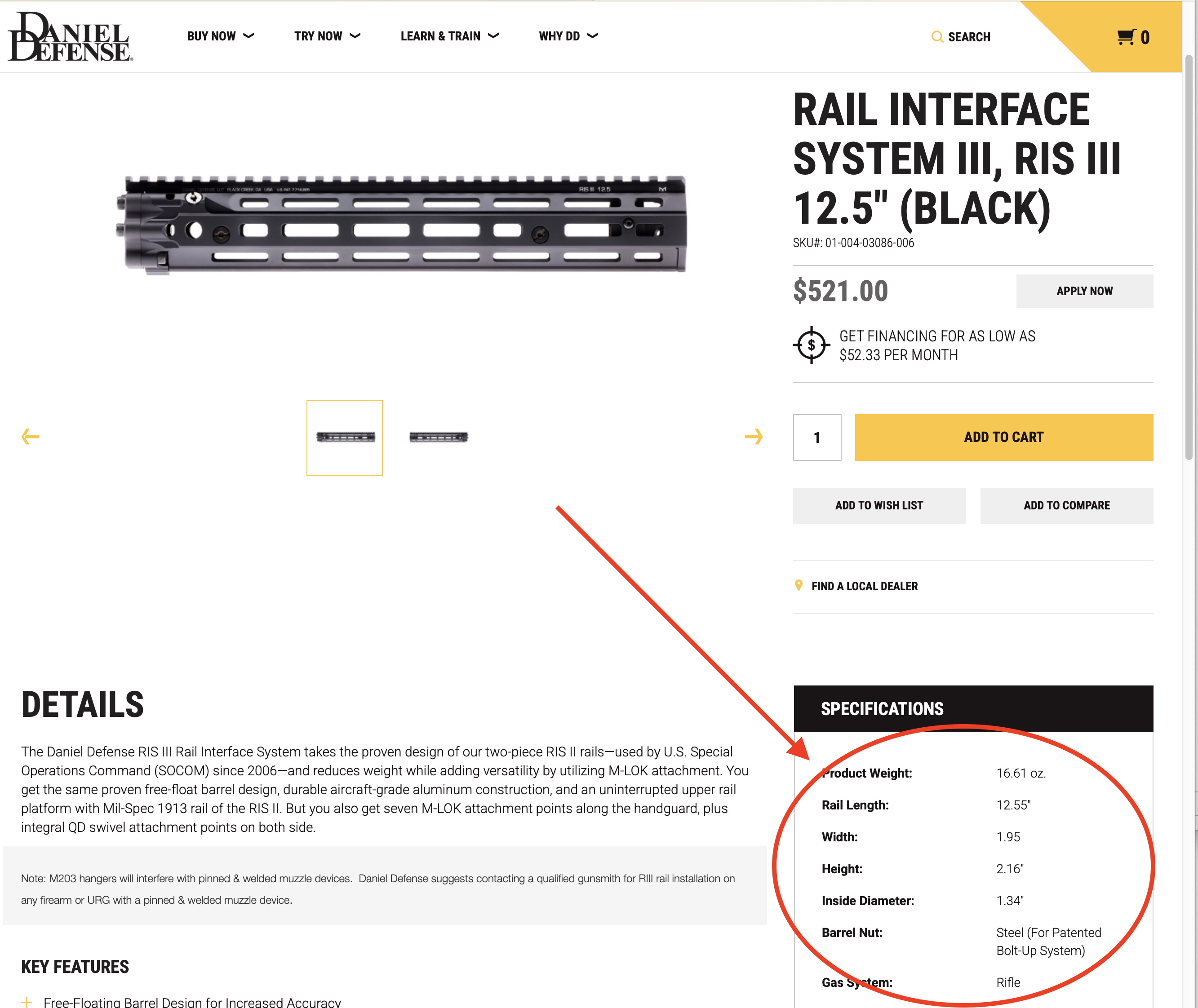

There are so many different brands/places making them, china is stamping them out like hotcakes. I've found some for $15. just like that. I think they were clearance at Durkin tactical. And half the brand name ones are just rebranded china. Why do you need to know? Just buy one bigger, they advertise the inner diameter.

Yeah, you don’t need to know anything about that handguard other than the inner diameter- because it is too small. Just measure that and buy another with a larger inner diameter. Make sure it comes with- or you purchase- the accompanying barrel nut.

It's pretty unlikely another rail is going to fit that barrel nut, especially if you're looking at one with significantly different physical measurements. From what I see other places, the MSR15 uses a proprietary barrel nut, so even less likely to work with another random rail.
