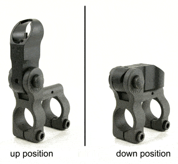

Your particular AR15 was specifically intended to be used with a magnified optic, not iron sights. The PRI flip-up would be one to consider:
http://www.mountsplus.com/mm5/graphics/00000001/PRI-FUP-001.gif
You could still use optics with it folded down, then flip it up and use your rear sight in conjunction with it for whatever it is you intend to do. From my perspective as an avid and long-time AR15 owner, it looks like you're wanting to take the Digital Electronic Engine Control off of a nice sports car, and replace it with a 1910-era distributor, but it's your gun and you are totally free to equip it with whatever aiming system suits your needs.
