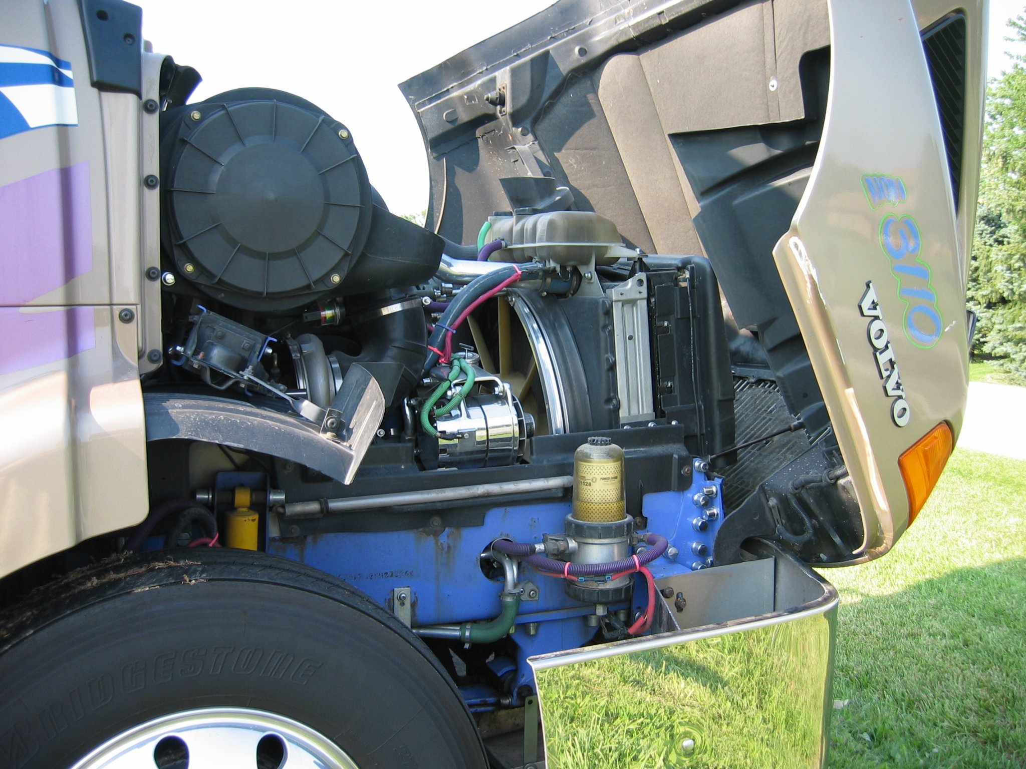

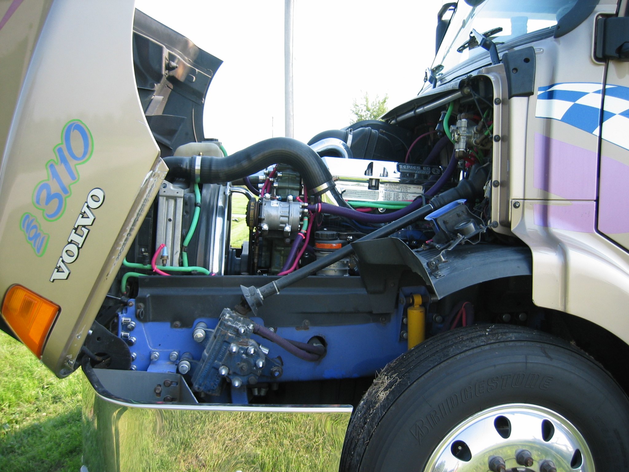

You really should consider a MDT at least, my Cat 3126B 300hp/800tq 6spd FL60 Freightliner got ~10mpg.
In my Volvo 770 I get 10mpg loaded/unloaded @75mph+ everywhere no matter what the load.
Detroit 14L 575hp/1850tq 18autoshift 1999/2000 pre-emission stuff
Cost less than a dually
