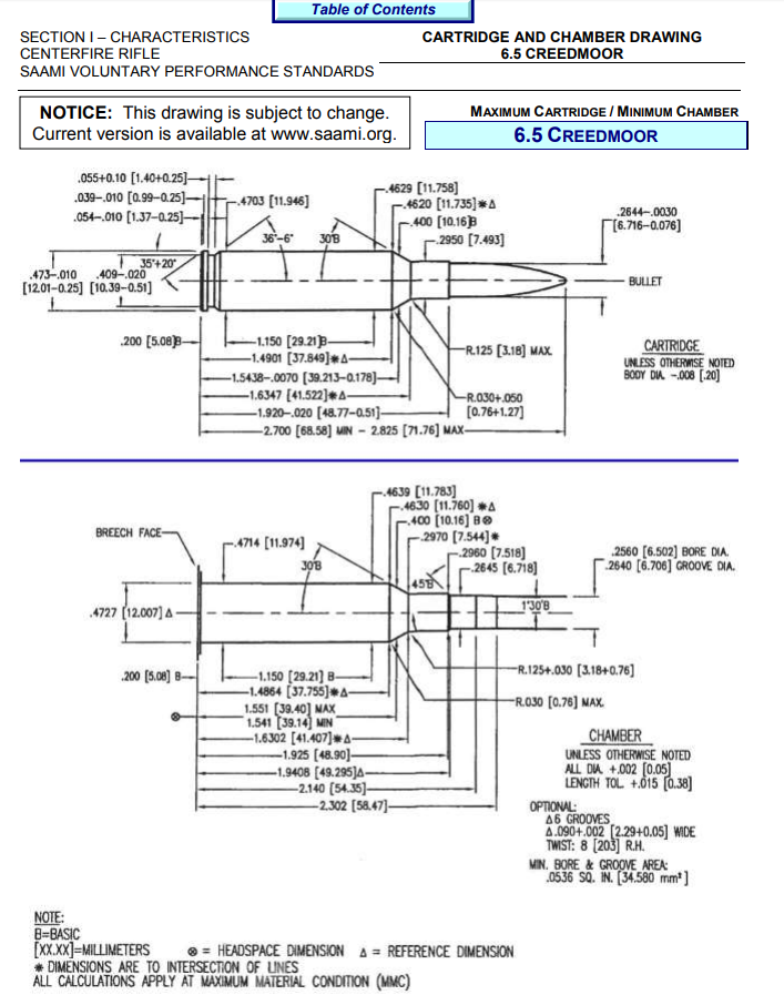

For trim length, i went with the books's (Hornady's) "Case Trime Length" of 1.910. I hope that's correct or i just wasted 2 hours. Reloading is not a quick process...
If I remember correctly the spec is 1.920-.020 so 1.910 is right in the middle. That’s the same way I do mine. Sure I can let it grow a little bit if I cant trim in between loadings for some reason but trimming to the middle spec is a a safe option and the benefits of pushing a longer case neck aren’t worth it to me.
Reactions: Drewdemon
Where could i find that spec your referencing? There seems to be a lot of opinions but i could not find any facts.
Your particular reamer may vary, but this is saami spec, aka the baseline standard.
