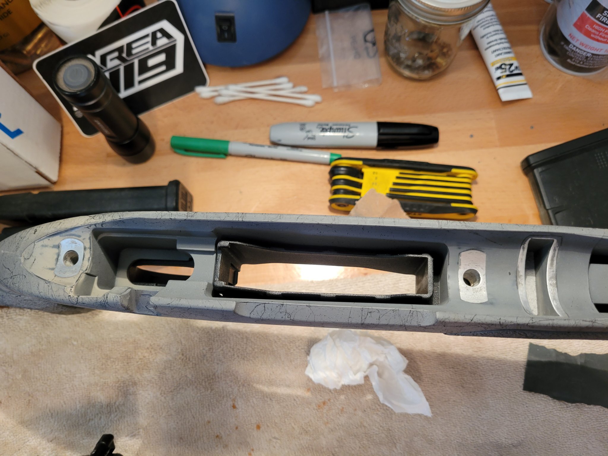

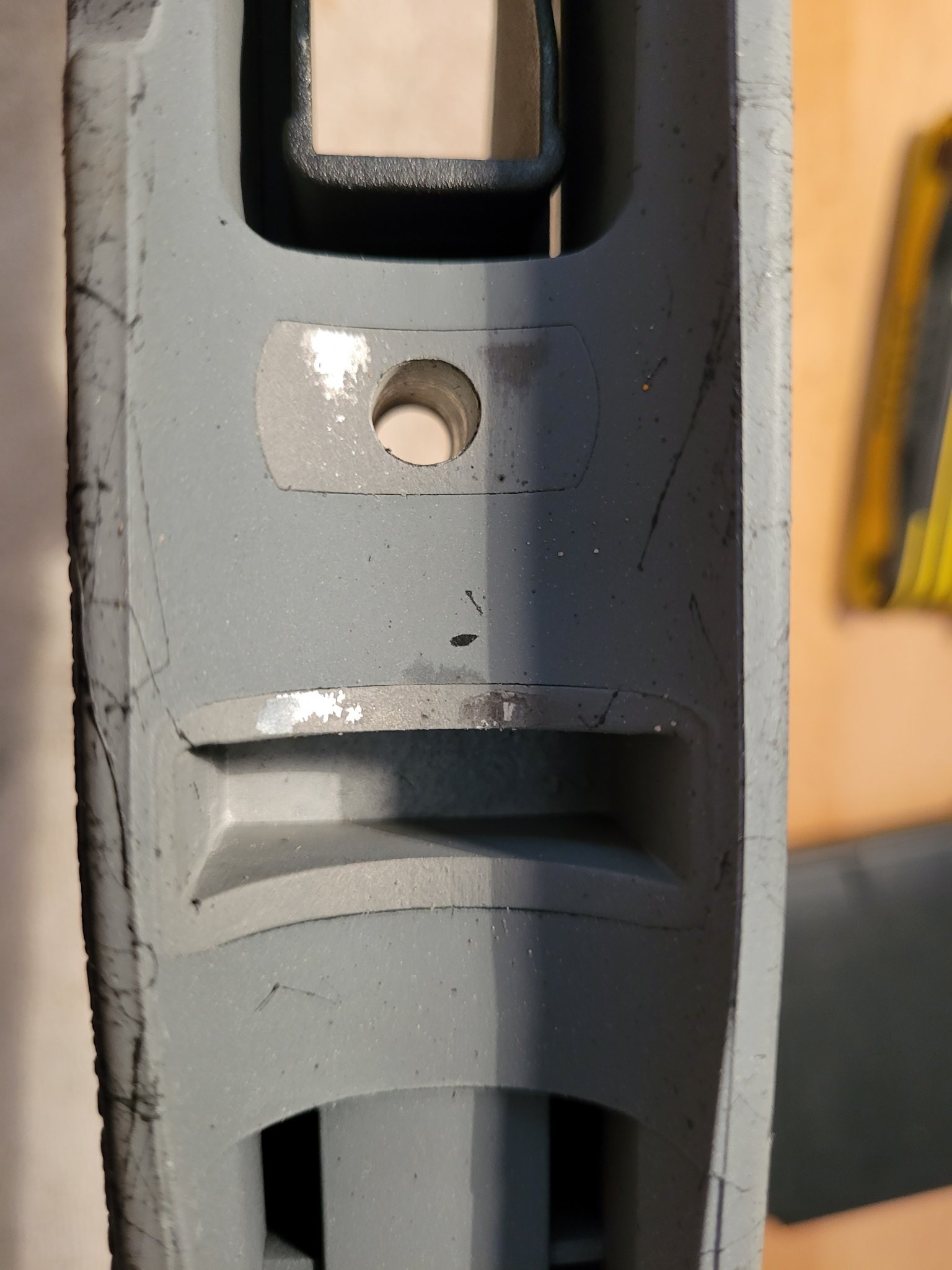

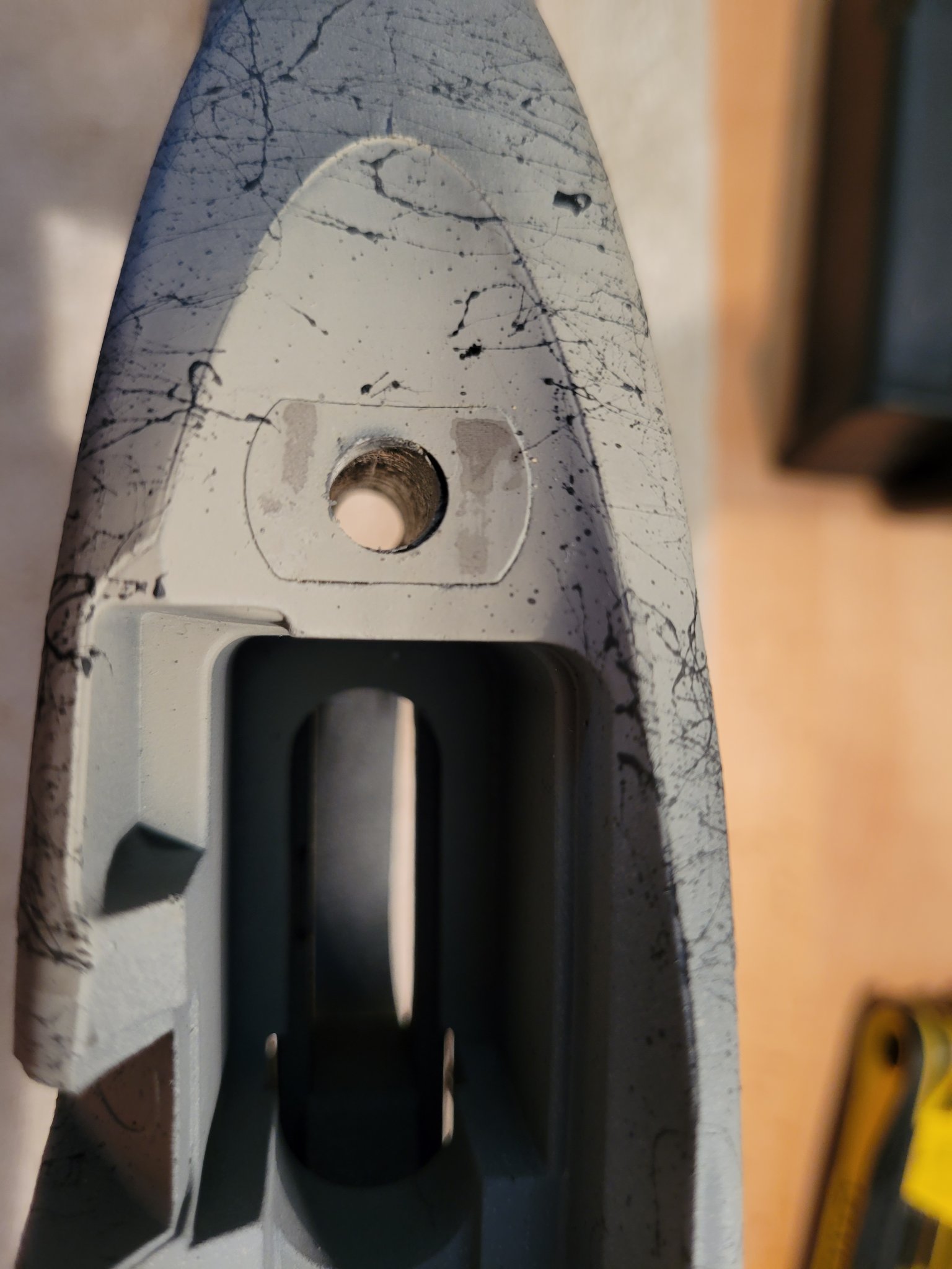

I have the same issues as others. I have a hmr pro 6.5 CM that's a .5 gun with emd-m 147 and .75 with American gunner. Love that gun so got the hmr wilderness in 300 WM for an elk hunt. 3x5 shot groups with freedom munitions 175 loads have been 1.75" to 2.25". Put 2 rounds of eld-m 195gn through it and they were 3.75" apart so I aborted and brought it home.
Took it apart today and noticed there was pain on the bedding areas with some black splatter on the front recoil lug. The base paint was chipped/ rough so I'm sanding that down now. Was thinking wtf and found this thread. Should be able to shoot Monday. I'll report back if it helps.
Before and after pics below.

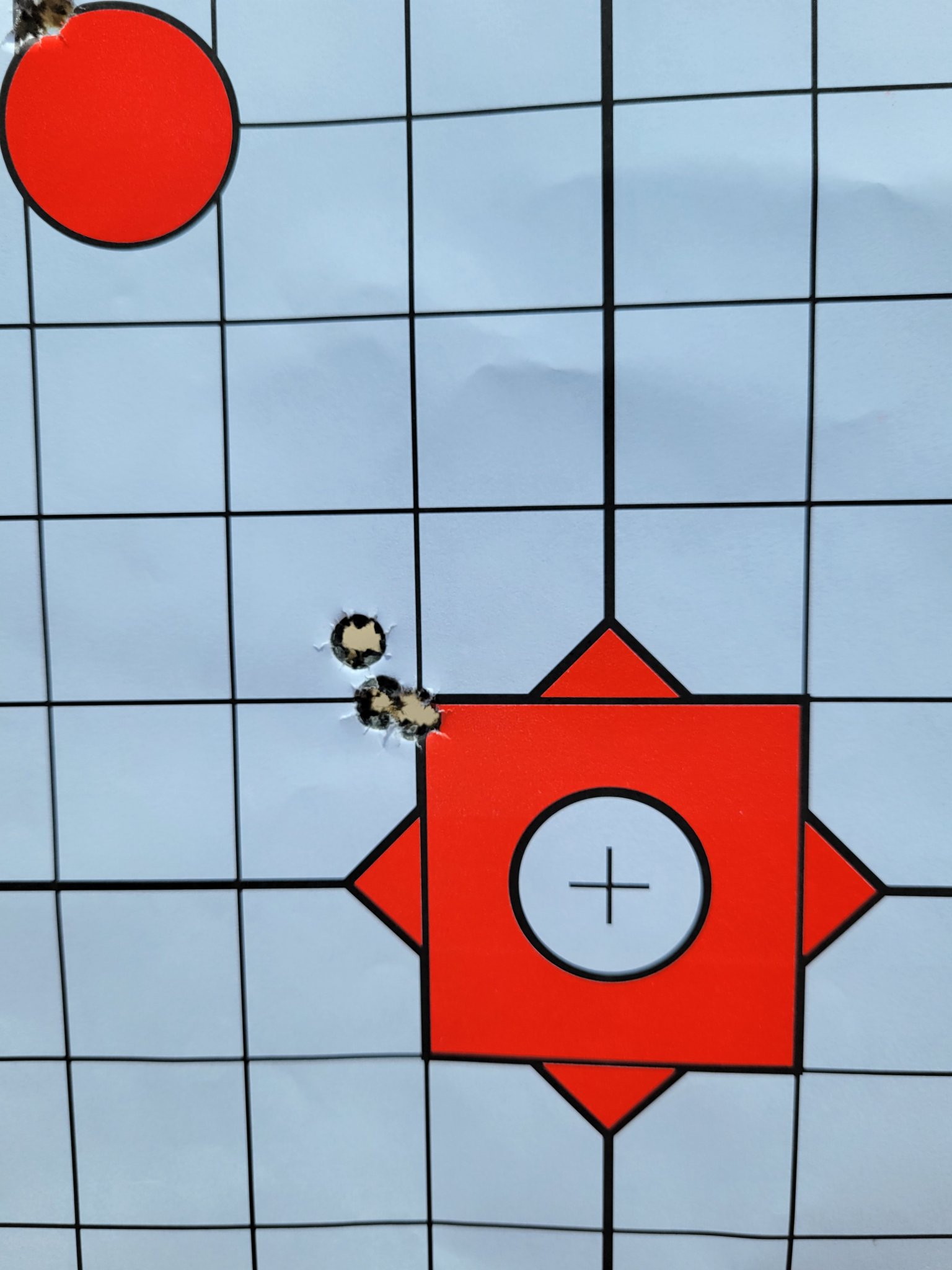

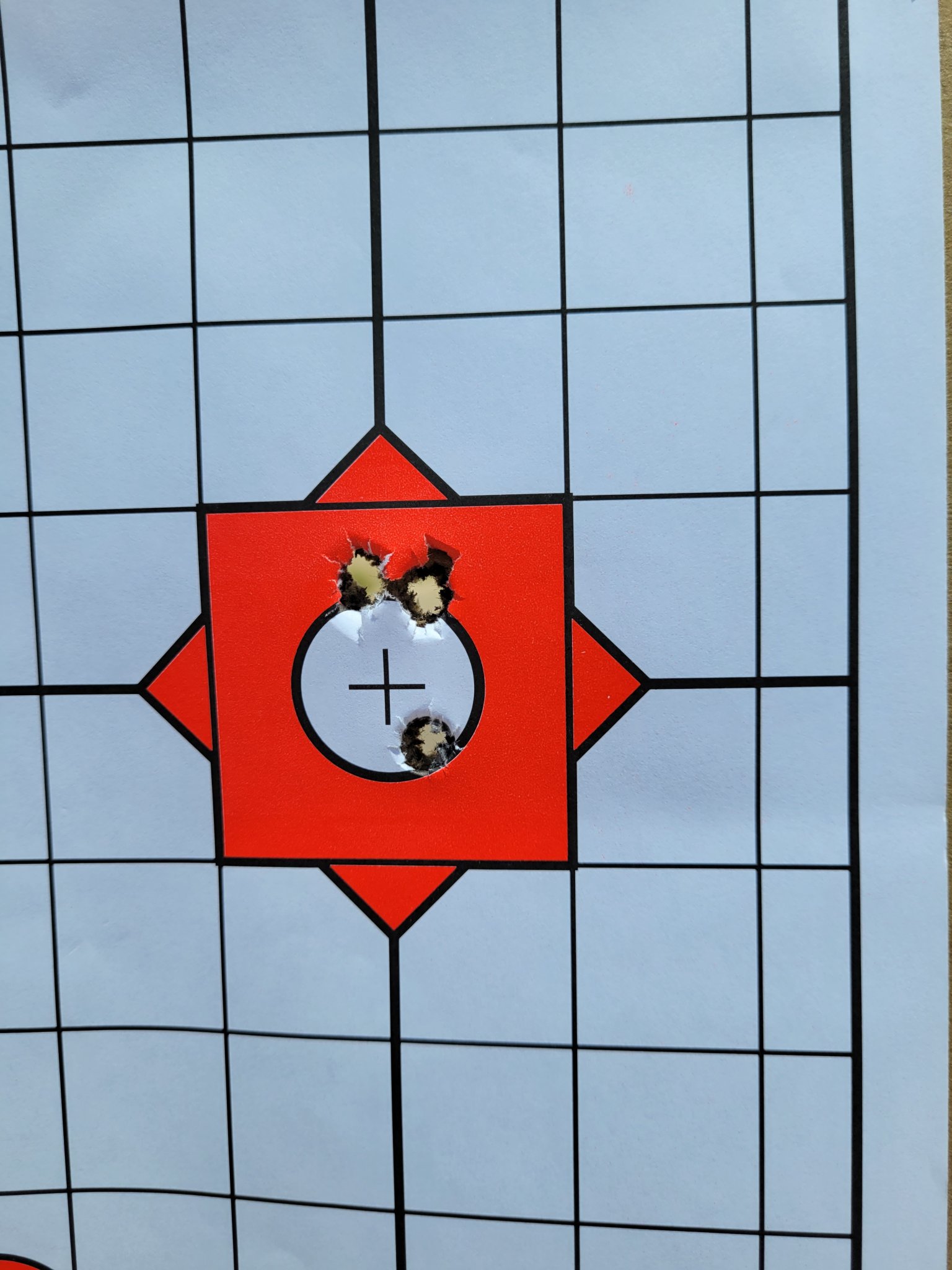

It does seem crazy that a little over spray would kill accuracy. But I was shooting 2 - 3 inch groups before this. Groups below are still not the best (was rushing before a monsoon hit) but good enough to hunt with. The improvement could also have been torqing the action screws to spec or just the barrel breaking in, but the accuracy improvement was quite dramatic.
Either way, I'll be happy if it keeps this up.
