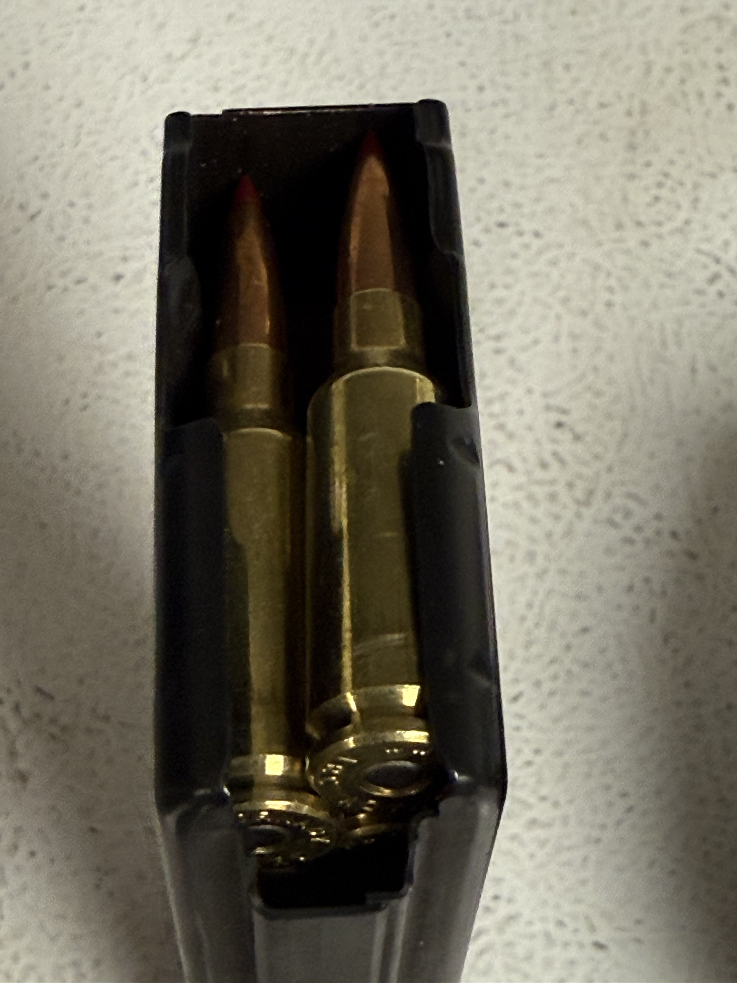

    2 new mags . Both feed fine from left side but right side nose dives and hits from by of mag.
    Discovered while shooting match. But do it when unloaded by hand also.
    Anyone else having issues ?
    Have you tried backing them down to 28-29? Just curious to see if that helps. I know it's not ideal but its worth a try. Given the cost of the mags I would contact them.
    Yes the pictured mag only has like 5-6 rounds in it
    That sucks. I would have taken that mag apart and checked the follower for any mold seem type issues or anything else that could cause the follower to drag or stick. If nothing obvious I would be on the phone with G asking them WTF.
    They were brand new from eurooptic. Cost me 2nd or 3rd place at match. Ended up 5th. Going to send them back they were the only ones I could find. $240 total for 2 !
    Other guys to include g people at match said 108eld doesn’t feed well from them
