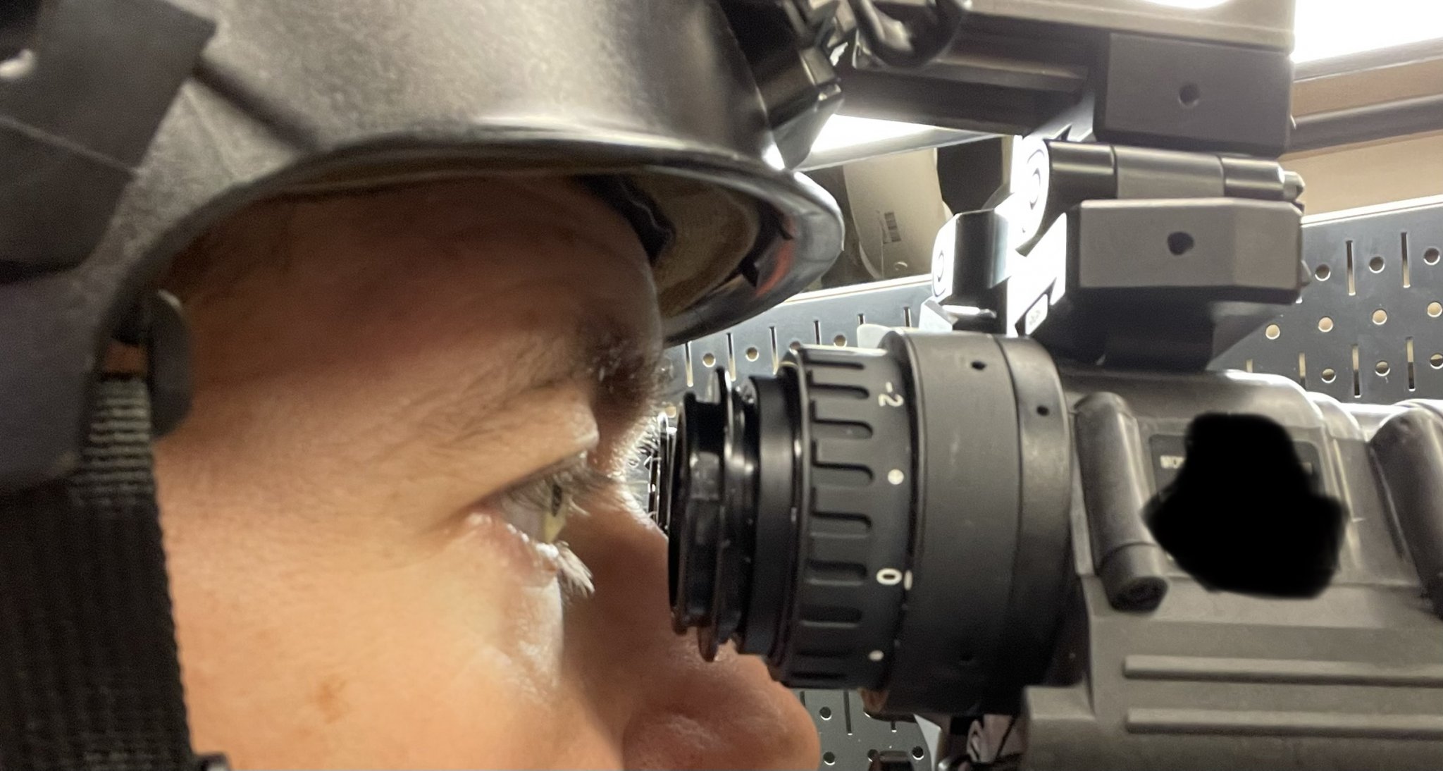

    Well I am the exact opposite. I own a G24 and it collects dust in the dustbin. I run the Rhino 2 with Dovetail exclusively.
    Much better mount all the way around IMHO. I run my NODS way out and can put 3 fingers horizontal between my eye socket and the ocular of my NODS to the point that my FOV is reduced to 20 Degrees. I know that it is 20 Degrees because my COTI then fills up the entire NV FOV. :)
    I run NODS way out for various reasons, stops fogging up in hot humid sweaty environments and allows me to easily see around and under my NODS.
    What kind of arm/s or NODS are you attaching to the Rhino II. That might be a lot of the problem depending on where the MALE Dovetail shoe is centered on your NODS. My Mod Armory mounts all allow plenty of adjustment of the MALE Dovetail shoe such that you have a lot of ability to adjust everything just the way you want it.
    Now to possibly solve your problem. Put a thicker brow pad in your helmet. It will push the helmet and your NODS out further from your eye sockets. You can take out some of the rear padding (nape chinstrap) or if a ratchet type suspension just loosen up so the hemet pushes slightly forward.
    There are additional ways to thicken up the front brow pad also, just use you imagination.
    I rig up helmets and NODS to fit everything from Midgets to Neanderthals :LOL: and the Rhino 2 has always worked very well in that setting.

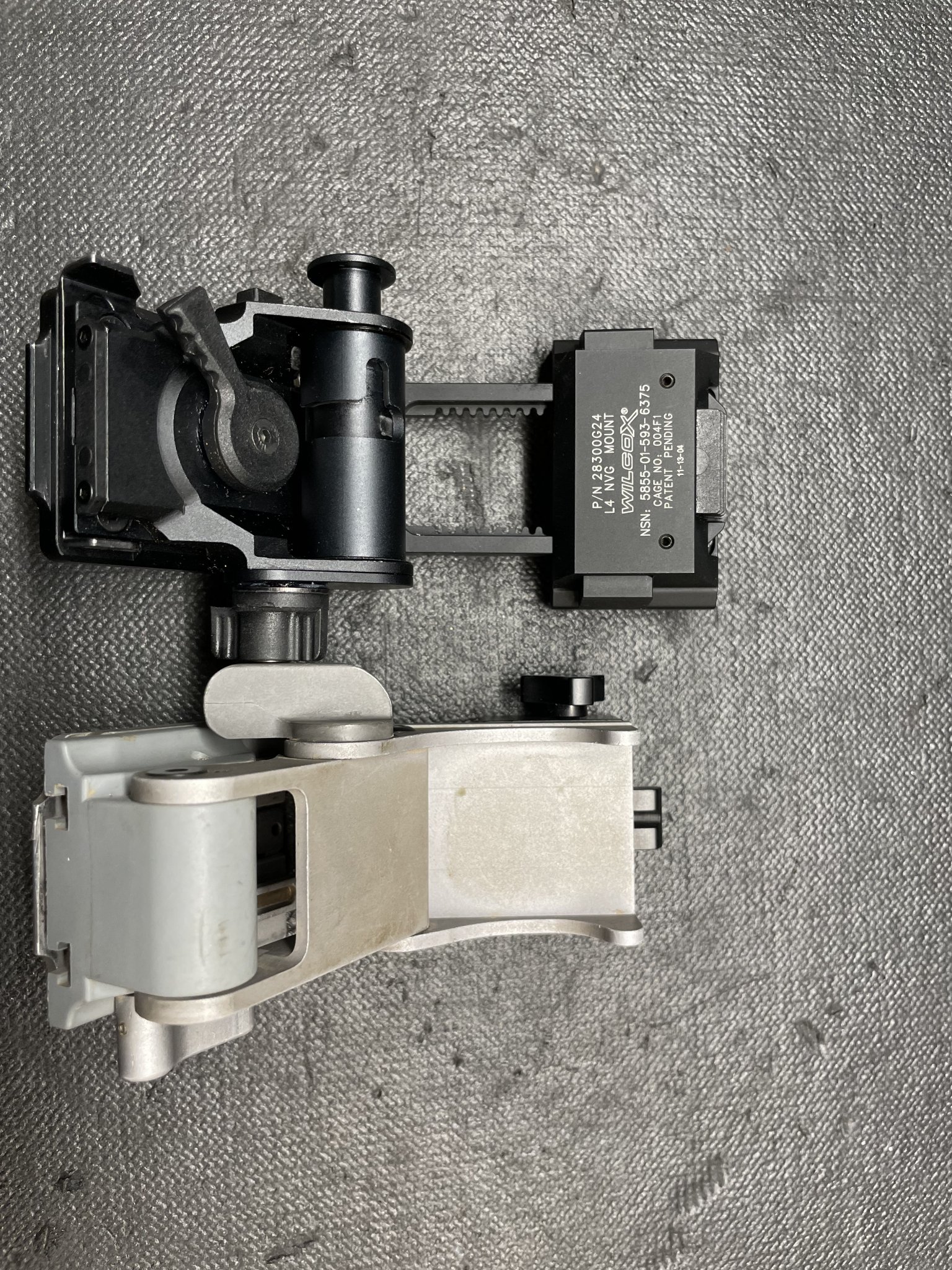

    So all the current data I am looking at shows the (current) Wilcox G24 and G22 (extended) have fore/aft travel of 1.4 inches.
    Norotos site says the Rhino 2 has fore/aft travel of 1.4 inches. On TNVC's site they say the Rhino 2 Dovetail has fore/aft travel of 1.6 inches.
    So I do not see that you would gain any additional travel going with the Wilcox iterations.

    I actually thought Wilcox was less travel and certainly isn't an infinite adjustment like the Rhino

    It would be great if I could get that much space. I’ve got the dovetail socket adjusted all the way out in this photo. Using a Mod Armory D14 bridge. I can feel it touching my eyebrow hairs at times. I haven’t tried thicker helmet padding yet, just the standard pads that come with the TW Exfil.

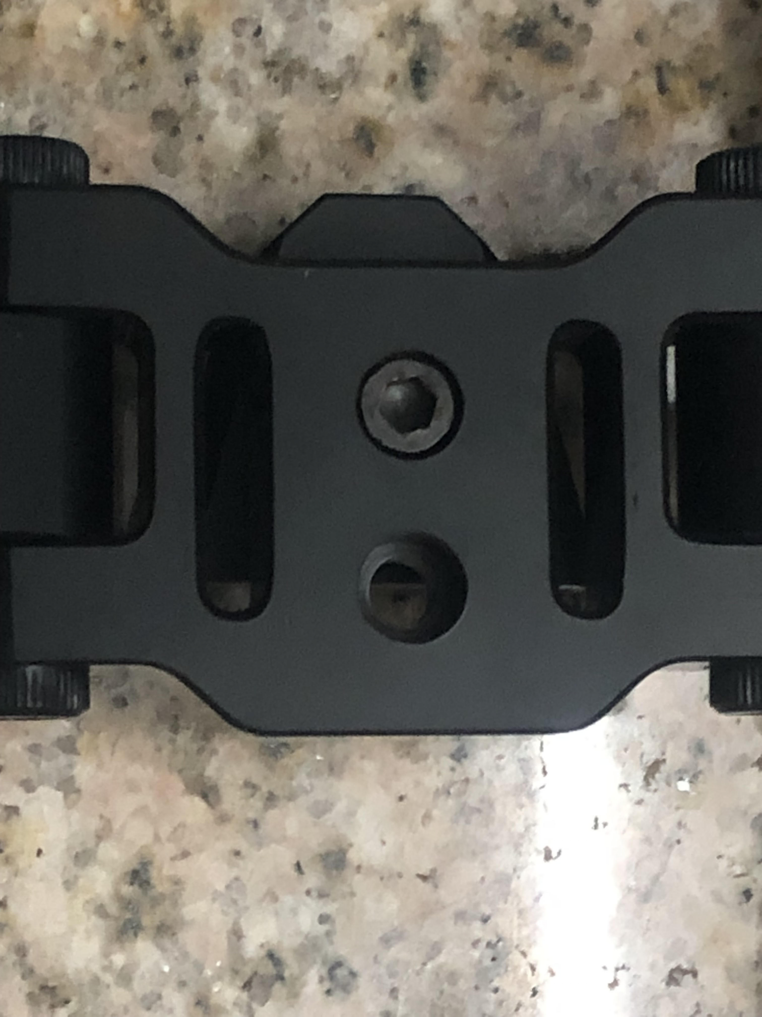

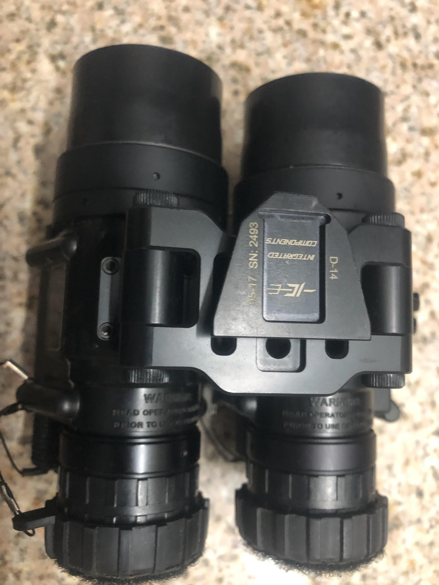

    I cannot tell from that photo if you have the Male Shoe on the Mod Armory Bridge in the right hole to give you maximum travel away from your eyes. There are 2 positions you can have it in. See my photos below.
    In these photos I have the Male Shoe moved into the hole closest to your helmet. That gives you the maximum travel of the Bridge away from you eye sockets.
    Reactions: Rerun7
    That’s awesome, I did not realize I could move the shoe on the bridge! Mine was on the closer spot, that should make a big difference. Thanks!

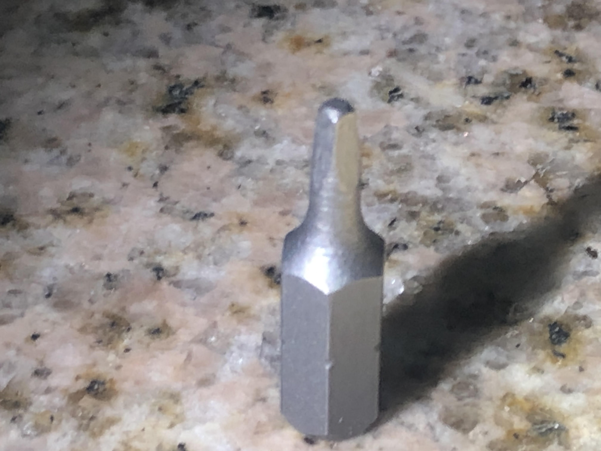

    Any advice from you guys on how to remove the roll pin for the dovetail conversion without destroying it? I used the paper clip trick on my last one but it didn’t seem to help.
    Take a little bit of oil and put down the roll pin hole. Then take a tiny tapered square driver bit that the point will fit down in the roll pin but that thickens so the 4 square corners come into a tight contact with the inside of the roll pin. The 4 square corners will bite into the inside of the roll pin wall. Spin the roll pin to around a few times "to soften her up" then put a small set of needle nose pliers on it while the tiny square driver is inside and pull out. Works like a charm for getting it out. Lube always helps situations. :LOL:
    Take a pair of channel locks and put electrical tape on the jaws so you don't scratch up the Rhino mount on reinstallation of the roll pin.
    Use a new roll pin.
    Hard-to-Find Fastener 014973222734 Tension Pins, 3/32 x 1/4, Piece-30
