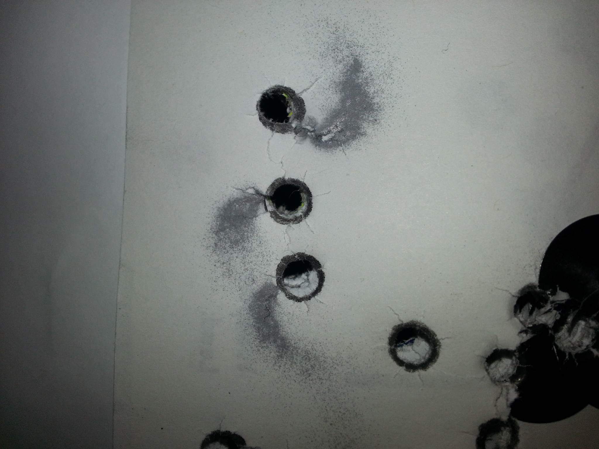

If you look at this image from Dave Tooley, this is what happens when you go aggressive
Off center and tearing the jackets to spill out the lead
