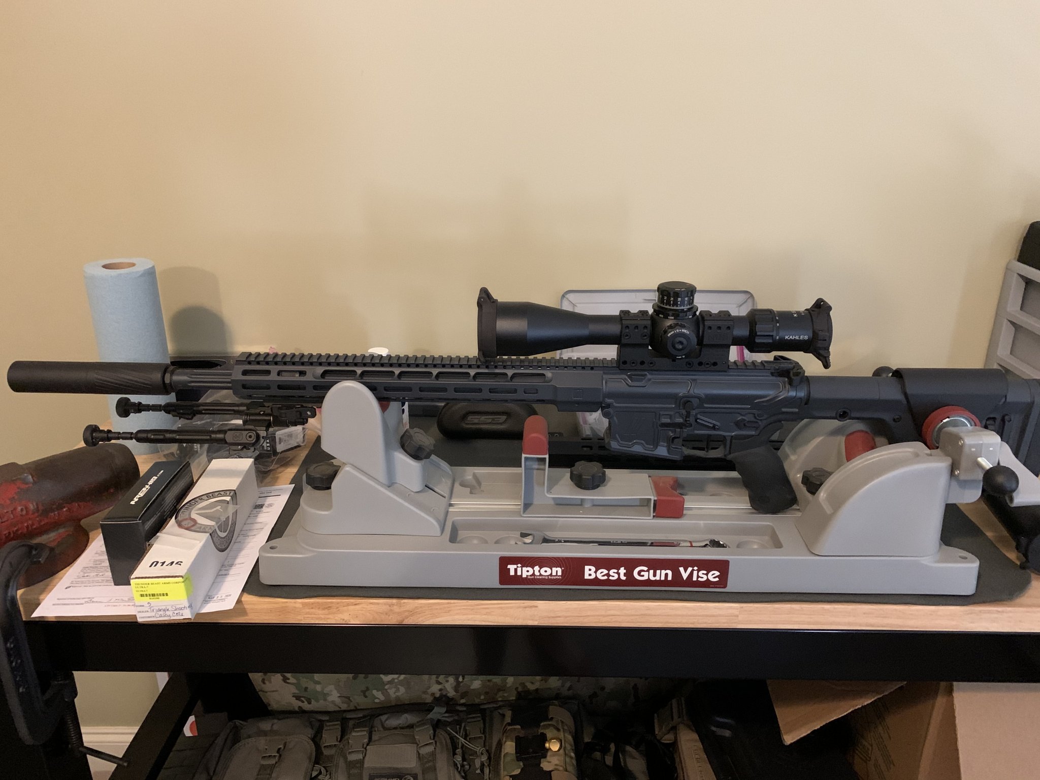

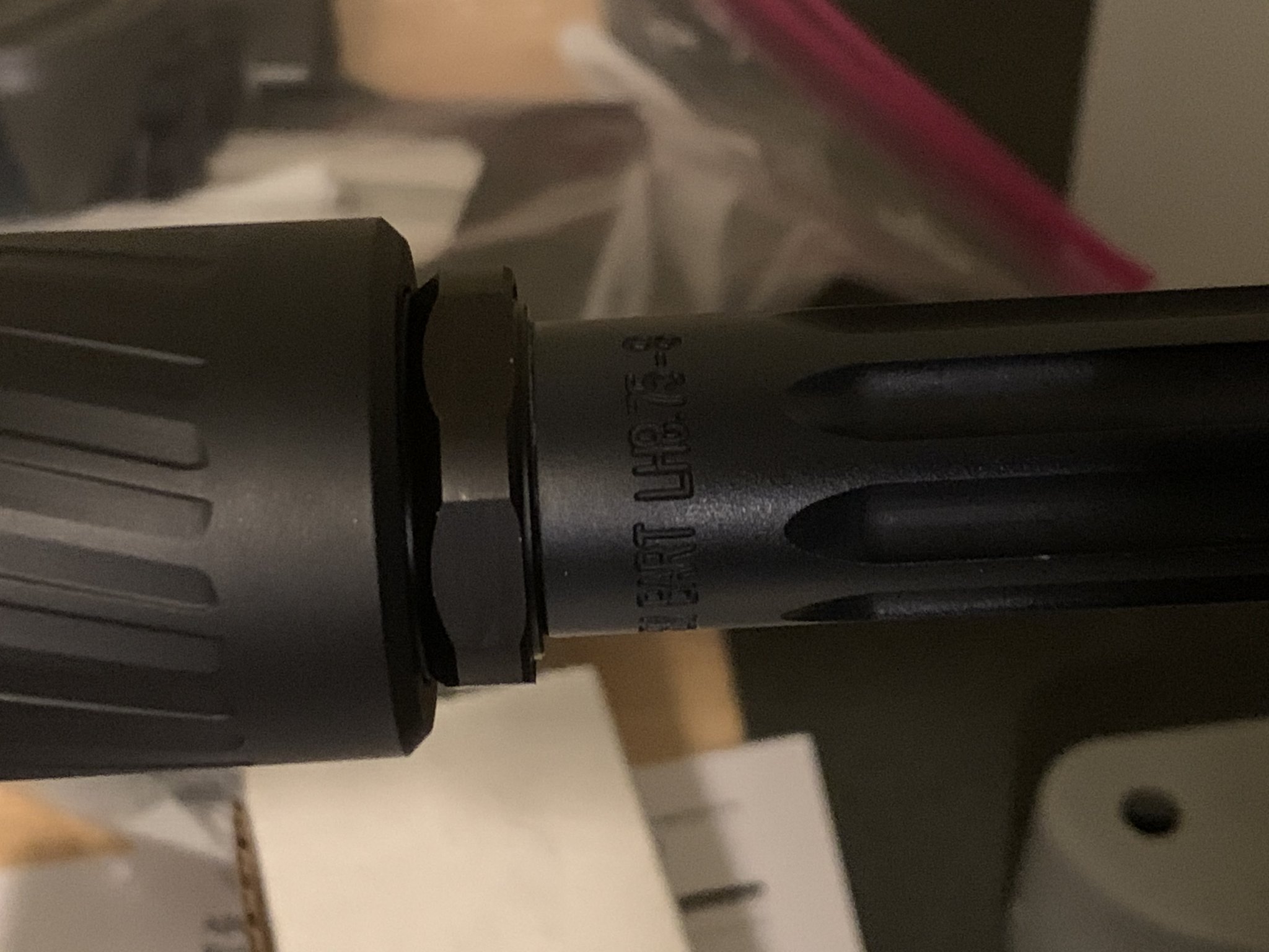

I heard about the whole gain twist thing through the everyday sniper and ordered a gain twist Bartlein from Compass Lake Engineering in 223. Here in the formerly great state of Kalifornia I am fortunate enough to shoot squirrels with unleaded bullets (thank you government overlords) and am also very intersted in 223 for long range, as here in SoCal long range is relative.
I can say I've killed quite a few squirrels with unleaded ammo, which is a whole new set of problems when it comes to reloading. I am going to start doing some long range (again, relative to SoCal and 223) testing soon and will post updates.
