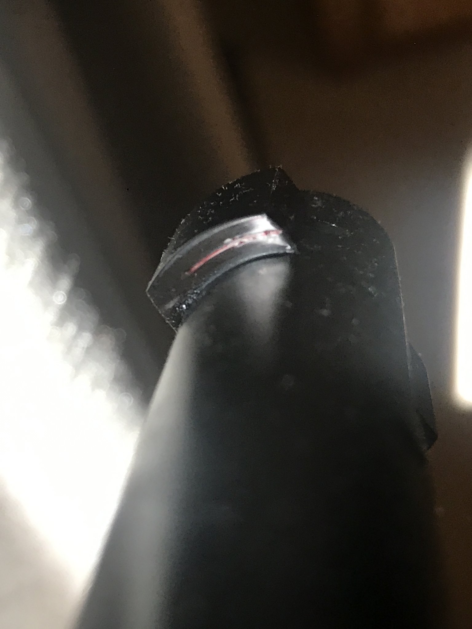

I recently got a new HOWA Oryx in 6.5 CM. The gun shoots well but I've noticed that the bolt takes quite a bit of force to open (compared to my Bergara B-14 HMR anyway). I was looking at the bolt head the other day and I found a gash in one of the two lugs (this is the top lug when the bolt is in the locked position). I've been sure to properly lubricate the bolt from the start. This looks to me like there is a burr on the surface the lug mates up to.
Since I don't seem to be getting good contact on this bolt lug, I was considering lapping the bolt lugs but I don't have the tools required to remove the barrel from the action and I think it would be very hard to fully clean the lapping compound out afterwards.
Is this a problem or should I just shoot the gun and keep an eye on it? As I said, the gun seems to be shooting well.

Lapping is for mating machined surfaces, not for fixing what you have there.
Call howa and have them rectify it under warranty.

Do you lube the lugs?
It doesn't look like it
Also, the cocking cam needs it.
Lube both of them and test it again. Let us know if it helps or fixes your issue.
Do you live the lugs?
Thanks for the suggestion but I have been lubing the lugs and cocking piece. I wiped the lube off so I could take a photo of the lugs. I use the same procedure I've used on all my bolt guns and none of the others have this issue. Neither does the other lug on this bolt gun, for that matter.

Update: I called Legacy Sports and they sent me a shipping label. They told me they would try to prioritize my rifle since it is a replacement for another rifle that also had issues. Here we go again...Lol...
Update: I sent my rifle into Legacy Sports due to the bolt lug galling issue and lack of contact with one of the lugs (the one that is galling). They sent me an e-mail yesterday telling me they are replacing the rifle and asking me for my FFL information.
