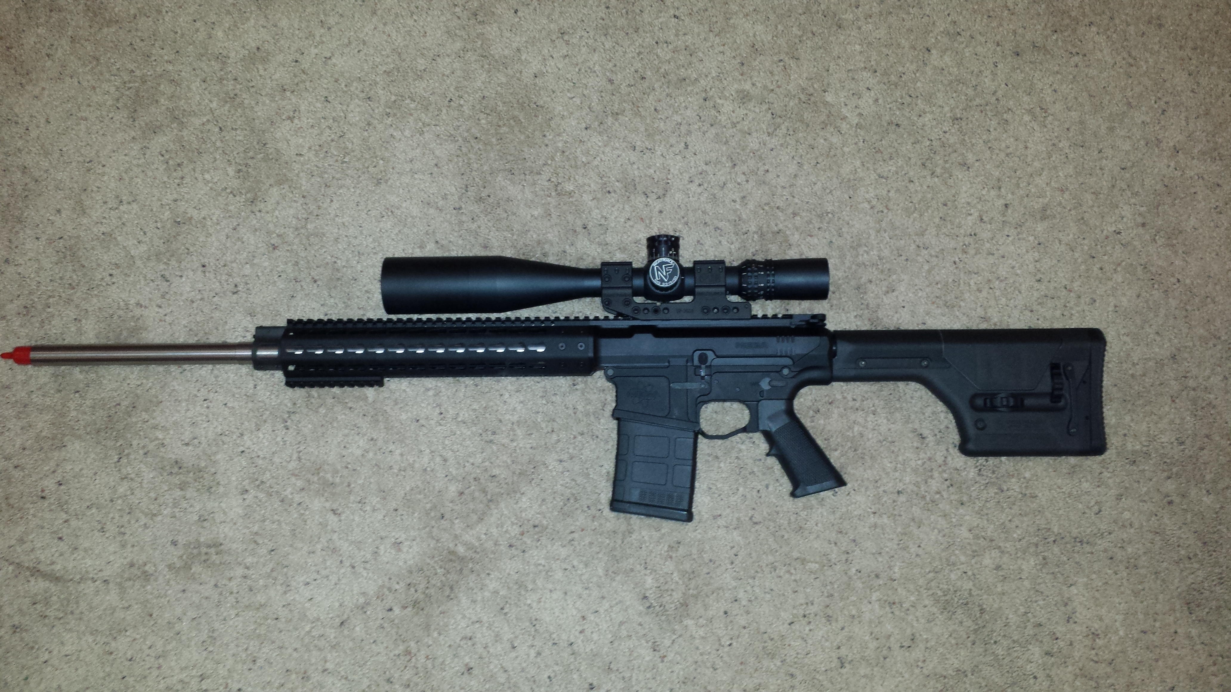

almost forgot, my ar308 spec mega maten with 24" 1 in 11 twist 3 groove lilja no sign of pressure in my rifle so work up your own loads. 185 juggernauts loaded to 2.800oal 45.0g cfe223 2655fps average 27es 10sd 42.0g h4895 2661fps average 37es 12sd

mega maten rifle length keymod lilja 24" 1 in 11 twist cmmg bcg dpms buffer,spring and buffer tube geissele hs national match magpul prs and miad spurh scope mount 3.5-15x50 NF
