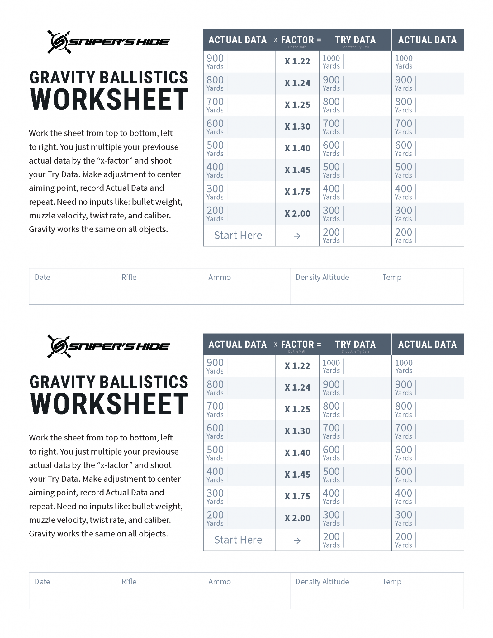

Here dope your rifle with this chart it's much easier, after you do this, you can put the trued data into AB
I think the sheet should say bottom to top, left to right, rather than top to bottom. Everyone should know that already but there’s a ton of idiots among us.
Ya that’s that wrong one, my bad I didn’t look close at the image, I’ll fix it with the right one. It was a mid-project change I had on my computer prior to the adjustment of the text. My bad on not paying more attention
