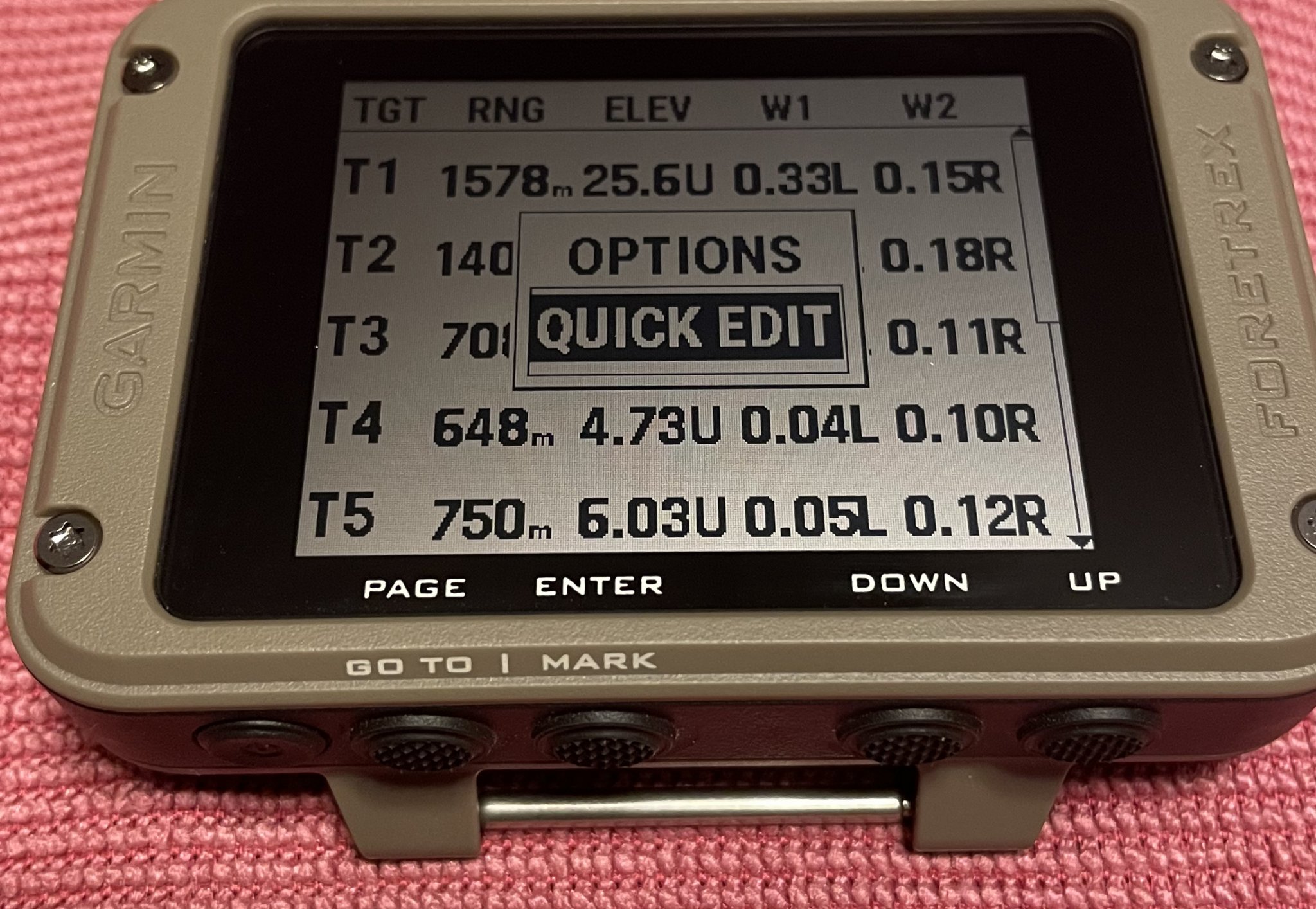

Kinda cool workflow with the new Garmin 901:
From the main Applied Ballistics screen
Press the enter button to bring up the options list and select target card

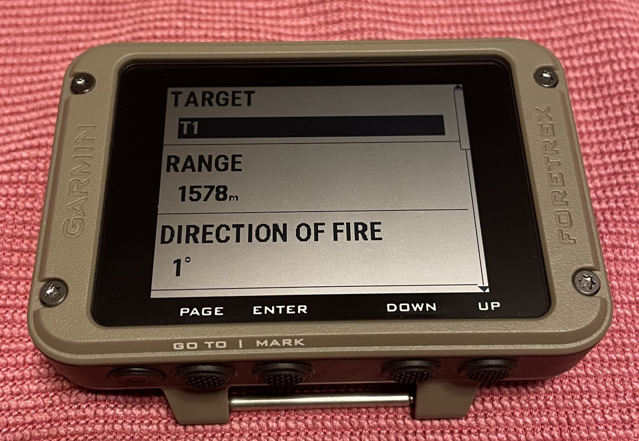

Press the enter button and select quick edit
From this edit screen, use up/down to select a target from the list
Press enter to modify the target information
From this screen you can use your connected rangefinder to range the target and automatically update the range on the Garmin. Press the page button to drop back to the target card screen and select another target to work through your list. Works pretty darn well.

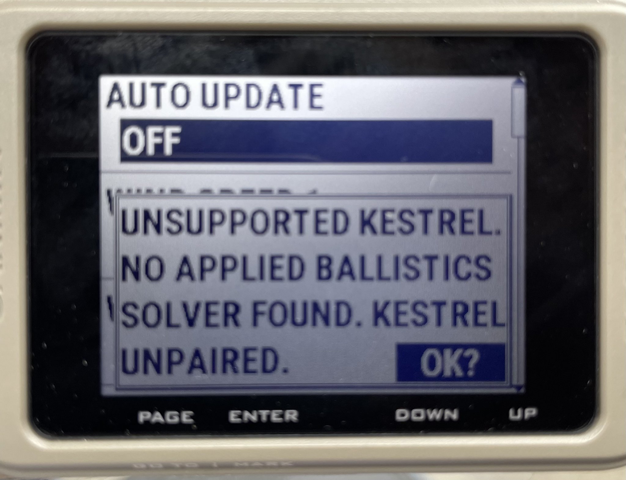

Annnddd, another Garmin fail. I cannot connect my Kestrel 5700x to the Garmin 901 for environmental data import. I get this message, "UNSUPPORTED KESTREL. NO APPLIED BALLISTICS SOLVER FOUND. KESTREL UNPAIRED."
Anyone else getting this error?
Garmin tech support is rubbish. Kestrel confirmed that it is a known bug with the Garmin Foretrex 901. They were able to offer a workaround fix by doing a "soft reset" on the Kestrel 5700X. I confirmed that it did work for my setup. Here are the exact steps I did to get it to work:
  1. Turn both devices on
  2. Have the Kestrel set to Bluetooth in PC/Mobile mode
  3. On the Garmin, go into Connect screen and scroll down to "Other"
  4. Select "Search for new" and let the Garmin find the Kestrel, but don't select it yet
  5. Power off the Kestrel, pull the battery and hold down the power button for 30 sec, and then restart the Kestrel
  6. Once the Kestrel is back up, then switch to Garmin and select the 5700X that was detected in step #4
  7. Give it a few seconds, but it should now show "connected" under the "Other" setting
  8. Use page button to switch back to the Applied Ballistics screen on the Garmin
  9. Press enter button and scroll down to select "Environment"
  10. Change "auto update" setting to "on"
  11. Weather data from Kestrel should now immediately update to the Garmin
  12. Currently the update interval for weather data is fixed at 5 minutes, but I confirmed that you can trigger an instant update just by repeating step #9. Just going to the environment screen on the Garmin seems to grab new Kestrel data.
Good luck!!

There are instructions for getting this to work on our support site at Pairing with Kestrel.
Ha, that didn’t work. That is why I contacted Garmin Tech support. Garmin didn’t even know it was a problem with the 5700x. Kestrel tech support immediately knew that it is a known bug in the Garmin device and at least offered a possible work around.

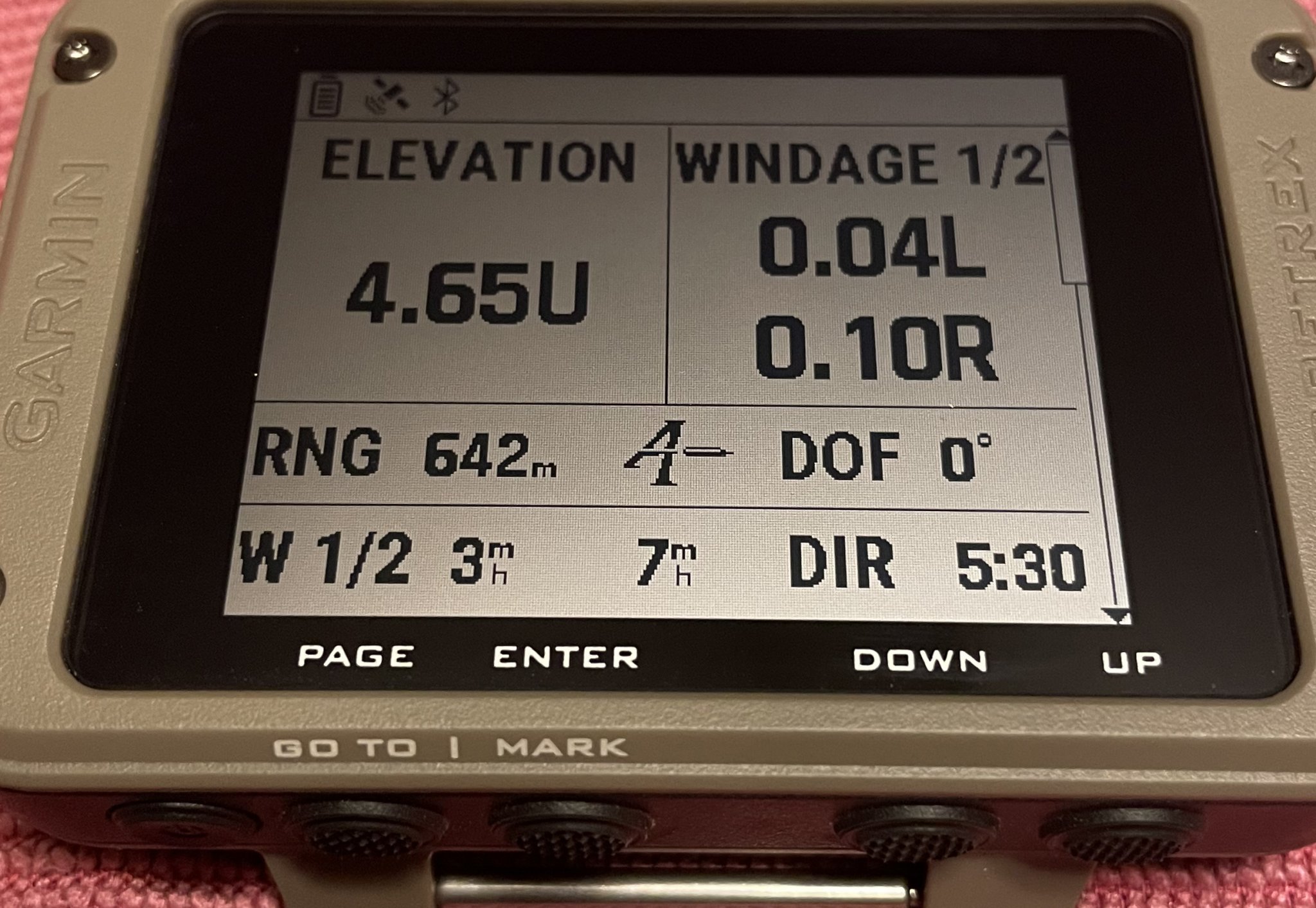

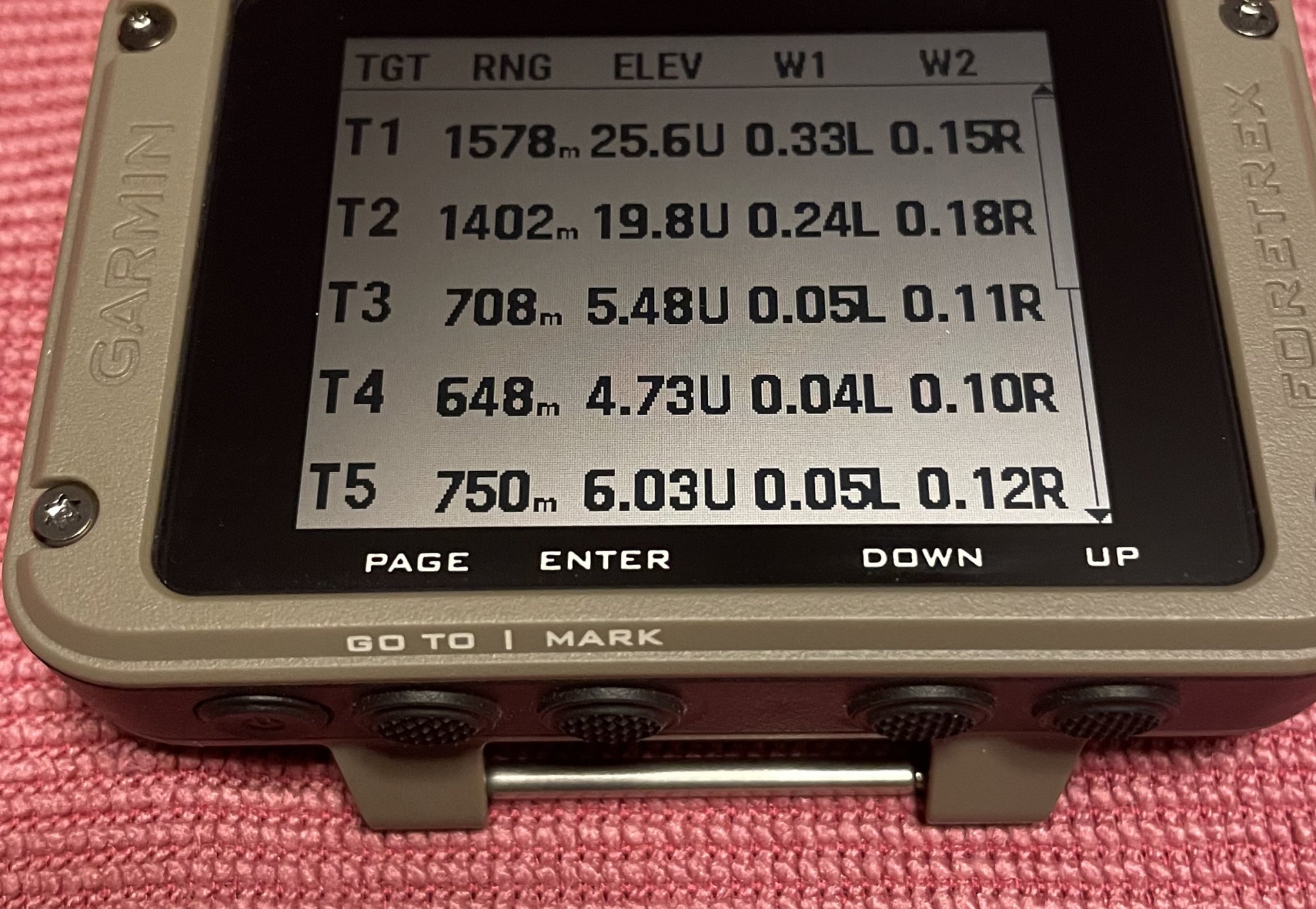

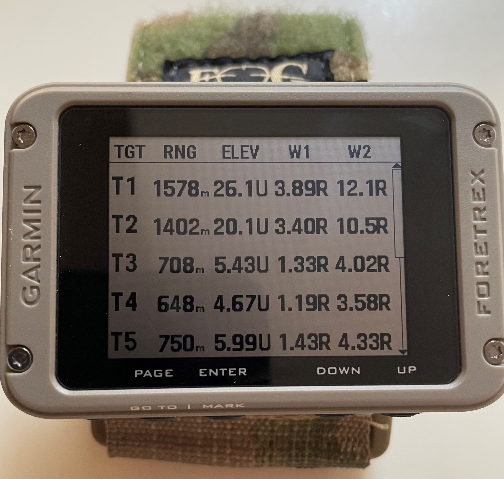

Is there enough screen real estate to show W1 and W1 on the range card?
Yes. Here is a close up pic of the range card.
Thanks for the picture but isn’t that the target card?
I’m asking about the range card that you scroll through at a given yd increment. On the 701 they only give 1 column after the elevation column and I always thought there was enough room for 2, ie. W1/W2.
Yep, same deal on the 901. Definitely looks like there is plenty of space, but only shows wind 1. You can press enter button and select "change fields" and toggle wind 1 to wind 2 though but that's a couple of presses away.

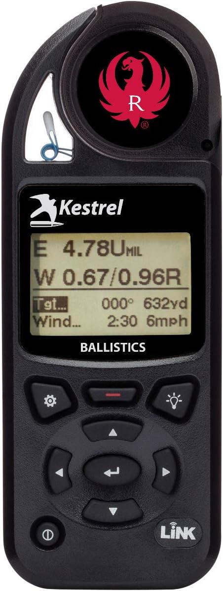

So if I'm understanding is correct for compatible weather meters this one would work?
I think it needs to be the “Elite Ballistics” model, which runs Applied Ballistics software, the one you linked might be running ballistics software proprietary to Kestrel. I could be mistaken though.
Thanks, what I ended up doing is getting the 5700 Ballistics edition. I figure if it does not pair with the 901 I can always upgrade the firmware.

Im curious about the direction of fire to wind direction calculations , if i pair some fury5000’s with ab , and a kestrel elite . Will this unit use the compasses to set the wind direction to each target ? Because if im shooting a match where the targets are at various angles and this unit messes up the wind angle cause it cannot do different comparisons between wind angle and DOF it would be really dissapointing . Also it says range only so im guessing it does not send direction and inclination from the fury’s
No, it only sends range data from the LRF. DOF and wind cosine are manually entered on the 901's environment screen. When I was in staging areas, I would measure wind with my Kestrel and load a high/low speed and leave it at 3 o'clock. I would just do the math in my head to adjust for DOF. With the time I saved not having to write ranges, etc, I don't feel too rushed doing a quick wind cosine adjustment. I'm sure they can start pulling more data from LRFs in the future with firmware updates.
