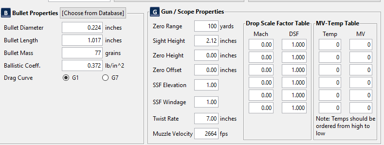

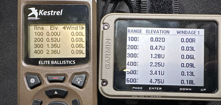

I've been experimenting with two devices and I'm curious to know if anyone can explain why their calculations differ slightly.
The difference is probably minor, just a few mils? but I'm still interested in understanding why. Or this is completely normal between two different devices.
Both devices have identical profile settings.
Profile from Kestrel
Profile from Garmin

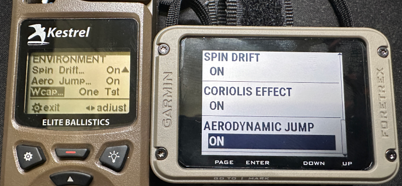

Probably a mismatch of environmentals or the various earth based effects enabled/disabled between them (DoF/Wind direction, Coriolis/ Eotvos, Spin drift, Aerodynamic Jump)
Reactions: TRAINERRANDY
That’s def where I would start. Zero the wind. Turn of Aj and spin drift. Make the DoF 000 and go from there.

So a couple things here.
1) Did you lock the environmentals, and are they exactly the same? If you don't lock them they will continue to update in your hand.
2) Did you double check latitude is the same in both?
3) Are all secondary effects equal?
4) Check the range card. Specifically check your Wind Hold, Remaining Velocity, and Kinetic Energy.

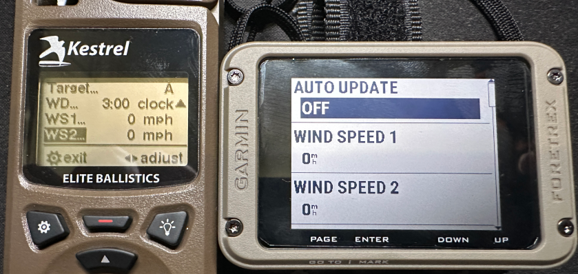

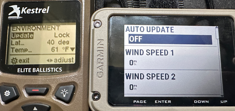

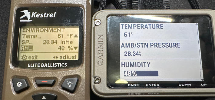

Thanks for all the suggestion. Here is some screenshot after I lock the environments.
What is the secondary effects? Thanks again.
Wind are all zero
Set the Temp SP and RH the same
Auto update off
Leave the setting default

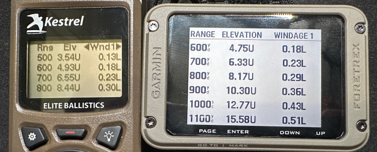

Range Card below. Start with the 100 yards is already 0.02 difference.

Secondary effects are what we said above. Spin drift Aj etc. turn all that stuff off.

Also you need to set your latitude, and firing directions the same. I see the results are becoming much closer. Once you are within say 1 click of a turret or two. That is considered within rounding.

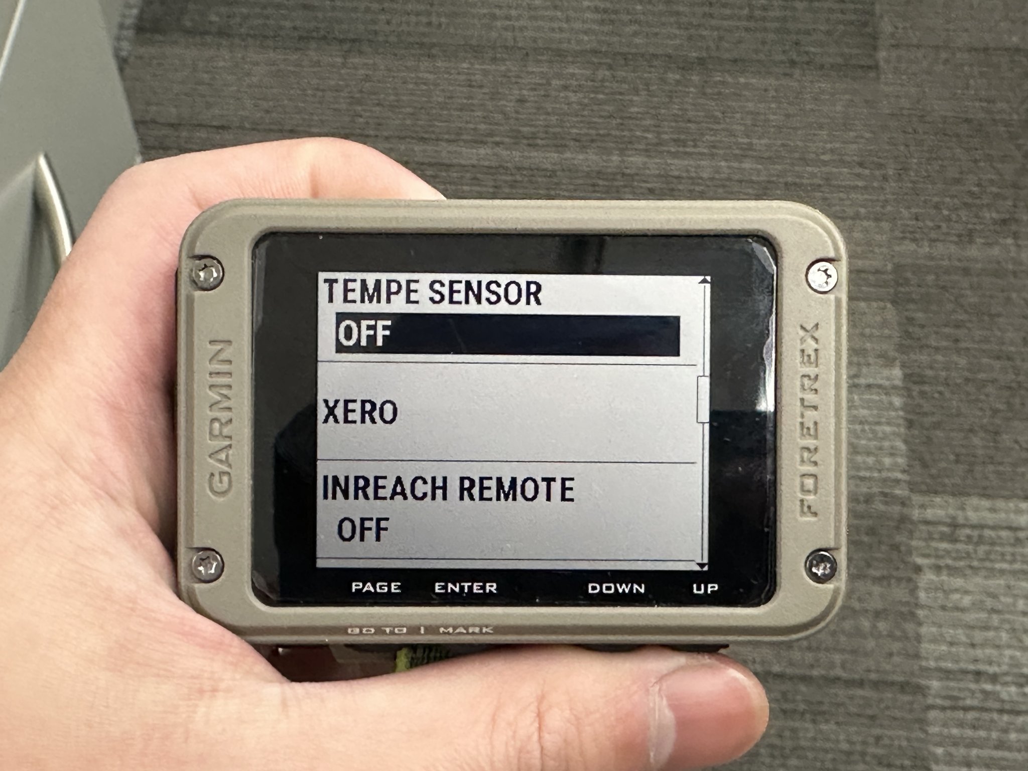

Also, remember that the Garmin 901 does not have internal environmental sensors...gets them from an external source. If you are trying to compare ballistic output to the 5700, make sure you manually set the Garmin's temp, RH and pressure to match.
Ah totally didnt know this. So i guess i will need to pair to kestrel all the time. Thanks
Yeah, it's kinda lame. Just set 50% humidity, 65 deg and your typical pressure for your area and I bet it will be pretty darn close most of the day. Adjust as needed.
Not true. It has an internal barometer and pulls latitude (Has to pull temp from a Tempe, and Humidity set at 50%). Which is why you have to turn auto update off and set everything the same. FYI my Kestrel and 701 match for all my loads with everything setup the same. I would sure think your 901 would do the same.
Reactions: BeteNoire
Can the Tempe be paired to the 901 simultaneously with an LRF or only one device at a time?
Yea Looks like it. Under the connect page, it has its own Tempe Sensor option and the LRF is connected with AB. Going to get one Tempe and test it.
I use my Tempe with my Sig 2400 at the same time. That’s with a 701
Where will be the best spot to mount the Tempe? To get the correct temperature
I keep it in an inside pocket of my pack, or an outside pocket of an insulated jacket during the winter. If it’s overcast I have it on a lanyard attached to my tripod. It seems to read pretty much spot on as long as it’s not in direct sunlight. Only issue with my 701 I have found is it takes a little bit to update in my 701 when going outside during the winter when it’s really cold out. And that could just be because the 701 is an older product.
Yes it can be.
You want this away from your body (no artificial heating) in open out, out of direct sunlight when possible. I keep mine pinned to a strap on my backpack.
@DocUSMCRetired Got it. Thank you for all the help. Right now they are within <0.1 mil different. I will assume its just rounding different like you said.
