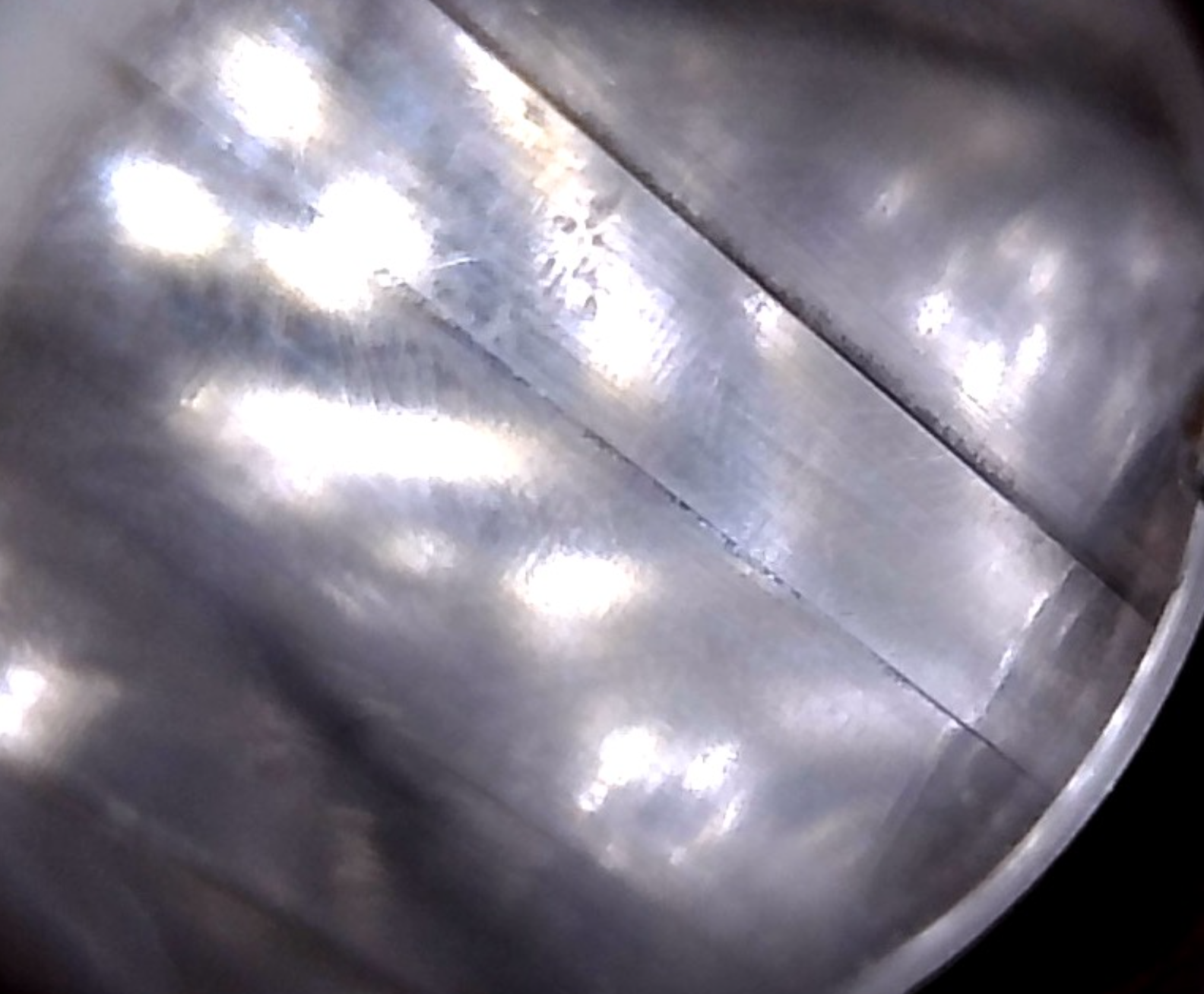

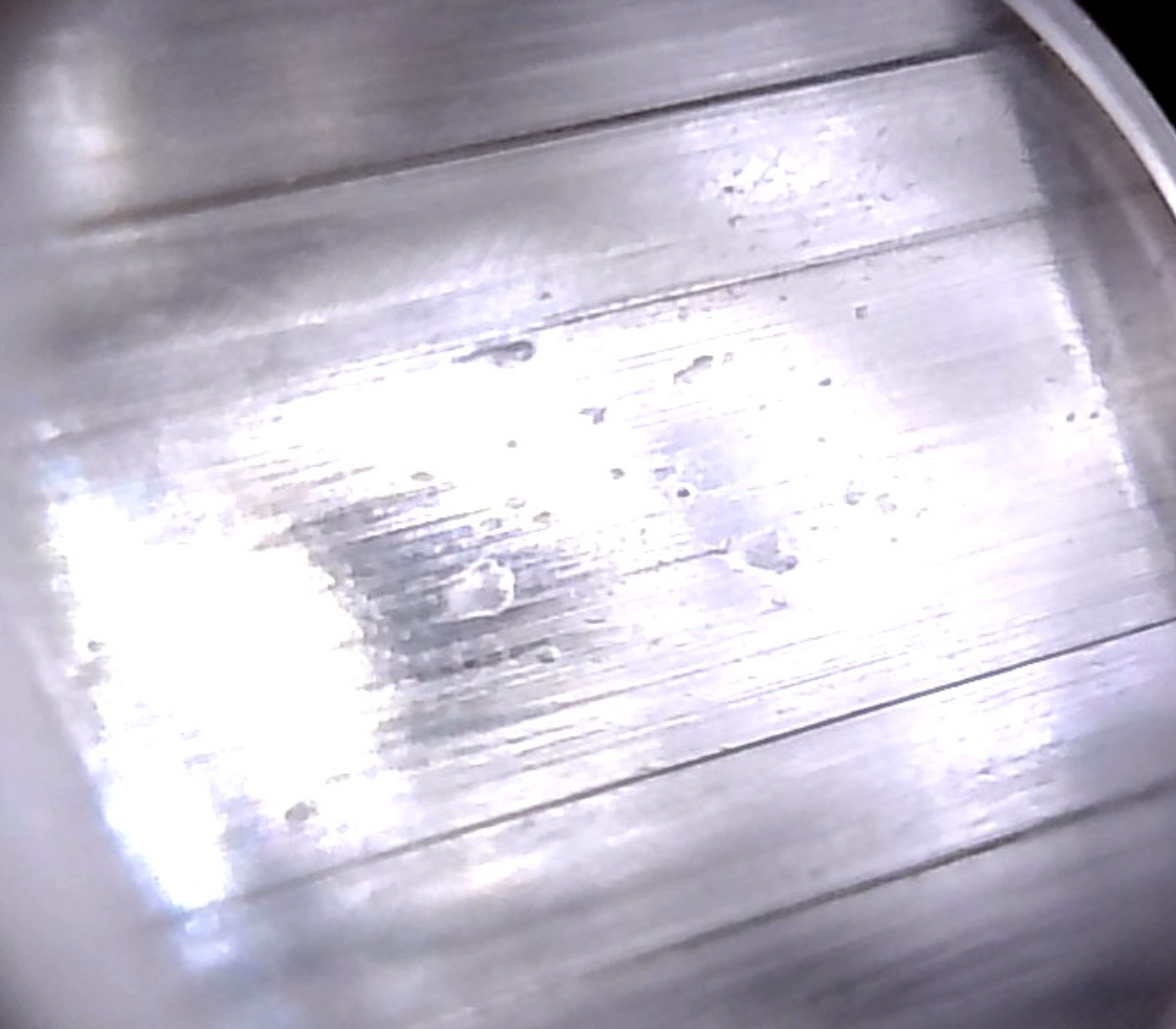

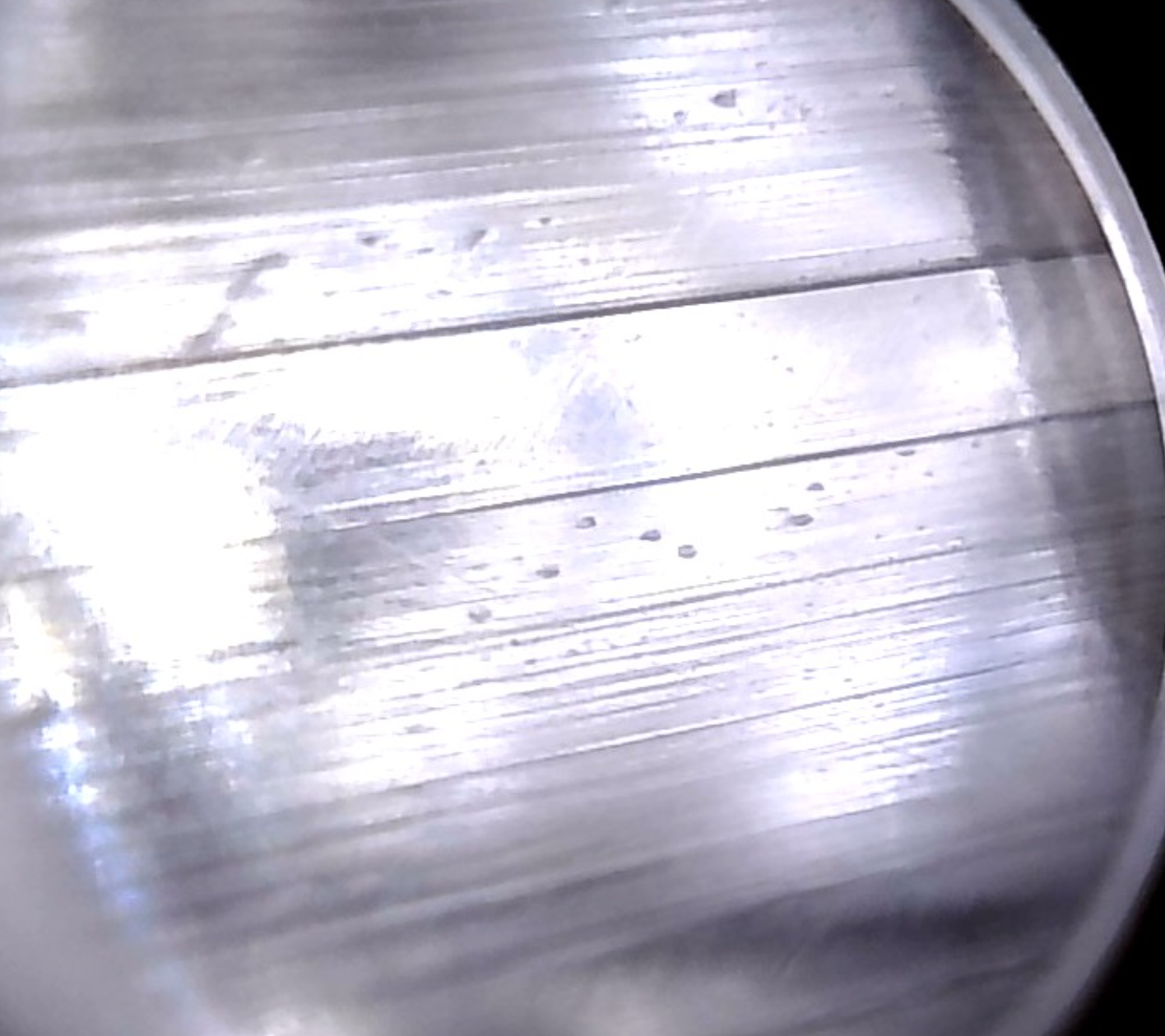

    I am wondering if anyone has seen this kind of pitting in your barrel, and what causes it? Shooting a gas gun I just picked up and it's really not printing groups that well.

    This isn't a casting
    The odds that wrought bar stock would have that many inclusions are simply astronomically low.
    99% sure those are corrosion pits. And before anyone says "but it's stainless", 416 will absolutely rust. Just not as quickly as carbon steels.

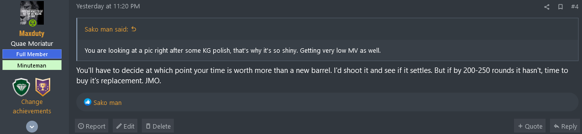

    You'll have to decide at which point your time is worth more than a new barrel. I'd shoot it and see if it settles. But if by 200-250 rounds it hasn't, time to buy it's replacement. JMO.

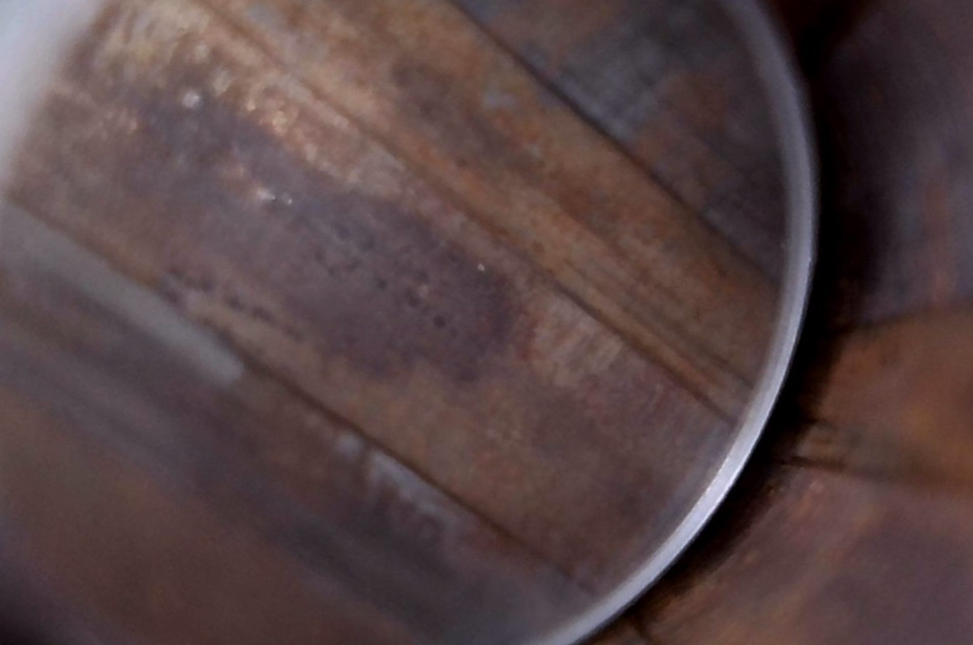

    Right here. ^^^I am obviously not the metallurgist you are. I mean the pictures show pitted metal, but that can't possibly be the case because you've never seen it before and it's highly unlikely that it exists. But feel free to explain how 416 goes that south after 250 rounds. I'm all ears.

    Corrosion doesn't care about round count. Time is the enemy
    Stainless will and does rust,the process can be helped along by using the improper (cheap steel) brush.

    The throat was caked with carbon, easy clean. But once I got through it there is a lot of cracking in the stele. So yeah..... I wouldn't call it mag dumb, but rather higher than stated round count.

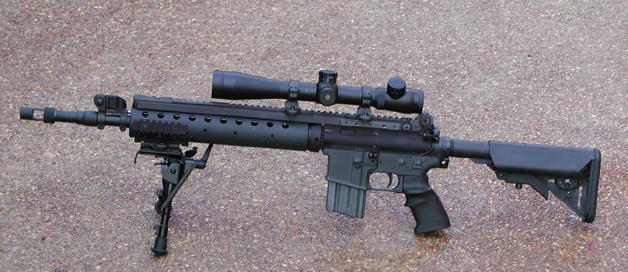

    I got a new barrel coming. PRI has been closed so looking for instructions to remove the hand guard.
    The accuracy is ok, 1.5 moa being smallest groups, most about 2 moa. I would like to get it to 1moa. But the MV is way too low, 2500... that's with FGMM, the other stuff I'm shooting is hovering around 2550. Doubt it would stay transonic for long.
    What handguard? The carbon fiber tube thingy is a lock ring at one end you just unscrew it with a spanner wrench or strap wrench or whatever.
    It's the Gen1 carbon SPR handguard, the early one. Has some tiny nuts on it... ok, there's a joke in there somewhere. It's a little tricky as there is that top rail. I have to look at it closer. A friend did get me the PRI site that covers some of this.
    Looks like its still a lock ring design but with a diff barrel nut than I remember
    Maybe there's a couple allens inside it for set screws or something but I bet it just unscrews.
    Is that gas block pinned on? When I had one it was a clamp I think. If it's pinned you'll have to bonk those out too.
    Reactions: Sako man
    The gas block just as the set screws, thankfully. Yes there's some tiny allen screws. Is the handguard attached to that top rail or are they both separate? If detached perhaps I don't have to monkey with it.
