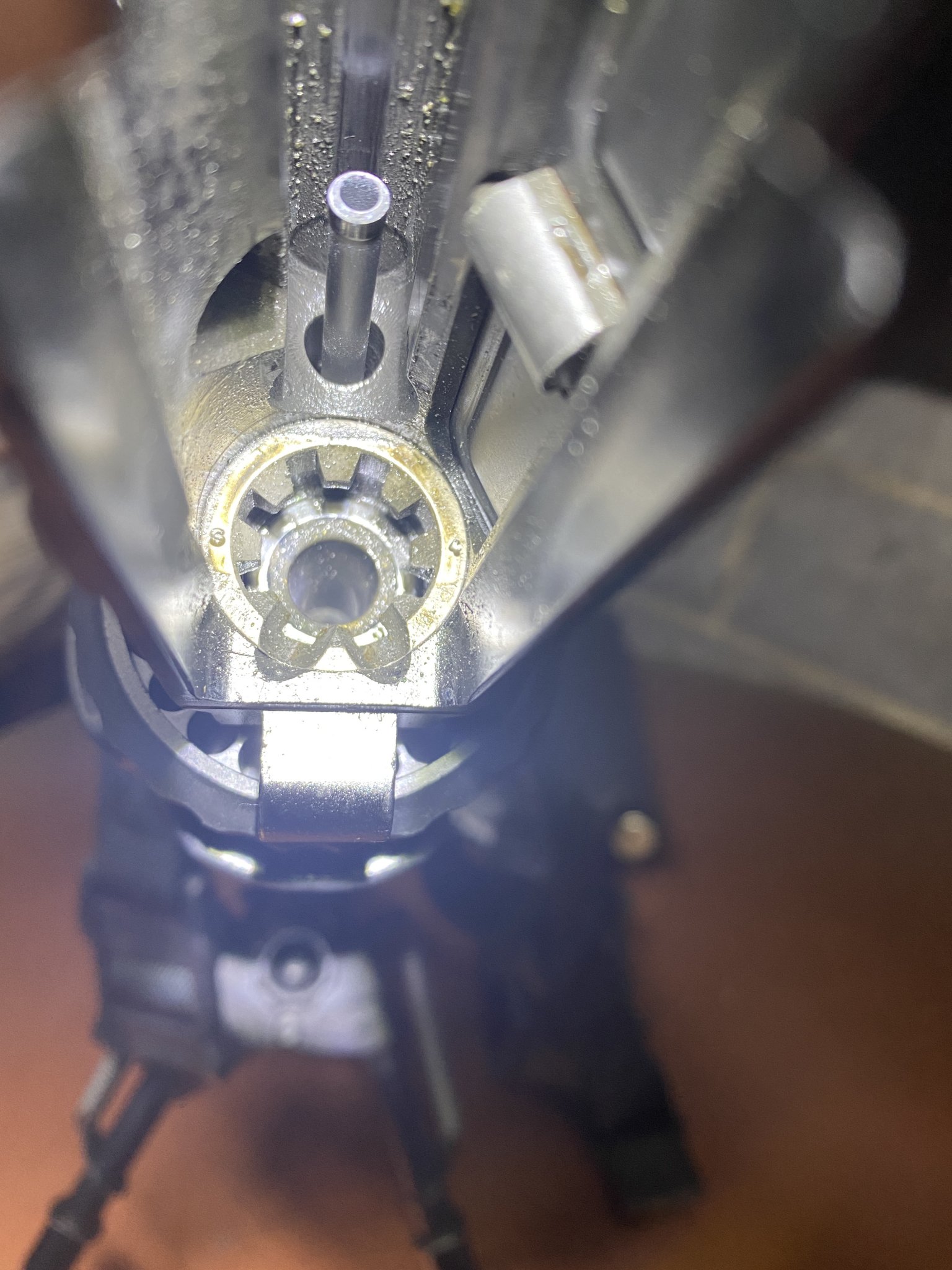

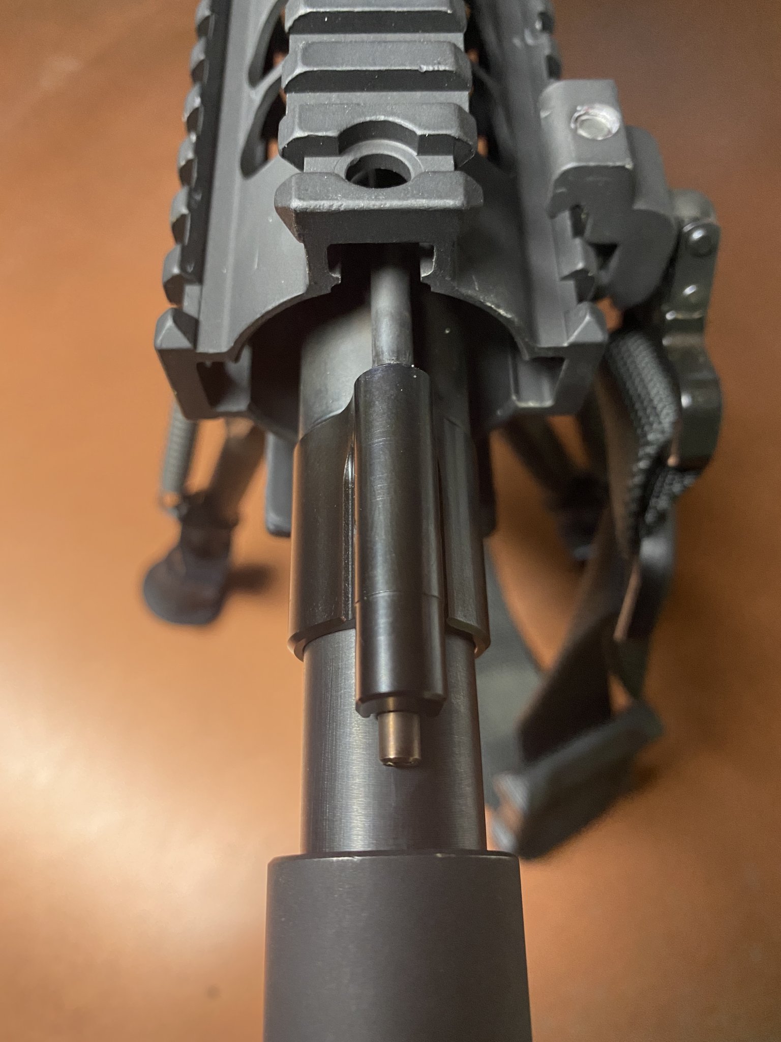

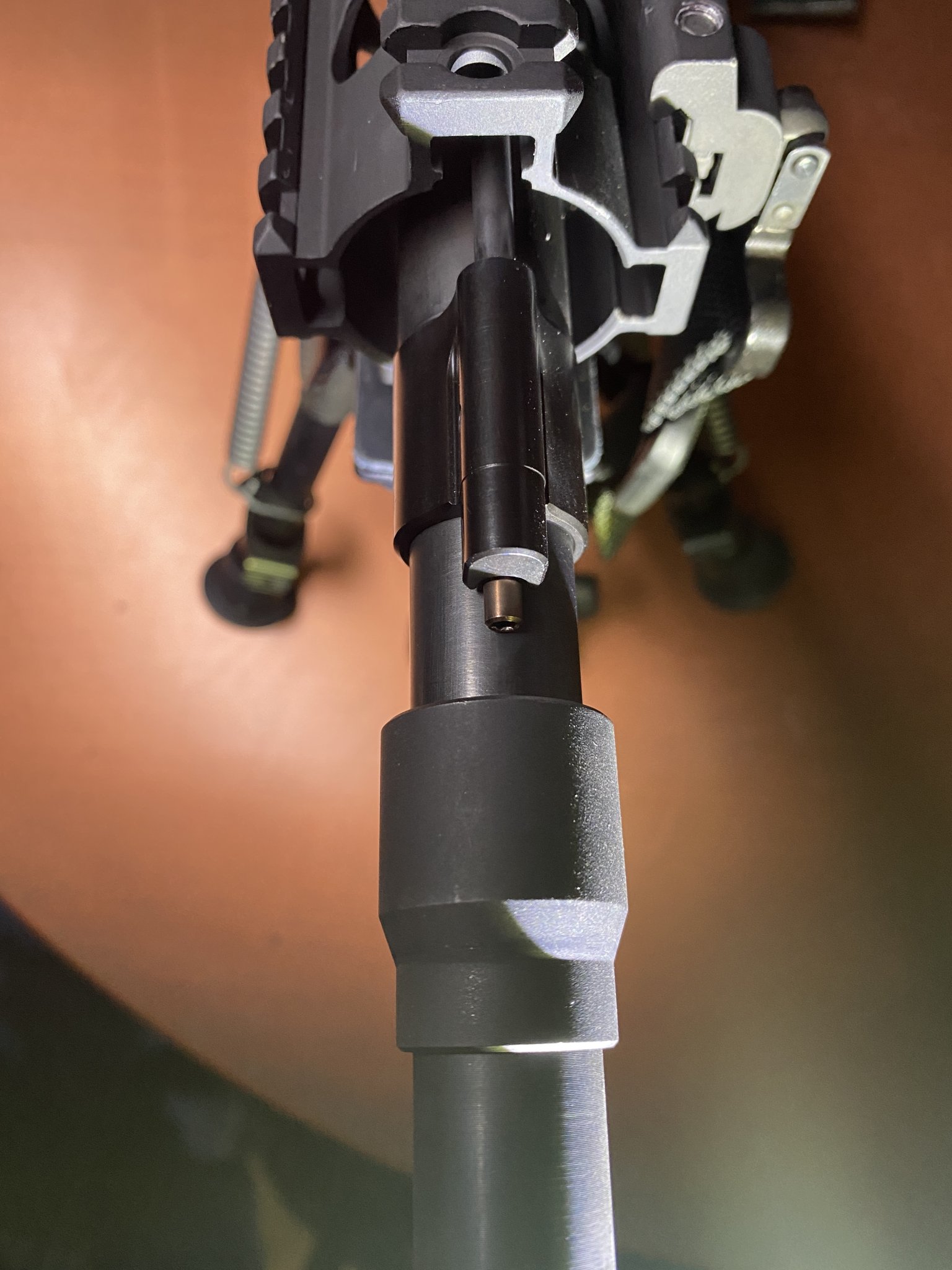

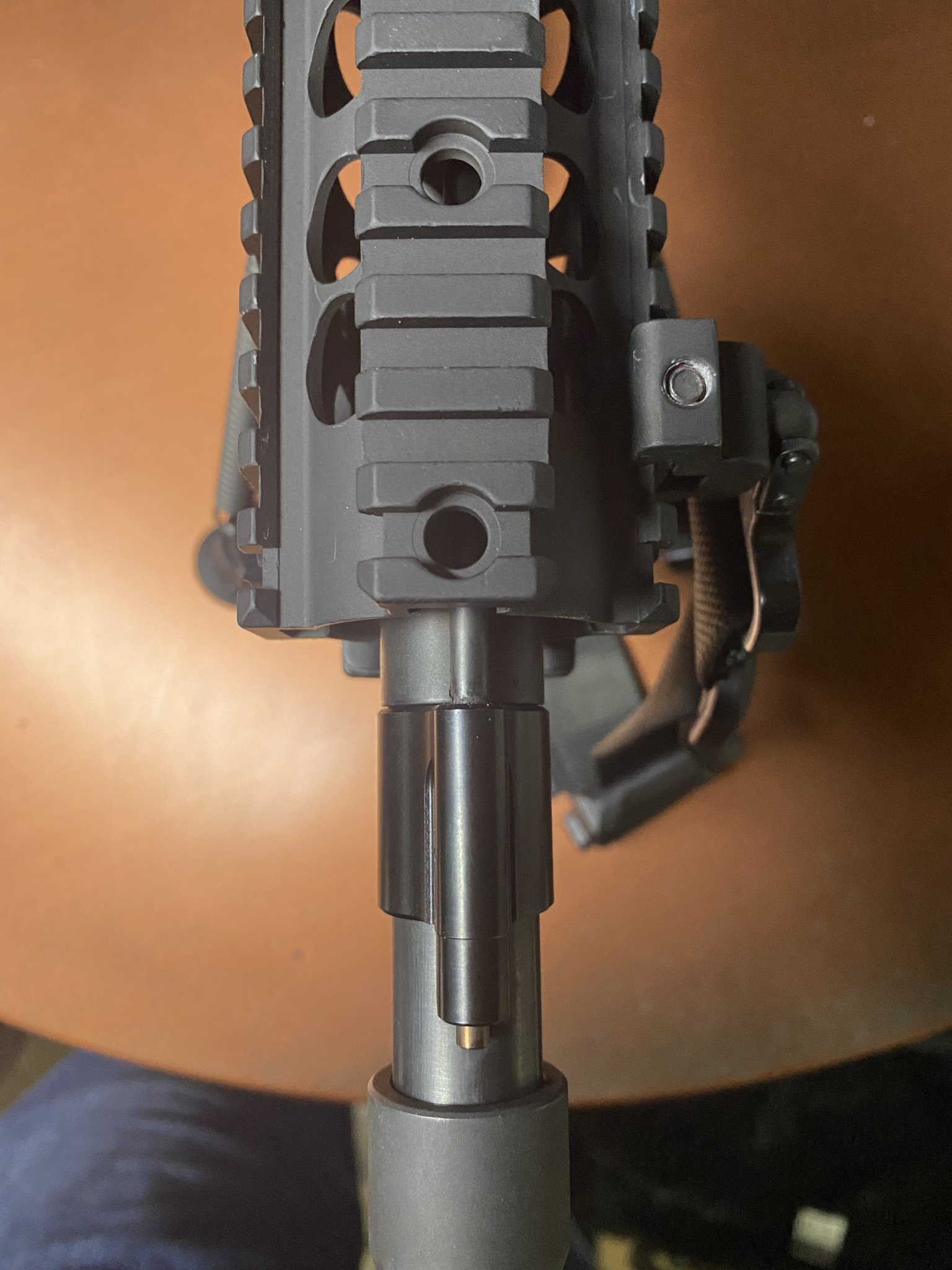

    Yea it’s definitely just a range toy, but I like things to be right. Here are a few pics and I probably made it sound worse than it is. It’s filthy from testing yesterday, but clearly canted at the port:
    The tube appears pretty straight once in the receiver, and like I said, I don’t notice any drag or hang ups when the carrier is slid back and forth by hand

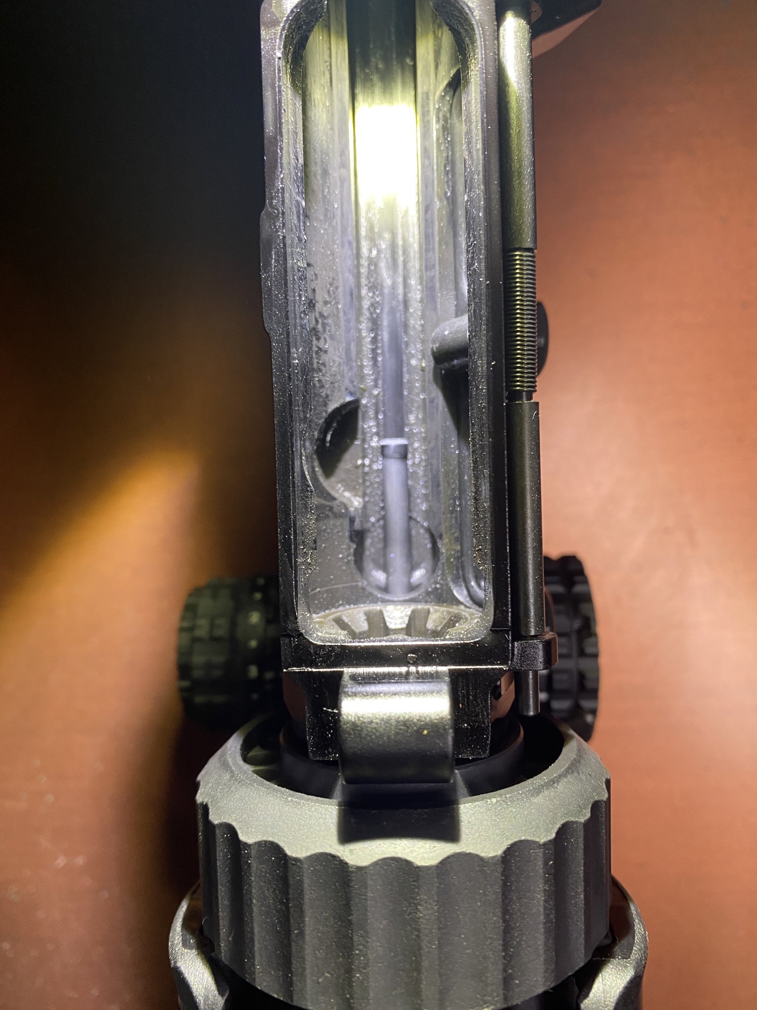

    Feed ramps aren’t too bad I guess, but not amazing IMHO

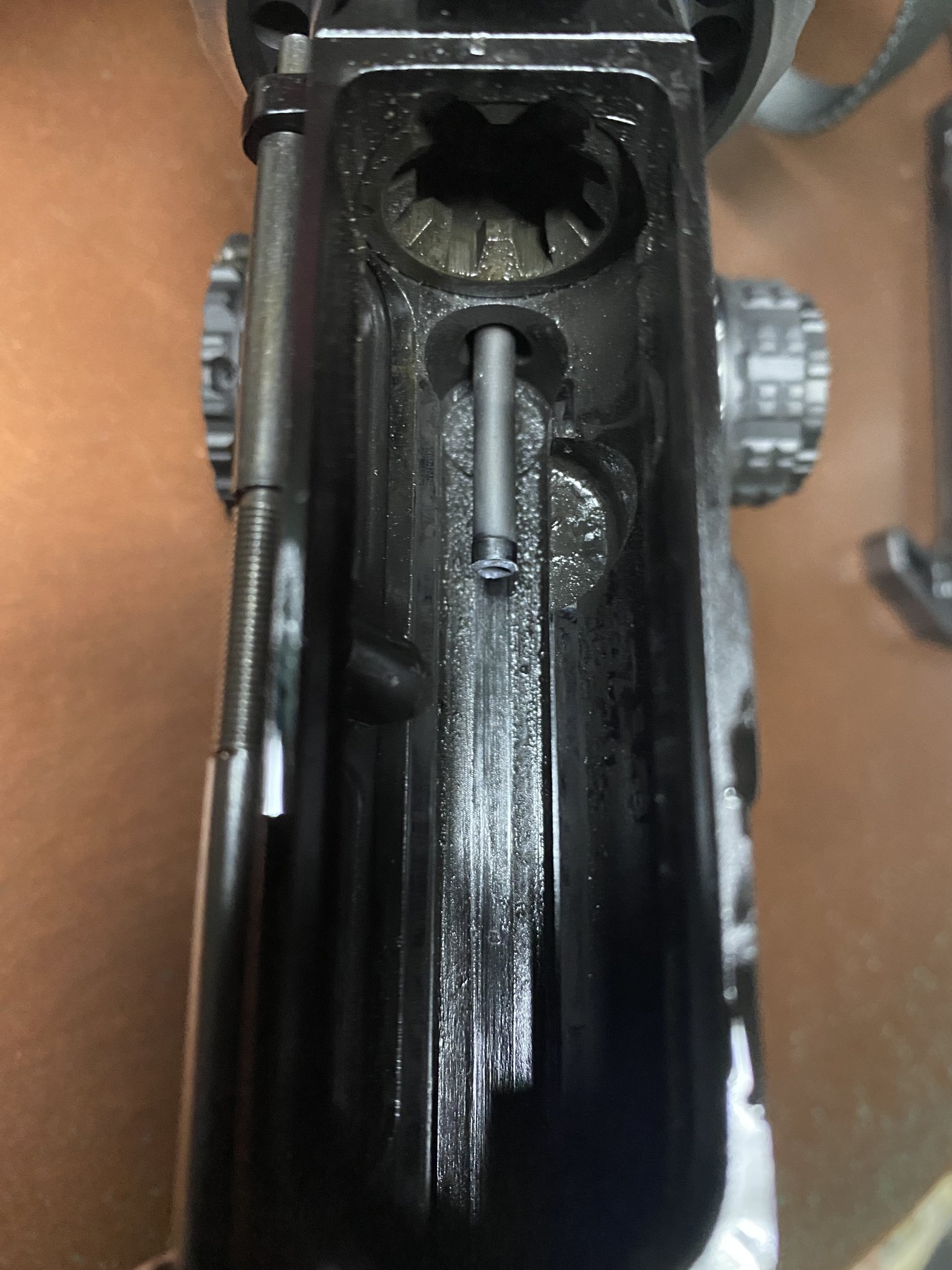

    This is their “performance series” and of course they’re out of stock on the site. Lol. I always use a reaction rod to tighten barrel nuts so I can’t imagine I did any harm to the extension on install. Indexing pin slot of the receiver looks new as of yesterday when I took the thing apart.

    It may be my imagination but the feed ramps do appear to be rotated slightly counterclockwise. Is it possible that the slot in the upper receiver for the alignment pin is off slightly?

    I’ll wait to see what BA has to say about it, but I’ll probably look into a Douglas, compass lake or white oak in the meantime. The photo of the feed ramps is a little deceiving compared to looking at it in person. The left edge of the left ramp doesn’t match the ramp in the receiver very well, like there’s a little extra material, but the other three corners line up pretty well. I’d imagine a little massaging of the ramps would clean that right up, but I don’t see a need to mess with that since there’s never been a feed issue with many different types of ammo, just the undergassed non-cycling. The indexing pin is a snug fit in the receiver slot so it doesn’t appear to be damaged. Just putting a straight edge along the stamp on the top of the barrel shows the gas port closer to 11 o’clock which I just didn’t notice during the initial assembly. I can live with a canted block I suppose as long as everything is safe and works as it should. The suppressor will be done this week so there’s another round of adjustments it’ll need I assume. Im tempted to put the original gas block on it using the dimple and see how it acts suppressed.
