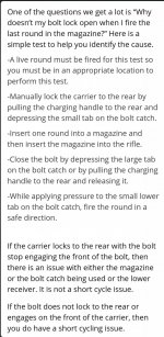

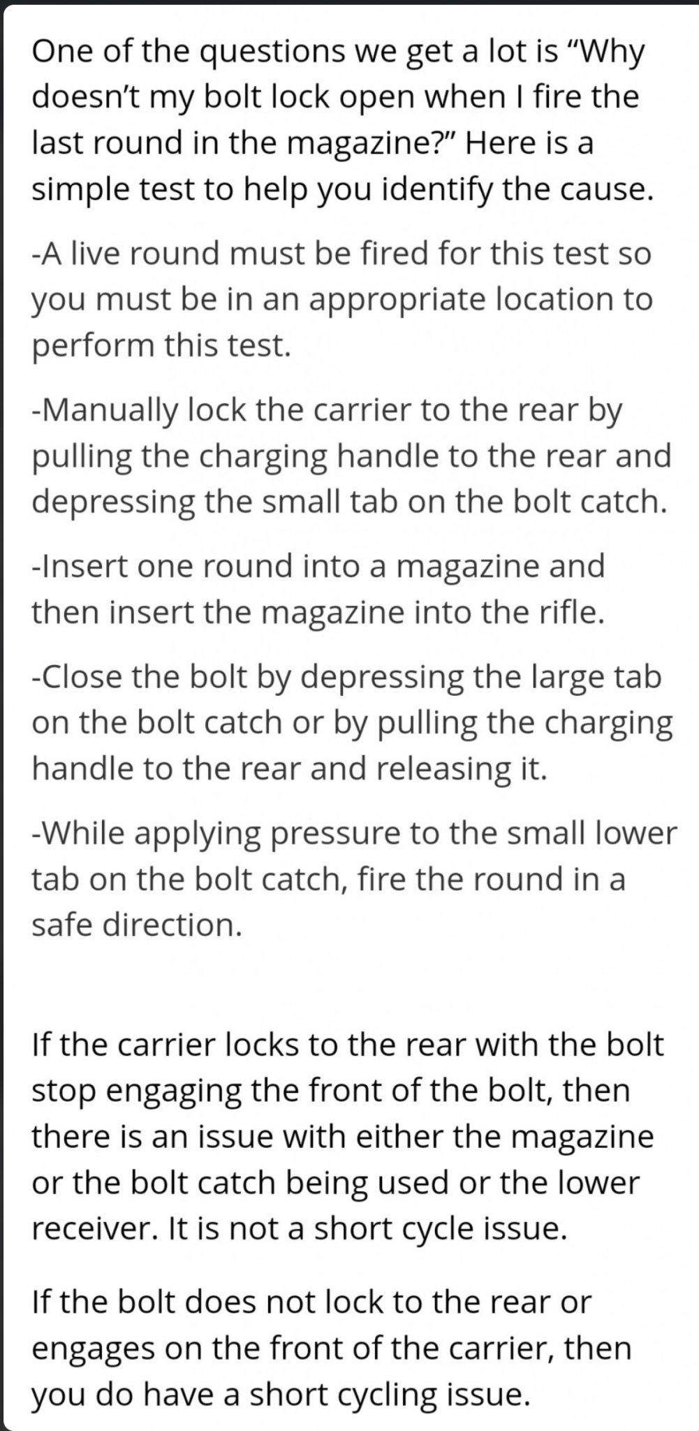

I have done the bolt catch test and fail that too.

Can you detail this ‘bolt catch test?’

Insert an empty mag and manually pull the charging handle as far back as it will go. Does it lock back? If not, look into the ejection port and see if the face of the bolt will go past the bolt catch. In the most rearward position, the bolt face should be at least 1/8" behind the bolt catch.
Yes it locks back and goes back at least 1/8".

I have done this.

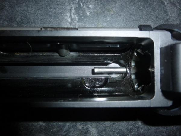

Also look into the magwell with the bolt locked open. See if the gas tube terminates halfway of the cutout for the cam pin like in this picture.
This usually applies more to large frame guns since the small frame parts are actually standardized but you never know until you check it for yourself. Check the screws for the gas key for looseness and proper staking.
