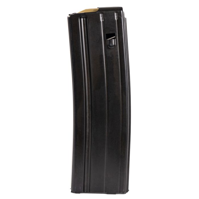

Would love to see/hear more about the ground up mag design. What capacity for the straight mags? Aren't most of the straight 6.5G mags already on the market of the 15-17rd variety? Probably not a huge deal for a DMR, but if you're going in the front door with a 12.5" maybe you'd want more capacity?

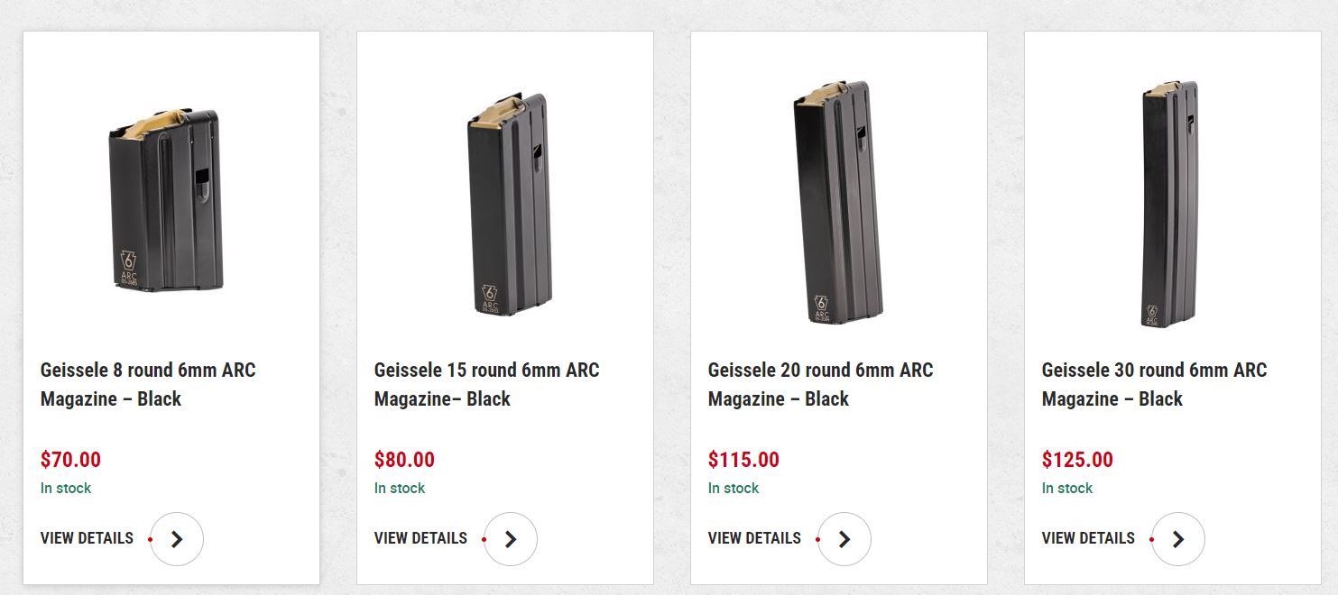

You can now buy it all on the Geissele web site. They have in stock for sale, the 18 inch rifle. The 6 ARC HUXWRX Can, Mags in 15, 20, and 30 rounds. It looks like only the Maratime Recce is for sale but they have up a 14.5 variant and a 16 inch as well just not available yet. They also have another rifle I have not seen that looks like some kind of match rifle. They also have the scopes as well.

Looks like they did a single layer wall for the front of the magazine, attached to the side wall away from the meplats to allow longer COL.

$115 for a 20rd mag, I was expecting it to come in a 3 or 4 pack! I don't operate hard enough to spend $115+ on an AR15 mag.
