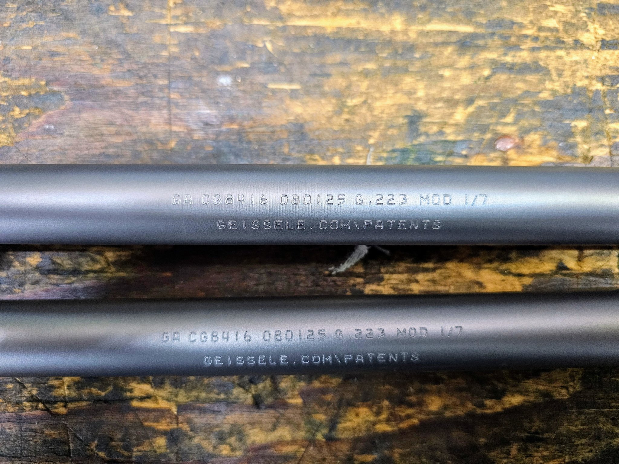

    Geissele Automatics has been offering Single Point Cut Rifled Barrels for close to two years now but they've been restricted to the 6 ARC Stratomatch or blanks that the end customer could have custom turned from barrel manufacturers like White Oak Armory.
    Two weeks ago Geissele proudly released thier new 18" SPR Cut Rifled Barrels to the public.
    At the time of their release I purchased 3 of the new SPR Barrels for testing and evaluation. Geissele seems to have paid close attention to the features customers want today.
    Barrel description:
    18" Single Point Cut Rifled

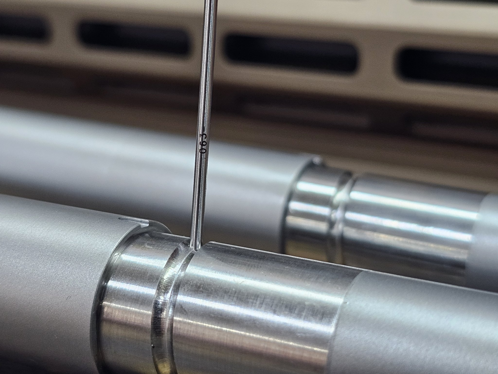

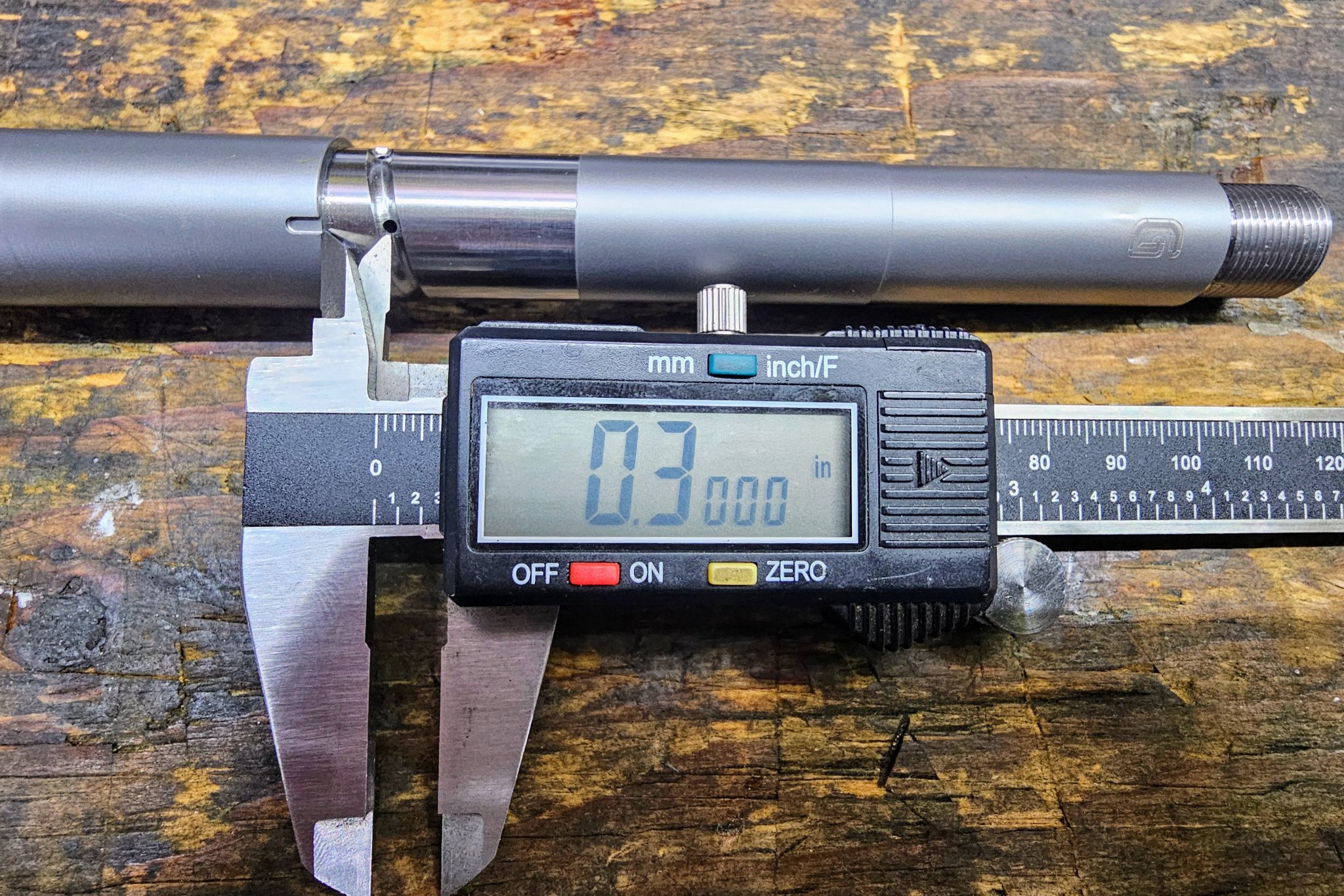

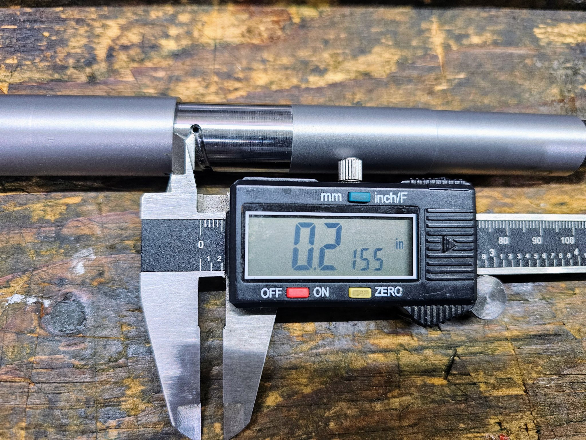

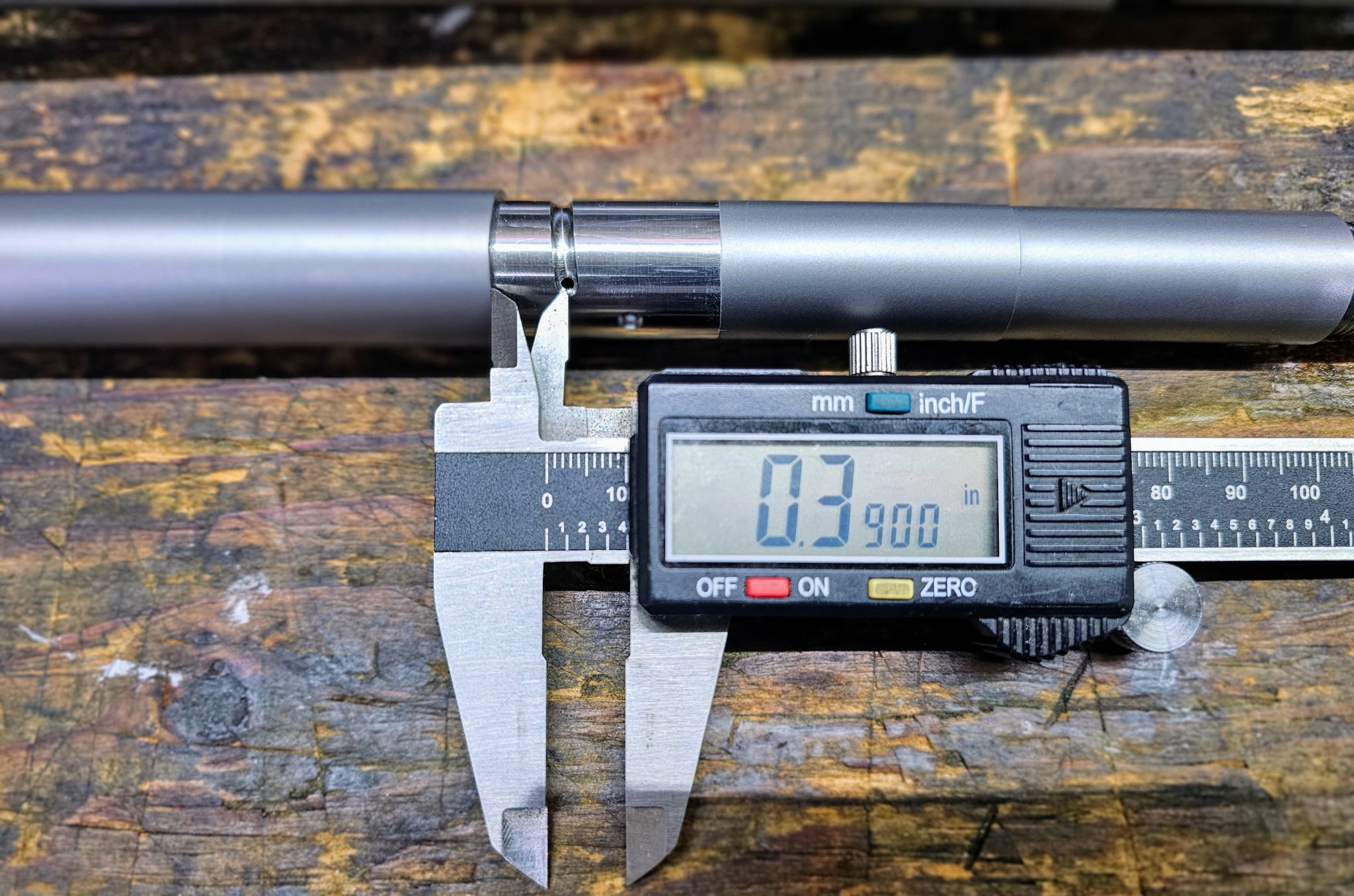

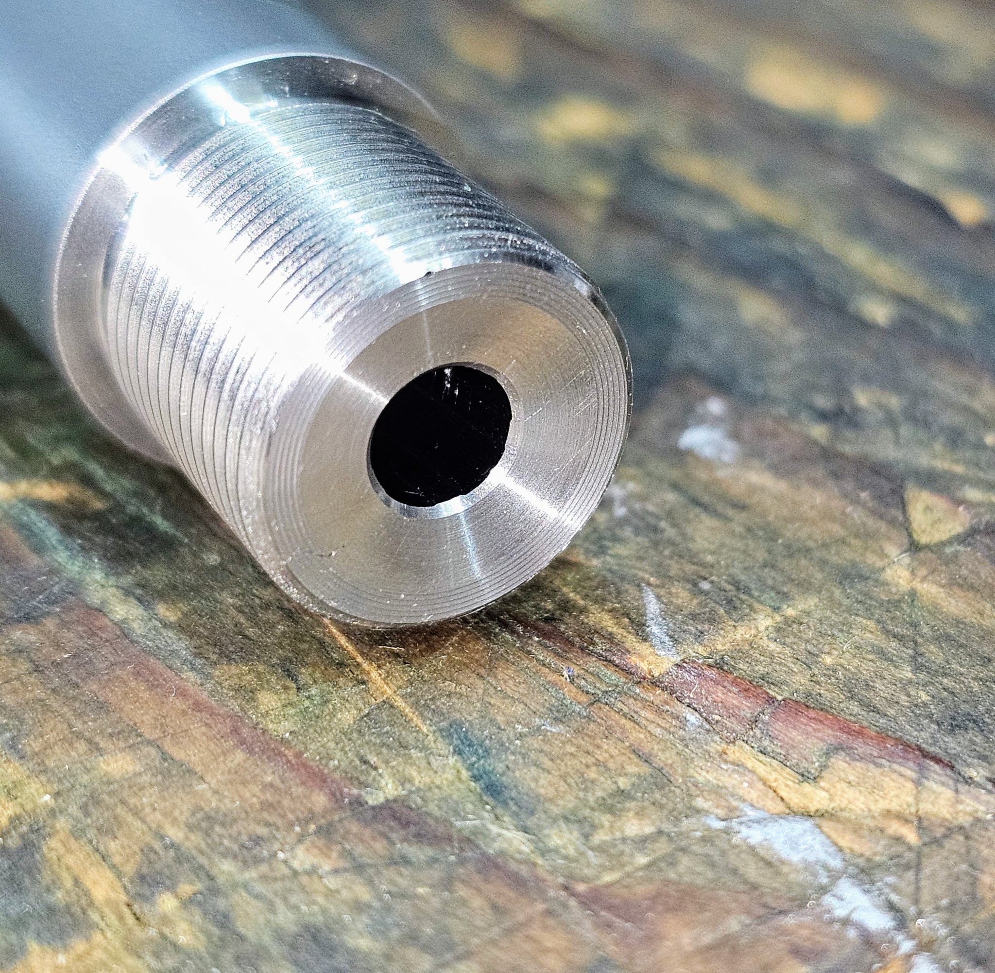

    The quality and the machine work on these SPR barrels are as good as they Come, truly impressive.
    The SPR Barrel has a precise and clean cut 11° Taget Crown the is chamferred, delivering exceptional accuracy and greater protection.

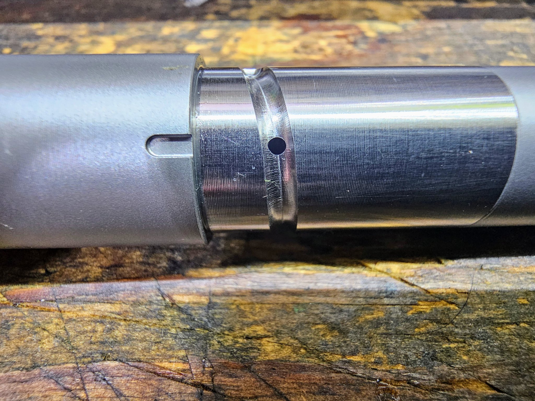

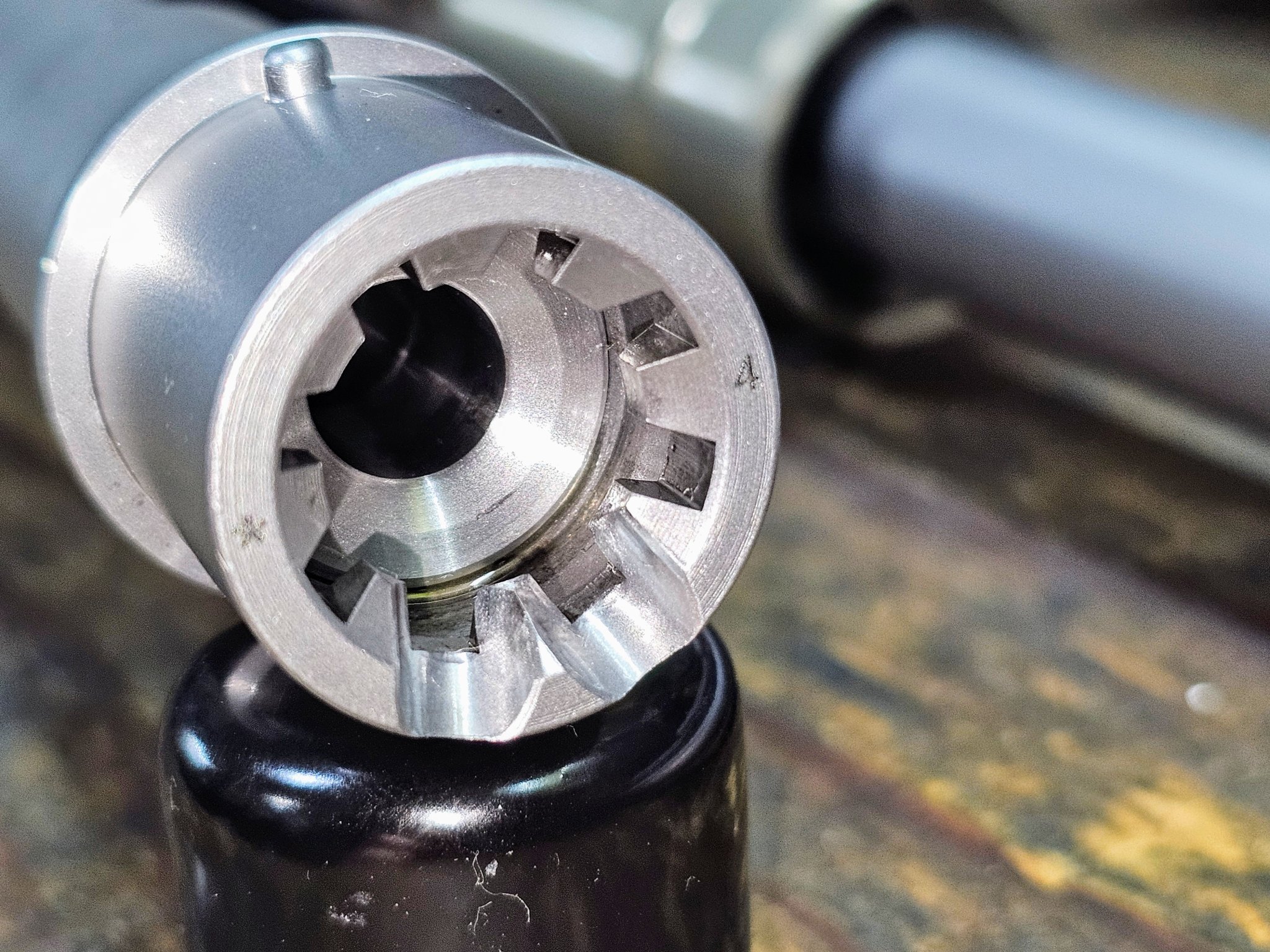

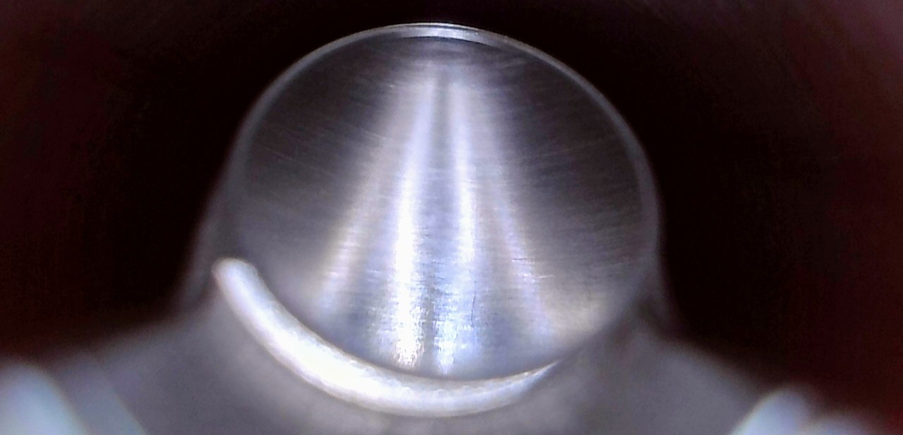

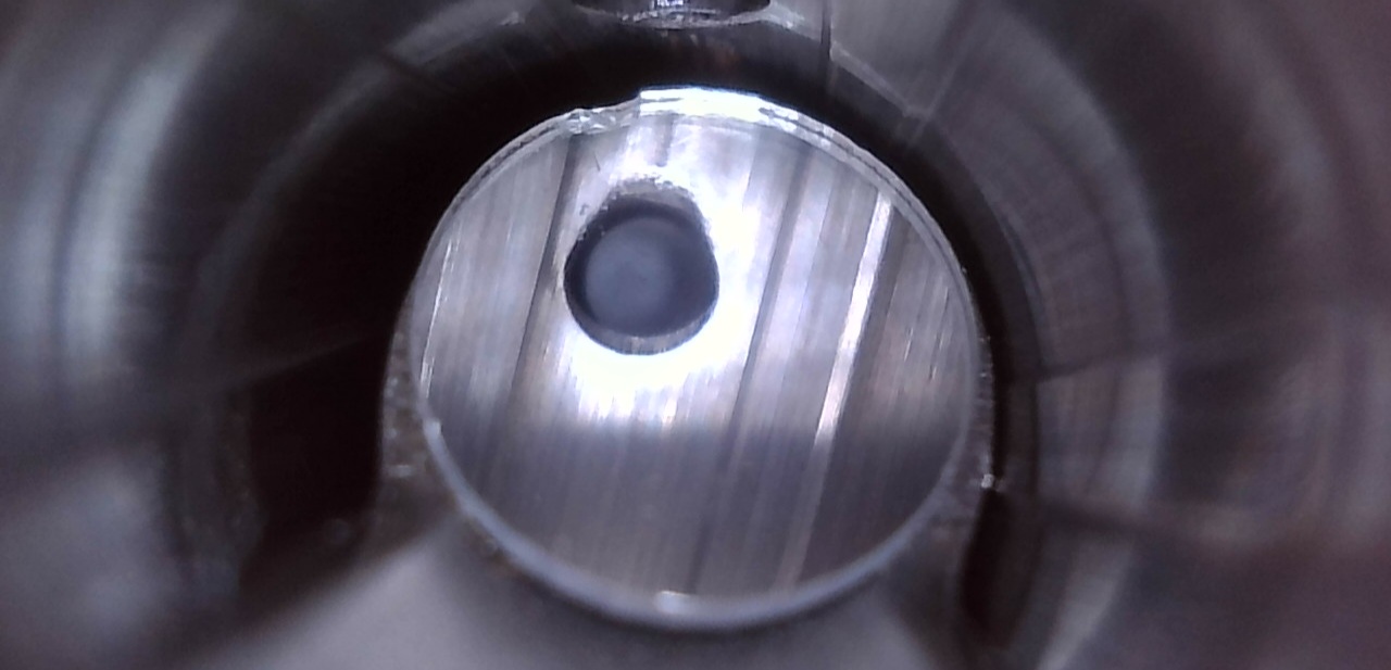

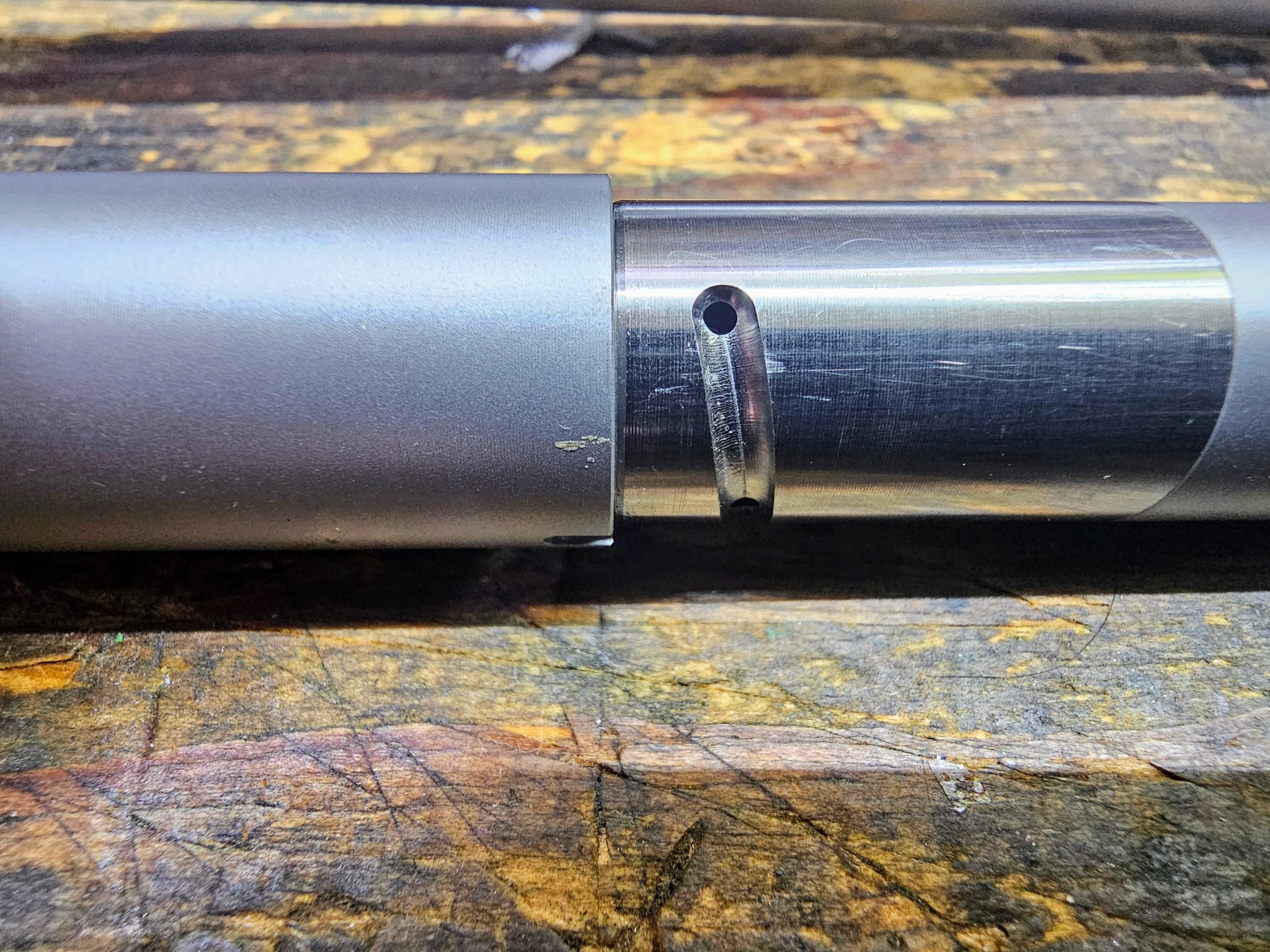

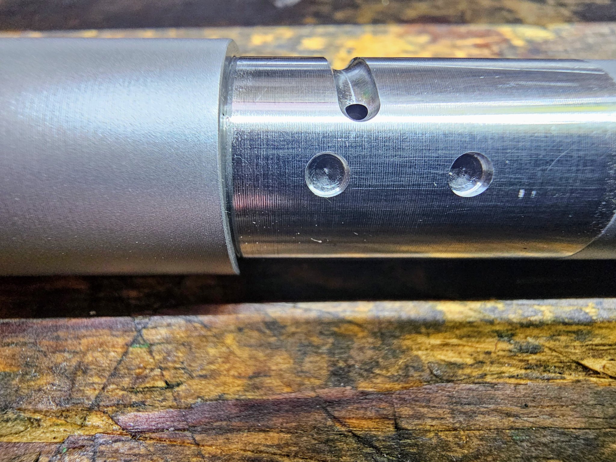

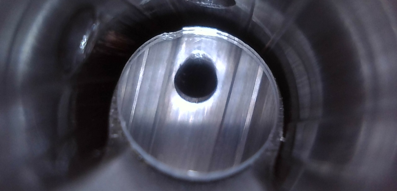

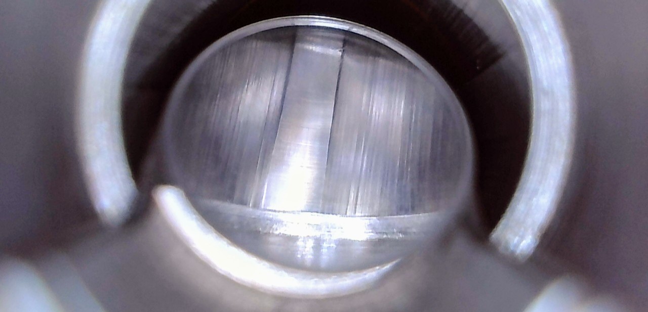

    The Geissele Proprietary Phased Array Gas System utilizes a unique 3 Gas Port Design. Each Gas Port is .063" in diameter and is located at varying distances from the Gas Block Journal Shoulder with a milled spiral cut that Channels the gas from all three Gas Ports, equally dispersing gas pressure for a smoother recoil impulse resulting in faster Sight Recovery and Target Acquisition.
    Each gas Port has a forward facing Teardrops Style Chamfer eliminating any possibility for developing a Burr at the Gas Port which can be detrimental to accuracy.

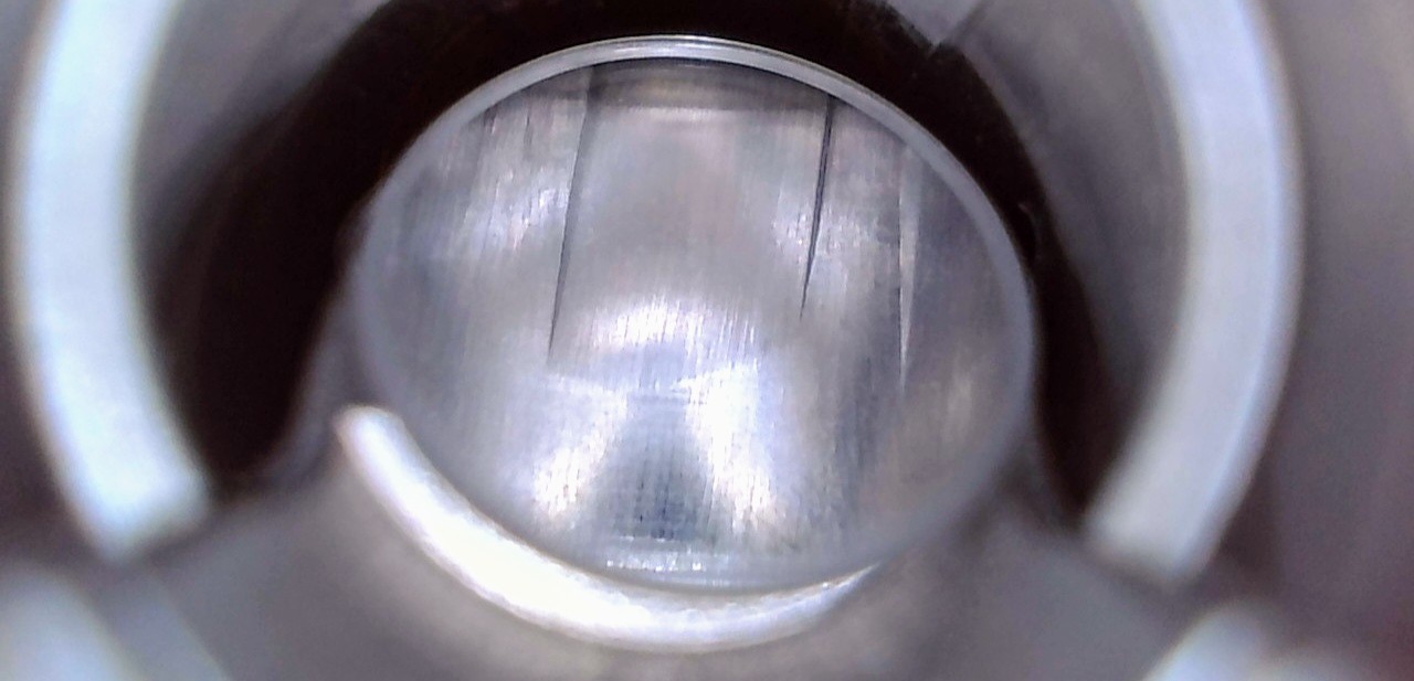

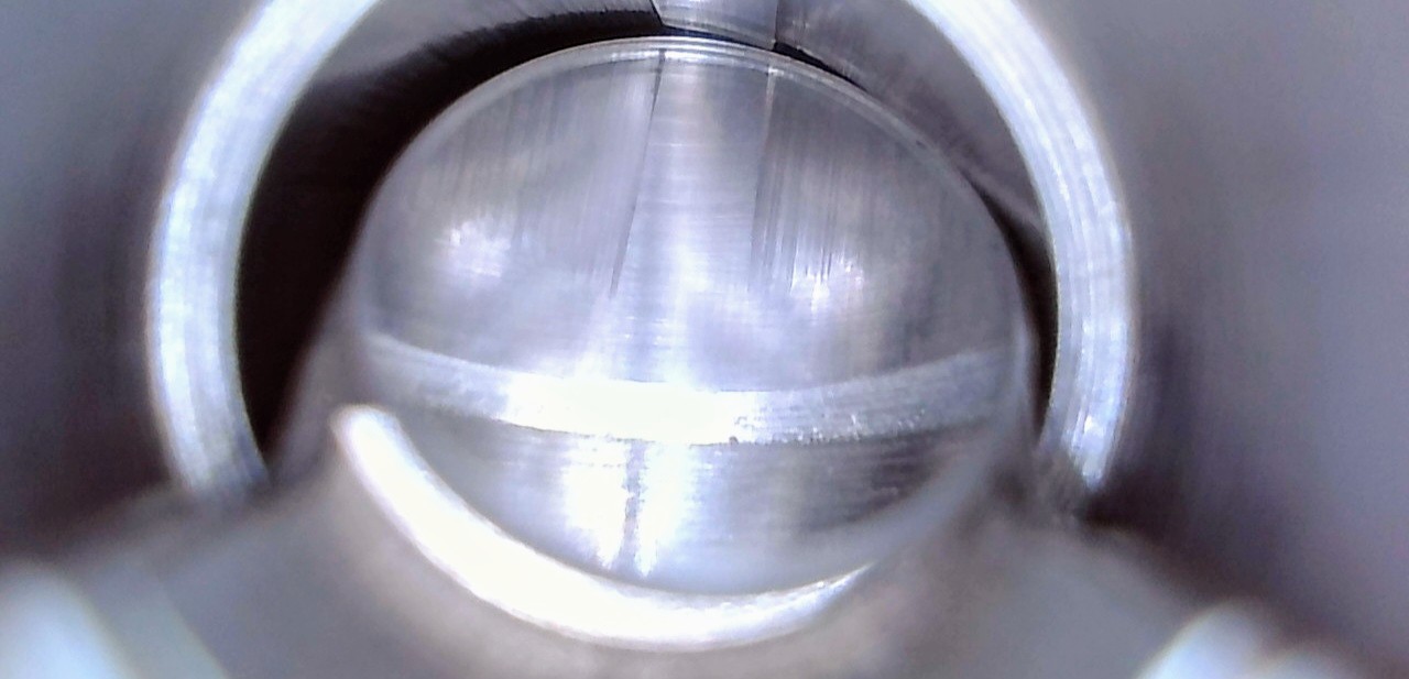

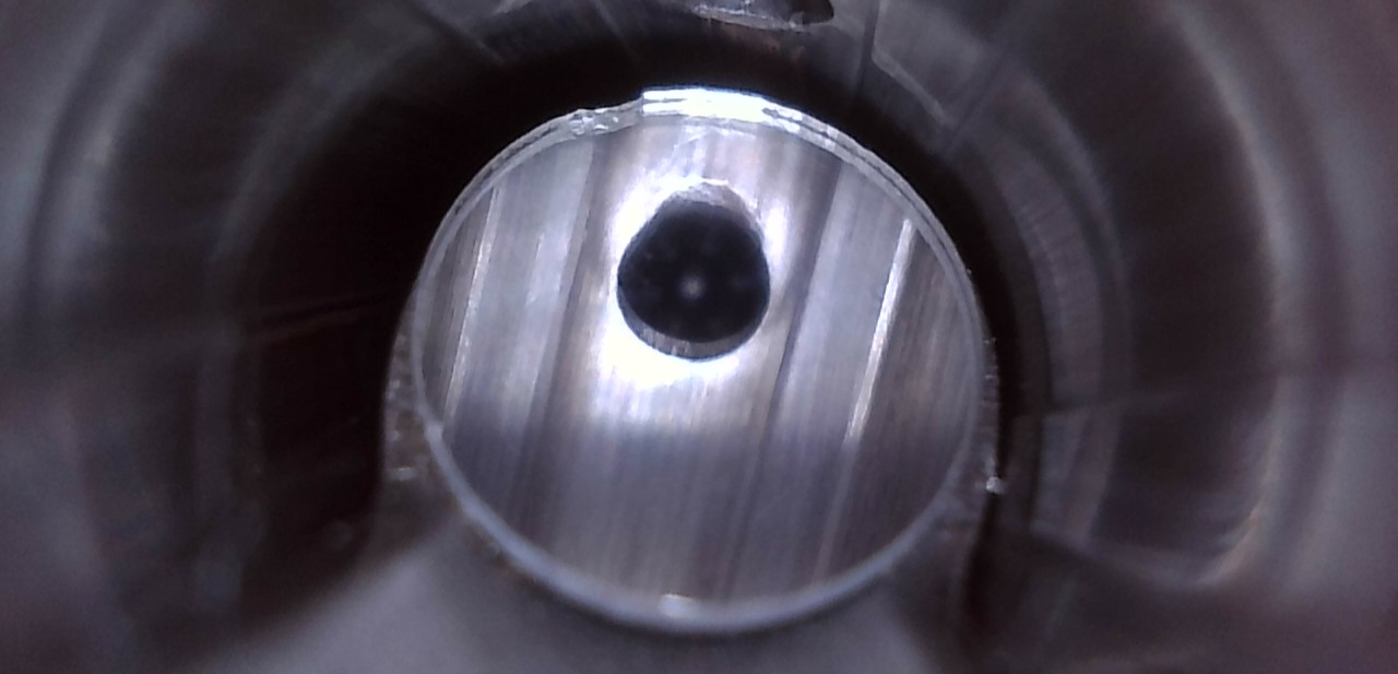

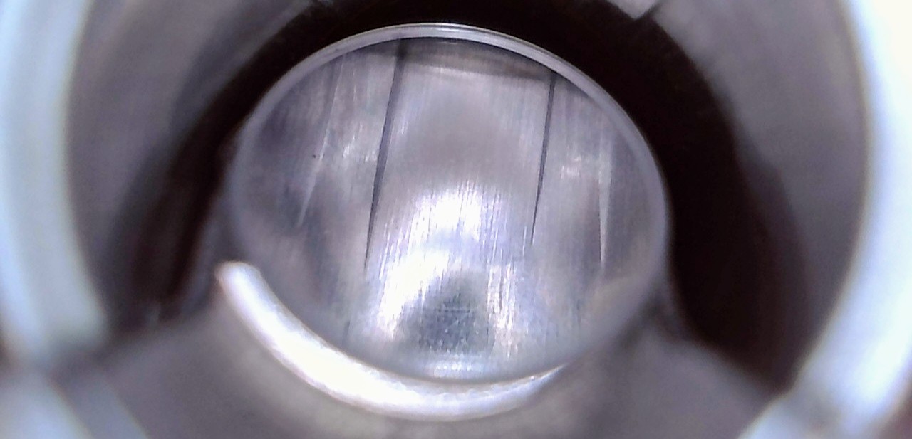

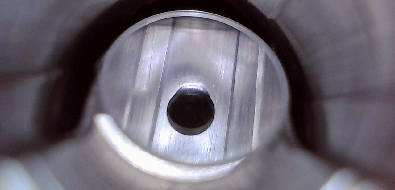

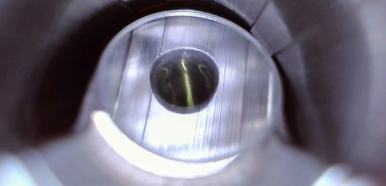

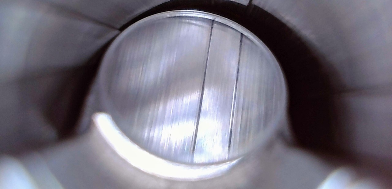

    internal View:
    Each Gasport is perfectly centered in a Groove.

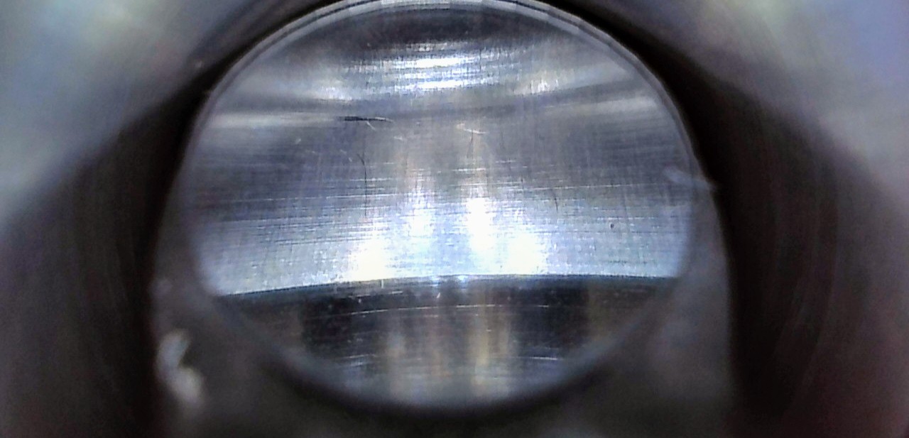

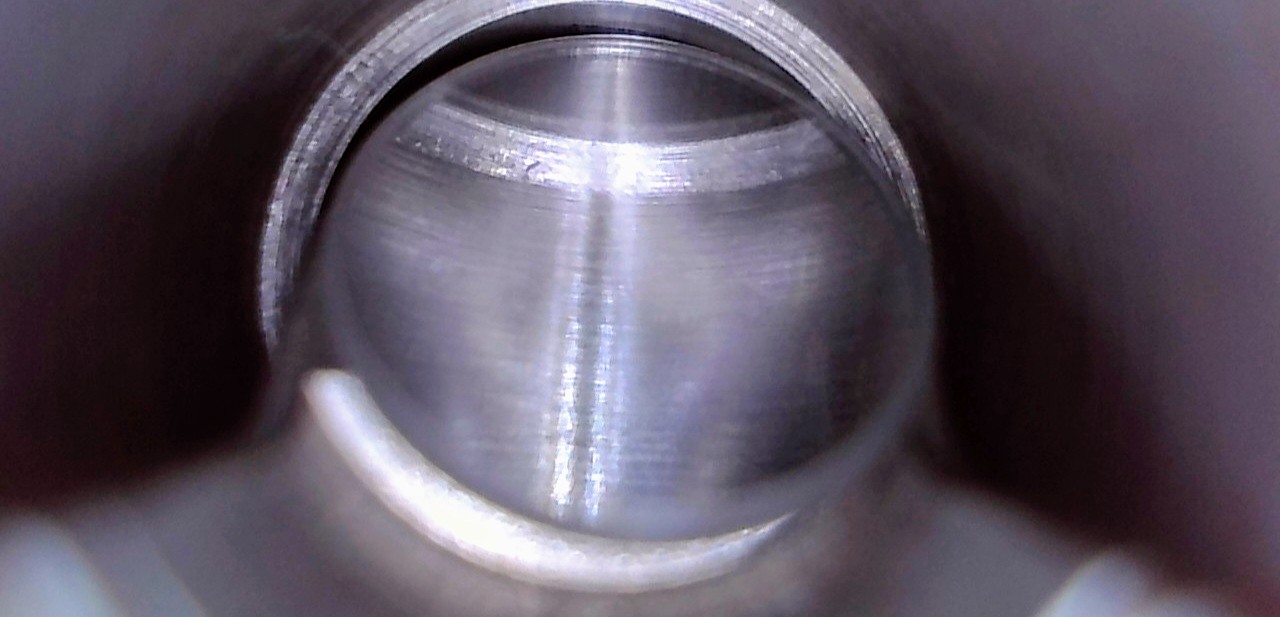

    As I stated above the machine work on these Cut Rifled Barrels are truly a work of art, I've performed a Side-By-Side Borescope Comparison between a Craddock Precision Bartlein .223 and the new Geissele SPR barrel.
    Geissele:
    Throat:
    Neck:
    Base:
    Shoulder:
    Tenion Face:
    Craddock Precision Bartlein:
    Throat/Neck:
    Base:
    Lands and Grooves:
    Gas Port:

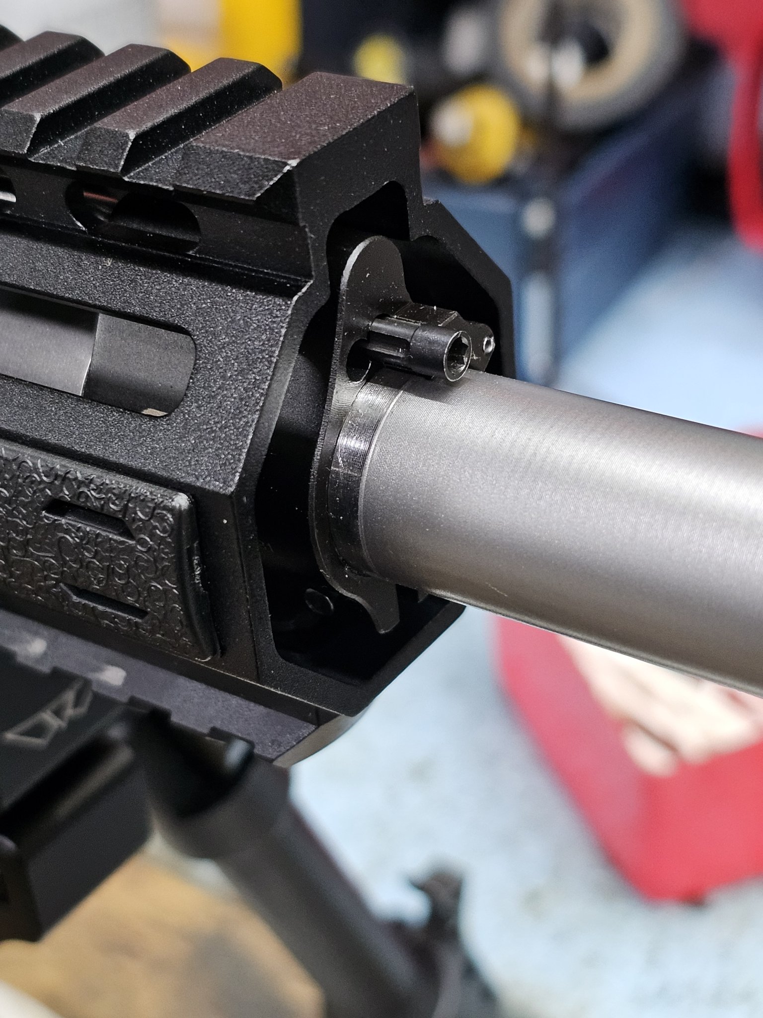

    Geissele reliability enhanced BCG
    Superlative Arms .750 Adjustable clamp on Gas Block

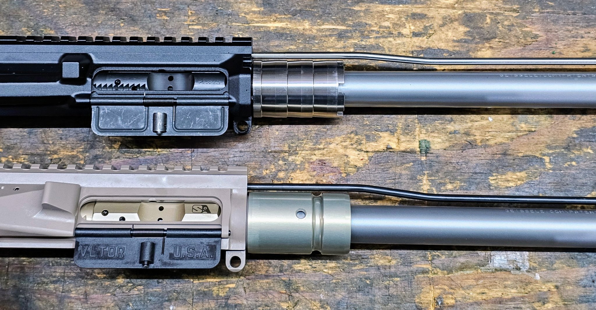

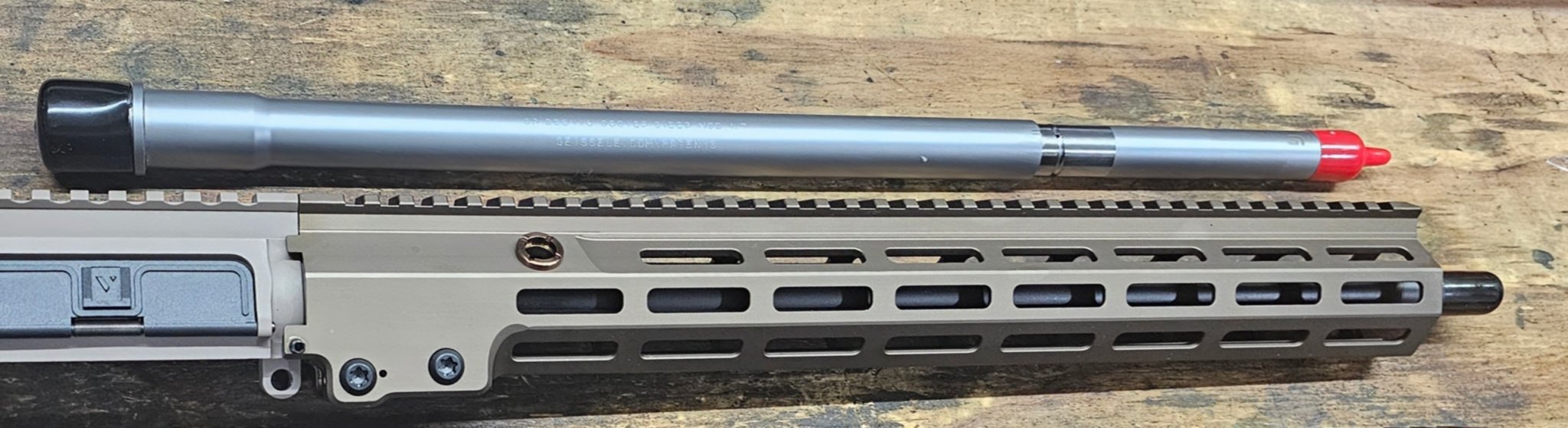

    Along with the New Complete SOLGW / Geissele Cut Rifled SPR Barrel I assembled a Complete Upper that will eventually go to the PX.
    Unfortunately the barrel extension on the new Cut SPR barrels aren't oversized so thermofiting wasn't an option so I went with the Loctite 620 for bedding the barrels.
    The Heavy Contour Chrome Lined Barrels have a tighter fit because of the Manganese Phosphate coating on the barrel extension.

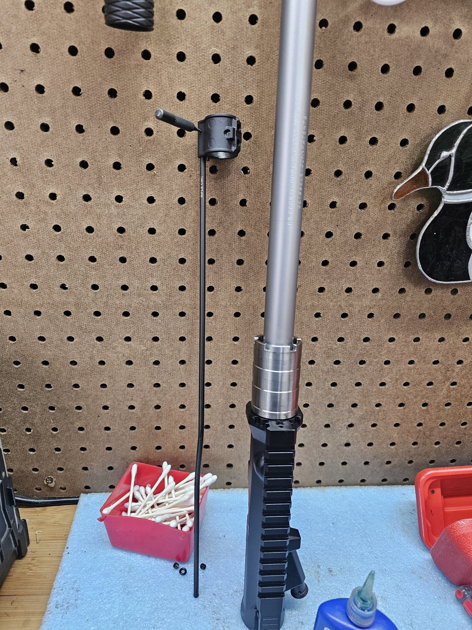

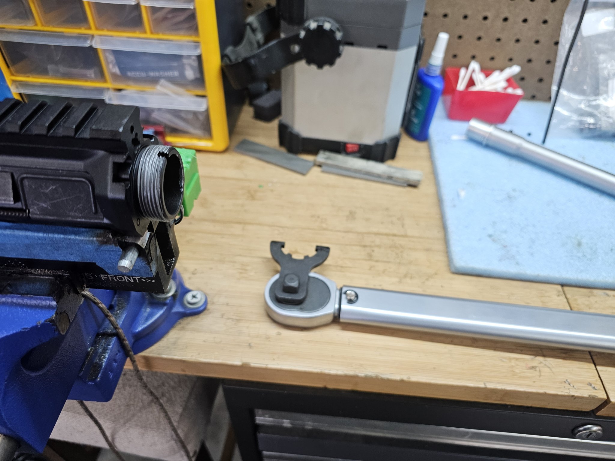

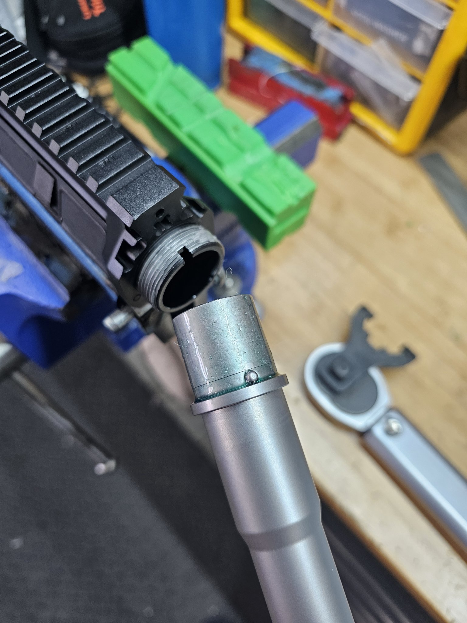

    The Upper Assembly process is pretty generic, but there's a few specific steps I want to touch on. I'll briefly run down the steps I take during Assembly.
    ASSEMBLY
    Reaction Rods have thier place in the Tool Box but I prefer the AR Upper Receiver Jig for Assembly. I apply painter's tape to take out any tolerance variation between the Jig and the Upper Receiver mounting points to eliminate any flex when torque is applied.
    Whenever Assembling anything new with various fresh parts you always want to carefully perform a mock-up assembly to make sure each part plays well with others, before the Loctite comes out to play.
    (1) After you secure your Upper Receiver with your preferred method you want to SEASON the Upper Receiver and barrel nut threads by repeatably torquing the barrel nut to 70 Ft-lbs, make sure to apply Anti-Seize to the upper receiver threads before working the threads.

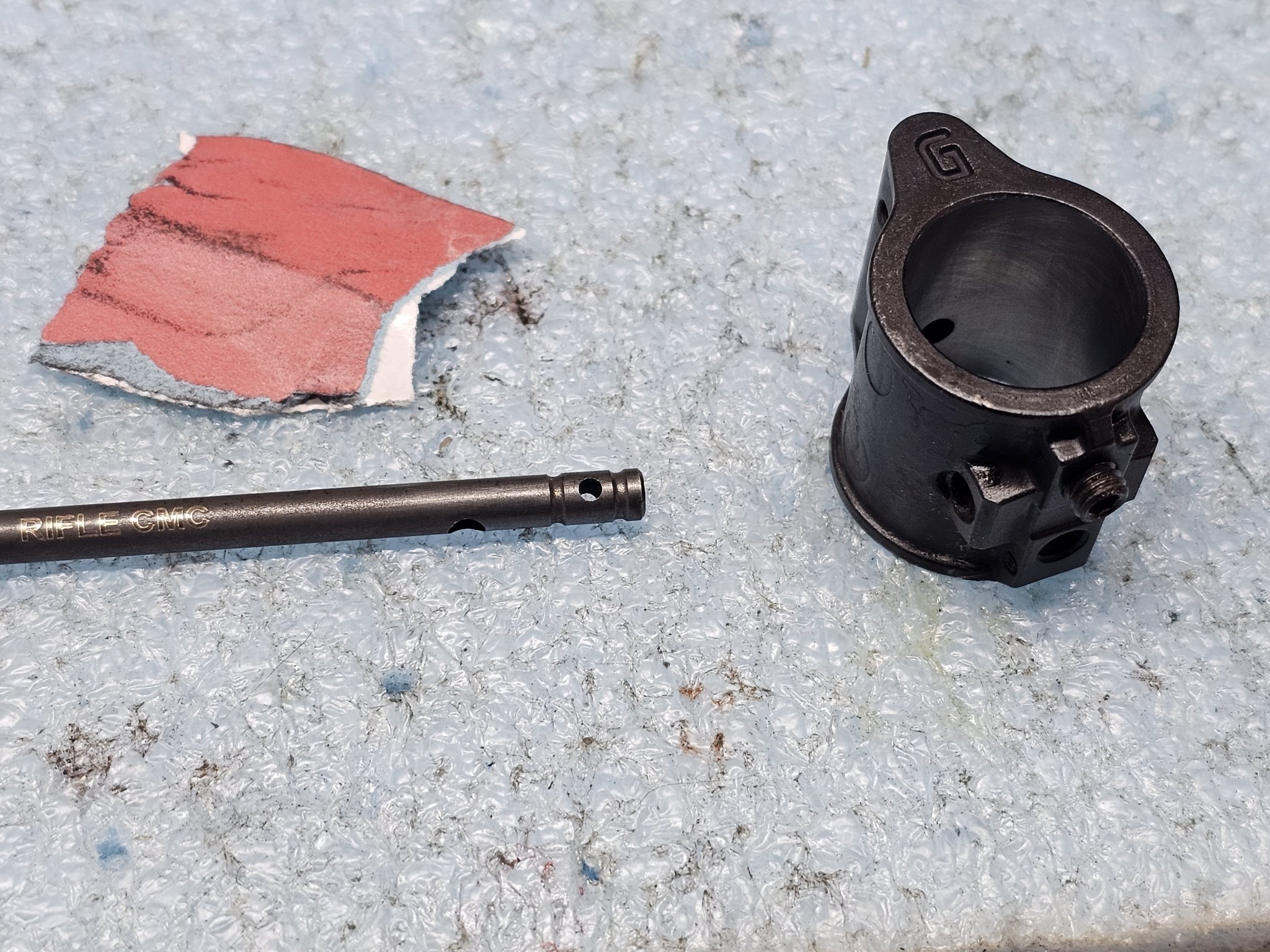

    Once you've seasoned the threads you want to lightly sand the mating surfaces with 400 Grit Sandpaper then clean with a Contact Cleaner like Carb Cleaner then wipe with a sterile cloth, Evenly apply a liberal amount of 620 inside the Upper Receiver Barrel Extension Channel same with the Barrel Extension itself.
    When Inserting the barrel you want to directly aligned the barrel to the upper receiver so that you keep the coating of 620 even to eliminate any voids or air bubbles.
    Apply direct pressure with the barrel to the Upper Receiver Face taking care not to tilt the barrel keeping the barrel extension and receiver face true.
    With your free hand wipe away any excess 620 so it doesn't get worked into the barrel nut threads, firmly hand torque the barrel nut on. Use a quality Torque Wrench for accurate torque specs, between 55-60 Ft-Lbs seems to be the sweet spot for dampening Barrel Harmonics.

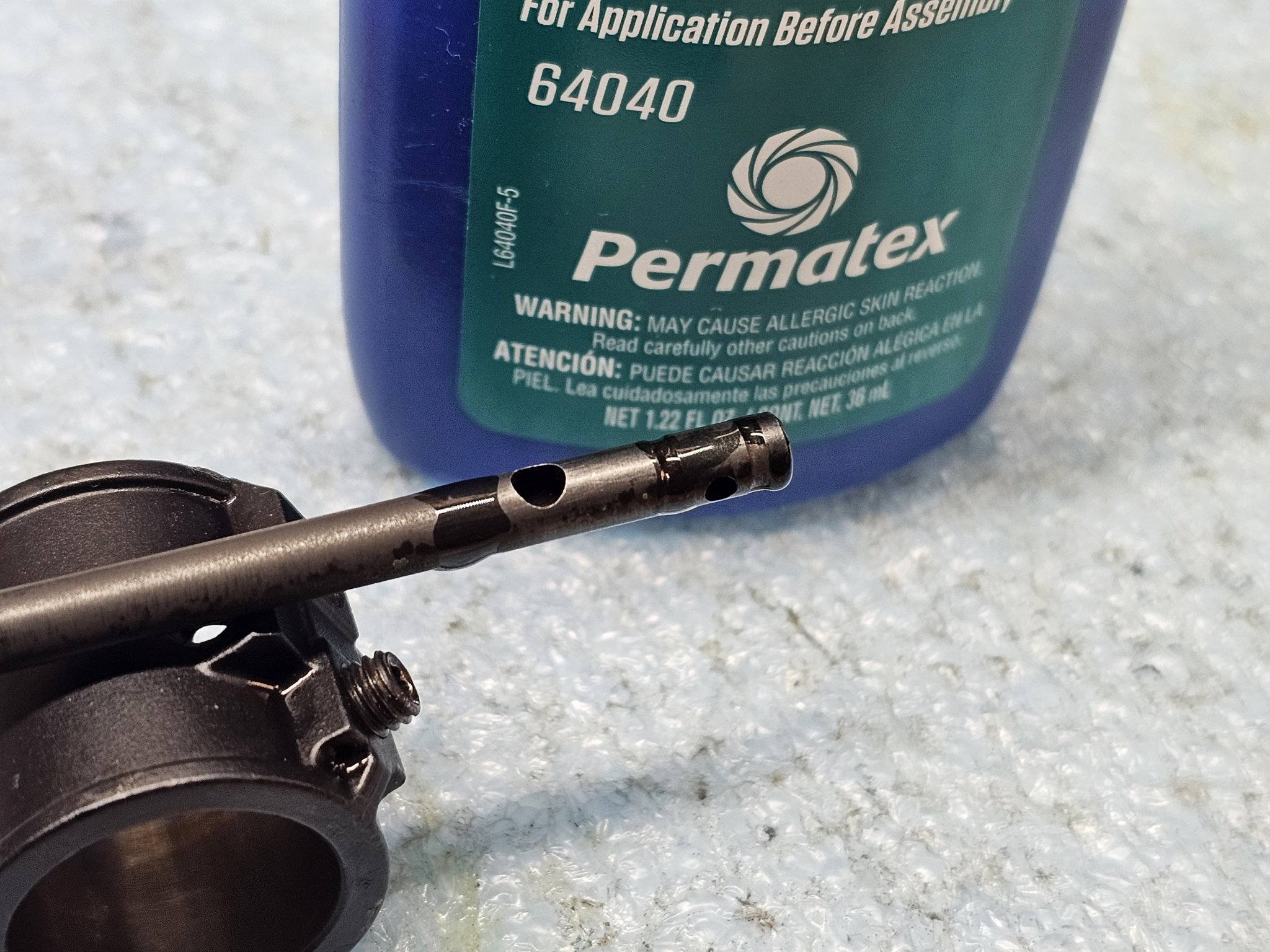

    Basically apply the same steps when pinning the Gas Tube to the Gas Block.
    Make sure to apply 620 to only the end of the gas tube and the aft end behind the gas port of the tube so that the 620 doesn't get into your Gas System. Insert a Q-Tip into the Gas Port of the Gas Block and clean, it will give you a visual indication if any 620 made its way inside the gas tube, when using a AGB perform these steps with the adjustment screw wide opened and after a few minutes work the adjustment screw to rule out any contamination.
    Insert a properly sized punch through the gas block roll pin hole and tube for proper gas tube alignment while the 620 cures, applying some low heat from a heat gun will expedite the curing process.
    Allow both the barrel and gas system a couple hours to cure.

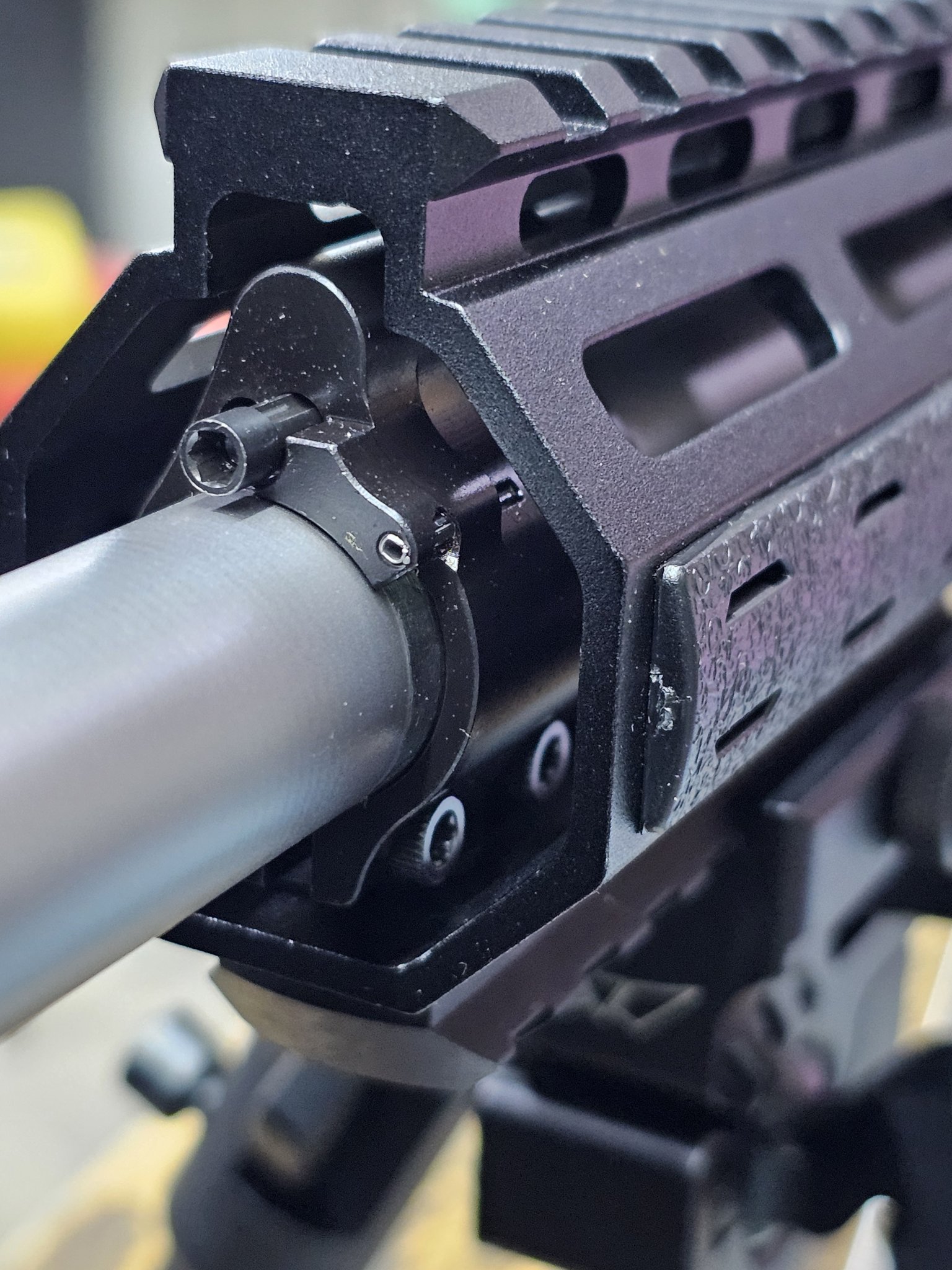

    This next part is something I think is worth going into detail with.

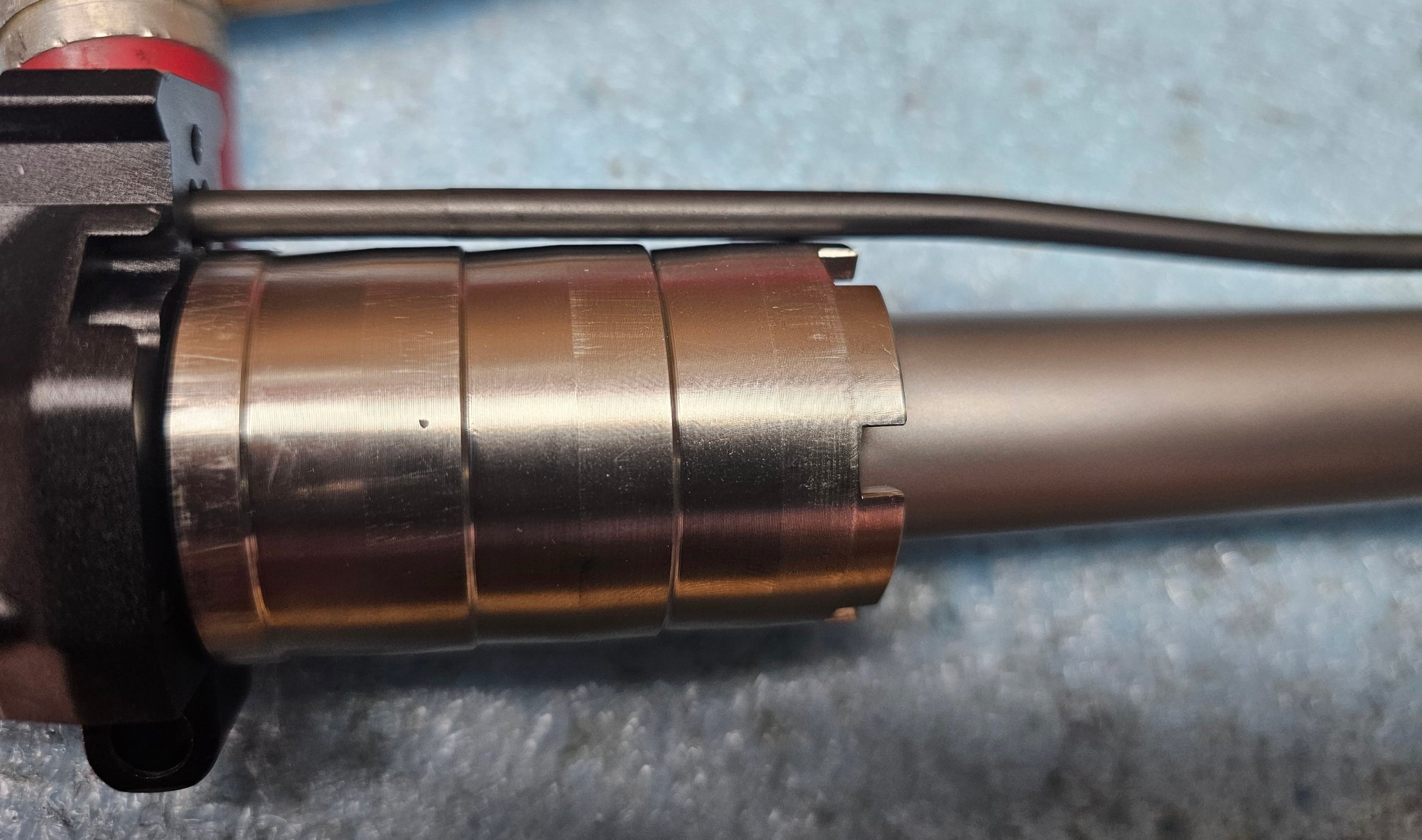

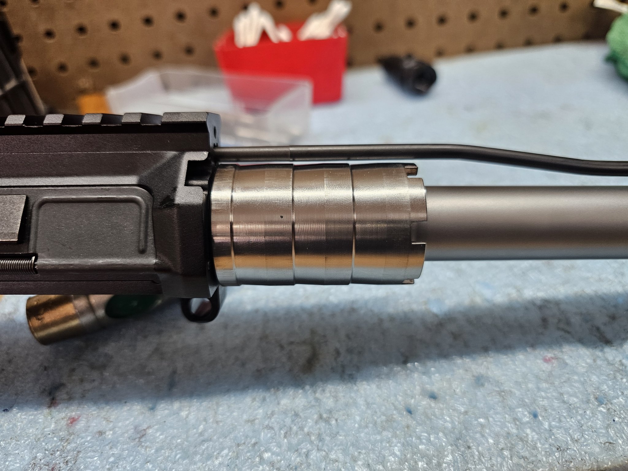

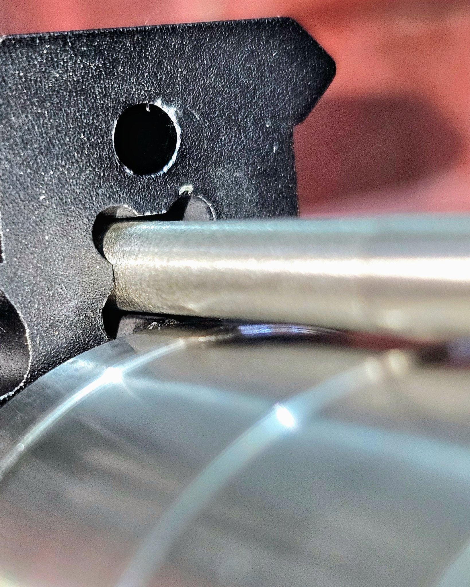

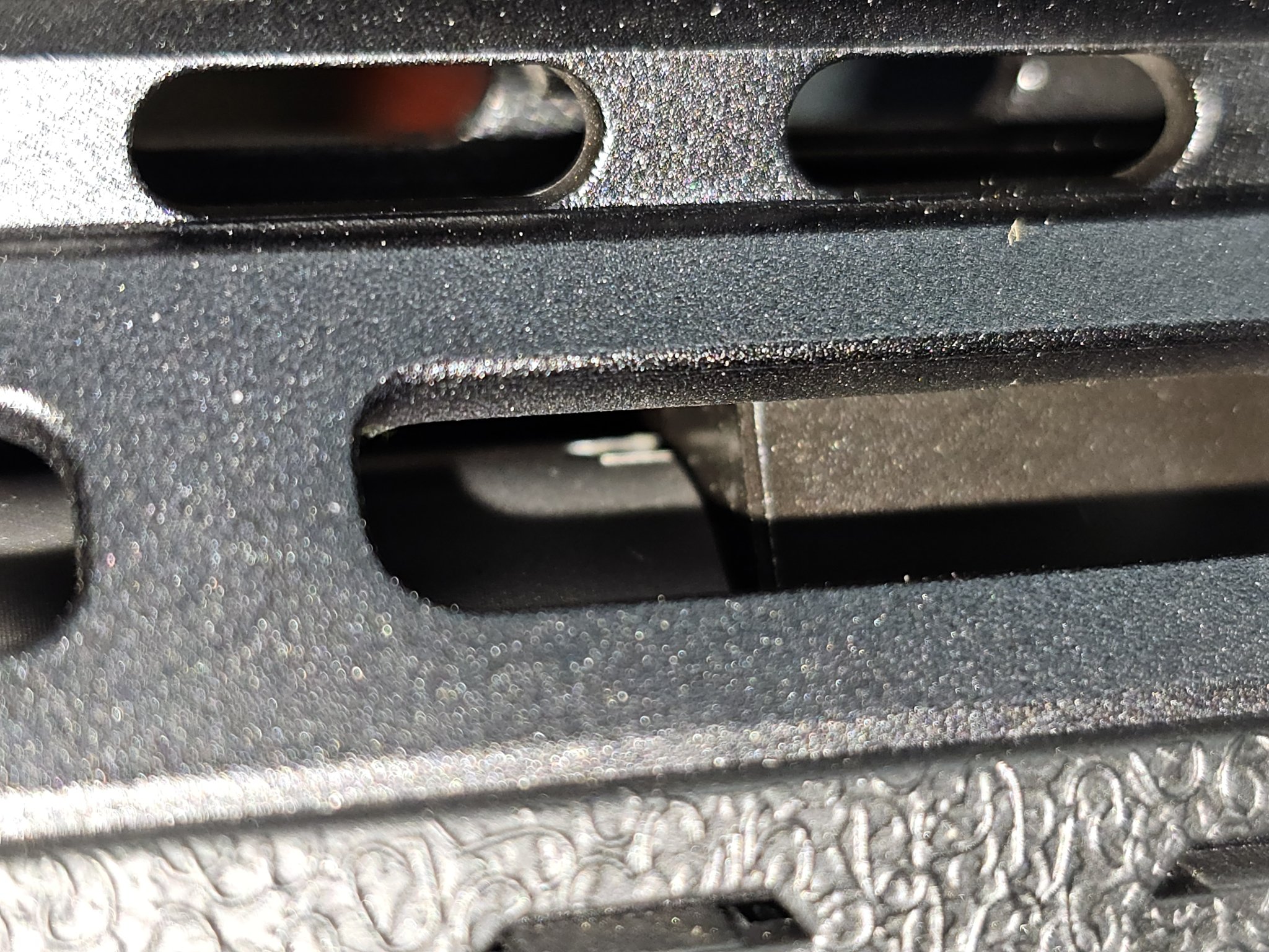

    Proper Gas Tube alignment is one of the most looked over steps that can dramatically affect accuracy.
    When using a low profile fixed Gas Block it's very common for the standard off the shelf contoured gas tubes needing to be recontoured for proper alignment over the barrel nut.
    The pictures below are a Before and After that perfectly illustrates this issue and the alignment after being recontoured. Because of the Geissele low profile fixed Gas Block neither a straight or "standard" contoured gas tube will have perfect alignment. I'm sure Geissele has rifle length tubes that are specifically made for thier gas block height.
    When you're finished you should be able to smoothly slide the carrier evenly back and forth without making hard contact with the gas tube and the Gas Key of the bolt carrier.
    Also when you seal and bed the gas tube to the gas block it increases the gas tube rigidity removing gas tube sag for optimum alignment.
    In the pictures below with the handguard and BCG removed you can see how the gas tube is perfectly centered and not making contact with the top or bottom of the Gas Tube Port, but perfectly hovers in the center.
    Geissele acknowledges with the release of thier new Cut Rifled SPR Barrel and it's proprietary gas system that there will be gas leaks but it won't detrimentally impact reliability and function.
    I ran several Hydrostatic Pressure Test with 3 different types of gas blocks by sealing off both the chamber and muzzle, with the upper upside down laying flat I sprayed carb cleaner directly into the gas tube then shot a pressurized charge of air down the gas tube.
    Both Standard Set Screw and the Geissele Set Screw with the pre-drilled pinning holes failed, the only gas block that had 100% retention was the Superlative Arms Clamp On Gas Block with only a few drops of contact cleaner that dribbled out of the bleed off port.
    what did this testing prove?? Not much... only that the clamp on gas block produced the tightest seal, in no way did this test prove that set screw gas blocks would be less reliable.
    For set screw gas blocks I torque mine to 15 in-lbs and use red thread locker.
    If the build permits the use of superlative arms clamp on adjustable gas blocks they are my go-to for precision builds. I torque my clamp on gas blocks between 30-35 in-lbs.

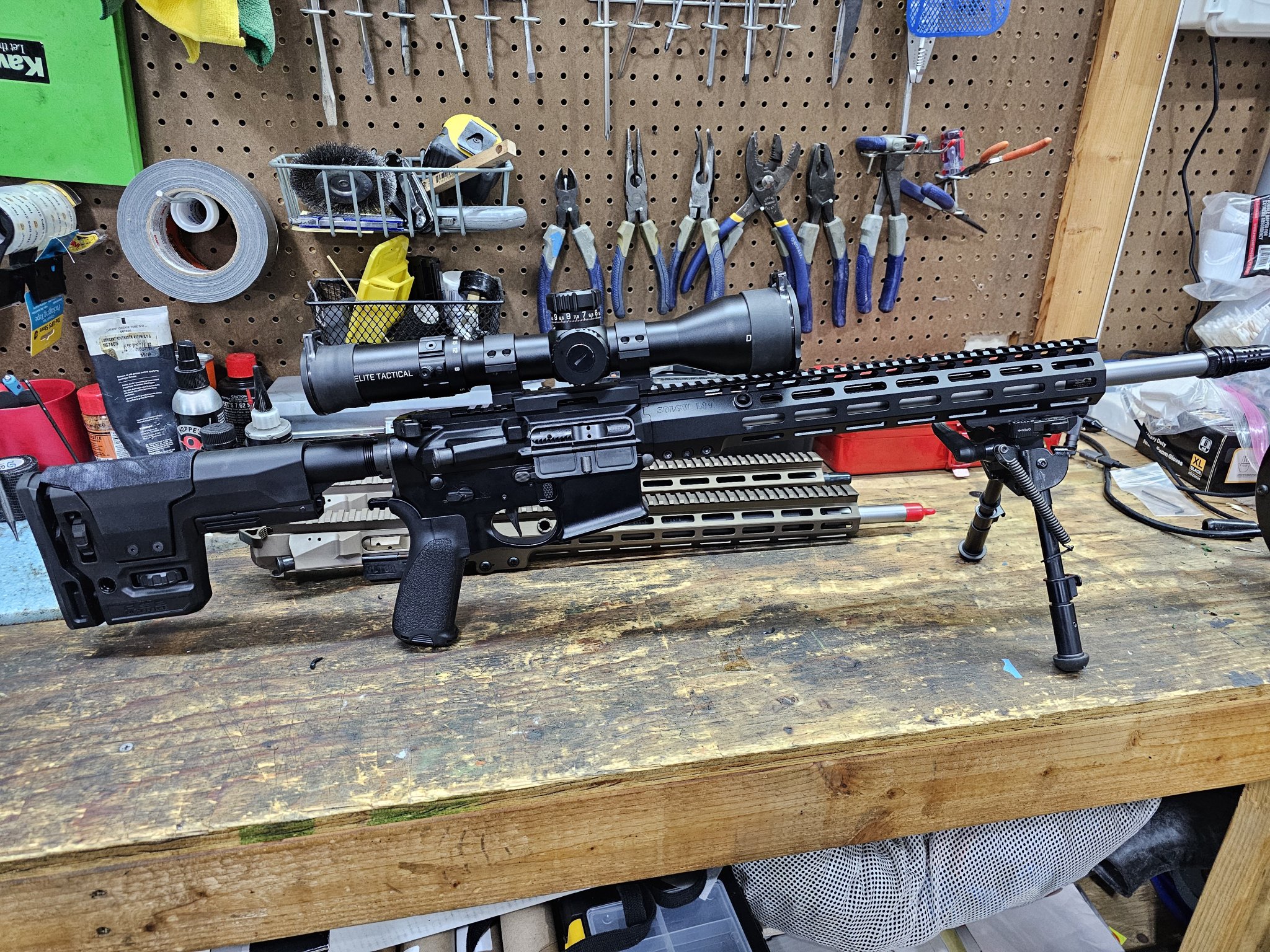

    Geissele 18" SPR Complete Build.
    Part 3 will be initial Set-Up and Range Report.

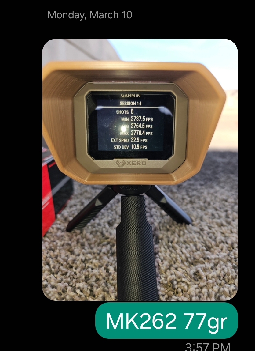

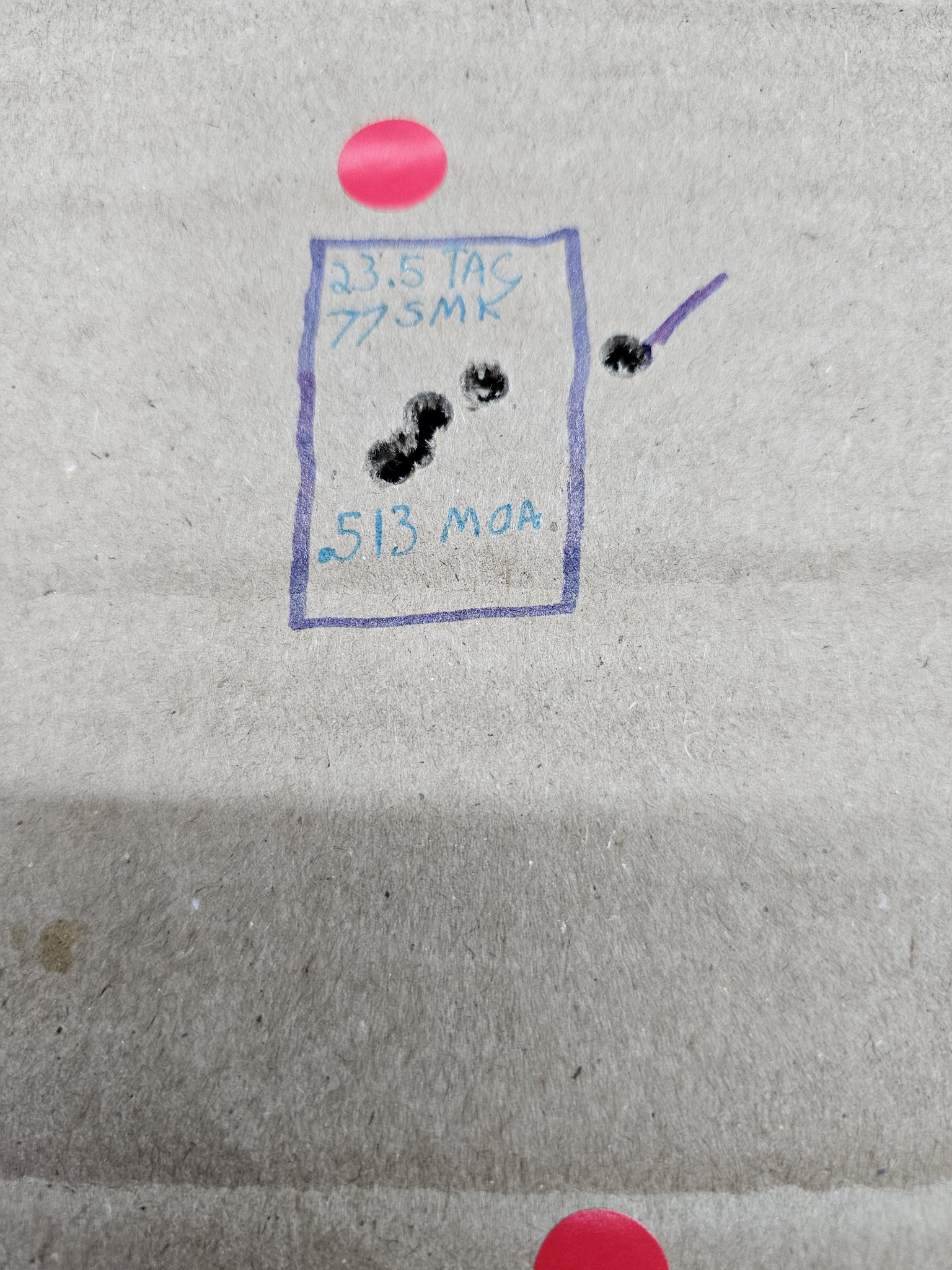

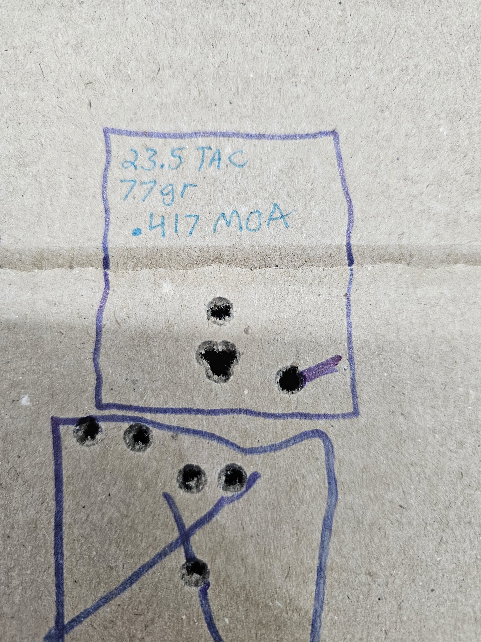

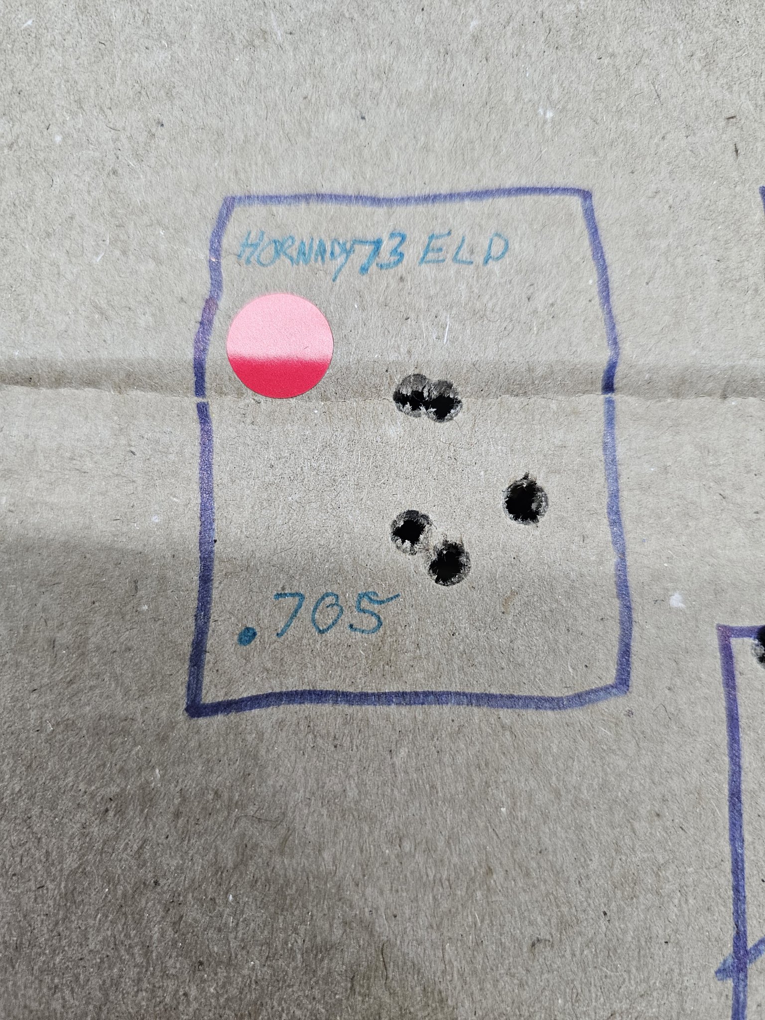

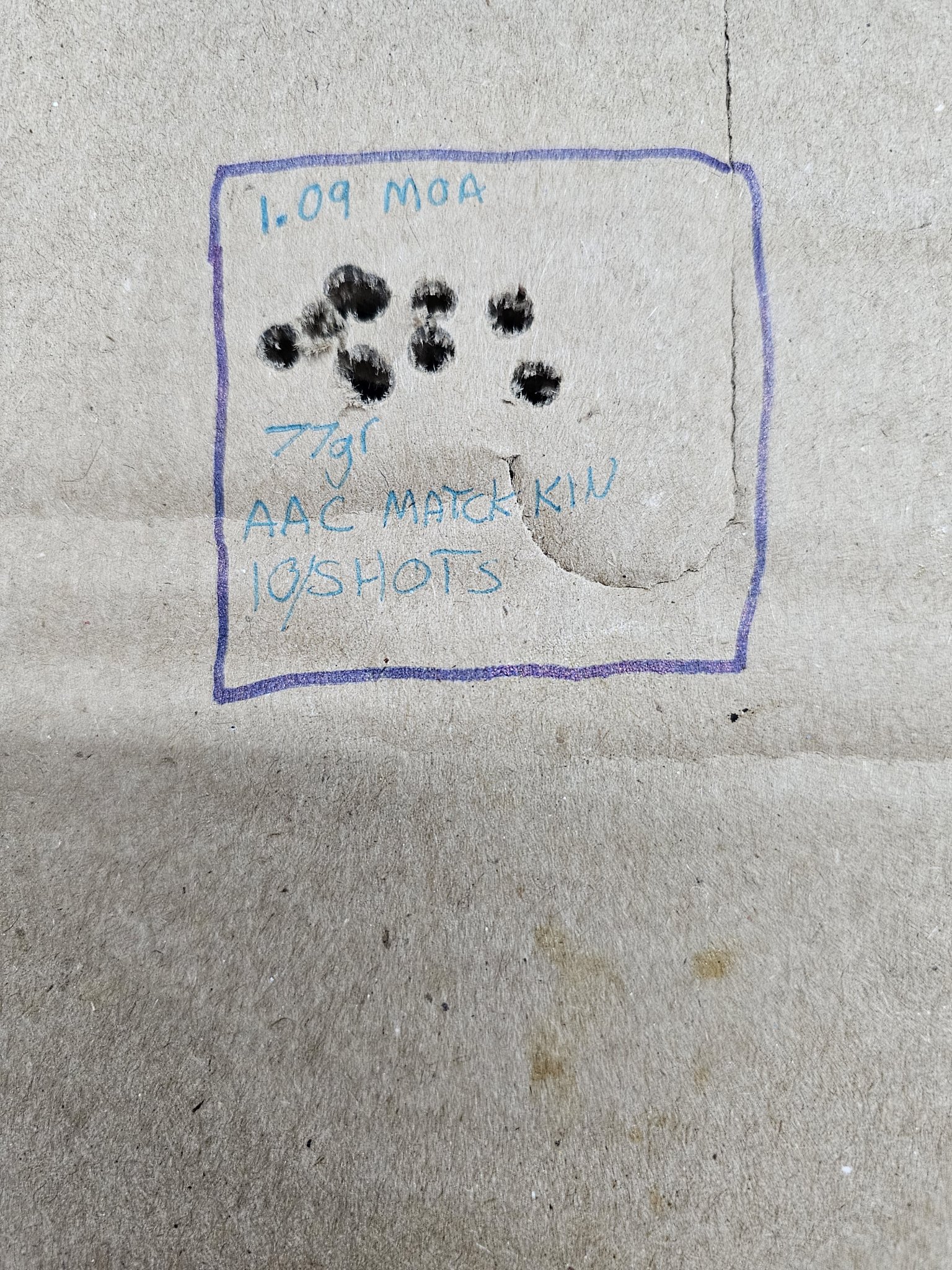

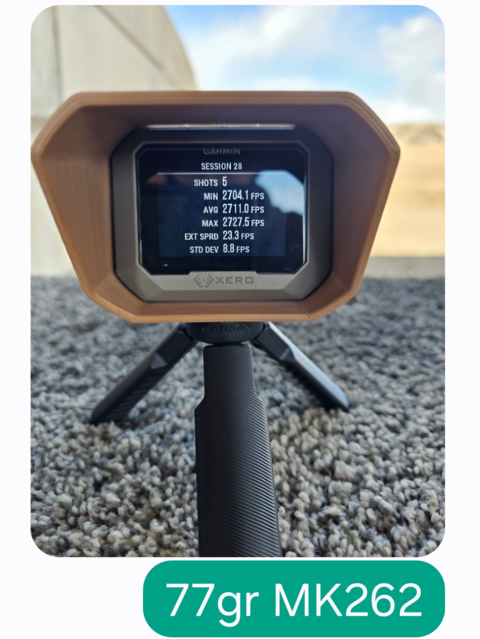

    I stated off with a 10rd groups of 77gr AAC SMK Ammo, I pulled a few but today wasn't about a final accuracy assignment, but barrel break-in l.
    The SPR Barrel definitely didn't prefer the 73gr Ammo like the Heavy Contour Chrome Lined Barrels do.
    The best accuracy results came from my go-to Handloads of 23.5grs of Tac/77gr SMK and MK262 Ammo.
    That's right @JR1200W3 your Ammo likes the new SPR Barrel, put up some respectable number too.
    23.5grs RamShot Tac /77gr SMk, /LC Brass / CCI BR4 Primers
    FOR A GRAND AVERAGE OF .663 MOA!

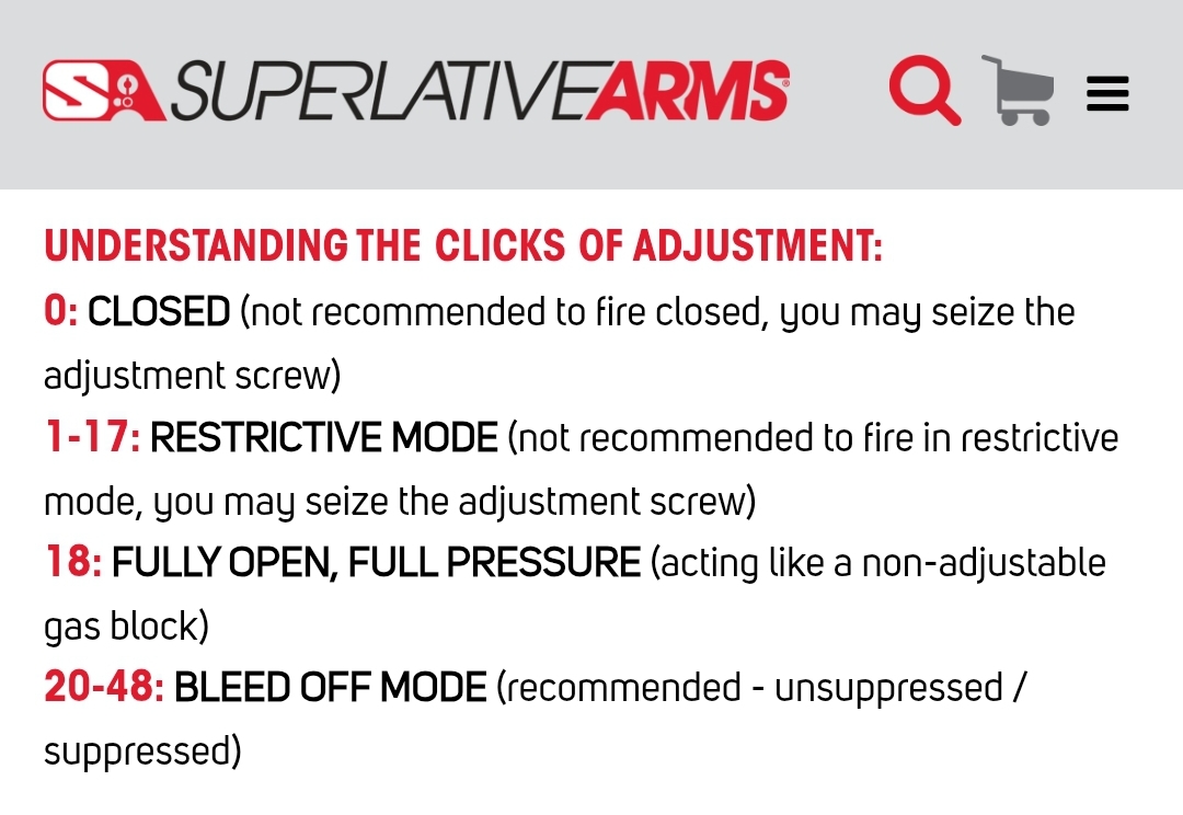

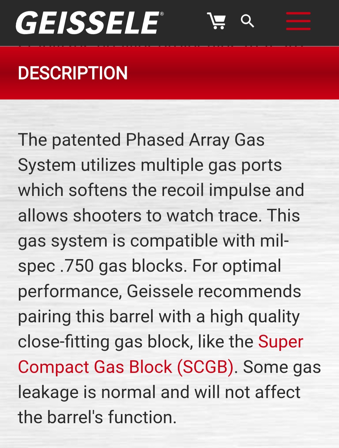

    Why are you using this gas block in restrictive mode rather than the bleed-off mode it was really designed for?
    Good Monring,
    I think it would be beneficial for the OP's of the above comment's to read part 2 again.
    (1) The Superlative Arms was chosen because it passed the hydrostatic pressure test where the standard set screw gas blocks did not.
    The superlative arms adjustable gas block is set up in the restrictive mode because I wanted to verify that I had a true seal on the gas system, if I'd run it in the bleed off mode I wouldn't be able tell because the Bleed Off setting is meant to expel excess gas and it wouldn't of given a true visual indication that the clamp on gas block had a 100% gas seal.
    (2) Just about every build I own is running a SA AGB, some with at least three to four thousand rounds on them.
    I'm acutely aware of what the literature says in the superlative arms instruction and product design description, the truth is no matter what setting you run that adjustable gas block in it will eventually start to carbon lock, so pick your battles.
    Can you please translate this into "For Dummies English" for those of us who do not know what you are talking about, please?
    Seriously? That’s pretty much worthless.
    Ok, so Superlative Arms (SA) gas blocks have 2 modes.
    They can be run in “restrictive mode” where adjusting the adjustment screw opens or closes the port that allows gas into the gas tube and down to the bolt carrier. This is the traditional way that adjustable gas blocks operate.
    In “bleed off mode,” adjusting the adjustment screw opens a port to the atmosphere, bleeding off excess gas pressure without blocking the gas port in the barrel.
    While the gas blocks are designed with both of these modes, SA only recommends that the blocks be run in bleed off mode.
    Reactions: Malum Prohibitum
    Superlative Arms claim to fame is the "Bleed off function", designed before flow through / Low Back Pressure Cans.
    It's just marketing niche at this point, so of course they are going to state that it should be operated in Bleed Off Mode because if they didn't SA would just be another AGB like thier competitor SLR.
    Geissele's new barrels a perfectly gassed, If I didn't already have dozens of SA AGB I would have gone with the VLTOR Clamp on fixed Gas Block.
    Yeah, I’m not passing judgement on how you’re using them. There just seemed to be some lingering questions on the 2 modes.
    I didn't think you were, like I said above I run the Superlative Arms Adjustable Gas Blocks on 90% of my rifles and it just depends on each firearm what mode I use. They work great either way.
    People aren't going to get it until they actually put a significant round count on one and see which way best suits their needs. Basing opinions on this through online literature is absolutely pointless.

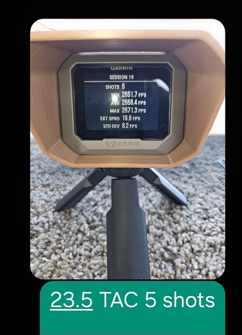

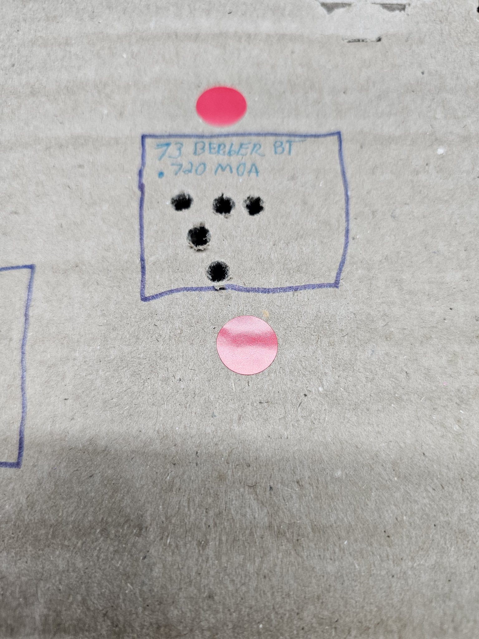

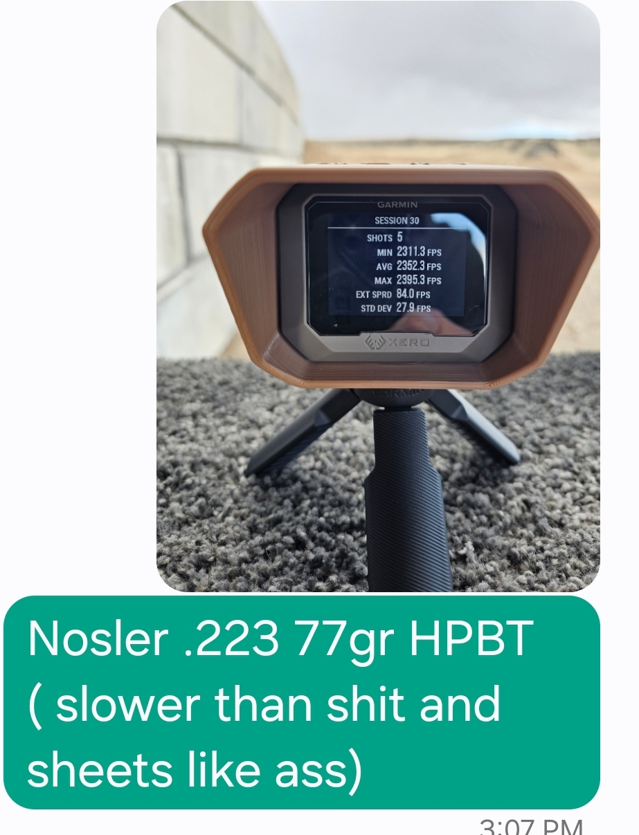

    I just finished dropping powder on some handloads for her, once the weather improves I'll shoot the first round of handloads and update y'all.
    I decided to start with.
    TAC / 77gr SMKs
    XBR / 77gr Berger BT
