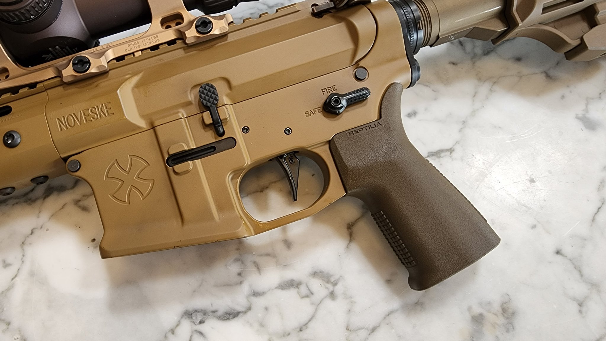

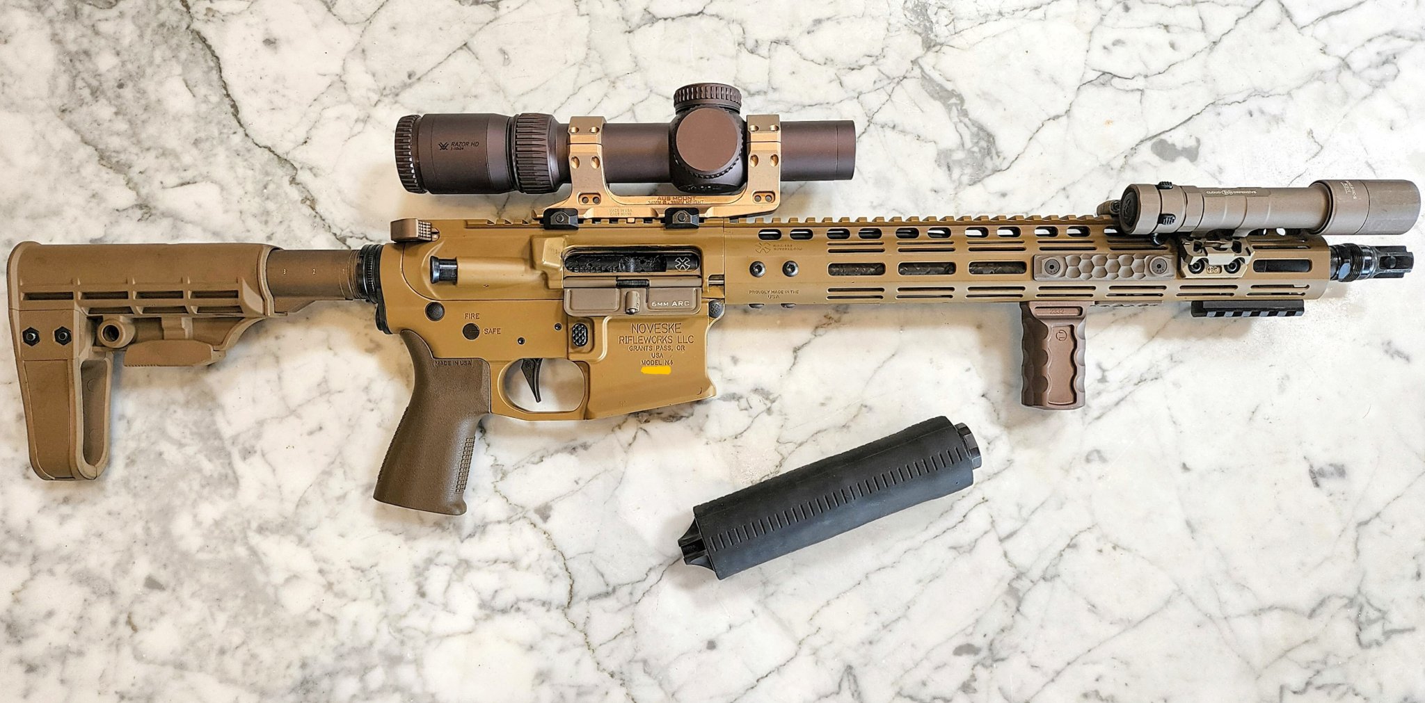

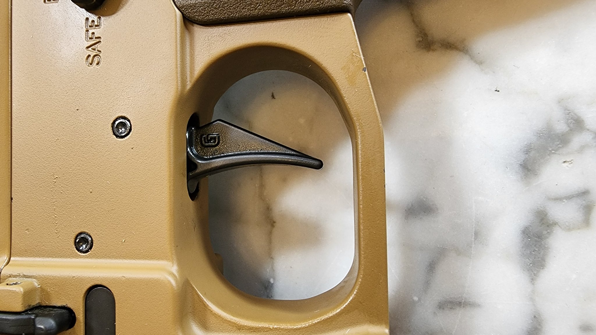

I just got my SSA-E X in today from the July 4 sale and popped it into my noveske replacing my SD-E, also have na SSA-E in my 6.5 creedmoor and a Larue MBT-2S in a 300 BLK for reference.
All that said, the SSA-E X has way too many letters in its name but man is it good. It is not a brand new trigger, more like a heavily revised and refined SSA/SD-E. These differences would likely not be noticeable to many shooters, but compared to my SSA-E and SD-E it:
- Has far less trigger travel while cocked on safe
- Has a much smoother, more linear first stage in terms of finger pressure and commensurate trigger travel.
- Seems to have a much cleaner break.
- Reset feels much snappier with a much smoother travel back. Travel from fully depressed back to reset seems to be a slightly shorter distance.
- This is subjective, but I far prefer the lightning bow trigger face to the curved or flat face in the previous generation.
This is a sample size of 3 Geissele triggers, but to me they knocked this one out of the park. I genuinely don't think I would buy another non X gen now after using this one.
