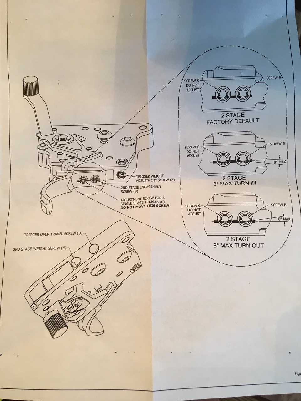

Based on some dry fire practice last night after installing the Super 700 trigger, it does indeed feel similar to a Geissele SSA-E AR trigger. The first stage travel is a touch longer on the Super 700 and the second stage is definitely lighter than the SSA-E. Unlike my previous Timney CE 2-stage the Geissele has a VERY solid backwall, and appears to not drag along the cocking piece of the bolt like the Timney CE. With a 28lbs spring it is very snappy!! Live fire testing to commence on Saturday.
SSA-E
Type:2 Stage
1st Stage
Weight Range:
2.0 - 2.5 lbs.
2nd Stage
Weight Range:
0.9 - 1.3 lbs.
Total Pull
Weight Range:
2.9 - 3.8 lbs.
Super 700
Type:2 Stage
1st Stage
Weight Range:
1.5 - 3.5 lbs.
2nd Stage
Weight Range:
0.5 - 1.0 lbs.
Total Pull
Weight Range:
2.0* - 4.5 lbs.
*you technically could adjust below 2.0lbs, but it is outside of the recommended manufacturer adjustment range.
A quick update after Saturdays range session. The trigger performed flawlessly and felt good. I did decrease the factory set weight following the included instruction (see attached). It's supposed to come set from factory as 1st stage = 1lbs 12oz and 2nd stage = 12oz. Testing with a Lyman digital pull weight gauge yielded a 1st stage of 1lbs 12oz and a total pull weight of 2lbs 6oz. Doing math yields a 2nd stage weight of 10oz. So either my gauge is a little off or mine came set a bit on the heavy side from the factory. I may tweak it a little lower, but it is perfectly usable at the current weights. I also need to double check but the safety lever appears to be a short throw rather than the traditional longer throw of Rem 700.
I will pick up a Triggertech 2-stage when available to compare. My only minor complaint is that Geissele does not offer the trigger with a flat trigger shoe. :(
