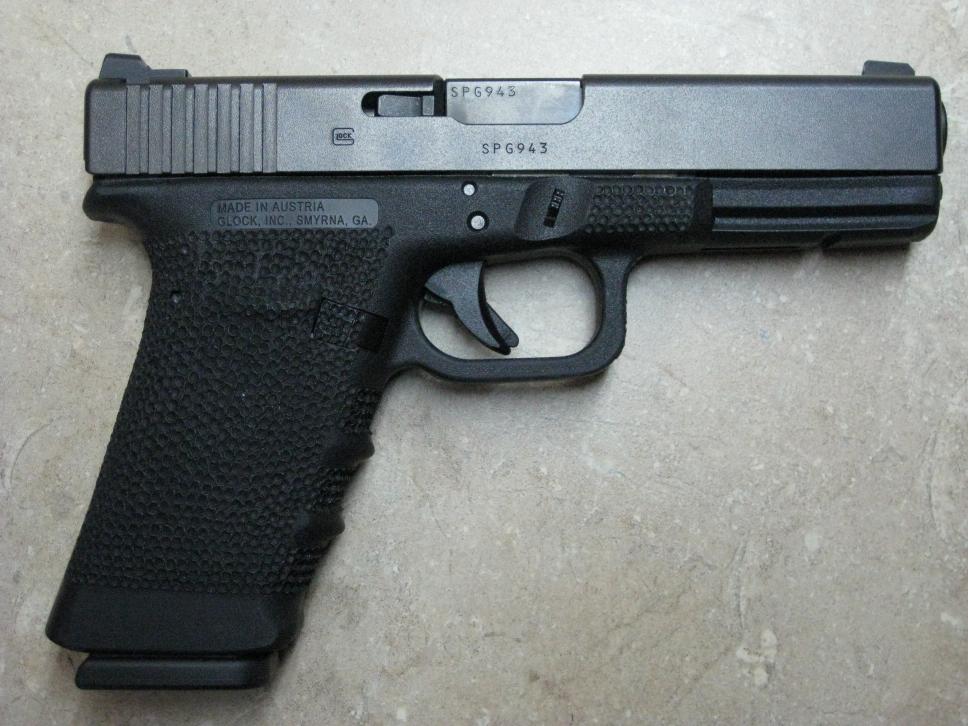

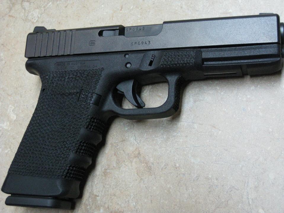

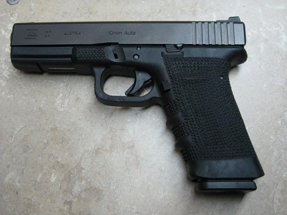

Here's another pic. I reduced the size, but still can't seem to attach more than one at a time.

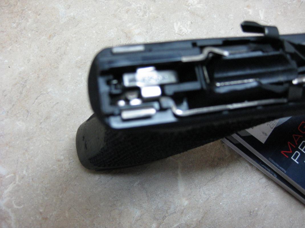

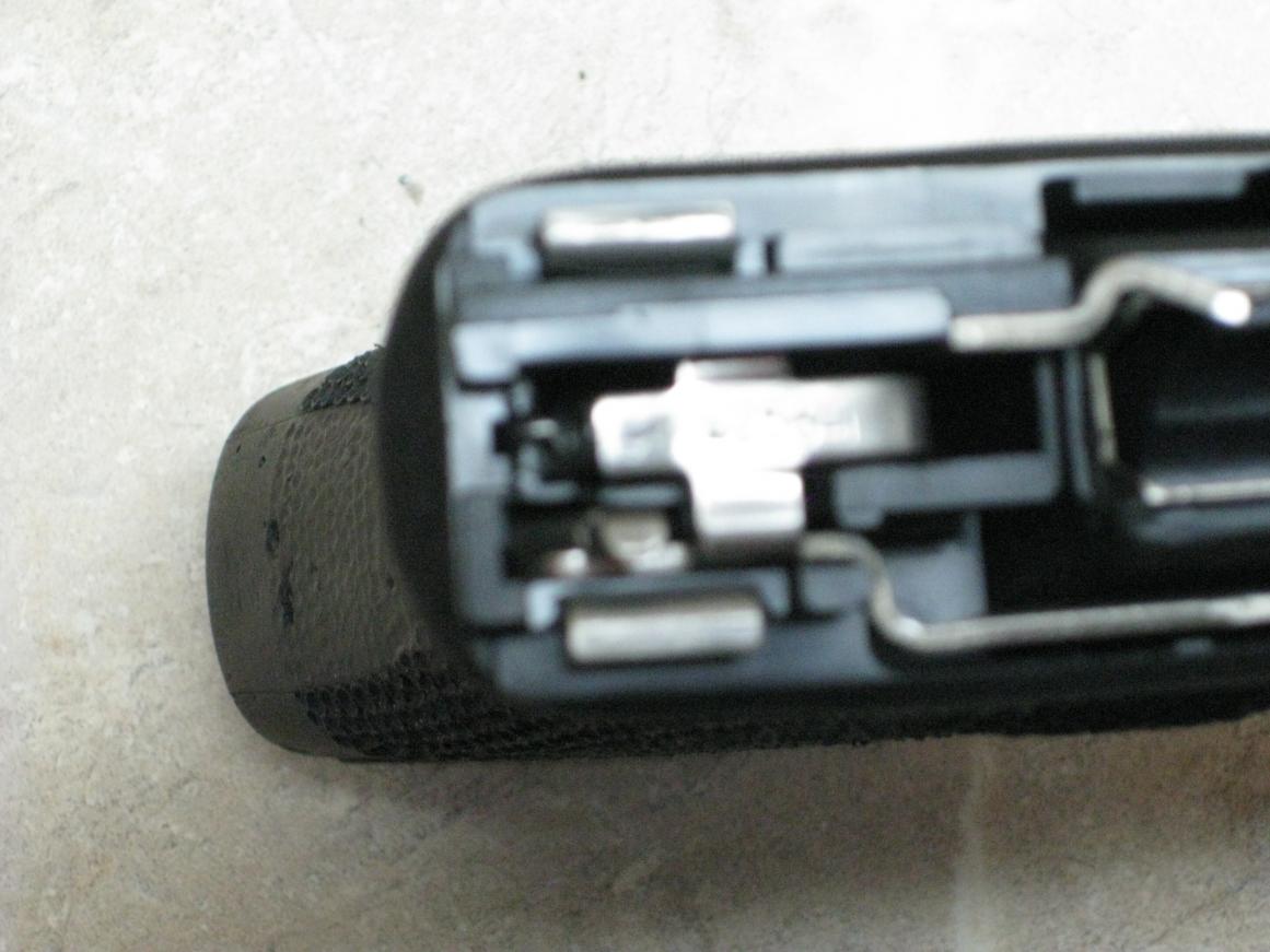

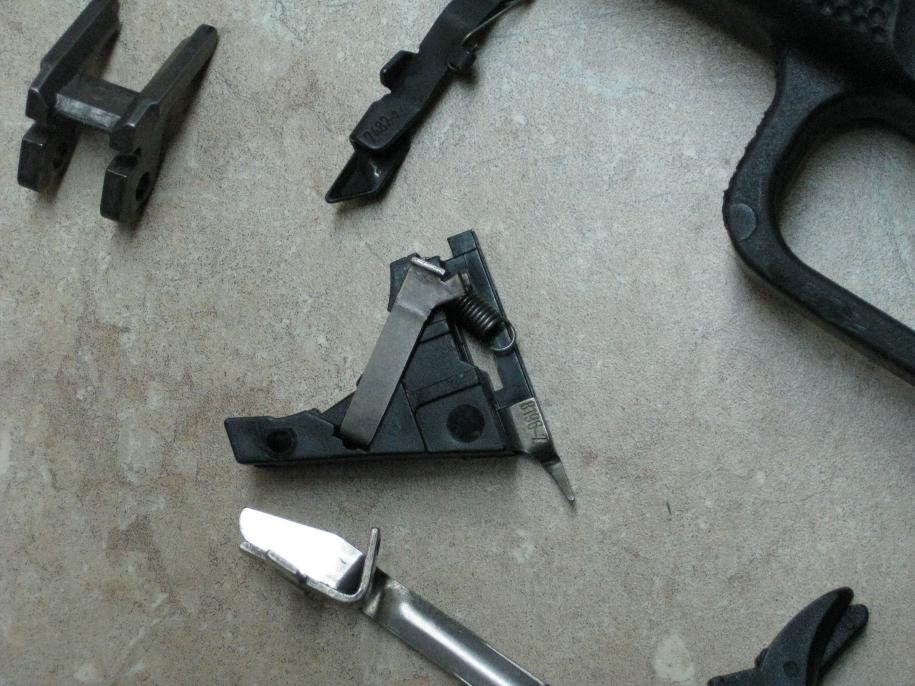

I filled the back of the frame(or receiver, in somone's parlance) with Devcon before cutting it down. The area where the ejector and disconnector sit was blocked off and is clear of any Devcon. I had a hard time focusing the camera on the trigger bar and disconnector area, so I just took the thing apart again. I still have a bit more stipling to do, but it's finished for the most part. I have a pretty good assortment of trigger springs, disconnectors and even firing pin springs on hand.

Did you or the guy you got it from alter the part of the trigger that connects with the disconnector? The reason I ask NOT SAYING YOU DID but a few have brought there pistol to me after POLISHING the trigger (TRYING I THINK TO MAKE IT GO FULL AUTO) with this problem. IT changes the angle of connection.

Got some parts ordered up from glockmeister and finally got home from work. I replaced the trigger/trigger bar and put a 4.5lb connector in, along with a competition trigger spring. Trigger is light and crisp now. Can't seem to induce the previous problem by dry firing like I used to. Headed out today to put 60rds through it in rapid succession. I have a feeling my problem is solved. Thanks for all of the advice guys.
