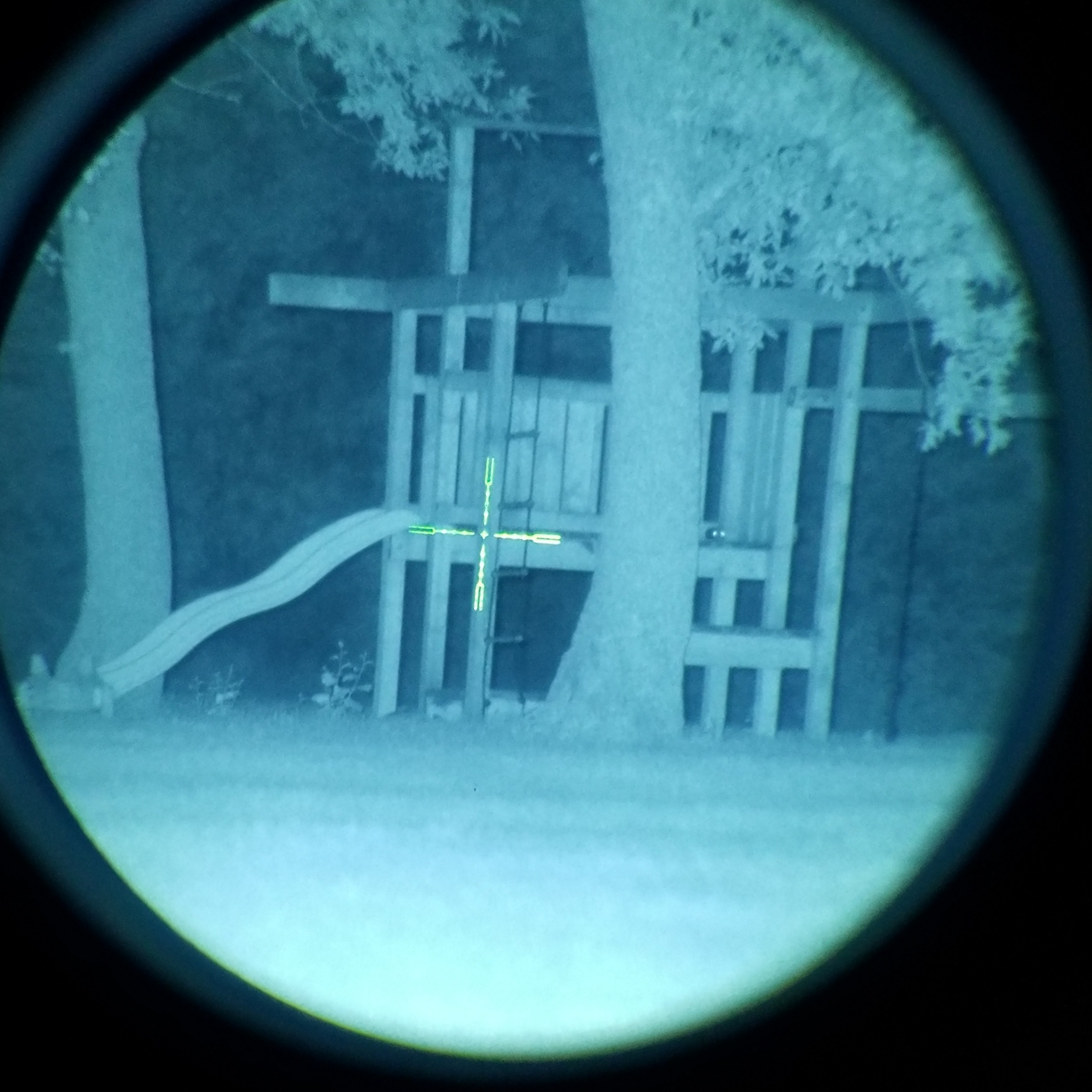

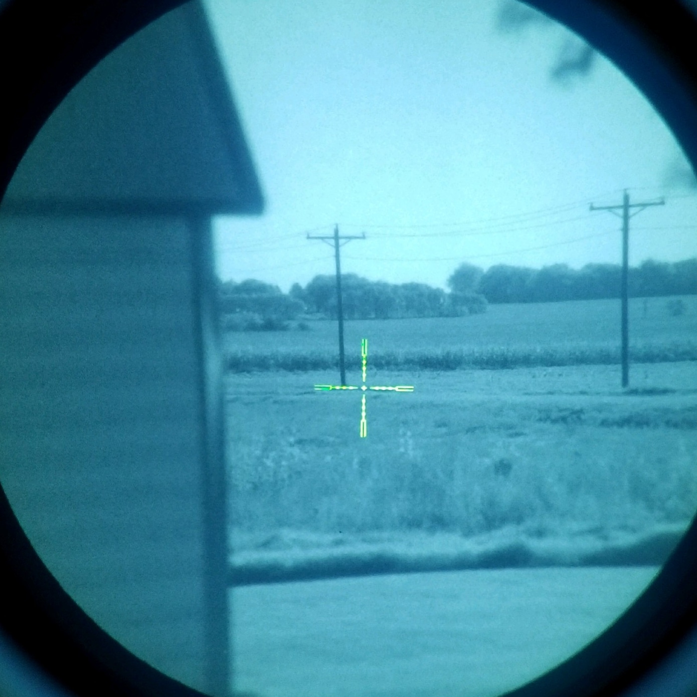

The pictures I've attached are through the scope of a d760 I used to have. Tube was a gen2+ photonis. It was fine and killed plenty of coyotes with it.

ya those photonis2+ tubes are GTG when you you put them behind a big Obj. . I shot several coyote with a clip-on armasight with big Obj.. . It only suffered on the nights with Zero ambient, with having some grainy signal noise and had to pump IR on targets .
Not that the Gen-3 does not have some grainy signal noise with no ambient, as it will need some IR supplement also . IT just that you do need a big Obj. to really complement the 2+ gen and get best results out of it . I had no problems with it seeing coyotes out in fields 300-400 yards out standing in open fields with a half moon ambient .
For some safety and stealthy 'foot travel' at night and on a budget . I would not hesitate to use a small Obj. with a gen2+ in a pvs14 also . It will give you adequate service for walking in the dark .
That sure looks usable to me, thanks for the pic.
