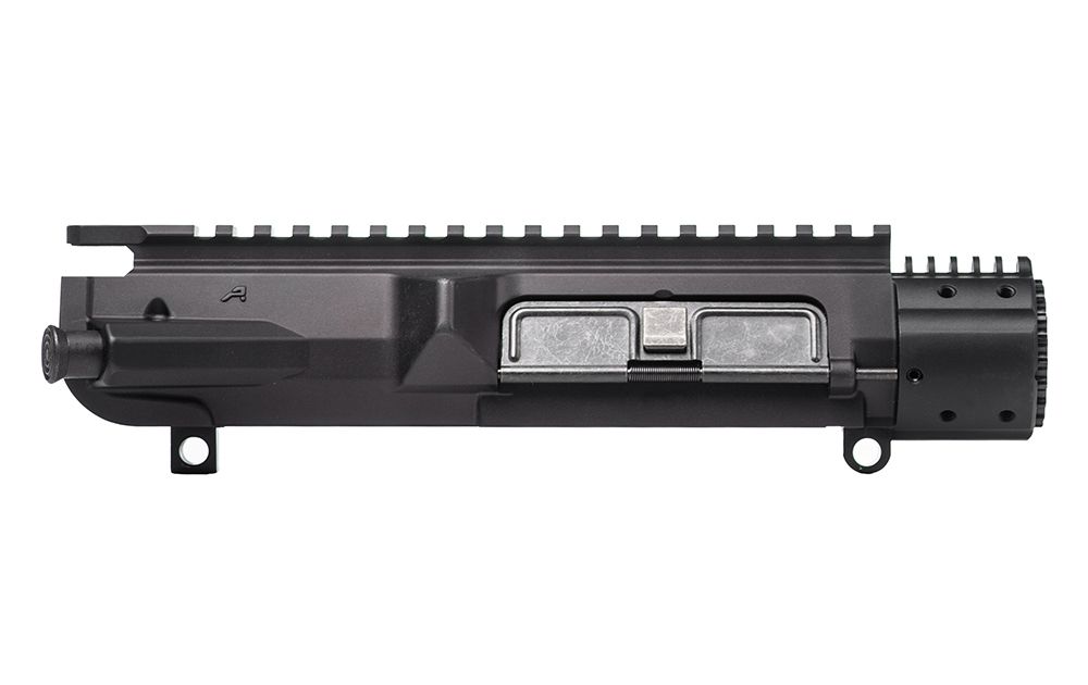

I would be sure to use the Enhanced Aero M5E1 upper with their handguard. Uses a similar concept as the the Seekins upper with the integral handguard mounting interface. (Mega (Zev) also has a version of this if you really wanted to blow money)
Aero M5E1 ENHANCED:
Any extra weight from a system like this is probably pretty minimal and definitely worth it IMO.
But overall I would not spend the extra money for a Seekins/Mega if you have a strict budget. Instead dump any extra money into the barrel like previously said. You'd be hard pressed to find an actual difference in performance between these receiver sets anyways. The barrel however is a different story... (Sgt of Arms didn't have any issues winning the 2020 PRS Gas division using Aero M5E1 Enhanced uppers)
Aero M5E1 ENHANCED:

Aero receivers are gtg. They have small feed ramps which some AR/LR308s don’t. JP bolt is a must imo. Even with 308 I’m still blowing primers occasionally with standard bolt. Faxon makes a decent rail also. I prefer it over the non enhanced aero rails. It won’t need shims or clocking like some aero rails. Also, Aeros gas blocks have more adjustment then they claim. My GB needs 17 clicks to be wide open

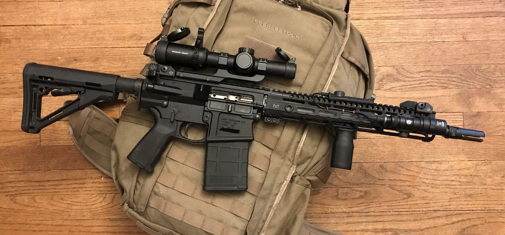

I don't have my .308 AR anymore, and I kinda wish I did. I built it as a general use carbine that wasn't too big to be carried as a primary weapon if it came down to it. It would give me more juice than my 5.56, but Was still compact, (for a .308) as long distance wasn't the goal. I went with a 14" Ballistic Advantage barrel they had on sale because they were discontinuing it. With a Warcomp pin & welded, it hit the government's magical 16", so they were happy. I'd love to build another like it, but at today's prices, and with no .308 ammo anymore... it wouldn't be practical to jump back into the .308 game. I don't remember reading exactly what your overall goal was, but to me, a handy little multi-use carbine is the way to go.
This is basically what I'm after, a rifle with more kinetic energy at distance than an AR15 will allow while also being light enough to fulfil a general purpose carbine role.
Do you remember the weight and accuracy of this rifle? What was your reason to go with the standard Aero M5 receivers and not the enhanced version?
Never weighed it. I was shooting about 1.5" groups with it. I did get one group under an inch, but I can't say that would have been the norm. (I did brag about it though at the time) I'm not the best shot, but either I sucked, and it could do better, or it was an average rifle, and I got lucky... don't know. I actually ended up not keeping it long after I finished with it. That's the main reason I'm pissed at myself for getting rid of it. I really think it had a lot of potential. As far as the receivers go... they were what I could find in stock at the time. I don't think fancy receivers really get you anything unless you're building a precision build. The heart of an AR is the barrel, and BCG. It was plenty good enough for a combat carbine... and I kinda miss it, but my 5.56 ARs are also plenty good enough, much lighter too.

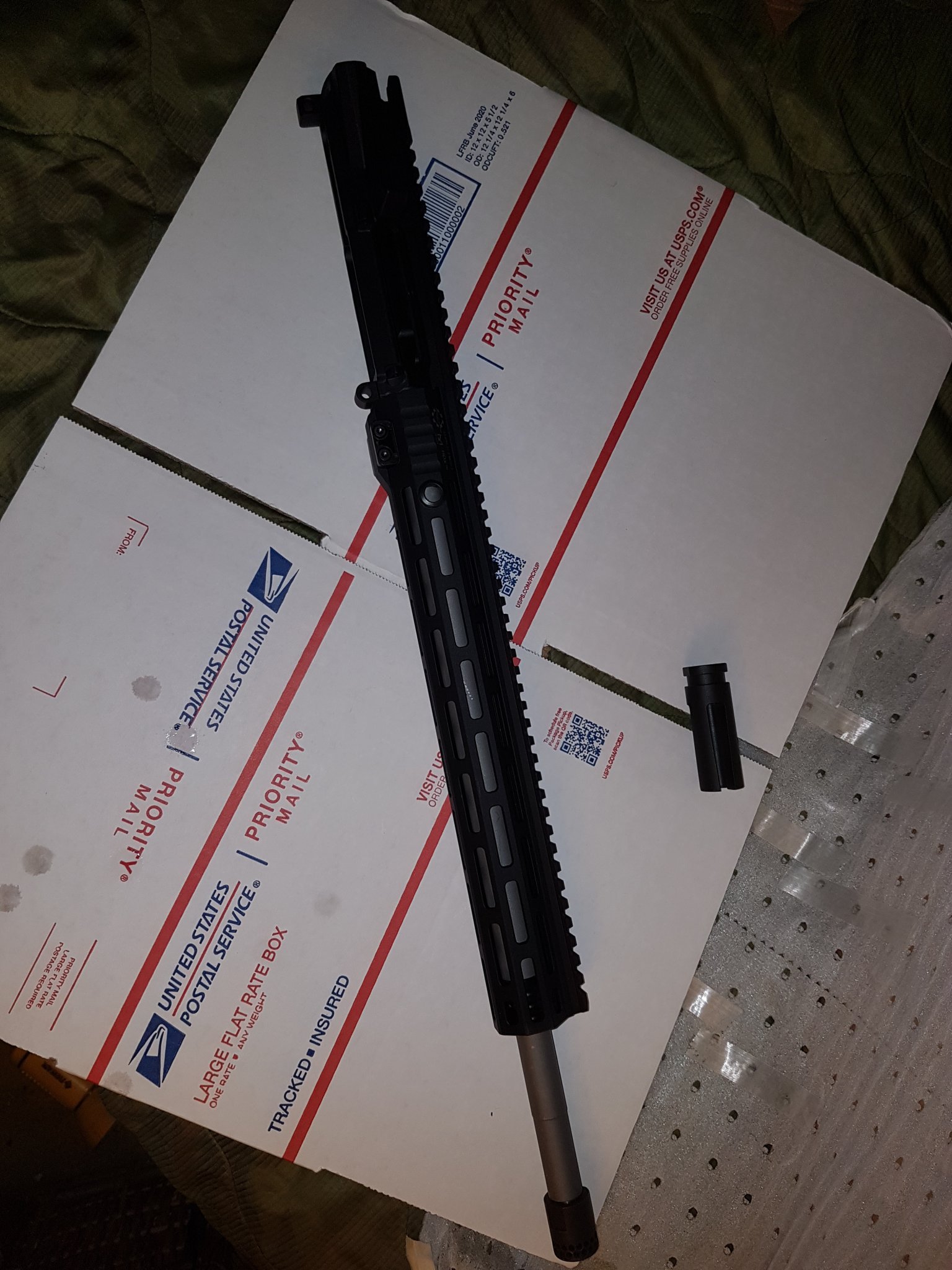

SLR sentry detent gas block is pretty low profile but can be a PITA to get to. I like it more than the JP detent block. Theres a new AGB on the market that's being pushed by influencers, dont remember what it's called but it looks easy to use and no tools for adjustment.
....this is true for any front single screw adjuster type of AGB if an overly long handguard is used, which also increases the overall weight of the rifle. For some, the long "look" is appealing and part of the reason they do so. Personally, over a period of time and usage, I forego such, now limiting handguard length so that the adjustment screw is readily accessible and the gas block is fully protected, not to mention weight savings gained.
...attached are images of SLR AGB's in both set screw and clamp models under a CMT UHPR-13.7 MOD 2 HDX handguard. The barrel is my BA 18" 6ARC w/Rifle Length Gas System ordered from Brownell's early in the advent of 6ARC.
Edited: Pics taken during my "mock up" testing of components. The muzzle devices shown are a Brownell's "short .308" compensator (used as a thread/muzzle protector) and a FOSSA-762 flash hider as a possible candidate for a muzzle device. Suppressors are not legal in my locale. YMMV
